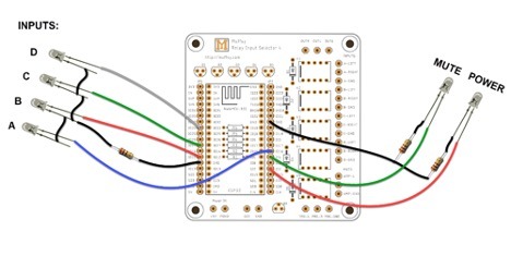

You can also try Muffsy Input Selector. You can view the description here
While I-select is okay, it is manually controlled only. The Muffsy can be controlled manually and remotely.
In my opinion, the advantage of the Muffsy over I-select:
1.) Remote or manually controlled
2.) Requires only 5Vdc that can be had with using just IRM-05-5
3.) Muted preamp to amp signal path
4.) Programmable
5.) Programmable 5V output for Solid State Relay (SSR) that can be used to turn the mains power On and Off
I have two (2) I-Select kits and chose to use the Muffsy instead in my BA-3 because I think it is an elegant source selector.

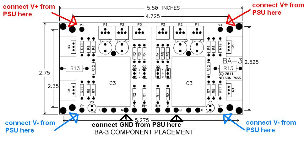

Hello jhuabd,
in the BA-3-frontend the connections from the symmetrical PSU to the board are like in the pic
below.
You have to connect both channels to the PSU = 6 wires
V+ / V- / ground and this for left and right channel. :nod:
Cheers
Dirk

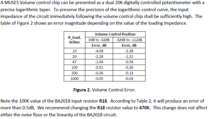

Hi Folks,
Very nice thread. Like many of you I use the Muses volume control board. Mine is coming from Academy audio and is working very nicely with Wayne's BA 2018 linestage.
As per application note from Academy Audio, the error level can be reduced by increasing the preamp input impedance. Here is a screenshot from the Application note and the link to the full document.
https://www.academyaudio.com/_files/ugd/6fd7ca_be4a3abc142e448587231feaa445cf51.pdf
Do you see any potential impact on the sound quality or stability of the BA-3 if I increase the R2 resistor from 47k to 470k?
Thanks.

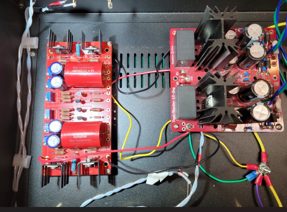

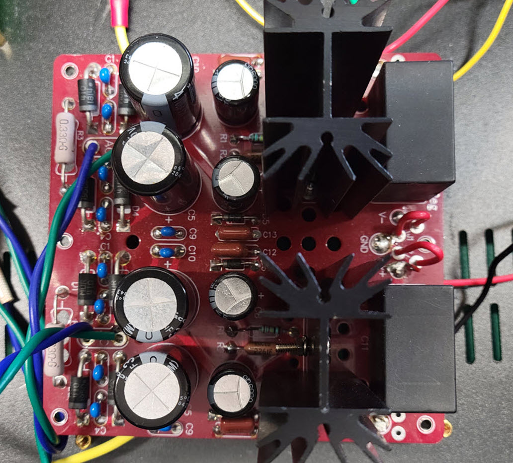

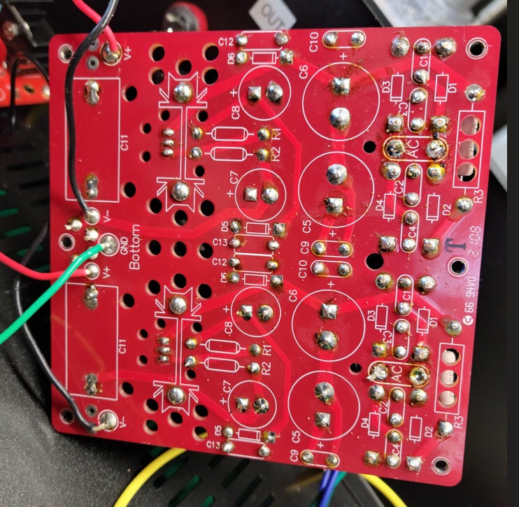

I get +/- 24V out of the PSU and into the amp board. I'm using 8 -10 IDSS jfets from diyaudio store. I have not touched the P3 pots.
I built a new board with the FQP3P20/30 mosfets and 500R trimpots. And I get the same results - no current flowing. Something is amiss. This is the second BA-3 preamp I've built. The only difference is I'm using the Dual/Bipolar LV Reg PSU instead of the PS-22 PSU. I'm missing something in how I've wired between the PSU and the amp card.
As documented in the BA3 article, the Fairchild parts require higher Vgs voltage to turn on (when compared the Toshiba mosfets) so you likely need 1K trim pots.
If you have the COM probe of your multimeter on GND of the BA3 board and measure with the other probe +24V on V+ and -24V on V- (again on the BA3 board) then your power supply wiring is correct.

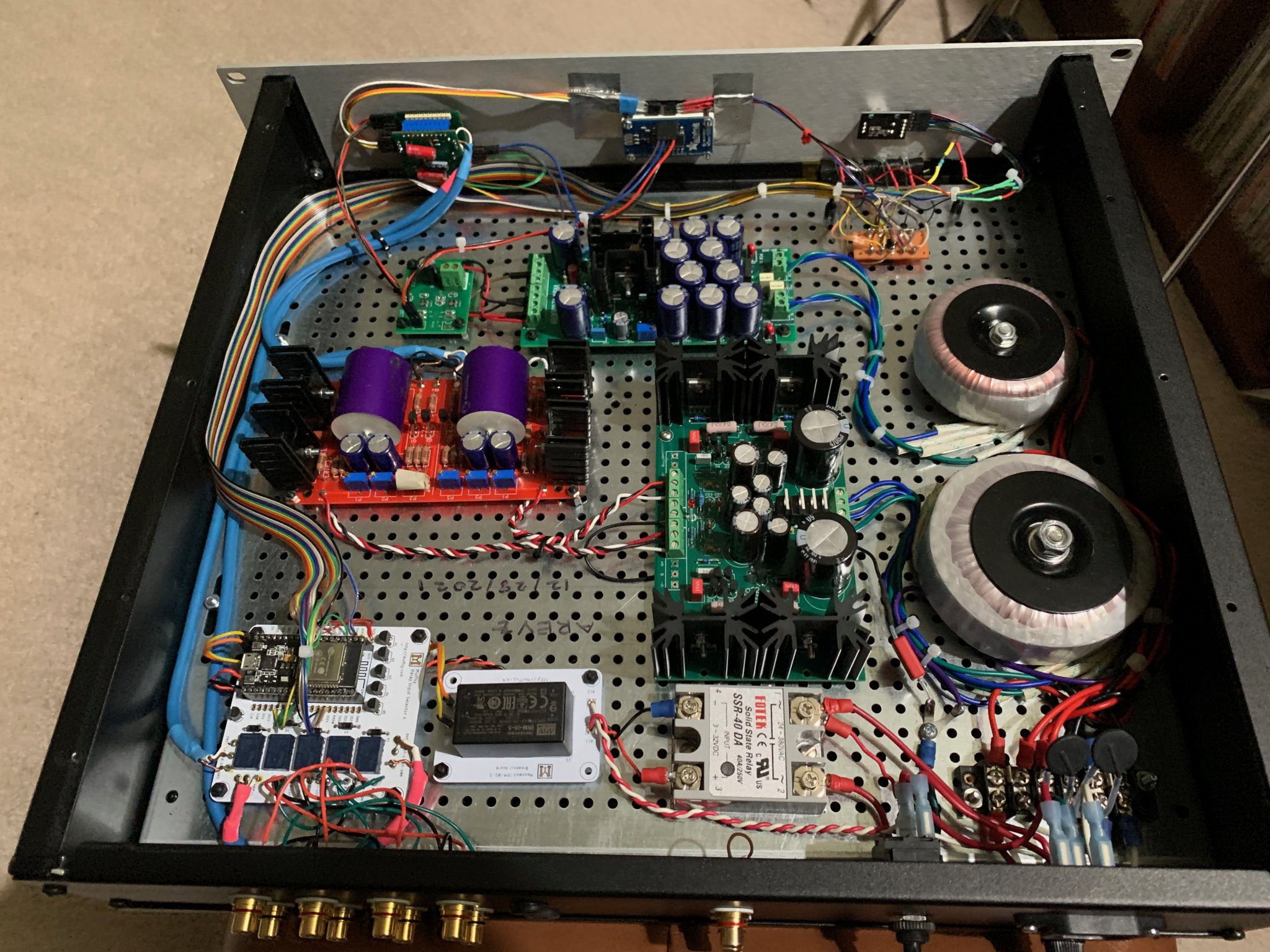

I can see a transformer feeding the Sigma 22 and another one feeding what it might be a Sigma 11, the BA-3 board up there on the left,
The small transformer feeds the VRDN (please search Pass Labs forum) to get a regulated DC of +-15 Vdc to power the Muses,
the smaller board immediately to the left of it is to get 5Vdc from the output of the VRDN for the Adafruit display of the Muses volume control.
No clue what the relay switch is for nor what the board in between it and the apparently switch board is, also top right before switch command and in the corner between the BA-3 board and the other PSU.
The relay (SSR-40, Solid State Relay) is to use the 5V SSR out of the Muffsy to turn On/Off the "big" and "small" transformer and in turn, turns On the VRDN and the Sigma 22, then the volume control and the BA-3; the board between the relay and the Muffsy is the IRM 5-02 which converts 120 Vac line voltage to +5Vdc to power the Muffsy input selector.
The top right switch, is not a switch but just a pcb that I use to implement the LED input display for the Muffsy below
So, I will try my best to explain how the system operates.
Looking at the back of the preamp, a little cut off from the picture but visible, to the right of the RCA output is the main switch for line 120 VAC. This switch turns On and Off only the IRM-5-02 (On is standby, Off is totally disconnected from line voltage). When the switch is on standby, the IRM has 5V out, the Muffsy control board can be turn On by pressing the encoder switch on the faceplate of the preamp. When the Muffsy is awake, it triggers the relay, then it connects the transformers to the line voltage, then it powers the boards and so on as I described above.
Hope my description make sense.
On a lighter note, lots of knowledgeable people here to answer your questions when you build the preamp, I know because I asked a lot of questions too.
I think you might be on to something. On the right channel I get -24DCV but not on V+. On the left channel, I get +24DCV but not at V-.
Which seems weird but points back to the PSU board.
Maybe time for a new PSU board. The PS-22 has been out of stock for months.
