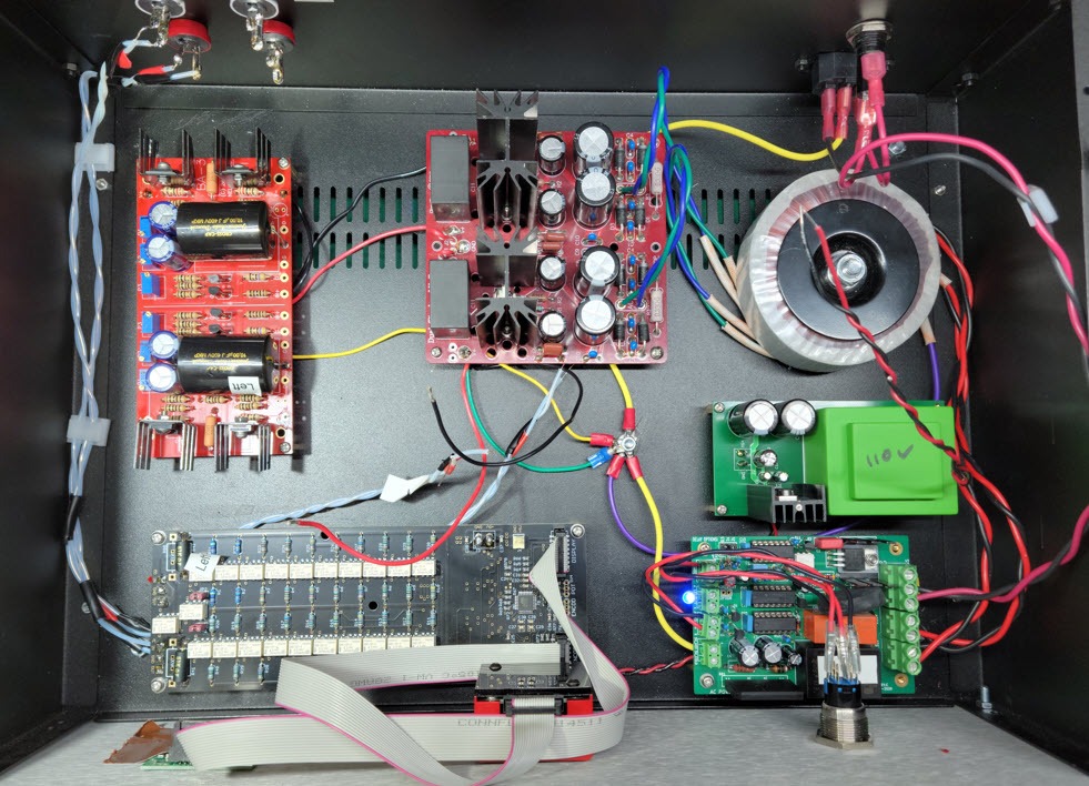

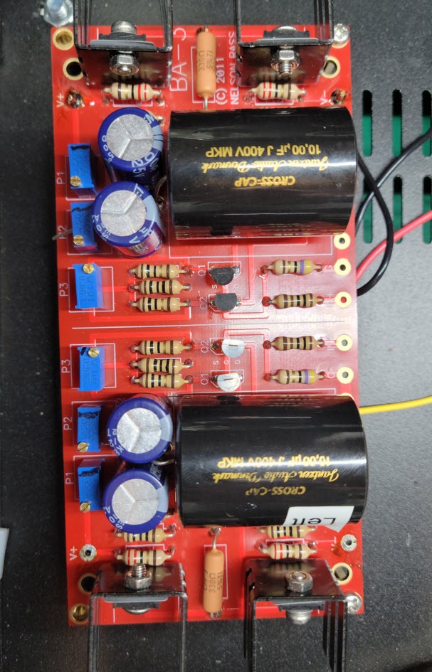

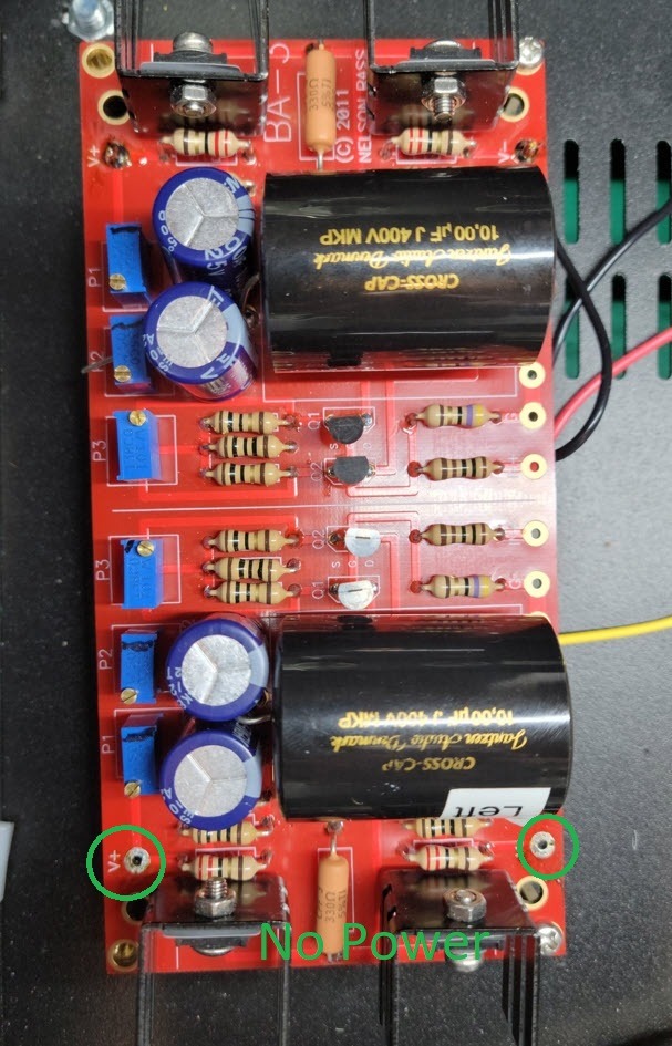

Stumped. This is my second Ba-3 build. I've got 24DCV from the PSU to the amp board. But I can't get a pulse from my efforts to bias either channel.
I've double checked the resistors, capacitors, trimpots [500 ohm as I'm using2SJ313 & 2SKs013 Mosfets] sourced from a reputable source via references in this forum.
I'm hoping I've missed a simple step. Or maybe not.
Appreciate any thoughts.

I suggest starting with the following:
1) Check all part values/locations again.
2) Measure voltage at V+ and V-, make sure you are getting +24V and -24V.
3) Measure voltages across R3, R4, R6, R7.
4) Measure voltages across R10 and R11. Do you get anything at all or is it zero even with P1 and P2 at max?

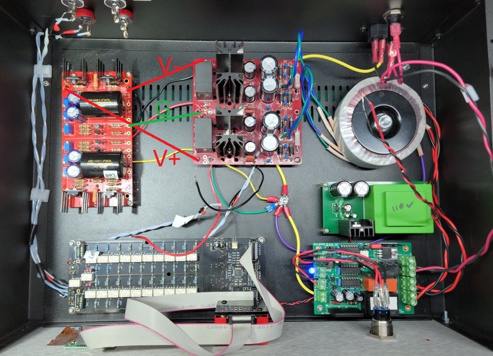

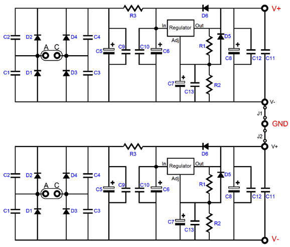

I´d say there is no positive Voltage on the amp board (V- goes to to V- but Gnd goes to V+). Left channel seems to have no power at all.
See pics attached (shows how it should be).
Edit: are the Jumpers J1 and J2 on the PSU installed to tie the voltages together?

Thanks Dennis, I will start to knock out measures.
Joined 2005
Right channel is not connected up. For left channel: V+ goes to V+ and ground V- goes to V- on the amp board.
I built his PSU a while ago and will have to research your question. my testing indicates I'm getting 24 VDC for both channels from the PSU.
To me it looks as if the black wire goes to V- and the red wire to V+ of one half of the power supply. So effectively you are feeding +/- 12 Volts.
Your power supply generates 2x24 Volts: V1- V1+ V2- V2+
V1+ and V2- make your shared ground and the board is fed with V1- and V2+.
Joined 2014
J1 and J2 need to be installed which I think I see. Touch ground on the PS board with the black lead of your MM. Red to + you should get 24vdc. to - you should get -24vdc. Tie ground to ground on the linestage, - to - and + to +. If all of that is right, you're not getting anything then it may mean you need to keep turning the turn pot. It takes a lot of turns to get it going.
