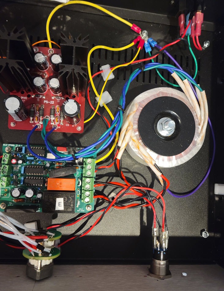

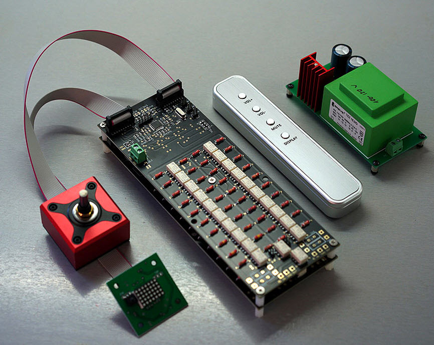

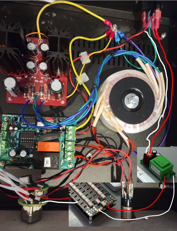

Ok. I've been working with Arek at Khozmo and he recommends the Khozmo Shunt type RCA 64 steps with relays and remote. It requires 120 V AC to power its PSU. He says I can pull from the AC at the IEC. My question is can I wire off of the hot and ground at the IEC to power this?I'm using the H9KPXG in my BA-3 preamp. Works like a champ.
I'd like to move to the Khozmo 64 steps relay-based ladder type attenuator with remote.
This set-up requires a 5VDC feed. I thought I could just use the 5Vdc from the board. But the Khozmo requires linear power supply, not SMPS. I'm trying to work out how to provide a linear power supply. I'm hoping I can use the Glassware LV-Regulator set to 5VDC which is currently sold out.
If that all holds together, I'm stumped as to how I feed or connect a 2nd transformer for the LV from the H9KPXG?
Appreciate any help.
I've mapped out what I'm thinking in the attached files:
As always, thanks.

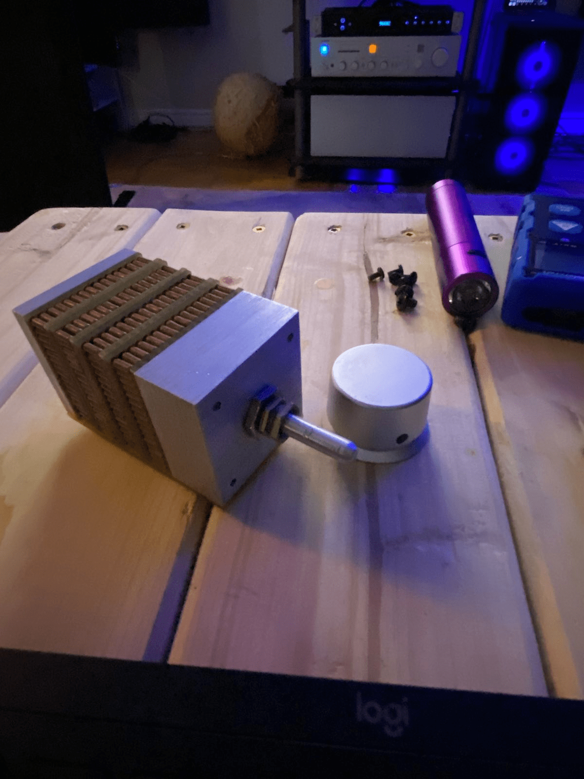

Can I play too? 😎 I receive this shunt attenuator as a gift from dear old brother. I've been sitting on it for more than a decade. Actually I had it in a crack headphone amp until I sold it. The khozmo did NOT get sold with the amp. So, it's been patiently waiting for a preamp project since then. It will be happy days when it comes back into use.
Always happy to have company in my confusion. Can I run wires to two separate components from the same IEC or do I need some sort of interim bridge to direct the current two ways?Can I play too? 😎 I receive this shunt attenuator as a gift from dear old brother. I've been sitting on it for more than a decade. Actually I had it in a crack headphone amp until I sold it. The khozmo did NOT get sold with the amp. So, it's been patiently waiting for a preamp project since then. It will be happy days when it comes back into use.
You can connect your power supply directly to the IEC. It's no different than plugging into another outlet in an extension cord. If your IEC does not have a fuse and if your power supply does not have a fuse, then you need to add a fuse in the live line between the IEC and power supply.
If your power supply does not have an on-off switch, it will be always on. You can insert a switch in the live line.
Or your other choice is to hook it to your soft start circuit, assuming that you do not exceed its current capacity.

Thanks much for your counsel. I am using the soft start circuit. I'd like to use the 5Vdc from it for the Khozmo but it requires linear power supply, not SMPS. Can I run the power out to the Khozmo from P1D and P1N? That would be great as the Khozmo would now be included in the switch. I understand now that if I wire it from the IEC, it would always be on, as I rely on the soft start switch. If so, I guess that shouldn't be an issue for the Khozmo.
