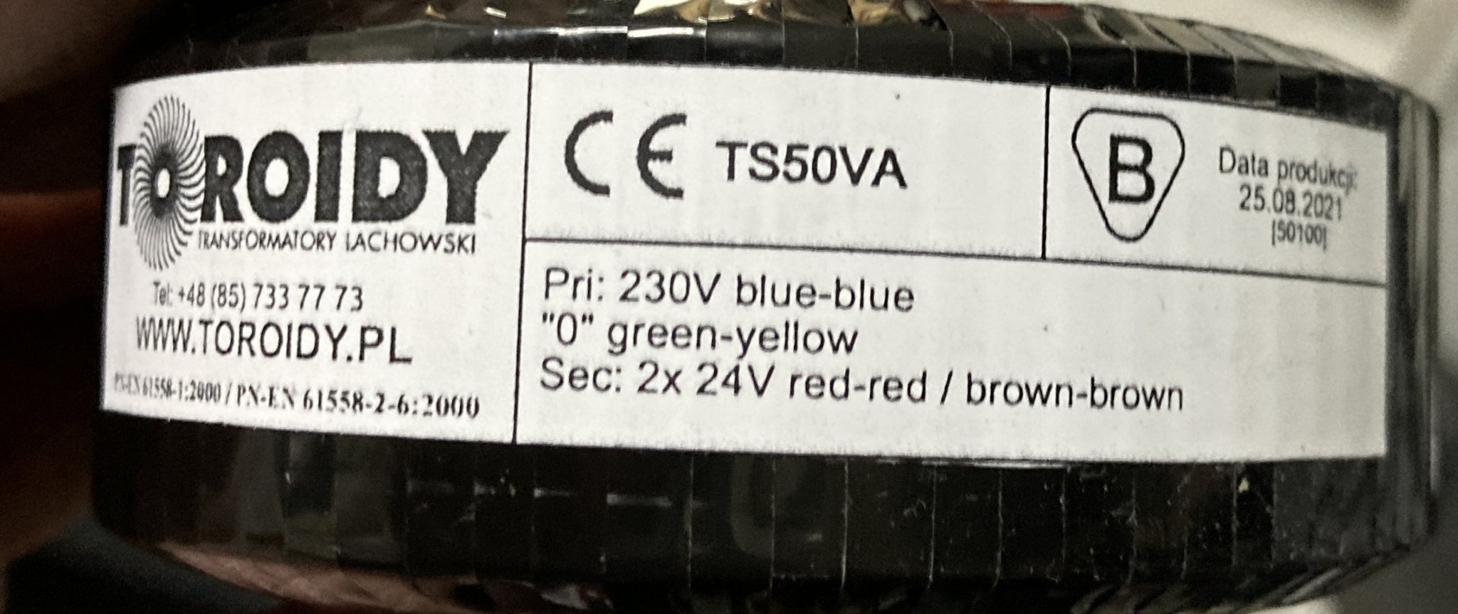

Per the PSU parts list, you need a transformer with dual 25VAC secondaries or a 50VAC Center tap for a +- 24VDC supply. There's 'a lot' of voltage drop in that circuit.
Toroidy specs their transformers at 230VAC input, so if you really wanted to get closer, to 25VAC output on 220VAC input, you could get a 2x26. The BA-3 isn't going to care, but since Toroidy offers it...
As for power rating, 20VA is more than enough, (even if you don't do dual mono) and is the smallest standard size from Toroidy.

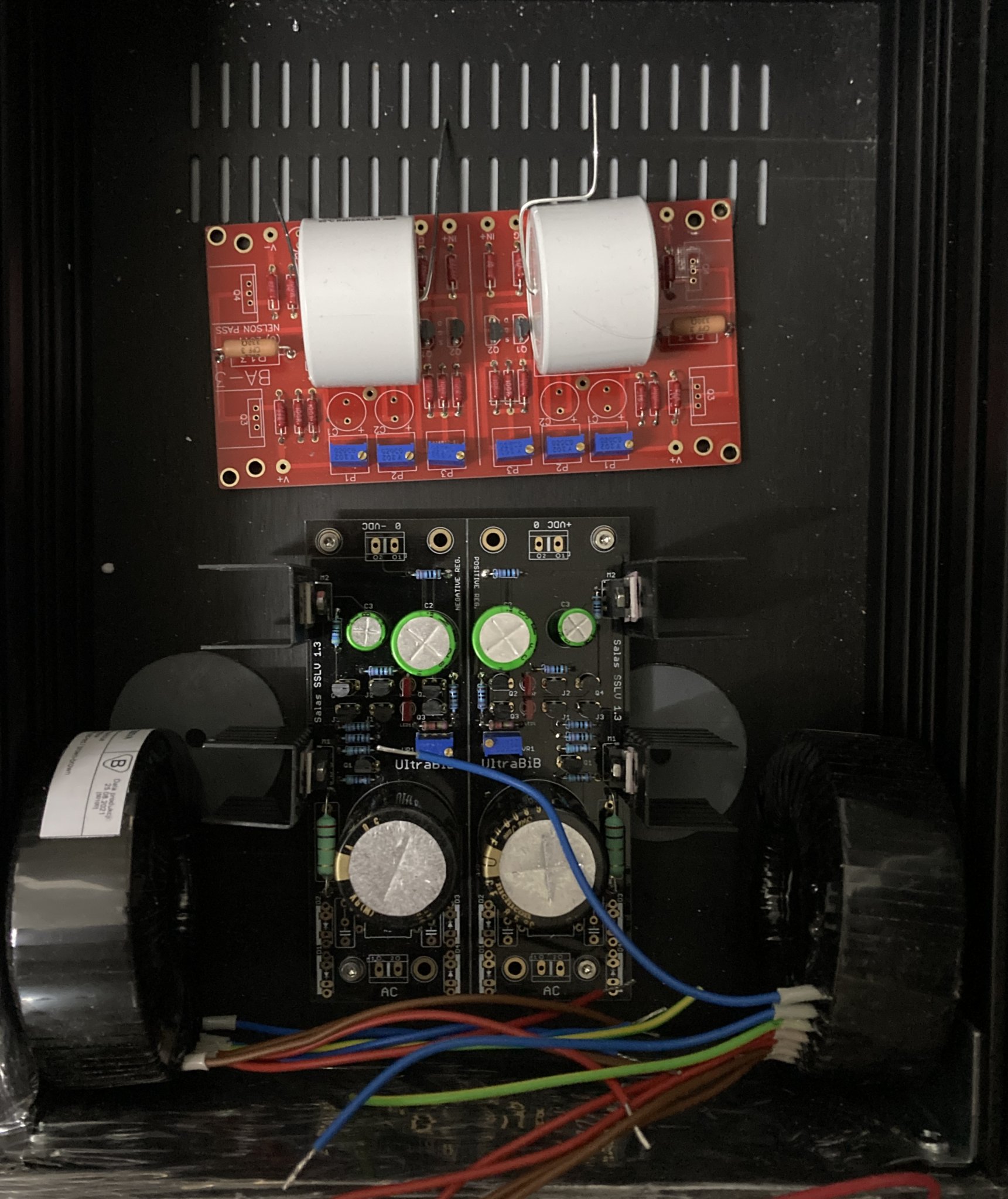

If you go the 2U 330 route, which is more than I have (I’ll actally run it in a 230mm chassis!), you should be fine. Still, make sure everything you need finds a place and is accessible/wireable…
I can’t explain a shunt good enough, please research! Its a regulation method, after toroid/rectifier.

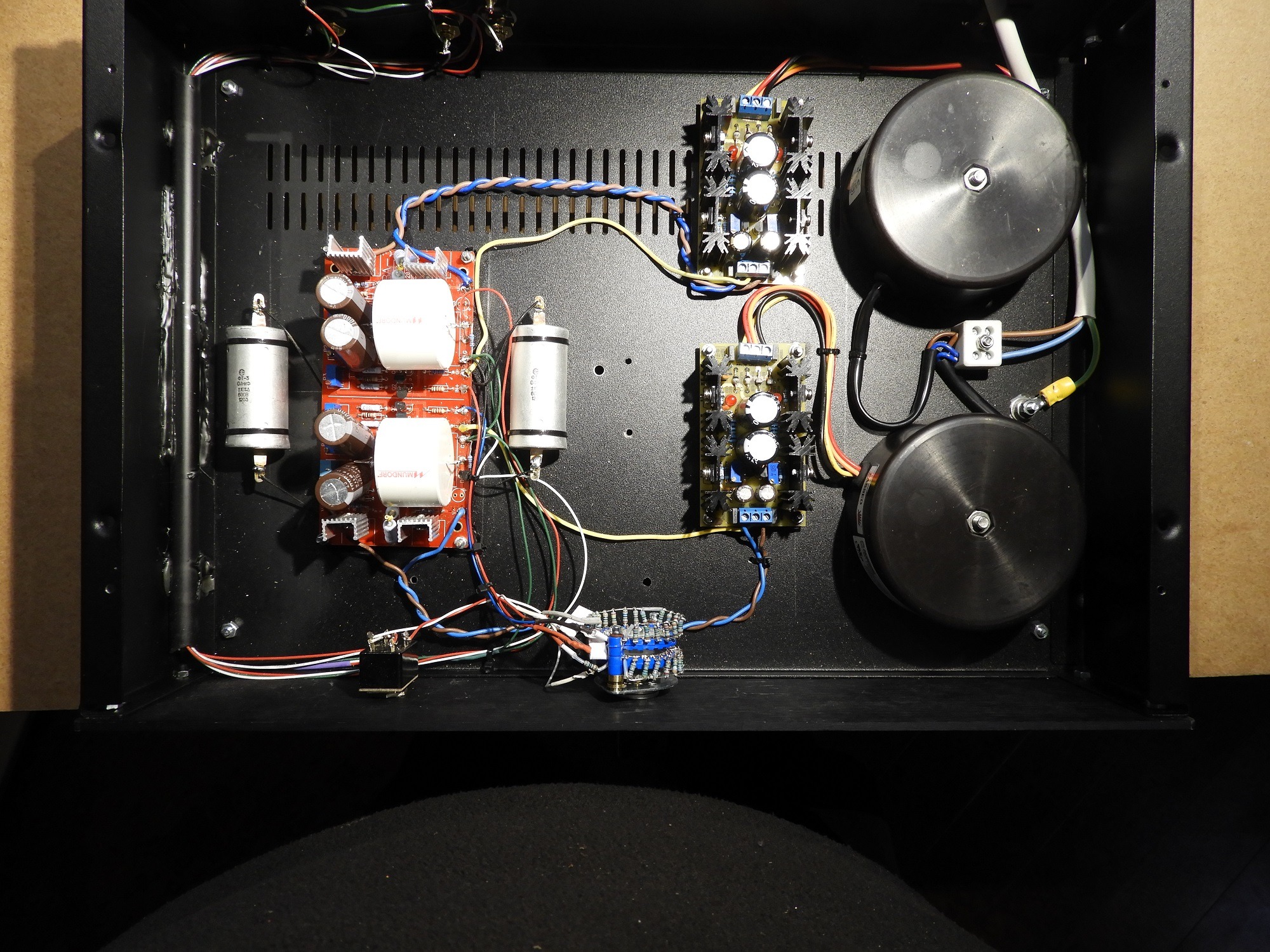

Ah, and, I have to admit: My build as it is looking right now isn't a dual mono! (There's one positive and one negative rail for both...
Shame on me!

Hello,
this photo helps a lot to understand the layout, a lot to a total novice... I can tell the AC reaches the two transformers, ground to the chassis, from transformers to the two boards, from there to the BA-3 board, what I can't tell from the wiring is volume potentiometer, signal input and signal output, how are they wired/where from/to.
Would it be possible to have dual output to drive two power amps?
How much influence the power boards have to the quality of the whole build, any suggestion about which ones to use?
