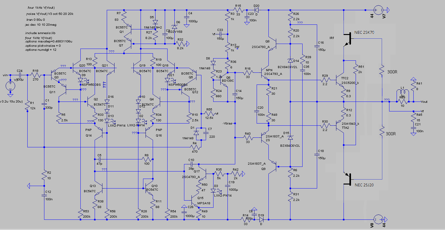

Hi Max,
minor point, but the objective of the BJT's is to keep the voltage across the FETs
constant to reduce capacitive effects. So the BJT reference should be the power rail.
That way it eliminates power rail noise or sag from affecting the FET.
I think this makes life easier as you just need a 10Volt zener and capacitor from
each of the power rails to set the respective BJT base voltage.
Also the MJ15024/5 devices are rather slow FT 4Mhz and low gain 15 to 60 compared
to the 2SC5200 / 2SA1941 pair (FT 30Mhz and gain of 75 to 150). So you need to
pick bias current carefully depending on which you use.
Symon

I am playing with the idea of a common-source output Amnesis, mixing the Sony and the Amnesis. Interestingly, this one could make a good phono/tape preamp with LTMD input. :cool:
The biasing is very tricky. My idea is trying later a Hagemann Vbe multilpier
instead.

Put a square wave on the input, and watch the current through R49.
You will see an oscillating behaviour in the lower part of the square wave.
Increase R3 to 150 Ohm, problem solved.
With a Miller cap on Q15 you can increase stability, but it seems to be o.k. without.
Hans

Yes. Thank you. It could be optimized (I made some mistakes) but for a first take it works rather good and should make a nice little amp.

This is the Amnesis common-source corrected. R23 is reduced to 68R as in the original.

See attached an updated Amnesis with bootstrapped VFET output, for the brave. Lower ranking Sony 2SK60/2SJ18 VFETs should also work here.
Edit: in reallity, all of them should work but at higher Vgsoff, I believe.

Further investigations showed:
The behavior is reproducible with this track but occurs only at a certain volume level ( with and without any output load).
The current across each of the both emitter resistors 0.22R raised to1200mV which is more than 5A.
The scope showed a heavy HF oscillation modulated by the music signal which only can be stopped by switching off the power supply
(a very short moment is enough).
The same behavior occurs sometimes when switching on the power supply with a load connected (no output relay with switch-on delay).
I tried many measures against this oscillation without any success.
Btw this problem also occurs with my first prototype board.
This problem does not occur if
- the output MOSFETs are replaced by a wire
- the input transistors Q3/Q5 (BC557C) are replaced by a p-JFET
(e.g. 2SJ103) which limits the bandwidth of the input stage so that the
rise time increases to 2us even without any input filter.
I never watched that a real music signal can bring an amp into heavy oscillation while
a 20kHz square wave (with a moderate input filter) up to 3dB below clipping does not.
For the moment I use the version with output MOSFETs and JFETs at the input for further listening tests and improvement.
Next I will populate 2 boards with the AllBJT input versions and probably in a first step the Darlington output stage.
Josi,
there are so many Amnesis variants, that I completely lost track.
If you could send the exact version that is causing you trouble, I can give it a try.
With a bit of luck I may find the cause.
Hans
In the mean time I finished my layout and ordered a small batch of 10 of PCBs
- to check the PCB quality which is excellent
- to verify if the layout is correct
First I populated 2 PCBs of the QUAD version with JFET input stage.
I discovered two short cuts which were not easy to detect but easy to remove.
I performed some stress tests (sine wave, square wave) which were similar to my first prototype. The amp worked stable with a tendency to overshot / oscillation when coming near to clipping. Unfortunately I there was no real improvement with the new layout.
First listening tests were promising. The amp worked stable even with high output power and the sound quality was good from the beginning.
with different kind of music.
Everything was OK until I played
The Ultimate Demonstration Disc from Chesky
Transient Test track 25 Royal March (Strawinsky)
After 9-10 sec. there was some heavy transformer noise
and I switched of the power supply immediately.
Dear JOSI1,
Again, great work from your side! :cool:
I do use speaker protection circuits in all my DIY amps. AND NTC thermistor in series with power.
I never experienced that but I seldom listen loudly.
It is strange, as you mention, that square wave test doesnot reveal potential troubles. Did you use gate stopper resistors for the bootstrapped input JFET?
I saw that different versions need or can use different R values for the MOSFET gate stopper resistors: between 10 and 130R...which in its own lets see that the amp is a balancing act...
In the meantime, and thanks to Hans' clever remark (you see I evaluate all your advices) that the R in my "charge-transfer supply" was jeopardizing power roof (BTW, it was reduced from 2R2 to 1R in power circuits) I began to question it and ended trying chokes in many of my power supplies. For example, my beautiful TOKIN SK180 single ended amp (which has caps for speaker protection :D) had a little hum (on the very sensitive Autograph clones and I am trying to see if this is due to a 20-30mV residual distorted sine on the PS line: previous to the mod, a 500mV sawtooth fed the power regulator. I built the biggest coil that would fit the tinny space that I had, with heavy gauge enamelled wire and iron core. Now the power regulator is presented with ony 200mV of gentlle sinewave and the residual is 5mV sine. :cool: I have not tested it yet on the big system as I am still enjoying the Sony there.
Then, my ALLBJT input amp is still fed with the faulty cheap SMPS that produced that periodic oscilation and perhaps you remember that I described its sound as "dirty"...I've collected many PC-SMPS over time so I picked some toroids and made some HF coils by soldering the 3 wide wires in series. Instead of the recommended extra C, now I have extra CLC :cool: The sound is much cleaner now, though I had not the time to test it yet with the scope. I find lesser difference between ALLBJT input and JFET input amps...

@Hans:
The attached .asc file is very close to my real amp.
Differences and modifications which did not solve the problem
are marked in red in the pdf-File.
Remarks:
Power Supply is +-32V
I do not use a coupling cap at the input since my audio source has a low DC offset <1mV
Changing the BC5xx transistors to your suggested 2Nxxxx types
does not solve the problem.
@Max
I use 330R gate stoppers for the JFETs and 150R gate stoppers for the MOSFETs.
What NTC thermistor (value, brand) did you use in series with power.
  • AMNESIS JFET.asc
  • Amnesis-JFET.pdf
