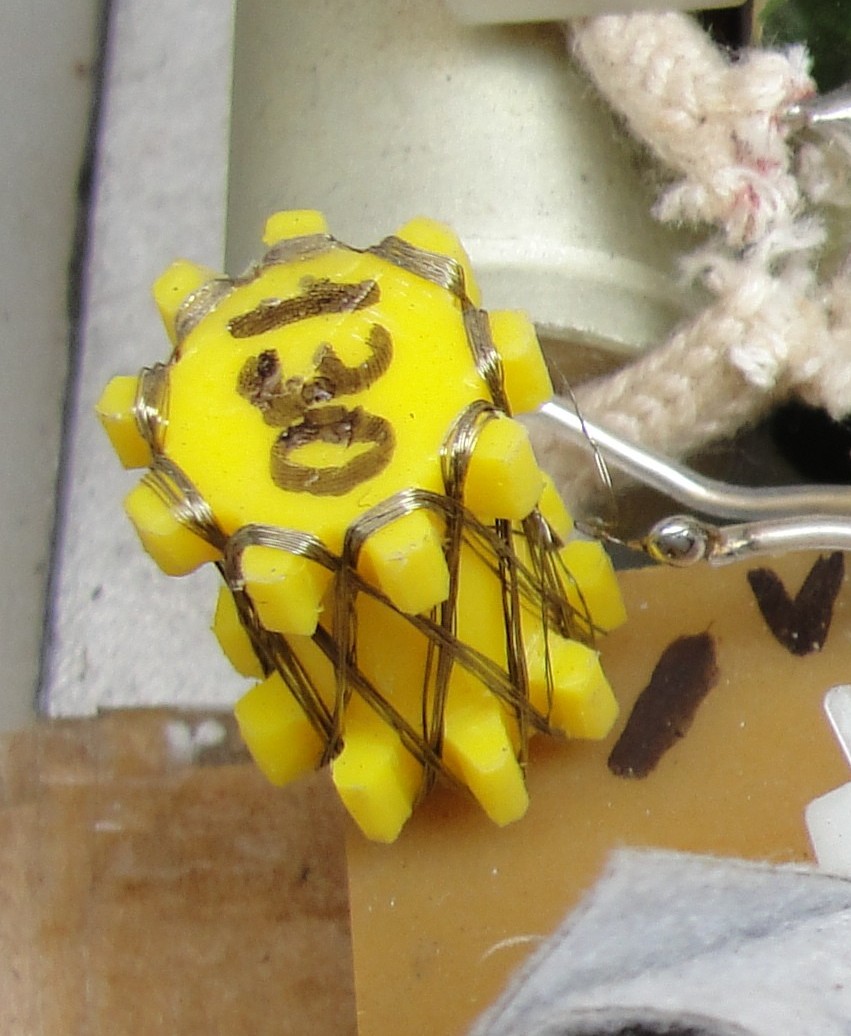

On the fun side, I made my first DIY resistors with a wire thinner than human hair; very difficult. I tried to make shoe-lace-like for lowest capacitance-inductance, but it resulted only so-so: 42 Ohm, because, once you cut it, that's it, you cannot go back. I did not try them yet. I have another thicker wire that I can put in a former to make a honeycomb arrangement. See attachment.

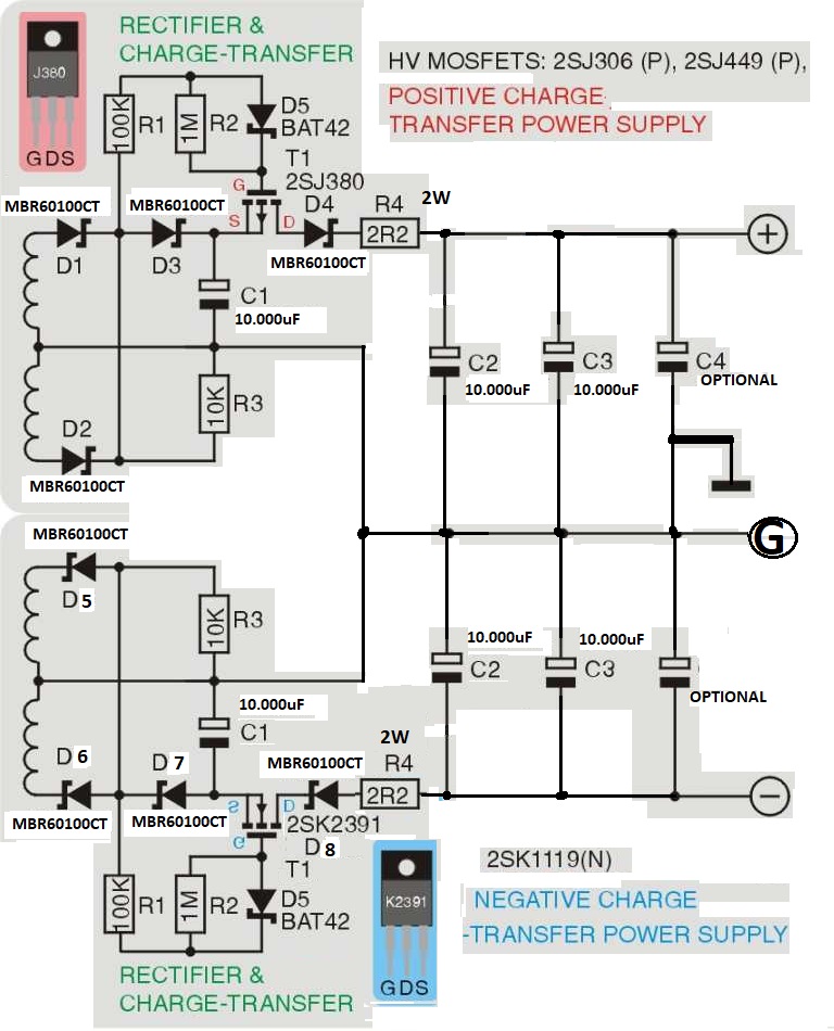

As always, I recommend the "charge-transfer supply" from -ECdesigns-, with upgraded devices for higher power. Any advice on possible improvements for this circuits are welcome. 🙂

Max,
Regarding your Charge Transfer supply I have the following:
The idea to isolate the power supply from mains during the charge time is great, it will help to block noise on the mains and stop sharp peaks caused by the rectifiers from entering the power supply
So far so good. But this will only happen with an ideal switch having no feedthrough capacitance.
So select Fets with the lowest output capacitance to diminish this effect.
The other thing is the 2.2Ohm resistor, although good for filtering, seems quite a bit.
With 50 Watt into a 8Ohm speaker, voltage drop would almost be 14 Volt !

Thanks Hans. You are quite right. :up:
This circuit was intended for low power DACs and I upgraded to high power to feed my UCD amps (ClassD= very efficient), then, due to good results I blindly kept using them for my Class AB amps...maybe 0R3-0R68 should be better? Or none at all...
Next time I buy MOSFEts I will have to remember to look for low output capacitance... 🙁

I think you can discard the resistor completely.
The mosfets come in very gentle and switch off the same way, like a variable resistor. No need for extra resistors IMHO.
You are referring to Class D UCD amps. I'm curious to hear what your opinion is in compare to your Amnesis, mainly because you are a classical music listener like myself.
