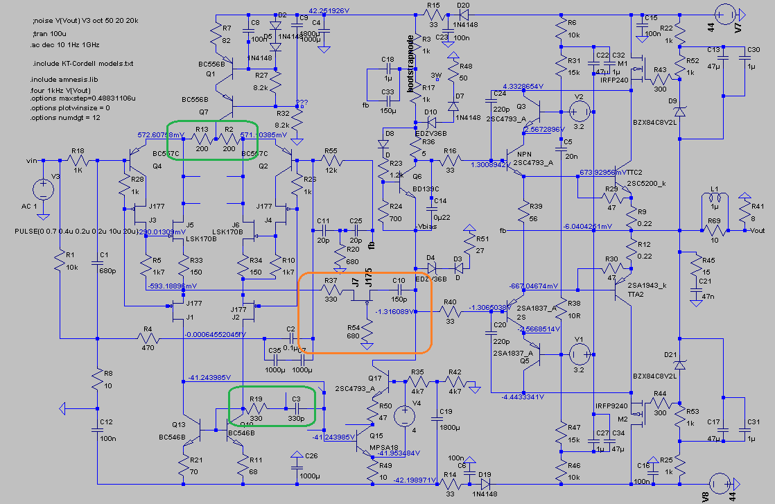

The Сap comp of Miller limits the spectrum for the next stage, and the RC phase twists approximately in the range of 25-60 degrees at a frequency corresponding to its time constant, and the entire over spectrum goes to the next stage, if it does not have enough frequency properties, it simply turns the phase and the result is positive feedback.

so it’s not so difficult - one of the rules is that, a compensation capacitor in parallel with the common NFB resistor - you can immediately say that the amplifier is overcompensated, and that this is very bad for the sound, due to the complex nature of the real load.
What I constantly see in this topic are models with such a compensation capacitor - it becomes sad....
Hi guys,
The other day I stumbled upon a video explaining "Cascode Compensation" and it was very interesting...
I made some simulations with a "double cascode Comp." and it improved the safety margin (a lot, in my unneducated POV), at the cost of slower response and lower BW.
What do the Wise think about this technique?
M.

Hi Maxlorenz and everyone else,
It is always interesting to improve Quality with suitable solutions.
Since I have "embraced" a full-balanced Circlotron with a Sziklai finite structure and negative output resistance - I use the recommendation of Willy Studer and Rupert Neeve.
This means: Medium-power (driver) transistors at the input and preamp with enhanced Class A to eliminate Memory Distortion!!
The amp is now LIVE and I can post the schematic - if there is serious interest....
With respect
Trifonovaudio
