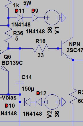

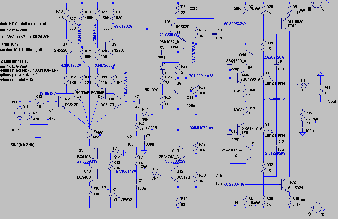

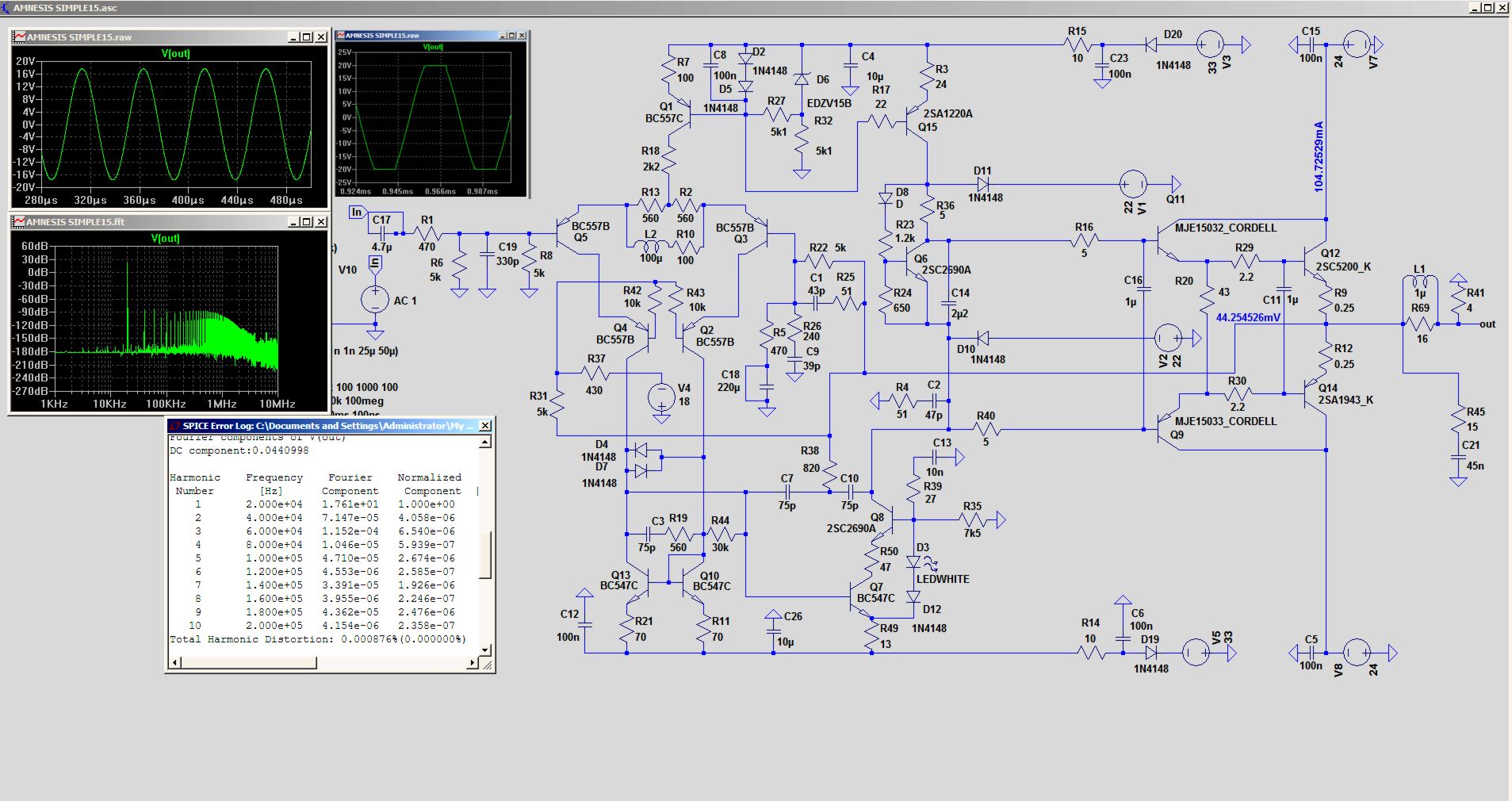

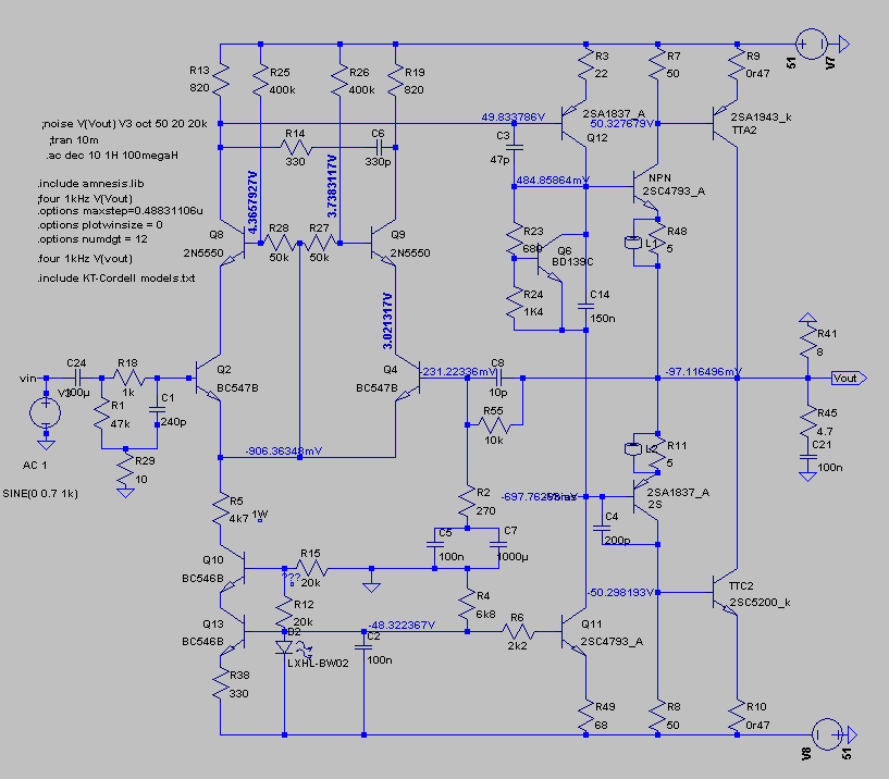

Hi, Maxlorenz! Please try this scheme .
It is necessary to solder two diodes each.
  • AMNESIS SIMPLE3.asc
    AMNESIS SIMPLE3.asc

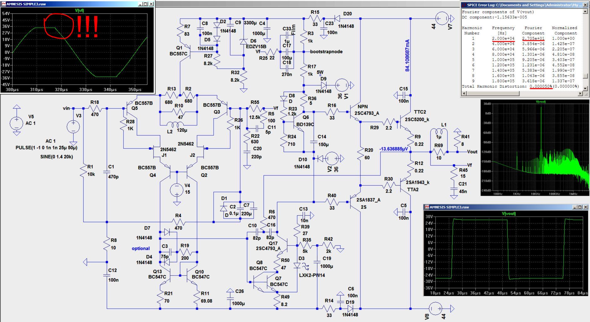

Thanks, dear Printnik for the many advices.
Dear Hans Pollak adviced us before of this overload protection circuit and it seems to be better with a small R in series. It should improve stability in trade for headroom...I suppose using a lower V source (like a 33V zener) accounting for the reduced V supply expected at prolonged musical peaks would be a responsible move...I confess I have not tried it yet because I do not torture my systems at all: I use moderate/high volume levels.
Maybe someone will try your version which has nice THD. Maybe later he/she would be inclined to test the LTMD/CFP input version of it, which degrades THD a little but should bring the taste of the experimental amp. Mine are sounding cristalline and clean as good tube amps but with the precision and control of modern solid state amps.

Hi Maxlorenz !. These diodes - D4, D7 reduce the gain of the differential cascade during overload, and this reduces ripples in subsequent cascades. They also reduce voltage drops on the collectors of the differential cascade. But in this scheme, this effect is not very pronounced.
Great. Thank you. I'll implement them.
I will try to figure it out.
M.

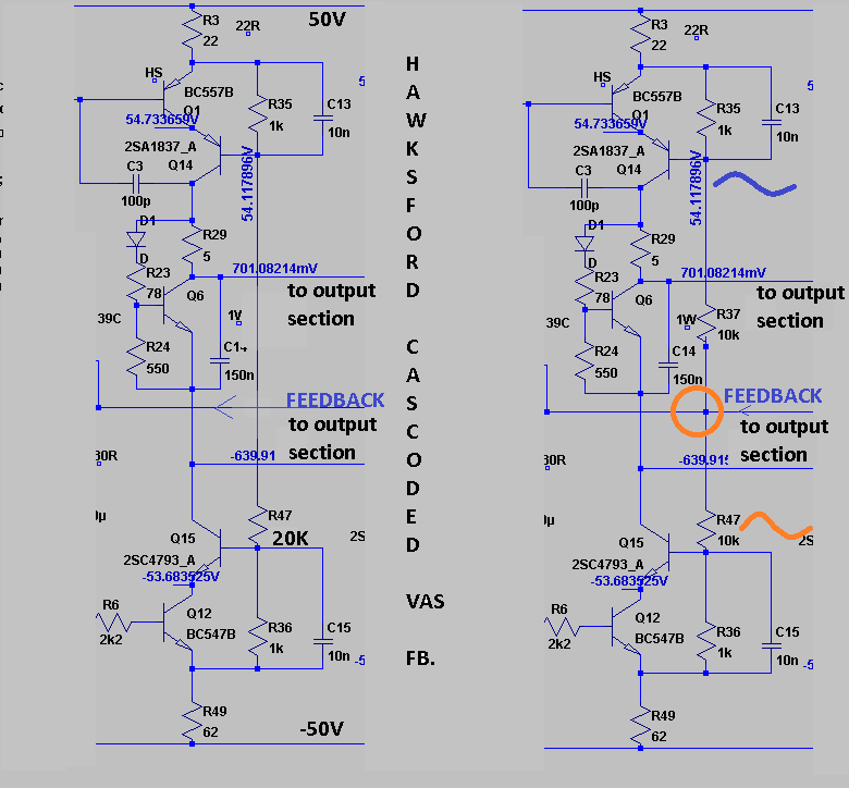

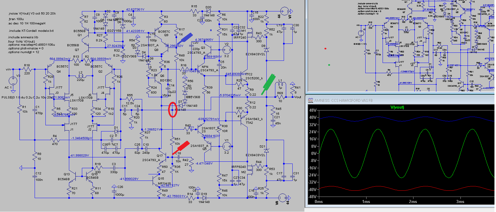

First: I've been studying the Hawksford FB VAS (read as trying to understand how it works) as improvement for the nice AMPSLABS C200 SIKLAI (which usually improves THD by one order of magnitude) when it ocurred to me that I could introduce positive FB to it from the output, comparable to the Bootstrap for the Bootstapped VAS AMNESIS....THD improves in some but not all versions but the curves...the curves look all nice....😀
Then, I made a fast drawing for revisiting the AMNESIS with CCS Hawksford FB VAS: good for experimenting....you know I like positive FB....
  • AMNESIS CCS HAWKSFORD VAS FB.asc

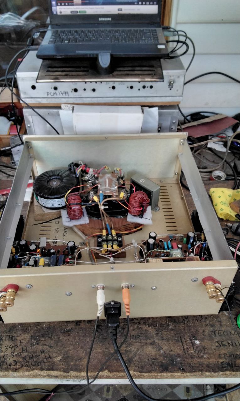

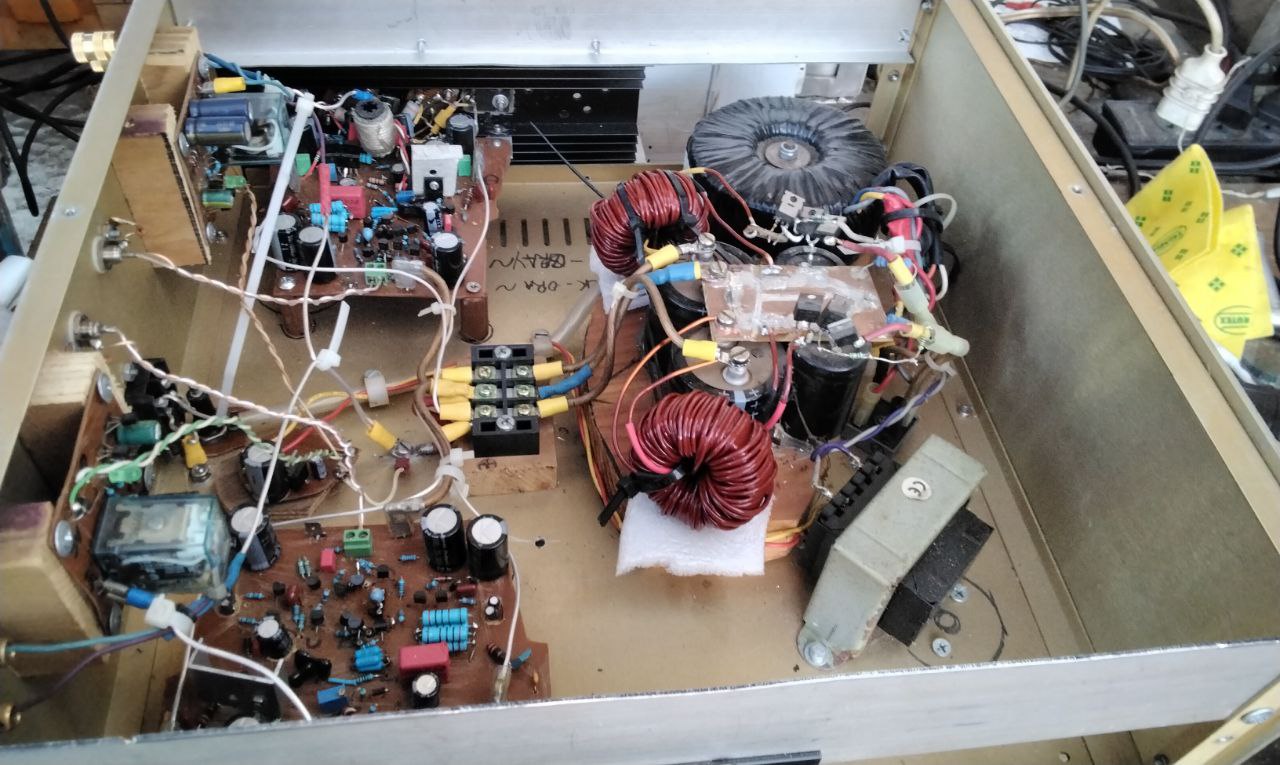

Second:

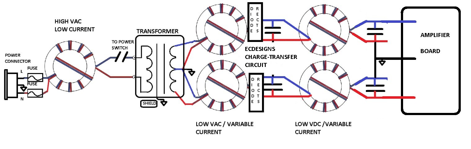

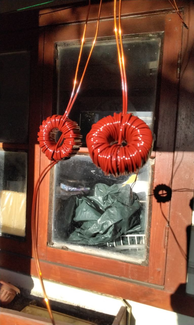

AMNESIS gets a Baluned PS!
I will not insist on this wonderful discovery of mine. I simply will show you what I am doing, for now on.
I bought some big ferrites from China (1Kh to 300Kh) and a Pro Varnish good for 150° Celsius and 4700V or so, in order that moderators DO NOT close this thread or eliminate this posts...no I'M joking: in order to reduce or eliminate any risks. L = 47mH; interwinding C = 970pF. 57 turns for each rail.
The effect of this Baluned (especial CLC) Power Supply is Yuge!
The biggest effects are in bass- midbass output, dynamic contrasts and overall power perception, it makes you want to reduce the volume setting from the TVCs.....As I wrote elsewhere, the "Bifilar Current Reisert Balun" probably gets its effect by balancing currents bewteen (power Rail versus Ground; differential mode) and Inside the wires, reducing skin-effect and group delay, appart the HF effect that is probably more easy to understand, with reduced noise floor and increased detail...but I am not an expert....by "treating" also the ground currents, it cancels the main criticism of ECdesings "Chrage-Transfer" supply.
The example shown lacks the balun for the secondary windings for the TX, which may be not needed...I need experimentation to confirm.
M.

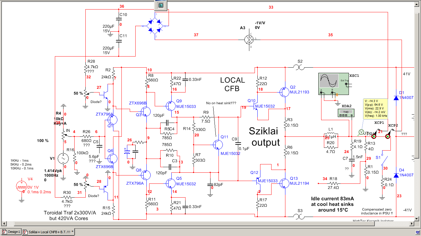

Hi Maxlorenz and all "active" DIY users!
I had almost given up on research in my favorite hobby.....
The idea of the better amplifier was my "return" to work:
Full balance (Circlotron only!)!
End structure CFP (Sziklai)!!
Negative output resistance - via positive FB!!!
And all with BJT Transistors!!!!!
From the input to the final powerful transistors - only medium power (for drivers). No small ones - for low power.....
My "revival" came after "desperately" good initial results from simulations with Multisim….
If there is interest - I will share the Lively Finale!

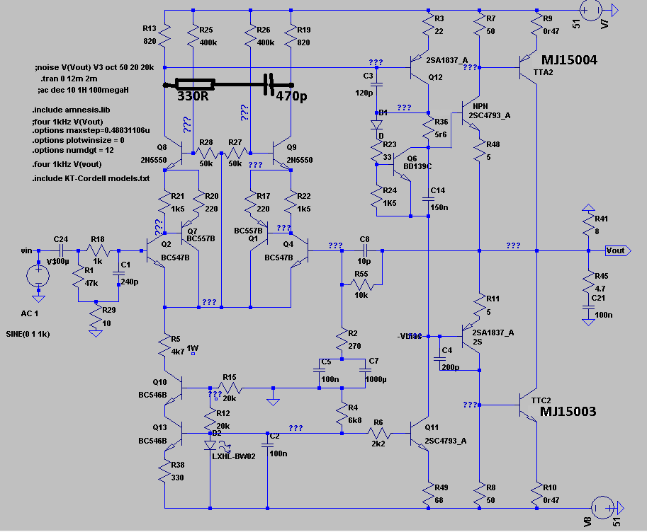

Hi guys,
I have to comment about a little problem I had with the modified Ampslab C200 Siklay: I could not reduce bias current under 90mA which to me means low level oscillation. I swapped the outputs for the MJ15003/4 which are the recommended BJTs by the inventor, Mr Chua. No effect. Then I added the RC mod for the long input pair--> that allowed me to reduce I bias to 20mA. I went into tests with no increase in T° nor in I bias, so I got cruel, increasing stress, until, suddenly as it always is, the magic smoke went out: I fried all the output circuit from one of the channels....now we confirm why Siklay outputs are not that common....
Back to the board. I thought about simplifying the input from cascoded CFP to simple cascode and adding ferrites to the emitter's resistors for the output CFP drivers'....just to end with a working amp, without going back to the stock amp, which sounds good but not as good as the LTMD amp...
I attach the schematics of the unstable amp and of the next step to try and stabilize it.
Soon, more news.
M.

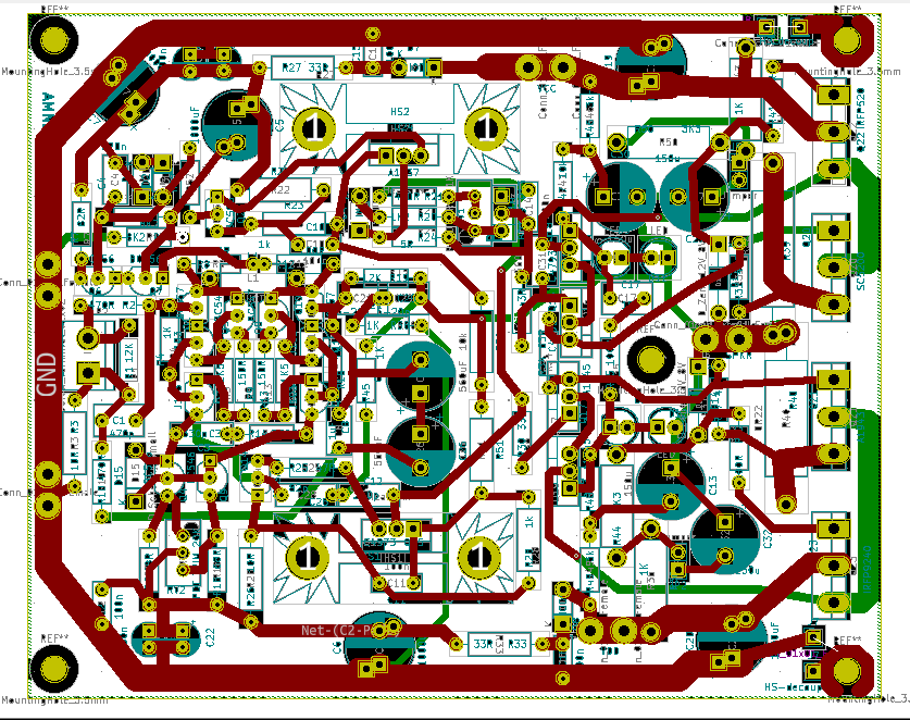

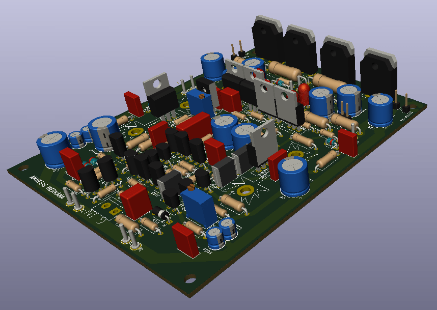

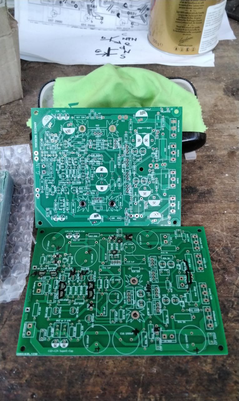

Good news:
I decided to test the Hawksford FB CCS (again) but with proper PCBs....and they just arrived!
I put there the many "upgrades" that I love to add...I did it fast. I will optimize it later....I hope there are not errors.
I will test it, as soon as I finish with my many other experiments.
M.

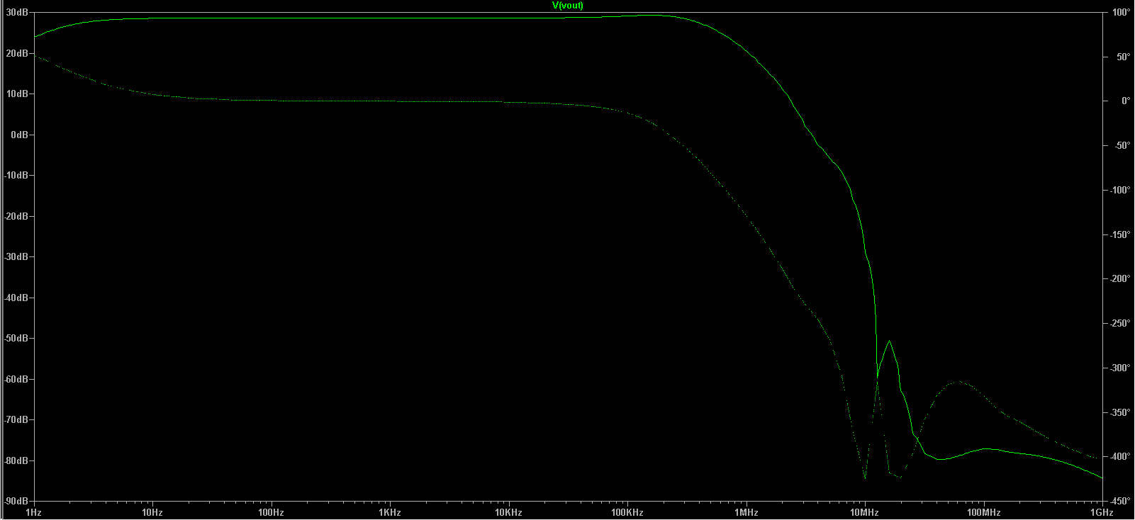

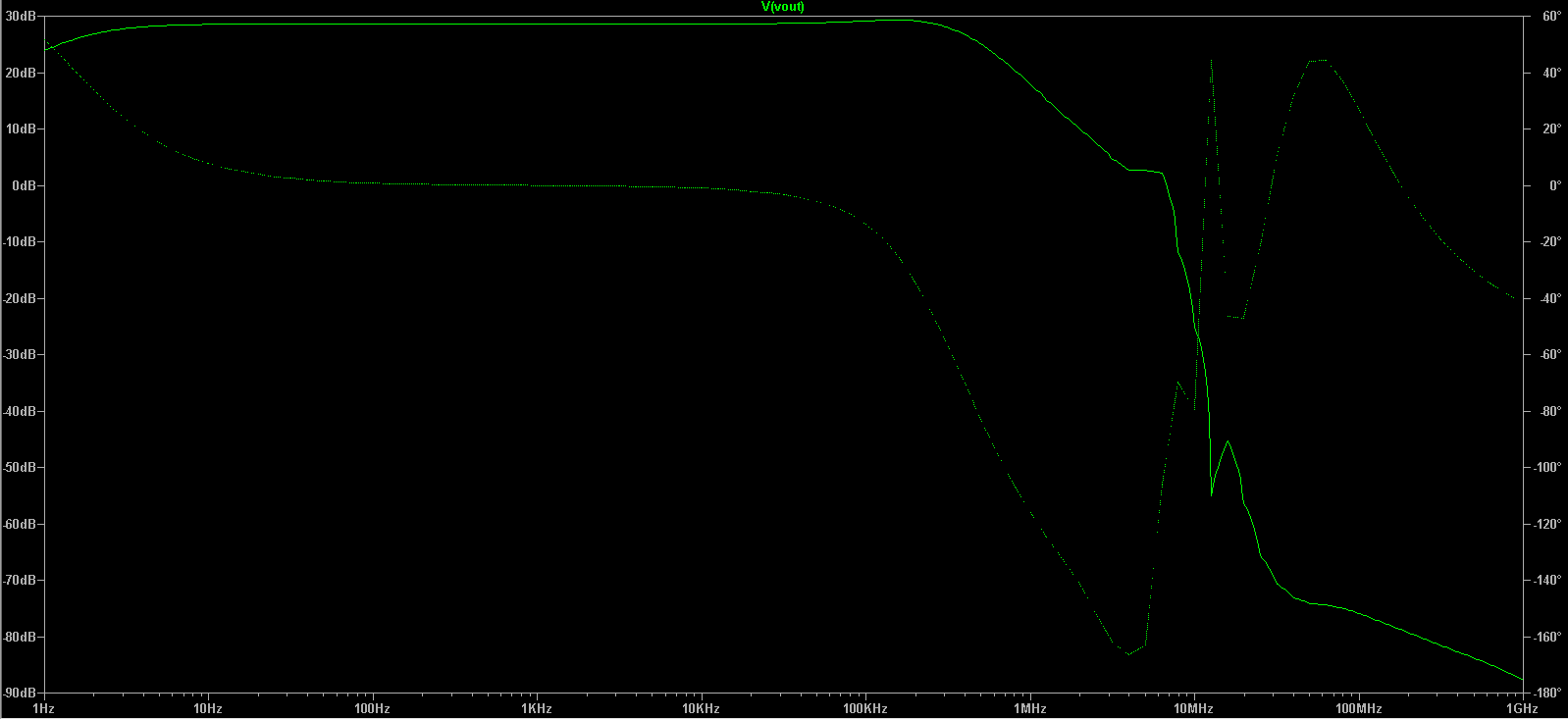

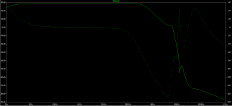

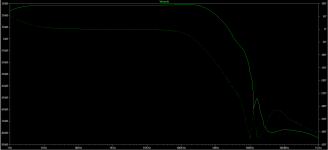

Hi.
I noticed an interesting and puzzling effect when transforming a simple Miller Comp Cap. into a C-R subcircuit....I present an example of Cm= 82pF and Rm= 1K...the phase response is totally different (from my last strategy) and from 3megaHz up, it goes upwards and even gets positive, avoiding getting near -180°. The nearest it gets is -166° at +3dB though...😕
Any opinions are welcome.
I also attached a conventional response....closed-loop....
M.
What's the mystery? The Сap comp of Miller limits the spectrum for the next stage, and the RC phase twists approximately in the range of 25-60 degrees at a frequency corresponding to its time constant, and the entire over spectrum goes to the next stage, if it does not have enough frequency properties, it simply turns the phase and the result is positive feedback.
