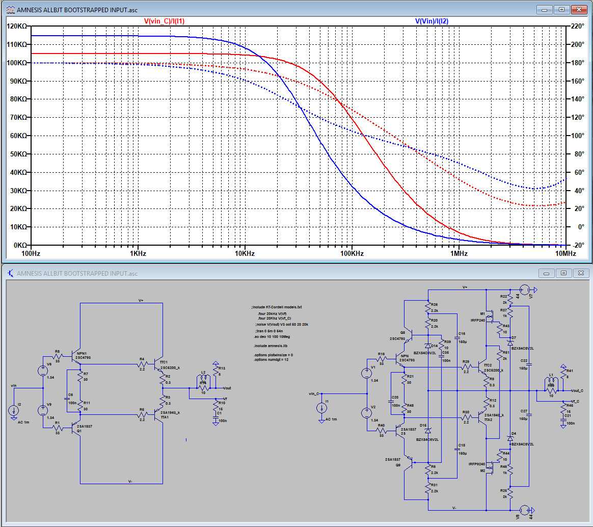

Max,
I had a closer look at the cascoded OPS.
I compared with a non cascoded version, using for as far as possible the same components, still using the 50Watt@20Khz test as before.
First of all I tried to find the optimal Quiescent current. For both versions this was at 125mA, giving resp 0.017%/Cascode and 0.022%/Straight.
When going to 75mA Quiescent current, THD20K became resp 0,047% and 0,037% or +8dB and +4.5db. The cascoded version proves to be a bit more sensitive for the right adjustment.
Next I measured the input impedance of both versions.
The straight version has a slightly higher LF impedance at 115KOhm versus 105KOhm for the cascoded version.
However as can be seen in the image below in red, the cascoded version has a significantly higher BW, which is to be preferred.
I could not find any effect caused by C36 and R39, which can be both omitted to my opinion.
As a conclusion: Cascoding the driver of the OPS, results in a better HF load for the VAS, which in turn leads to less distortion helping the Amnesis to become a top performer.
Hans

Dear Hans,
I don't know how to thank you for all your interest and energy invested in our little project. You find me in a personal low, though, with much real life interference, exhausted and with only one week ahead to summer vacation...it is hard for me to envisage complex re-organization of the circuit. For that, I simulated a quick and dirty version, with errors as you pointed out, and, as now I realize, with a fishy behavior on square wave test...trying to debug it proved hard.
I fully understand all your advices and the rationale behind them but I find it hard at the moment to grab the energy and time required to proceed to the orderly modification and testing of the circuit, especially when I consider the present state of both versions to be fully satisfactory in musical terms (I may be positively inclined to a certain amount of distortion and "dirt" 😀 ) and that my primordial concern was not THD in the first place...
I was hopping that the "first edition" of the amp gained enough acceptance to motivate enough people to investigate further and develop a more refined version, which I confess, may be beyond my limited capacity...I feel already payed by having a working amp, which sounds nice in addition. 😱
In the following days I plan to do easy tries:
1) Look for my "improved current sources" article and try to find the best CCS I can for the input section.
2) Try the EF VAS again...
3) Cascode the bootstrap for the bootstrapped input section 😀
I am glad that you analyzed the output section also. The present configuration of the "QUAD" was selected only in sonic terms as it seems not to limit the benefits of the putative LTMD organization of the previous sections, in the aspects of transparency and dynamics, which are my main goals, as I always repeat...
If you have time, can you analyze the Darlington output on post #468, which seems dearest to JOSI1? 🙂
Gratefully yours,
M.

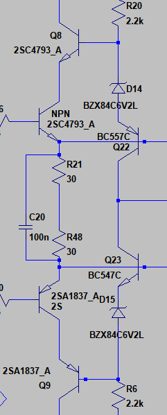

Hi Max,
As in your previous version, Q11 and Q12 have a Vce of 0Volt and cannot function as transistors.
The biggest advantage of your two stage OPS is the cascoding of the Drivers.
The Darlingtons in #476 do not have this cascoding, resulting in a higher Vas loading which is an absolute disadvantage.
From a THD point of view, cascoding the drivers seem to be much more important as cascoding the output transistors , but I have no idea what is does to the sound reproduction, a thing that cannot be measured with LTSpice.
Hans
Hans

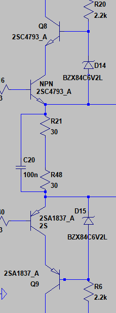

Hi Max,
Oops! I must stop working on a hurry...
In my only experiment, which lacked inter-emitter resistor, there was some wanting of easiness to the sound, by comparison to the QUAD. I wish I could find a medium power MOSFET to make a cascode arrangement for the drivers similar to the output...
Hans

Hi Max,
as Hans says cascoding the drivers is important in terms of reducing the load on hte VAS, this was covered in Dr Arto's book, although he considered it only nessecary to cascode the driver and not the Output device as well. But as always listening testing is what counts, and I recall you reported sonic advantages to the use of mosfet cascode.
As with the input stage, driving the cascode devices Q8 & Q9 from a voltage referenced from the drivers emmitter terminal will improve things. see attached drawing, although I've not checked all the effects of this, one problem here is that the boot strape current from R6, R20, R26 & R31 directly affect the bias setting.
Or perhaps again stealing from input stage, buffer the cascode reference voltage as in my second attachment. the nice thing here is we don't need high voltage devices and they are not exposed to large voltage swings.

Dear Max,
I don’t doubt for even a second your impression that changing the VAS transistor changed the sound perception.
However I find it hard to understand how one single transistor could have this noticeable effect.
Therefore my question: do you still have an old transistor radio.
This is a perfect tool to detect HF oscillations in the Mhz region without invading or loading the amp and if not excludes that HF is changing the perceived sound.
Hans
Hans

Input stage
I'm working on a combined layout for the JFET and AllBJT input stage.
There exist several versions for the AllBJT input which are more or less complex. It's not possible to cover all the versions on the main board. The complex versions which are not perfect yet and subject to change must be shifted to a daughter board.
I tested successfully the proposal from Hans (post #475 using only BC5xx transistors) with my test amp.
@ Hans: Why do use 3 LEDs for D1/D2. Simulation shows the same result for THD when using only one LED.
The latest proposal from Max/Symon (post #488) differs completely from proposal (post #476).
@Max: Is proposal (post #488) your favorite now.
Simulations show that the voltage drop across the LED/Diodes is
very critical for the functionality.
When increasing the voltage drop D16/D11/D13 to increase Uce for Q11/Q12 the simulation does not work.
Is it advising to use LED LXK2-PW14 which is a power LED (Vf=3.6V @350mA) for simulation.
Which components did you use for D9 and D16/D11/D13 in your test amp for listening tests (the LEDs used for simulation are not suited for a real amp or hard to order).
Beneath providing solder pads for connecting a daughter board I'm looking to find AllBJT versions that can be placed on the main board.
One candidate is the proposal from Hans. Max do you have another proposal which is not too complex.
