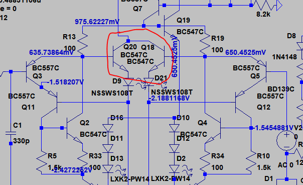

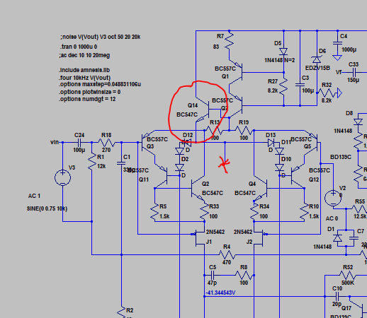

Hi Max,
the circuit is looking a lot more stable now, something that concerned me
about the bjt cascode version, is the ground reference for Q12 and Q13.
I realise you might consider the modification below boot straped but the intention is to accuratly cascode Q3 & Q5. So terminology apart, the modification shown below simulates very well from distortion and step response.
And should make the input better able to handle larger signals.
I await to see your views on this.
Regards
Symon

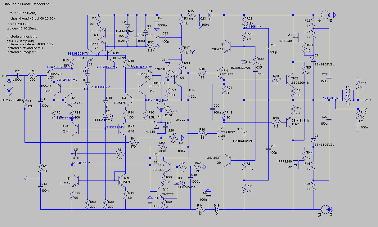

Hi Max,
the most critical parts of JFET based inputs is J1/J2 (2N5462) because they determine the DC operation points. When replacing 2N5462 e.g. with
2SJ103 and 2SJ74 the simulation does not work due to horrible operation points that are displayed when stopping the simulation.
Since the 2N5462 is hard to get (only SMD version MMBF5462 at Mouser) a suitable replacement should be found also for simulation.
Furthermore the production tolerances of the JFET have to considered when used in such a critical place.
Btw: What has to done to display the DC voltage in the simulation schematic (blue bold lettering).

Wow! Good idea, dear Symon. I'll start experiments ASAP.
Actually, bootstrapping might sound better (positive feedback) but is potentially less stable.
Please download Hans Pollak's amnesis.lib
Right click on the node and choose "Place .op Data Label" (red 88) to view the voltages. But, how to reduce number of decimals???
The J1J2 problem: with ALLBJT version (now to be modded) you can set easily the voltage and operation points. J74 cannot tolerate high PS so it is only good for inside-FCP function, which BTW is sounding oh, so good. 😉
My J103 work OK at least on 32V supplies and my batch set source V to -2.3V in both my amps.

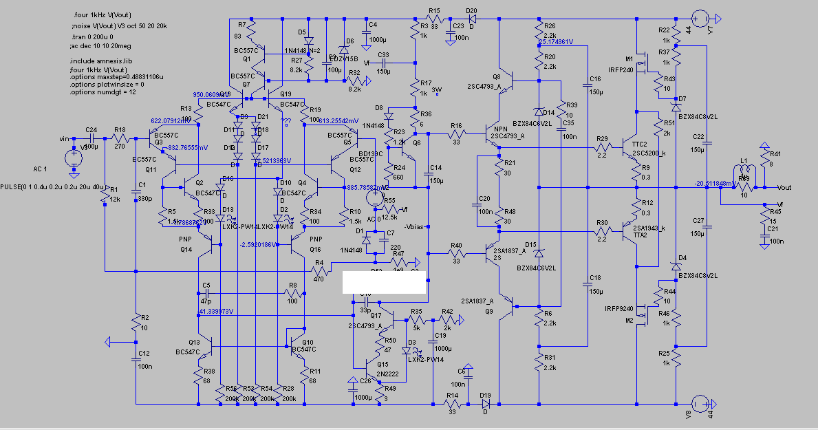

Dear Hans,
Thanks very much for the complete and useful explanation. I remember this was recently exposed in the "CFA, not-only..." thread. What distracted me is that some experiments show better square wave behavior (large signal model) than the predicted from Bode (small signal model) so that puzzled me. 😕
My test amp with the last Miller compensation you proposed has been stable on the few hours I have been able to listen to it on the test system. It sounds nice but won't opine about it yet...
Here goes one possible implementation of the ALLBJT input amp. The square wave test is OK even with 20p Miller. The voltage references for the current sources can be set with any system for example initialy a pot to set the preferred operating points which give the best sound or numbers (Hephaïstos proposed very low Vce values for the input pair) and once established those, other less noisy devices, like diodes or LEDs, alone or in combination, can be set. This is the cheapest way we can go.
I know you guys can better my ideas, so I will wait for your critical revision of my humble efforts. 😀
For now on I will trust more the brute force large signal square wave test.
M.

Dear Max,
There are schools that propagate that the loop gain should be flat from 20Hz to 20Khz.
This is easy to achieve with the latest Bipolar/Fet version, because open loop gain is high enough.
When placing 500K in series with 100nF parallel to the Miller cap, the gain of the VAS will be linearized and reduced, but because of the feedback through this 500K, distortion will even drop.
In the images below you see the Loop gain in blue and overall gain in red.
Left image is as-is. The low frequency drop in loop gain is because of the used Bootstrap.
Hans

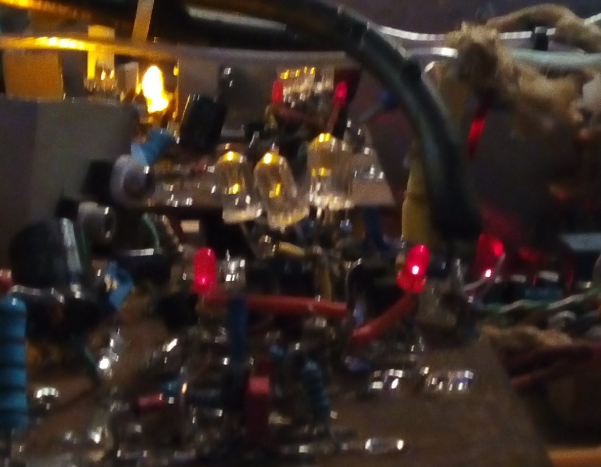

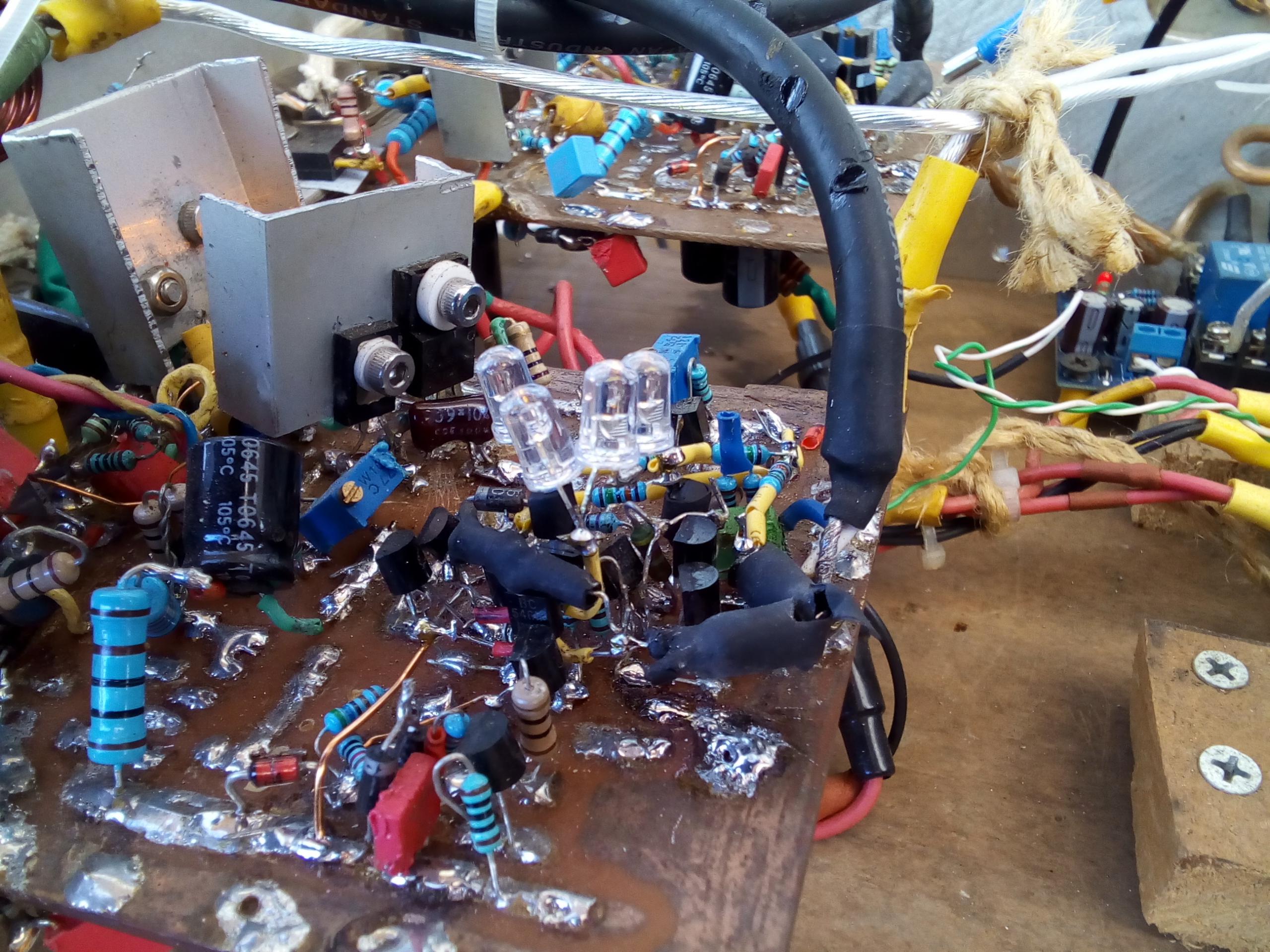

Dear Hans
I am sorry to say that the "linearized VAS" trick as tested on my "cascoded with BJT-CFP input" (39pF Miller) will not be part of the official recommendation. Maybe when 20pF arrive I will change opinion...
It surelly has an obvious effect on sound. The music became more ethereal, more relaxed, with good openness. Some sounds that were mere ghosts became more intelligible. Unfortunatelly, there was a significant drawback in one of the salient features of the Amnesis: loss of dynamic impact. The violence was lost. The concentrated energy of the plucking and of the smashing was not there, a mere facsimile, a cupon, a sophistication. No emotional transmision. As I have talked before, this may have to do with a smearing of the sound energy in the time domain which perturbs the "sound envelope" and precludes the brain to perceive the information as real sound from real instruments...in parallel there was a lost in mid-bass energy, which may or may not be cause or consequence of the former...as usually heavy on the bass amps sound to me "slower" and this is not the case here.
I had not the need to try the "47pF-100R" between Drains trick though it seems to help stability. Both tricks will remain as optional for experimentation.
The good part is that now my amp is running with 39pF Miller as is so far stable. 😎

Hi Max,
Regards
Symon
Dear Symon, guys,
Yesterday I found the time to perform your clever bootstrapping idea. It is really a fast an easy mod.
The effect on sound was totally unexpected: while the mid-bass and dynamics are comparable with the previous standard, the sound presentation became very laid-back, making the standard look very upfront and aggressive (the violence I talked about) by comparison; the detail and highs are there but recessed.
The voltages look OK and it is so far (few hours) stable. I don't know, maybe I need to reduce the CS resistor...
THD looks decent but I cannot make the square wave test to work...😕
Anyway, I don't know if I like it as it is now. Maybe I will perform my ALLBJT input mod sooner than expected.
M.
ALLBJT first channel done 😎
With two yellow LEDs. I might replace the diode string with one (red) LED.
I saved two JFETs 😀
They sound almost the same to me, though it is early.
This set the possibility to go to 60V supplies and parallel outputs for macho power.
I'll keep you updated.
M.
Edit: oops wrong file...
Edit2: the bootstrapping NPN can also be cascoded with base between Q1 and Q7...
I saved two JFETs 😀
M.
Done. Red led instead of 3 rectifier diodes as Vref for the first bootstrap. Might not be perfect but is easy. Listening tests to follow.
M.
Hi dear JOSI1,
Sorry. Too busy to post lately.
The ALLBJT INPUT bootstrapped amp (latest Symon's idea) is delivering the goods. It has the transparency and dynamics attributes which makes it an Amnesis amp. It should be considered the equivalent of the BOOTSTRAPPED JFET-CFP INPUT. The sound difference is subtle: the JFET is a bit more focused and images are denser; the BJT version is a bit more expansive and images are a bit softer. Without direct comparison there will be no complaint.
The red LED replaces with advantage the 3 diode string as Vref for the bootstrapped PNP's base at input. It should give -1,3V to ground for 32 to 44V supplies. With -2.1V to ground I got a simulated square wave output with 60V supplies, thought I have yet to try parallel outputs.
With two yellow LEDs I got -3.2V Vref from lowest bootstrapped PNP's base to ground. As I said before, experimentation with different values of Vref and different resistor values (of high quality) is encouraged for optimal function and sound.
LEDs sound better than diode rectifiers: more "continuous", more legatto sound, if you know what I mean...
As they carry low current, low power LEDs can be used in the input sub-circuit, with less real estate use...
I am very pleased. 😎
I can't wait too hear your opinions on my (our) humble creation.
M.
PS: bootstrapping is the way to go IMHO. Making a stable amp with each stage bootstrapped, meaning with positive feedback, is a small miracle on itself, don't you think?

Hi Max,
Good to hear you are getting good results.
A slightly more elaborated version of the input circuit is shown below.
This should get closer to the JFET version, as each BJT cascode is now driven directly from the emitter signals, and not the common signal from the pair.
Anyway, something to think about and maybe try.
Symon
