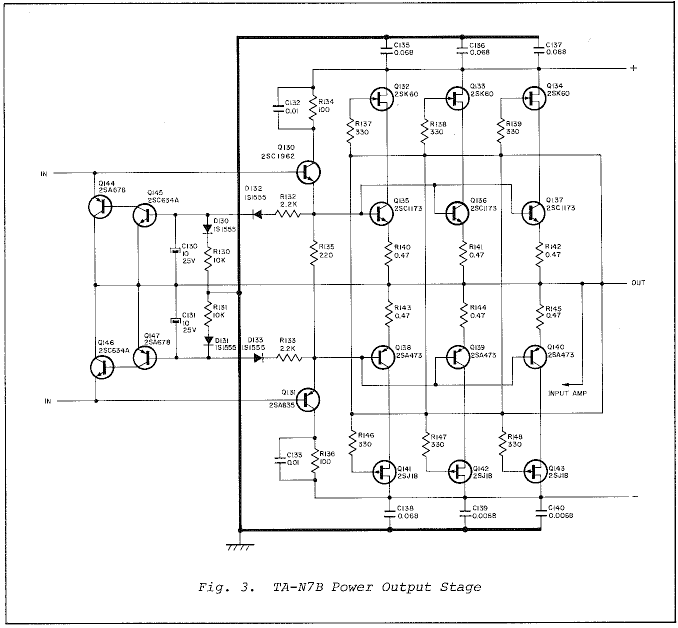

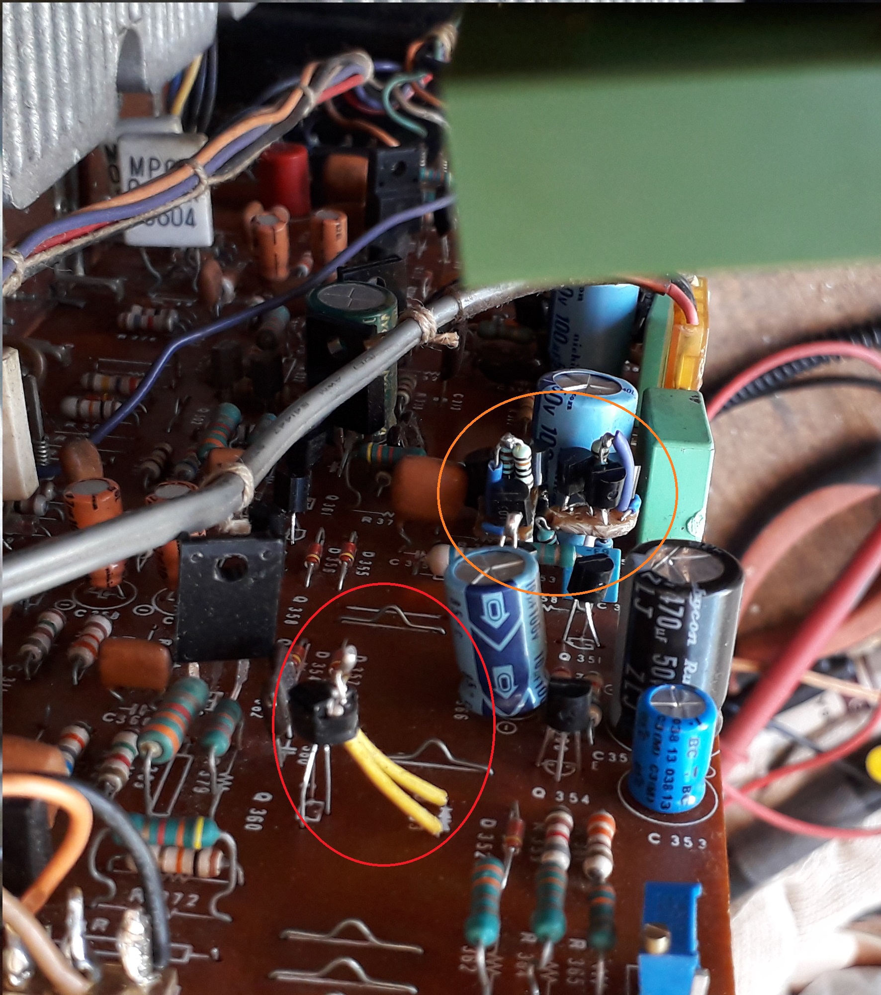

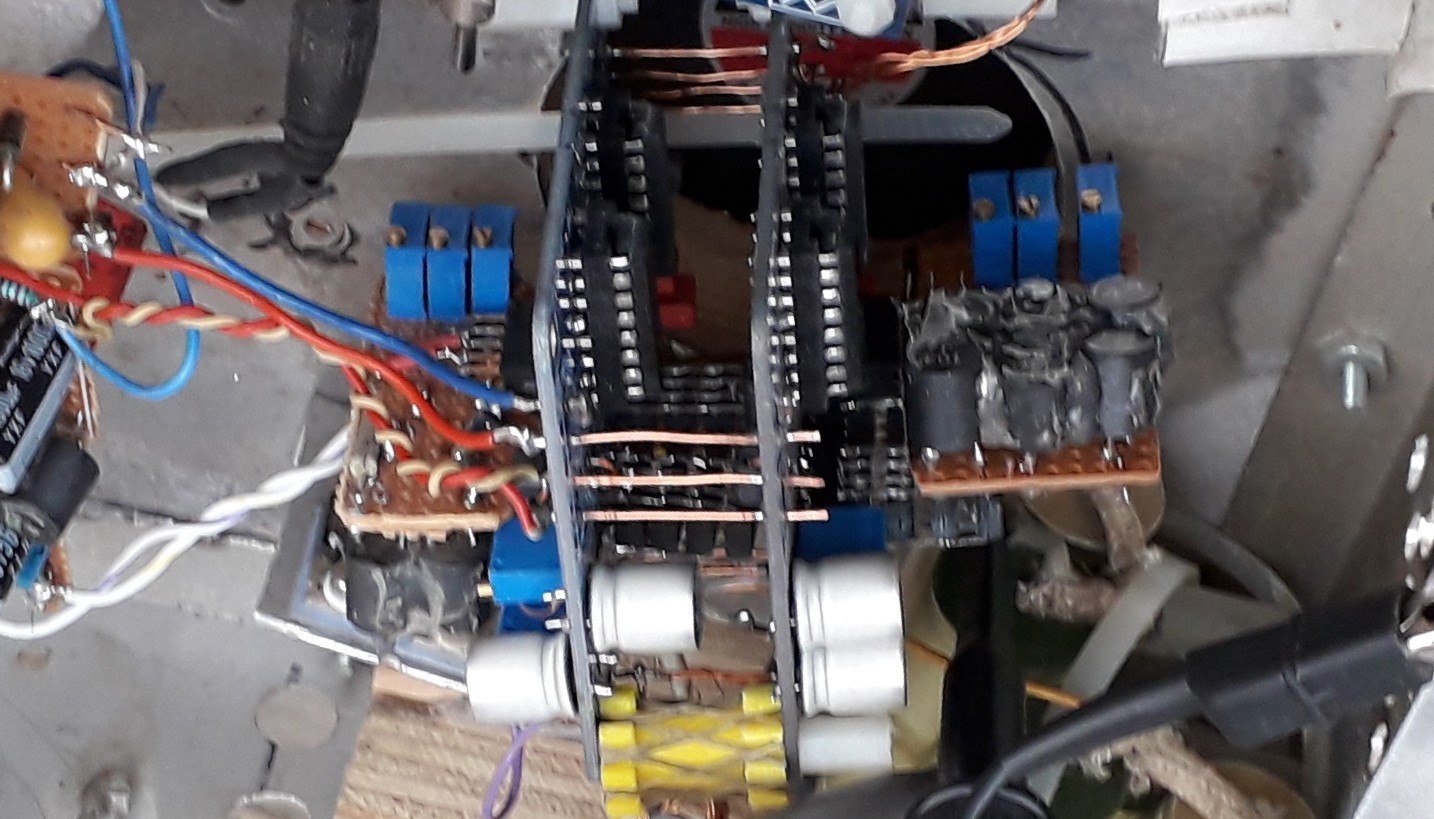

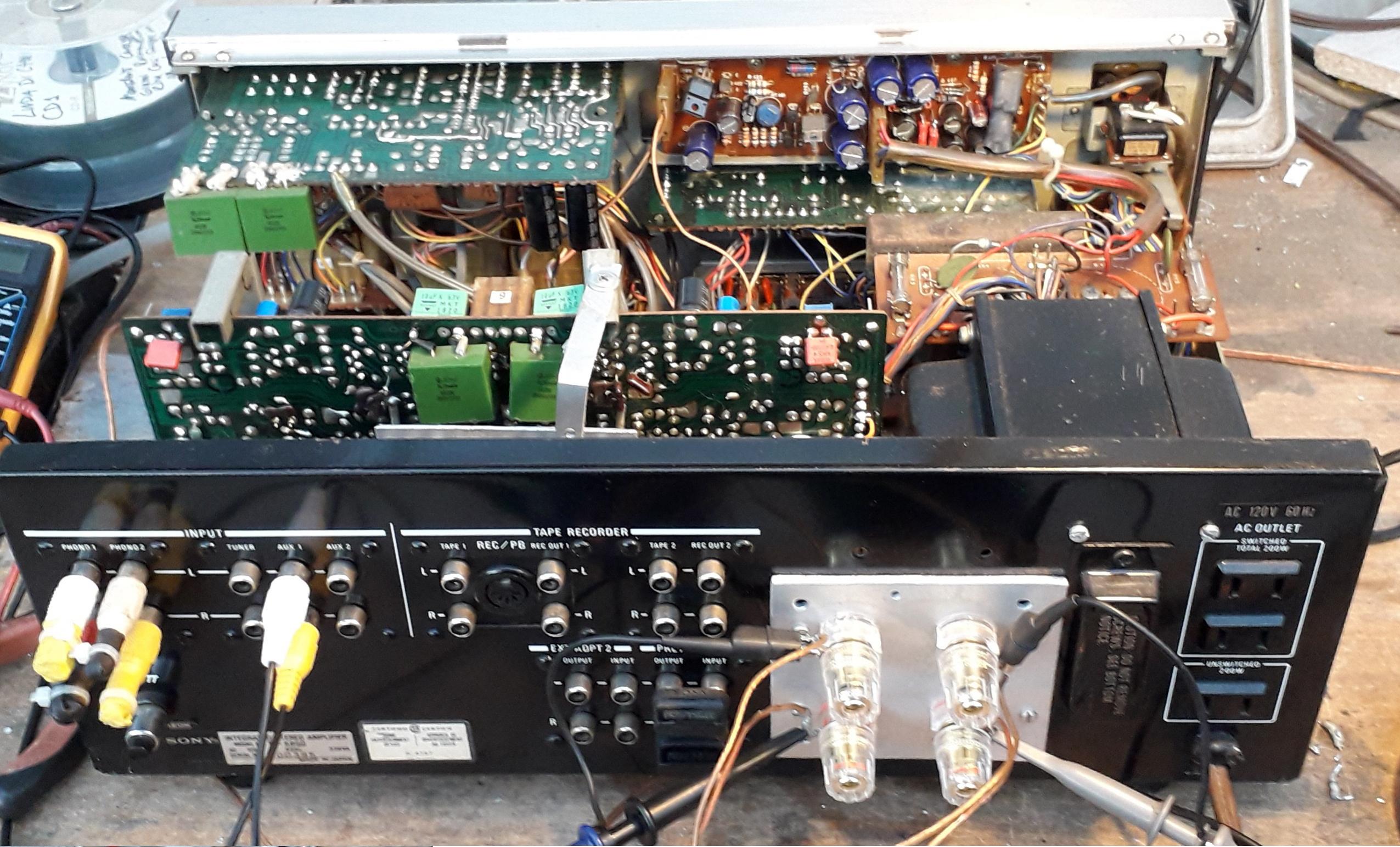

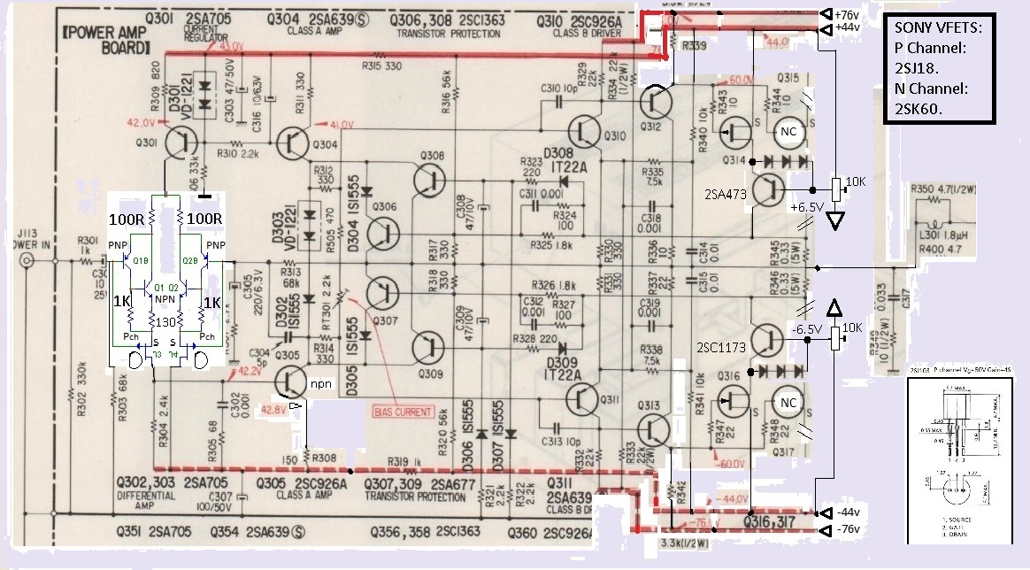

Allow me to hyjack my own thread.
Dear all,
For those who are thinking, why is this guy always talking about the VFET bootstrapped output??? Perhaps you never had the joy of listening to a VFET amp...🙁 VFETs have a delicacy, a crystalline quality, much like tubes, which cannot be equaled by other output devices, IMHO.

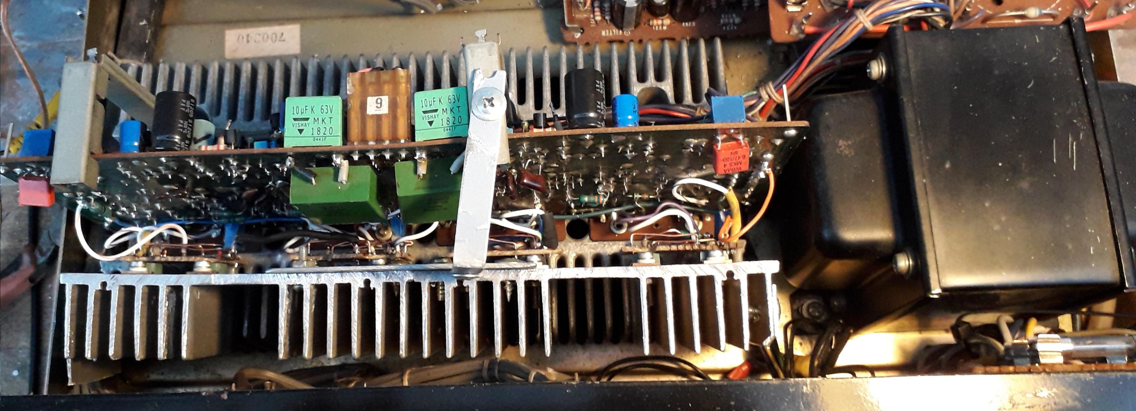

I have the luck to own three of these amps, one of which is a glory of the golden age of Japanese electronics, namely the SONY TA-5650 amp which I bought for pennies as a non functioning unit. My gamble succeeded as all the 8 VFETs were good, and after much repairing and modifying I finally tested it: one channel good; the other, oscillating.
I then tried all the advices published on the net (safe one, I confess) to no effect.
Then I postulated that the common-source arrangement (predriver-driver-output) as it was, could be forming a Colpitz with the capacitance of the bigger and slower VFETs being the culprit. So I decide to try and cascode the output (yeah, I know I am mono-maniac) to bring the resonant freq. much upwards...it worked.
Now I am considering improving or changing the output, as I have some MOSFETs, but being a coward as I am with this jewel, I will again abuse of your generosity by posting here the present stage of the amp to seek your advice and comments.
Questions:
1) is my diode string redundant, from a bias POV? In other words, will the voltage on the emitter set itself with the biasing pot as it is? Since the current is set by the common-source VFETs...
Now the Vce is under 8V, for these low SOA transistors, which BTW, are the same the flagship TA-N7 uses, though in common-collector arrangement.
2) if I swap the output BJTs for the MOSFETs IRFP9240/240, will their sources set themselves to a +4V and -4V, respectively, compared to their gates???
This question is related obviously to the former and makes evident my lack of basic knowledge...only empiric I have...
I understand I can reference the pots to output instead of ground, to form a true bootstrap, like in the case of the Amnesis, at an increased risk of oscillation...talking about which, I must mention that the other potential cause of oscillation which I must address is the one caused by the zobel injecting HF into ground and then transmitting it to the input, on a susceptible layout, like this one, pre-software era, seems to be. In this case it is recommended that the R-C zobel, be connected after the output R//coil, in case of said oscillation.
This was the most demanding project (even bigger than the Amnesis) so far, due to the fact that repairing and debugging is much more difficult than building...my deepest respect to technicians :worship: who have to deal with these problems.
I hope you like my crazy story 😀 and thanks in advance.
M.
PS: I forgot to mention that it has the "first generation" LTMD input mod. No space for more complex mods...though I must cascode the input CCS at some point.

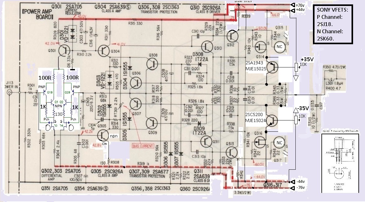

Questions:
3) I understand I can reference the pots to output instead of ground, to form a true bootstrap, like in the case of the Amnesis, at an increased risk of oscillation.
4) I must mention that the other potential cause of oscillation which I must address is the one caused by the zobel injecting HF into ground and then transmitting it to the input, on a susceptible layout, like this one, pre-software era, seems to be. In this case it is recommended that the R-C zobel, be connected after the output R//coil, in case of said oscillation.
Max,
Let me try to answer in the best possible way starting with:
3) The pots Must be referenced to the output, or else the BJT will be shut off above Vout>+/- 6.5 Volt, but it seems as if there was a second pair of Vfets that you removed , why was that ?
And why did you insert the two BJT's where now all current has to flow through, BJT's who aren't suited for the job with only 10 Watt each.
2) Replacing these BJT's by Mosfets can be done, gates to the output signal, because the Vfets determine the amount of current that will run, so they Mosfet's will bias themselves to this current.
1) I do not understand your question, but I also don't get why you are inserting BJT's or Mosfets in the first place. The original Vfets are supposed to do the job of driving the output.
4) It is very important to have the feedback signal properly routed, preventing to pick up other signals from within. Sometimes a wire in the air will help.
Also very important is the point where the feedback signal starts, This should be taken from the final line going to the Amp's output.
As for the grounding, this comes also very critical to keep the signal gnd at the input as clean as possible, but much has been published about the subject.
When everything is well done, I don't see how a Zobel network may reduce stability.
5) The other thing that strikes me is that this amp has no Miller Cap, possibly making it more difficult to get the amp stable.
Hans

Max,

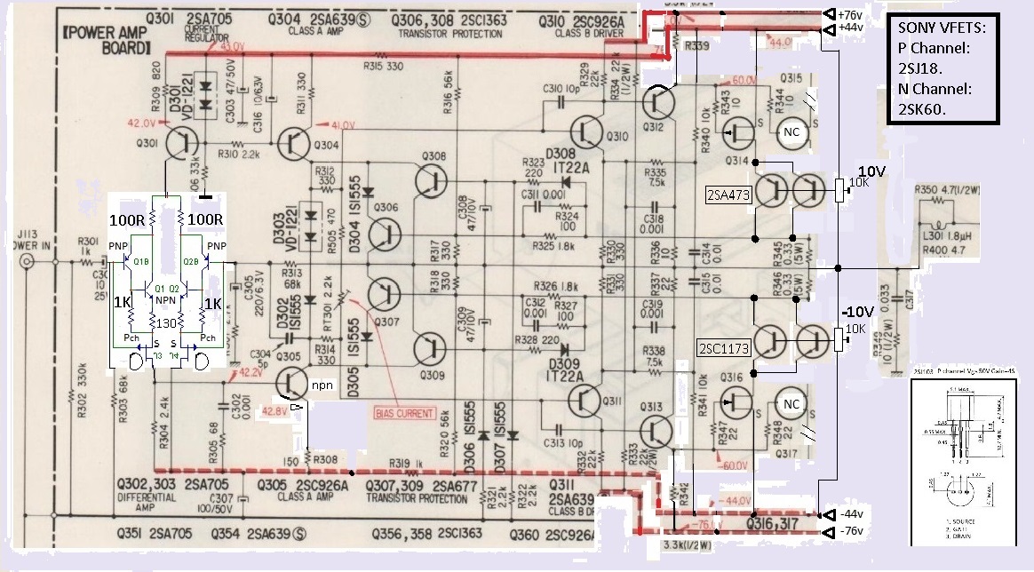

OK. That move, pot-to-output, is easily done.
Maybe I don't see the clipping because I drive the amp very gently...
As I tried to explain, inserting the BJT in common-base was intended to reduce Miller (and Early?) effect...I chose these low power devices to be a life-guard to the VFEts: they shall blow before the former in case of malfunction, or that was my idea. The next move was supposed to be higher power BJT (or MOSFETs) with the pot biased at, lets say +/-35, to reduce VFETs' Vds...but I never reached that stage of the plan: the Amnesis was the priority; every time I mod this beautiful amp, I suffer 🙁 anxiety and fear.
For example, yesterday I opened it and answered my own question 😀 about the diodes (which are on the wrong direction in the drawing BTW; +/-7,5V was in reality the base ) and the probe slipped over 😱 and something went awfully wrong! I thought I had fried one VFET, which, as you may know, are made of unnobtainium, but no, it was a little BJT that was fried.
Oh, and I am using now only 4 VFETs: that way only 4 are at risk; I have 4 extra VFETs for other projects
Thanks! :wave2:
That's what I thought but was too coward to test it. 😀. I could set the Bias to +/-21V with a Zener, That way the VFETs and the MOSFETs would share more or less the same burden.
As I tried to explain, my thought was that the triple with common-emitter output has feedback that can form a Colpitts oscillator, with the capacitance of the VFET, the bigger unit, being the offender. So by reducing that capacitance the resonance point will be shifted upwards. Am I right? 🙁
BTW, I have the intuition that these common-emitter/common-source output amps sound inherently better than the common-collector/common-drain ones...but are much difficult to design.
The FB is properly taken, IMHO.
It is my understanding that the zobel can inject HF noise into the "ground" and if that this "ground" is not properly routed, as seems to be the case here (I won't post the PCB not to overload you) it can contaminate the input...
I am inclined to believe that it now does...
Hans

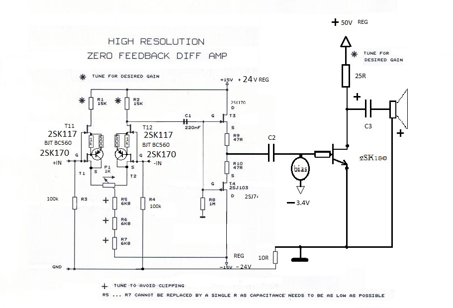

I have great results with summing my LTMD differential input section to my single ended class A Tokin SK180 amp.
I have all the needed parts (safe PSs) to make another, bigger, amp with this configuration but with THF51 TOKINs. When I finally make it will post it and you will see the size of the box! 😎
In other words: only "Low Thermal Memory Distortion" amps for me, thank you...whatever that means 🙂

O.K., now I understand what you were aiming at, reducing the effect of the Cgd of the Vfet.
However, the gate from this Vfet is driven from a very low resistance with a low voltage swing, so I have no idea whether this will sort any effect, other than adding an extra pole in the equation. Often less is more.
But with enough phase margin will it be possible to add a BJT or Mosfet in the Vfet's drain, but in that case with a much higher fixed voltage for the base (or the gate) , like 40 volt, and not be tied to the output in that case.
With this marginal BJT that you have now, you can't do that, you will need a real power device.
And with the protection circuit installed, I see no reason why you should be afraid of frying a VFet. You can even set the tripping points a bit sharper to start with.

Here, some pics about the present state of the SONY TA-5650, while I rest and plan the next move.
I recorded a video with my portable phone but it does not sound good...I will try to make something better...
M.
PS: I forgot I opened an exclusive thread for this but failed to update it...

Hi Max,
What you've done makes no sense.
When wanting to reduce the miller effect of the Vfet's, the drain should be kept at a fixed voltage, which is only the case when the external pots are connected to gnd.
In the current set up the drain moves with the same voltage swing as the output, only reducing the power consumption in the Vfet's a bit, but that is most likely not necessary.
So first try to let the thing work without the added BJT's in the output stage until you are happy with the sound.
At a later stage you can always extend your experiments.
Hans

Maybe, 😀 I've tried it both ways and now I am doing listening tests. It does not sound bad at all. When I'll upgrade to big power BJTs, I'll tie them to ground, as you recommended.
As I see it, now the BJTs are fed with signal from two pins.
In a perfect world, I would attach a switch to swap from one to the other option and try to discriminate if the "sensical" option outperforms the "wrong" one 😉
We can explore options based on an hypothesis from the accepted model but sometimes we could find unexpected results...that makes experimentation fun. Or, we can be totally fulled by our own expectations.😀

Hi Max,
I agree with Hans, I'm not sure where you are going with this circuit.
If Connect the 10K pots to ground and not to the outout as shown, then
the BJTs will cascode the VFets, but it will limit output to +/- 10volts.
I observe the cascode BJT's are only rated at 10W each and have a Vceo
of 30volts so youc can't increase the voltage very much, perhaps 14V as a
reasonable max voltage or the BJTs will self destruct near clipping.
As Shown the BJT's are operating within safe limits, apart from running in
parallel without current sharing emitter resistors isn't a reliable way to
double power handling.
Anyway, an interesting experiment, just watch the limitations of the
devices.
Symon

Attached is the future plan for the Sony. I am exploring a "common-source Amnesis" project 😎 also, just for fun.
Chhers,
M.
Chhers,
M.
That looks much better.
The BJT's will draw quite some base current, so it may be wise to also put caps to gnd.
Isn't this a fantastic hobby ?
I'm anxious to hearing your listening experience.
Succes, Hans

Yeah, I will use the pot just to find optimal operation point and then maybe zener//cap to PS with a big 1K to 2K resistor to ground...and then swapping to output?
I have to see what is better, if cap to PS or cap to ground. Potential difference will be smaller from base to PS...
Hi Max,
minor point, but the objective of the BJT's is to keep the voltage across the FETs
constant to reduce capacitive effects. So the BJT reference should be the power rail.
That way it eliminates power rail noise or sag from affecting the FET.
I think this makes life easier as you just need a 10Volt zener and capacitor from
each of the power rails to set the respective BJT base voltage.
Also the MJ15024/5 devices are rather slow FT 4Mhz and low gain 15 to 60 compared
to the 2SC5200 / 2SA1941 pair (FT 30Mhz and gain of 75 to 150). So you need to
pick bias current carefully depending on which you use.
Symon
