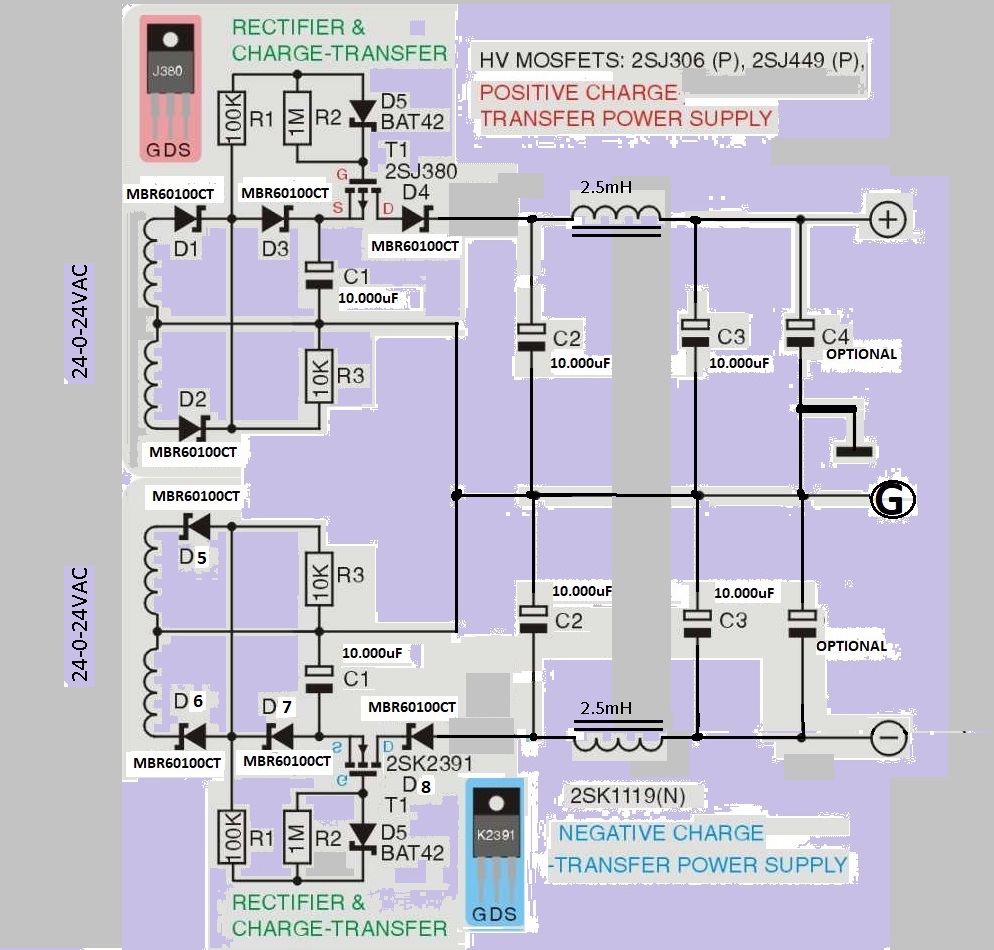

The last experiments were made to the power supplies. The amp has not been modified, but I received yesterday my N2222 BJTs for the VAS to be compared to MPSA18 (and BD139).
The CLC supply is trully amazing. The amp sounds now even more relaxed, fat and textured. Not like any solid-state amp that I know. I uploaded a clip: see my signature.
I am upgrading my very old crossover filters (AMT-1 monitor from the 70´s), something that should have done time ago 😱 😱: hard wiring, bypassing jumpers, pots, selectors, better binding posts and changing capacitors in the HF section, just the left one for the moment...it is a complex series-parallel XO with high value caps...
Now I am listening to some Brahms trios for piano.
I attach the "official Amnesis power supply". Of course you can skip the charge-transfer part if you so wish. I will probably try that myself someday.
Only the lasts capacitor should be high quality: the previous could be normal heavy duty caps. Perhaps the improvement in sound comes only from increased voltage (32 to 42V) but I doubt it. I suspect the choke has something to do with it. Could it be related to "reactive currents" (apart the ripple effect) related? Those misterious reactive currents...😕
How did I made the DIY choke?
I took a couple of empty teflon tape formers (25mm internal diameter; 25mm wide +/-) that matched with an iron rod that I happenned to have. 🙂
Wind it with a Variac plus power drill machine to reach the desired turning speed...for the enamelled copper, I tried to match the secondary's width: 18G or 20G, I am nor sure...
For the SMPS a much smaller coil is needed between the extra caps. Mine are 0.3mH or so, if I remember correctly.
M.

For many years I use an external CLC power supply (10.000uF-> 2mH
->22.0000uF) and I like it. Maybe I should reduce the inductivity.
Great to hear. I am late to the party, then 😀
