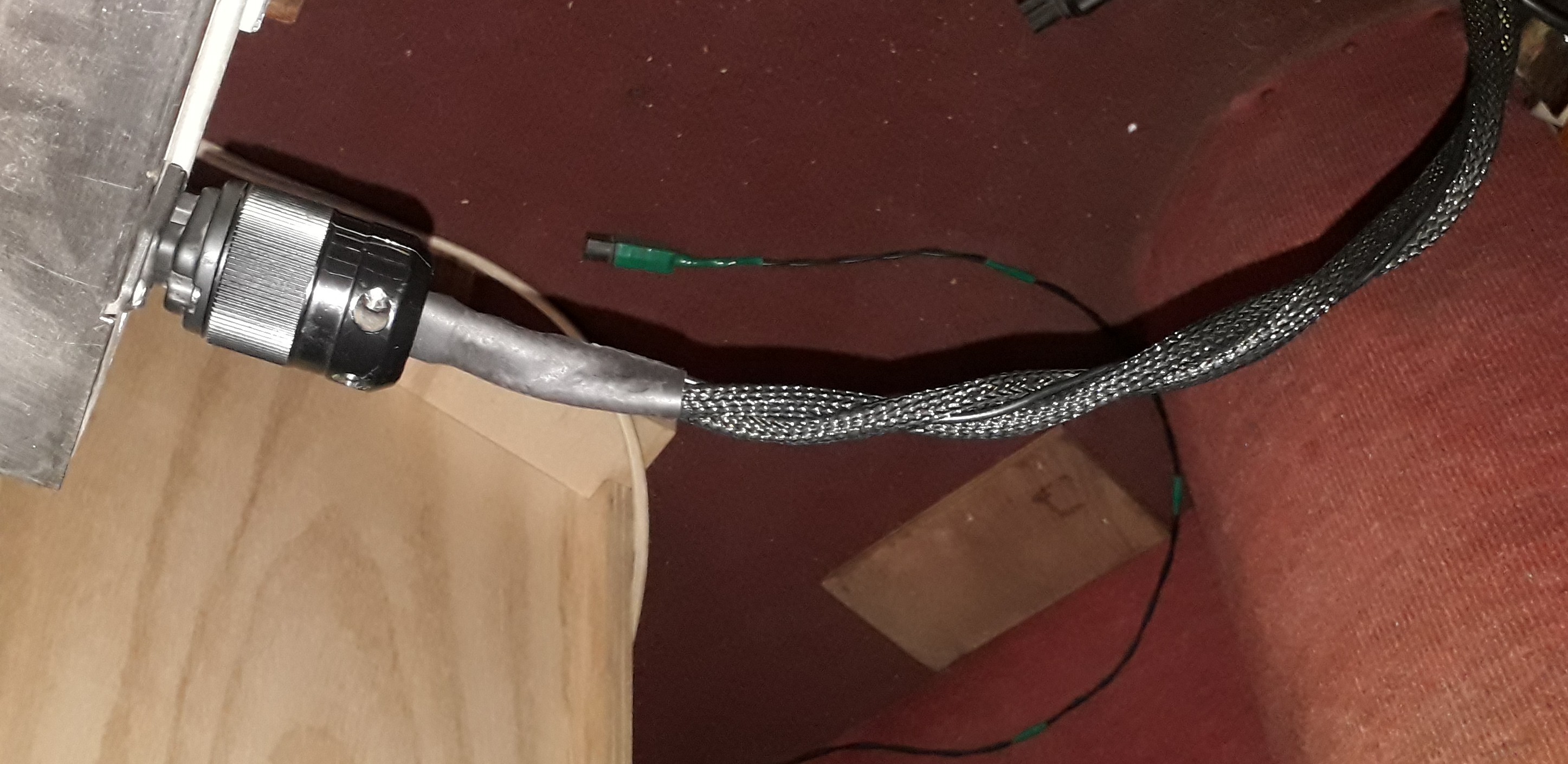

I forgot to show my new upgraded power cord for my SD card player plus TDA1543 DUAL-MONO DAC, with 12awg solid core OCC copper surrounded by 3 wires of silver plated OFC (aerospatial grade) 22AWG winded in counter-rotation on both active leads, imitating the expensive example given by LC . The ground lead is (almost) straight. Noise floor went down and the picture is more orderly but colder now, IMHO.
Sorry to insist with these horrible videos...I think the cellphone not only distorts the highs but it also fails to catch the low bass. :(
YouTube
Oops! It is twisted. :eek:
Ha, ha!
M.
Should try the same power cord for power amp too.
Phone's mic is not so bad, freq resp is the least of a problem, compressor-limiter is the one to blame. This is the one taken by mine.
Yours sound good. Seems iPhone does it OK. Mine is Samsung something: the only requisite I asked my wife was to get me something for free :D
