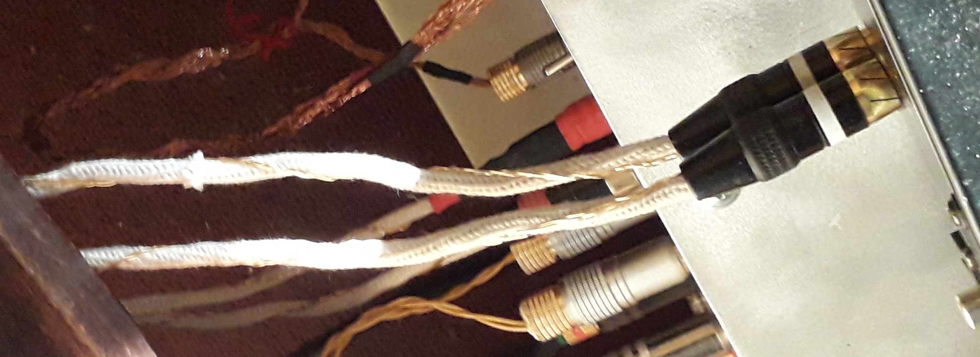

50µm is _massively thick_ gold plating, ten times more than "heavily gold plated" connectors. I think you mean 0.50µm plated.
50µm on AWG (radius about 200µm) would mean that 33% of the wire is gold (increasing the average resistivity of the wire somewhat!)
Indeed, I found the business card that states the 0.50um (0.5um) plating.
The wire is quite good. It has an organic and truthful sound and lots of bass amplitude and extension from a tinny wire. Brass instruments sound phenomenal. It allows the punch of the Amnesis to express itself. I braided 3 wires per side and it seems good enough.
I am thinking of using it also as internal wiring for my amps, apart from interconnects, that is.

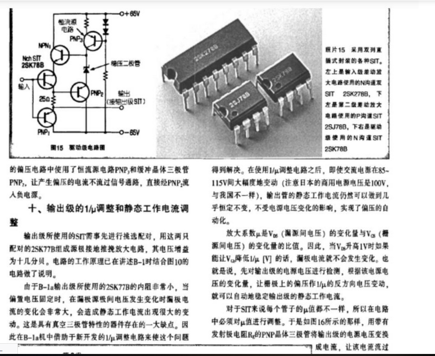

Currents do not drive transistors, voltages do. What static induction transistors care about is the gate to channel voltage. The common-emitter topology is not unproblematic concerning driving capability, nor is the voltage follower.
Ripple voltage is a nonissue here, IC regulated power supplies and bootstrapping are generally objectionable.
The problem under paragraph 3) applies more or less to all topologies where the output is balanced to ground. The Hiraga amplifier follows the load variations closely, large energy shifts are damped by the intrinsic resistance, local feedback and global feedback besides the 1 ohm resistor. It is not the role of 8.2k resistors to drive the input capacitance. How on earth can a depletion mode device operate in enhancement mode? The description of the operation is regrettably flawed.
Yes, thermal abuse leads easily to damage or destruction. The thick silicon dioxide layer utilized results in low input capacitance, wide bandwidth, low sensitivity, low gate-to-source series resistance, but also in a decrease in reliability. I agree on the necessity of gate stopper.
The expression "dynamic balance" in this context is nonsensical, undesirable and unrealizable. Signal voltages approaching the supply voltage will be terribly distorted.

Mr Hiraga rather unwisely simply transposed his 'darlingnot' circuit which is current driven, into an attempt to make the current of the BJT driver stage into driving voltage for the SIT/VFETs. There are several problems with this:
1) A relatively minor problem is that the required bias voltage for a chosen bias current depends on the power supply voltage. In other words, any sag or ripple will modulate the bias current. The only logical solution that would keep the schematic simple, would be to regulate the power supply.
I only wish to prevent unnecessary grief. Please do not pose arguments that could mislead unsuspecting potential builders, the SITs are very valuable and rare.... commenting post #631
The 2SK82 and 2SJ28 are vertical power Jfets so no silicon dioxide layer.The thick silicon dioxide layer utilized results in low input capacitance, wide bandwidth, low sensitivity, low gate-to-source series resistance, but also in a decrease in reliability. ...

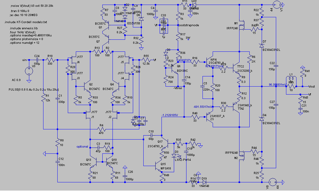

I am back with the following comments.
Zobel network
Without zobel network the amplifier oscillates at 7..2 0MHz.
To stop oscillation a resistor < 20 ohms has to be connected to the
output. The inductivity should be well below 1uH.
A resistor of 10 ohms and a capacitor of 47nF mounted directly to the
PCB is a good choice.
Stability
The problem with my test track 'Royal March' (see post #577)
does only occur if driver and output are cascoded/bootstrapped.
The problem does not occur with
- Darlington version (output cascoded/bootstrapped, no driver cascode)
- cascoded/bootstrapped driver, output transistors connected directly
to power rails (no MOSFET)
If I increase C10=100nF to 200nF in the VAS the stability of the
amp concerning my test track increases by a great amount. Increasing
additonally the Cap across the emitter resistors of the driver from
100n to 1-2uF the amp is stable.

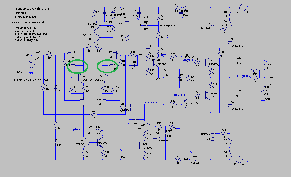

I already mentioned that the problem does not occur for all versions if
input transistors Q3/Q5 (BC557C) are replaced by a p-JFET
(e.g. 2SJ103) which limits the bandwidth of the input stage so that the
rise time increases to 2us even without any input filter.
This option has the following advantages for me since
I use a DAC with very low offset and with passive volume control without output buffer:

Dear JOS1,
I've been thinking about our problem with the "Royal March" track and trying to figure out what to do...
So far I would guess increasing power supply so increasing headroom could lift the problem to a higher (not needed in real life) power requirement...
A Baker Clamp was recommended for the CCS loaded VAS but was neglected on the Bootstrap loaded VAS based on hearsay...maybe a Baker Clamp is also needed there (// to Miller cap) in the form of a small Schottky diode.
I once got rid of an oscillation problem on a QUAD by using a small inductor //R16-R40 (33Ohm) at the bases of drivers BJTs...mere chance maybe, but it worked. Maybe the same can be used at the base of the output BJT.

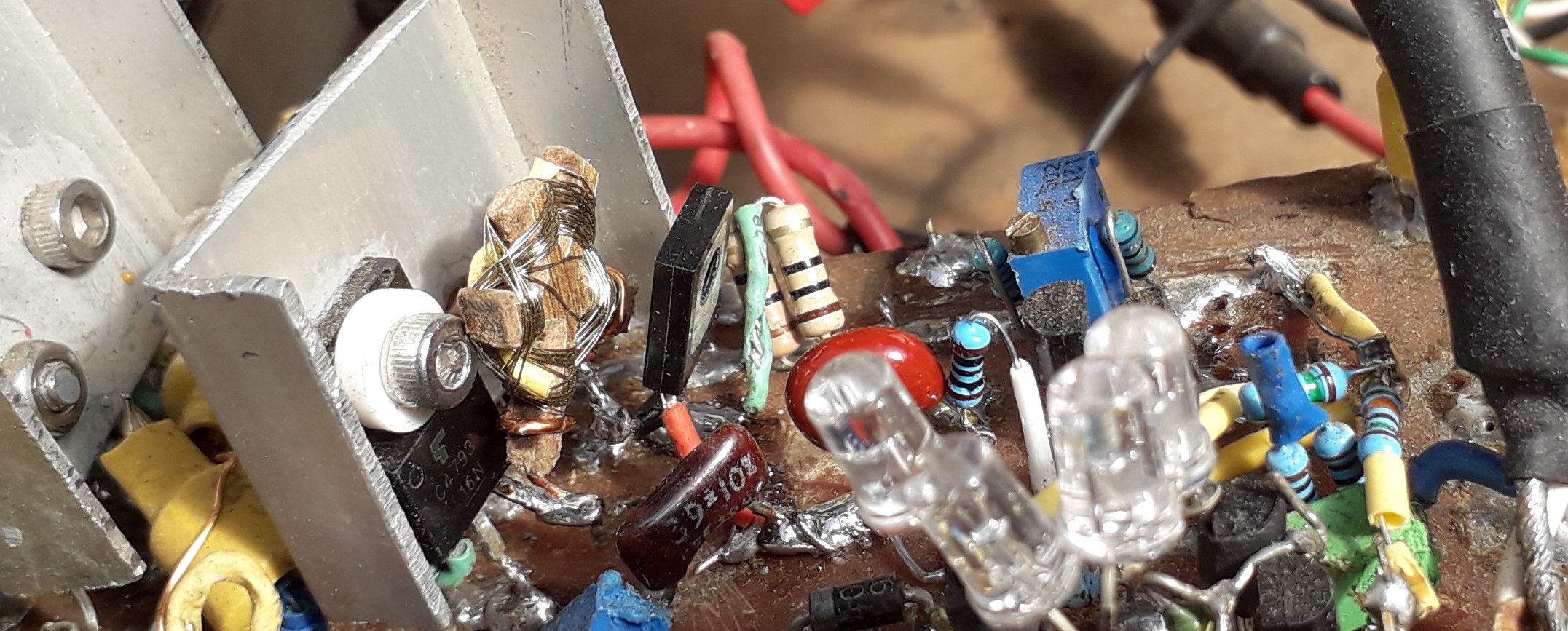

Hi Max,
With this measure the amp is absolutely stable even without input filter
and any compensation in the driver / output section
("Royal March" track is no problem anymore)

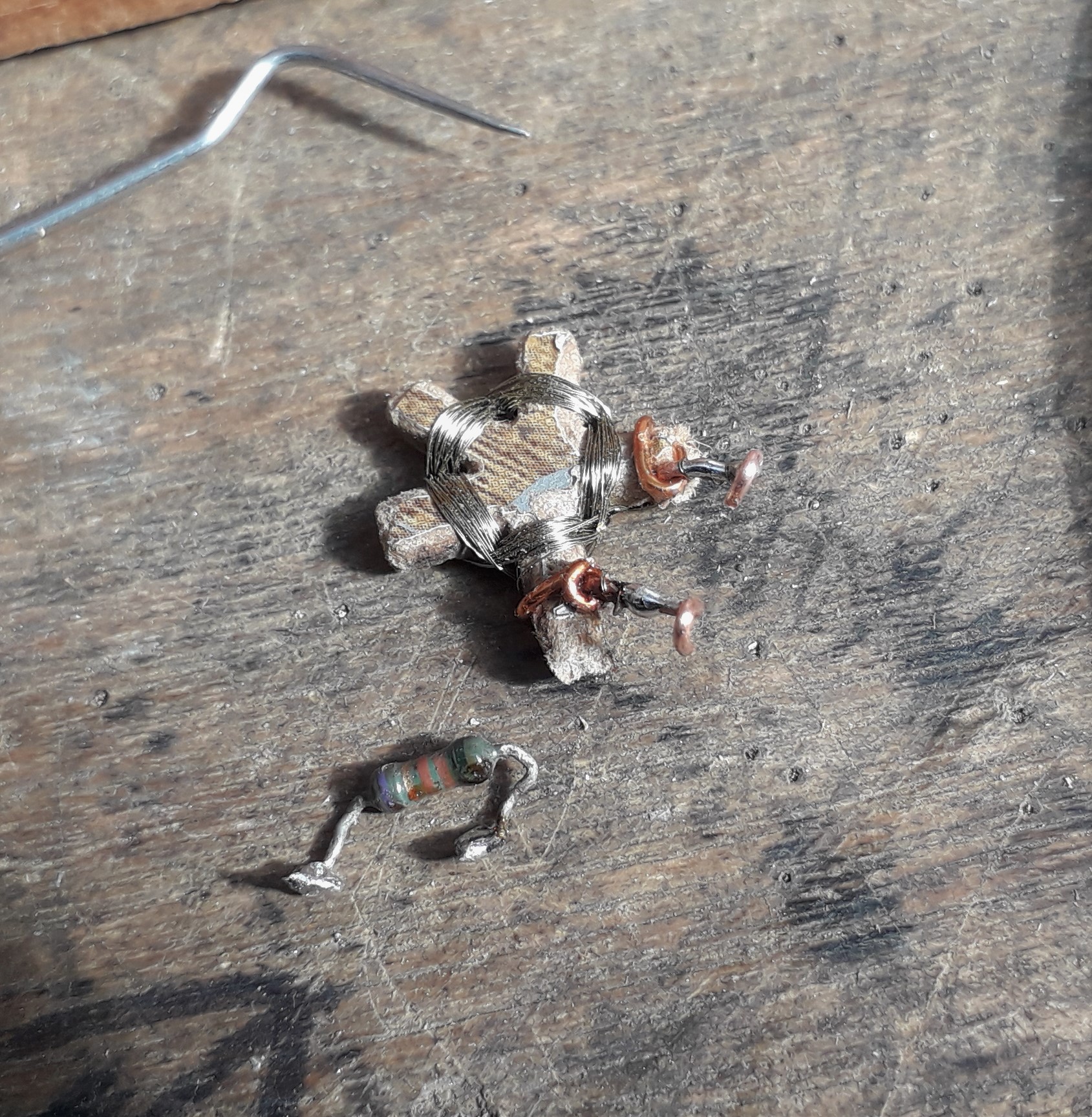

The Zobel 10R/47nF is placed directly on the PCB, an inductance (1uH )
without 10R resistor is realized by some copper windings around the
speaker connector.

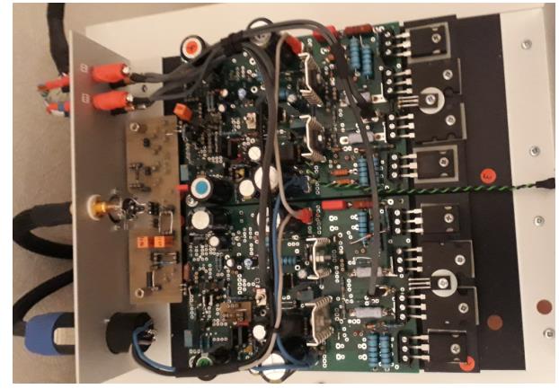

Dear JOSI1,
Wonderful news and excellent build.
Please, look inside.
I will, my friend.
Best wishes and thank you for believing in my fantastic dreams... 😀😀😀
M.
Hi Max,
speaker connector.
Your proposal the add a second JFET in the input section improves sound.
Great to hear. The J103 has low gain but is good for the Boostrapped-inside-CFP. Maybe a higher gain JFET would be better for the first unit? Or is the use of CFP enough? I ask the wise this...

I looked quickly at your JFET input, using J177 (from LTspice offer) which has +/-3mS, comparable with J103 (but lower Vds) and the squared waves look quite well behaved and could stand lower Miller and lower input filter, as you hinted to.
It appears to be the "simplest" way to implement the project and still enjoy the putative LTMD goodies, all with (probable) stability. 🙂
M.
M.

I think it is an idiosyncratic cascoded Kondo shunt regulated push-pull armament.
They are not JFETs and have certainly some kind of dielectric layer. The emphasis was laid on material and thickness.
Hi Max,
if you earch the forums, you will find others have looiked at these devices.
and most importantly, 2SK78 s totally different to 2SK78B
The non B version are power devices, and the B versions are small signal types,
in the DIL packages shown in your picture.

Report:
The DIY VAS resistor is done. The difference is far from subtle, even while the solder is still hot, so to speak. Briefly, it is like upgrading from a potentiometer to a Transformer based Volume Control (TVC), with improved clarity and definition, and I would say also improved dynamics.
Next time, I will do the frame from PCB thick plastic instead of MDF. If you do not want to buy some expensive low capacitance/low inductance resistors, you can buy some Manganin wire (100 Ohm/m; 1 Ohm/cm) from Conrad and cut one 50cm, or better 2 *1m// sections to wire your own. A star frame was the easiest, or less difficult, to build...
I would like to use those kind of R in all the signal path and see the effect.
M.

Amnesis PCB-Size: 137,7mm x 98,9mm
I gave 2 of my Amnesis PCBs to a good friend who is experienced
in DIY projects. He had problems to equip the PCBs due to the many variants and the close placement of the components esp. of the input stage.
For a rework of the present PCB it should be checked if it is possible
to reduce the number of variants and the number of components a little.
So I will skip the
buffer before the VAS (BC546) because never used
optional current sources proposed by Hans (SMD)
resistors parallel to the 1k resistors of the BS-VAS
Do you still need the CCS-VAS option?
Do you still need all the variants of the BJT input stage
up to 4 transistors feeding the red and yellow LEDs separately
with the bases optionally connected to the top/bottom of the100R resistors.
Are there any wishes from your side concerning the rework.
So I will skip the
buffer before the VAS (BC546) because never usedOK. Never got to make it work.
optional current sources proposed by Hans (SMD) OK. Can be fitted on daughter board in case of need.
resistors parallel to the 1k resistors of the BS-VAS.OK. Not needed.
Do you still need the CCS-VAS option?No. That was kept as some asked about them. Don't remember who. I reckon that high quality, non inductive R here would beat active CCS; resistors do not "slew".
with the bases optionally connected to the top/bottom of the100R resistors. We can use daughter-boards IF it is too complicated. The ALLBJT is sounding astonishly good with the DIY VAS resistor. Highly recommended, not to say imperative.
BTW, we can invent other inputs to try. See attachments.

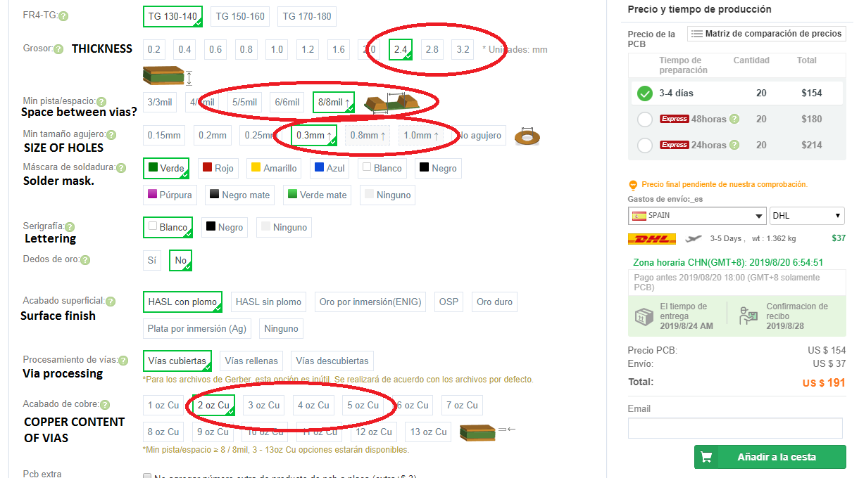

PCB production
Hi Max,
the main problem is if your selected PCB manufacturer can handle
the data output of my layout tool.
I am using a semi-professional tool called TARGET which is popular in Germany/Europe and many PCB manufacturers support the data output of this tool. This tool does not provide Gerber data but uses an own format (file name xxxx.T3001 or older version xxxx.T2001).
You simply send this file to the manufacturer. He knows how to extract
the relevant data for PCB production.
Let me know the web site of the PCB manufacturer in Spain and I hope I can find out if he can handle the TARGET file.
PCB data
thickness usually 1.6mm but 2.4mm is OK too.
size of holes: minimum diameter drill holes is 0.4mm
Space between vias: 8/8 mil 1mil=0.0254mm 8 mil=0.2mm ???
copper content of vias: 2 0z. Cu ??
usually the following parameters are used:
minimum diameter of drill holes e.g. 0.4mm
minimum trace width e.g. 0.2mm
minimum distance e.g 0.2mm
trace to trace
trace to solder pad
solder pad to solder pad
thickness of copper layer usually 35u
The price of 191$ for 20 boards is OK. Does this include shipment costs from Spain to your home town?
Best Regards
