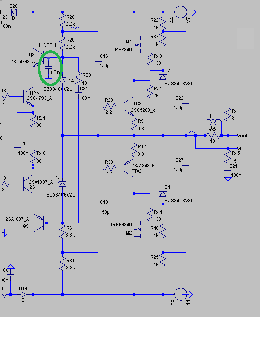

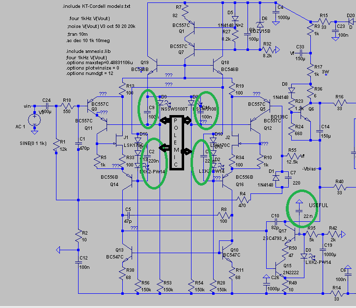

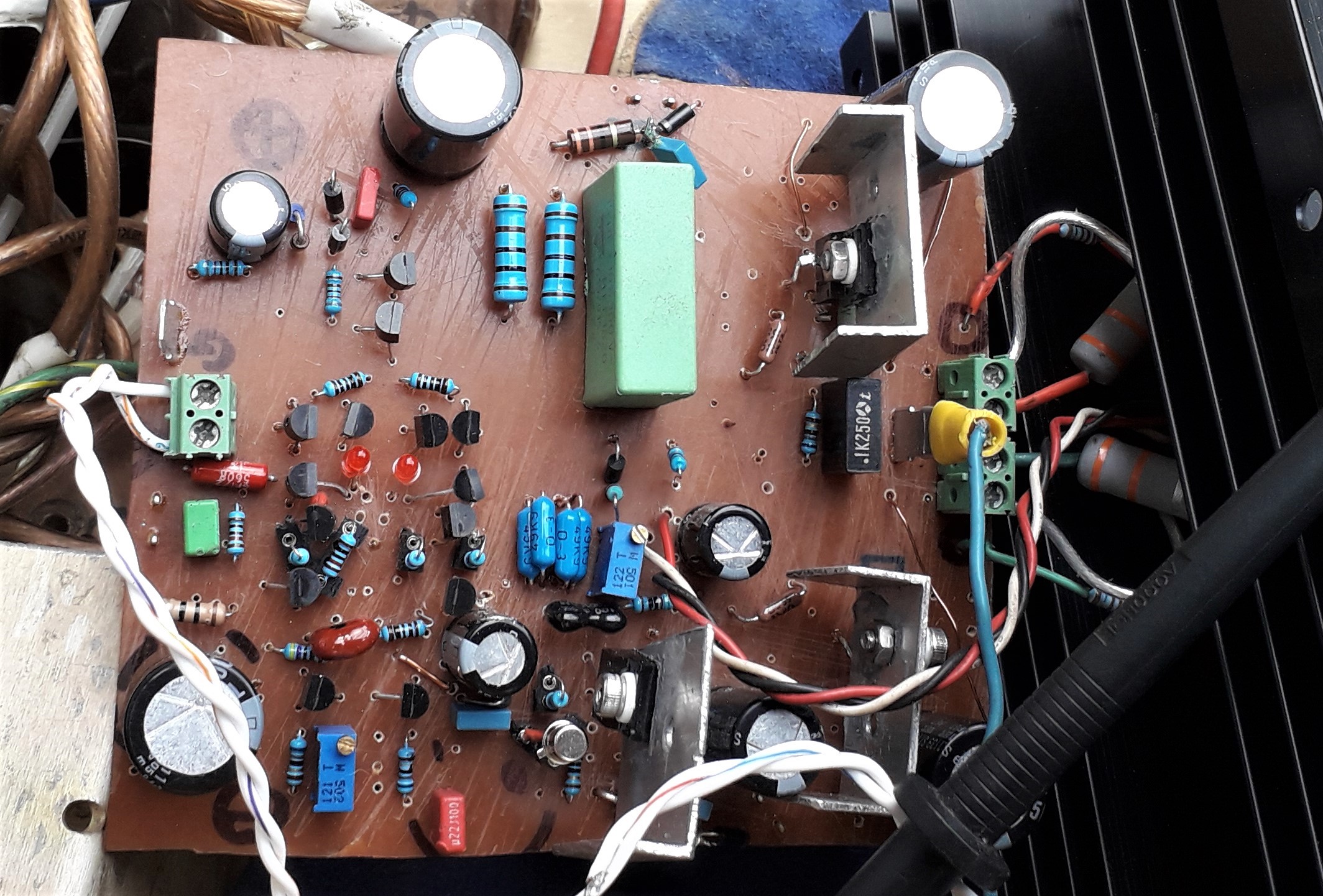

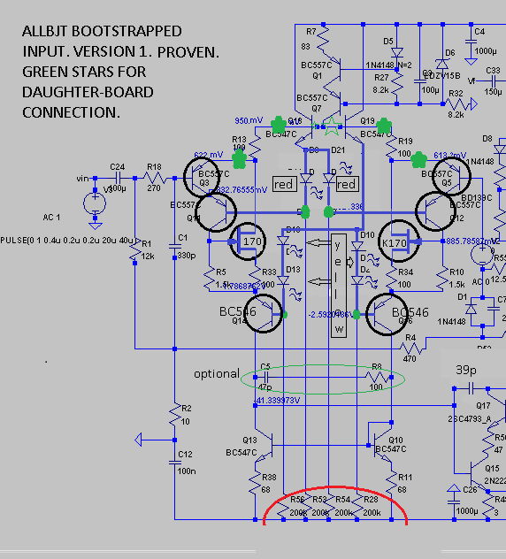

These monsters of amps of mine have, as you may have noticed, a tendency to oscillation in real life. Blame it on bad design or bad PCBs (JOSI1's apparently less prone to oscillation) or the mess of an experimental circuit, the thing is that either they tended (both versions) to show oscillation at the peaks of the positive going sine, which then could transform into full oscillation if volume was pushed up, either they went into full oscillation without warning. As an eternal beginner, I was desperate but I found an article (I think the author is our Bonsai) about the effect of cascodying in oscillation. A cap from base to ground of the driver's cascode (a bootstrap in reality) cured the problem in that particular system. I started with 100nF then dropped it until 10nF good quality film cap. Then I forget it. I believe I could go as low as 1nF but I lack those for the moment.
The full blown oscillation was tracked and cured when using a cap from base to ground of the VAS cascode. Again, I reduced the value until 22nF in one amp and 10nF in the other.
While doing that stressing task of taming oscillation, I was more focused on oscilloscope than on sound. Now my oscilloscope is not working so I can focus on sound.
Thanks to one channel of my red PCB (Ex-DX-HR II amp) oscillating when pulling on/off the lights of the room or the patio (!) with an arch felt and a pop from one speaker, even when the sound system is connected to an exclusive system with its own ground bar...I re-examined what could be wrong. This Electric Universe is amazing.
It was apparent that if forgot to reduce the 100nF cap from base to ground on the driver's bootstrap of that particular channel. Reducing it from 100 to 47nF, avoided the oscillation from the audio room lights but not from the patio lights 😱 Then reducing it further to 10nF makes it sensitive only to one of the patio lights, one of low wattage. So the effect is "tunable". I think the radiated EM pulse is captured by the speaker cables maybe and coupled to a tuned oscillator tank. I have to re-do the zobel and put it again before the R//L fillter, as now it is at the speaker's binding posts. Maybe that will cure the instability. I can also install snubber caps on the light's interruptors. 😀
But, what we have to do with all this nonsense? you may be asking... 😀
Here is the aspect of that adventure that has to do with our previous comments with Hans and Ramcres: the reduction to 10nF on the driver's bootstrap base-to-ground DID have a noticeable sound effect. It is subtle but significant and what makes me write this is that it is the same type of effect that I encountered when exploring the use of bypass caps //LEDs of the ALLBJT input (which now has one N-JFET) suggested by non-objectionable simulations, and where I noticed the same subtle effect which was obvious when I came back to no caps. I will attach a diagram for clarity. Even if I was checking the scope screen and not focusing on sound when experimenting with the VAS cascode (not touched since) I believe no sound effect was evident. I would have to re-experiment it if you force me.
So, the best is not to have to install caps at all but if you are forced, use the smallest that fixes it because: the addition of caps make the sound softer, rounder and more polite, but micro and macro dynamics suffer, and images get fuzzier and background is not so black. Going back to smallest cap in the case of the drivers' bootstrap or no cap in the case of the ALLBJT input restores dynamics and black background and even channel separation improves, with more solid images. Now I am on the process of evaluating if the present configuration is the preferred one. I also attach the present (good) hybrid or compound Sziklai input.
But why is that? My explanation as an amateur is that, in a bootstrap, as simulations show, signal is applied to two legs of the transistor, or better, signal is also applied to the base (gate) and that signal is useful and good for sound (dynamics, low level detail...etc) so when I use a cap to tame the oscillation, current is wasted (or waves are modulated; or else) on that cap. On the VAS' cascode BJT (the VAS is "bootstrapped" by a cap on the CCS also, hence the name), the base has no signal so the cap has no effect on sound quality. Does this make sense?
Maybe that is why I stubbornly insist on getting the QUAD bootstrap right...😀
as the effect on dynamics is cumulative, IMHO.
I am buying 1nF quality caps. 😉

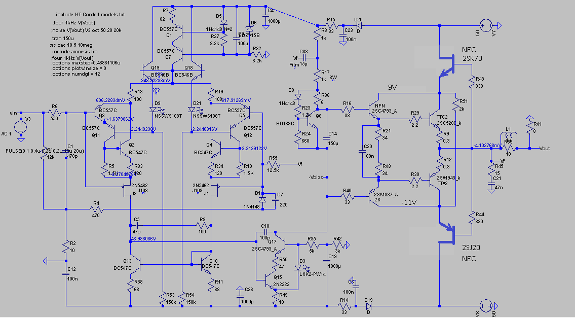

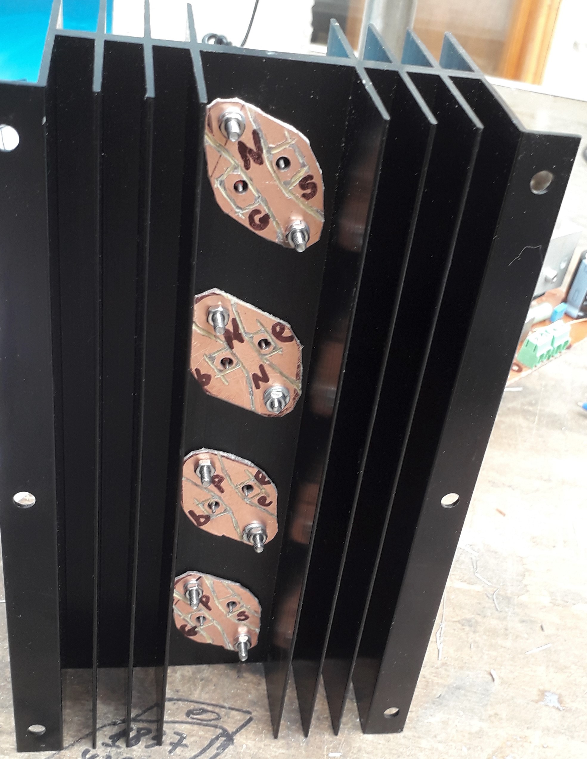

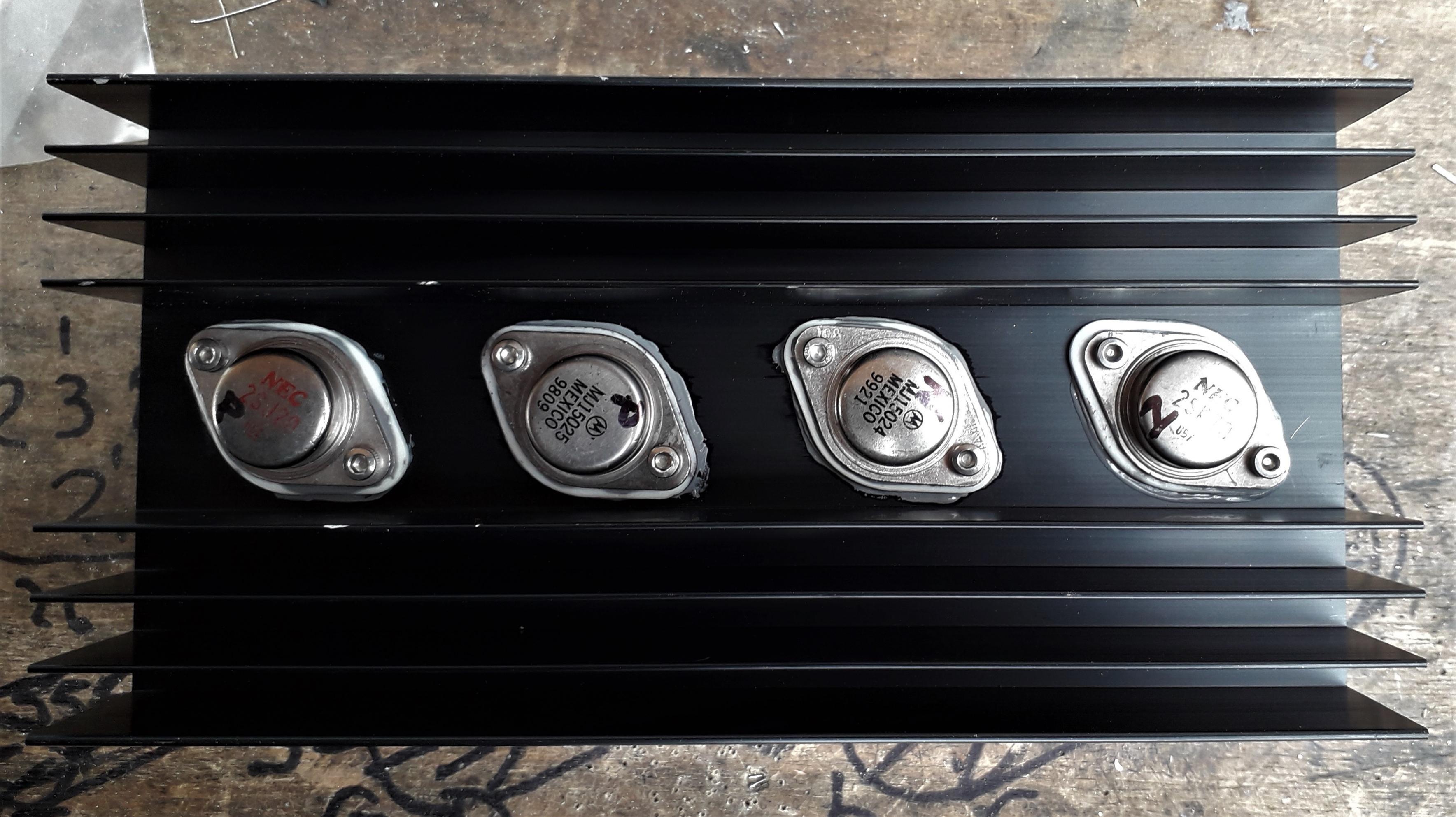

And the New!
Like we say in boxing... 😀
Finally, my dream of a VFET AMNESIS.
I am using my NEC 2SC70/2SJ20 VFETs. I reserve the Sony for later.
First step: emitter follower output. Everything works OK.
Second step: wired it as VFET bootstrapped Darlington output. Everything works as intended. Very simple mod. The gates of the VFET are connected to output with a 330R only.
Now, I am finishing the second channel.
I am listening to monophonic music with both test speakers (16 Ohm) connected. 😎 I won't say how it sound because you know I am totally partial. 😀
Third step will be connected as "QUAD", meaning bootstrapped drivers also. I hope it does not oscillate.
Edit: you may see that I am using a big 15uF quality film cap as bootstrap for the VAS and also in use is the N2222 BJT as VAS. Pin adapters are fitted for several key resistors and for the VAS transistor, if the wish for experimenting arises...
M.
