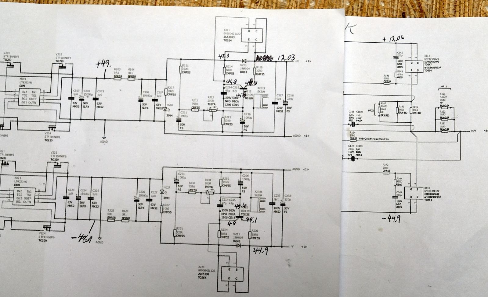

I removed R203 and R223, measured about 49vdc on both positive and negative legs. Reinstalled them and measured +12v and -44.9v on the respective outputs.
I have written the voltages on the schematics. I am guessing I have an issue on the plus Cap Mx side. Gone over the board, checked solder connections, etc.
Thoughts appreciated.

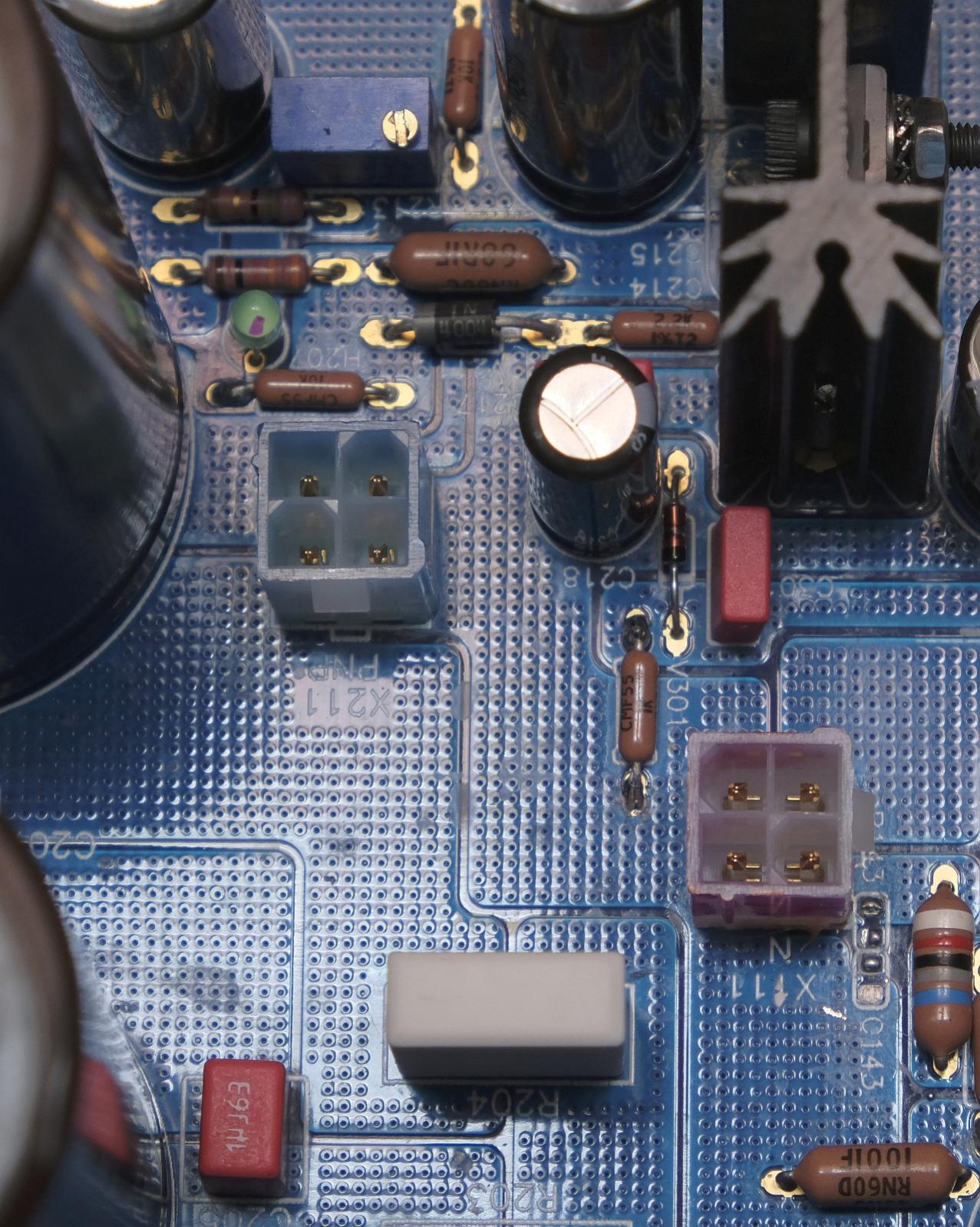

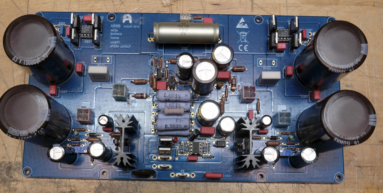

All I can say is the check your flying lead wires to make sure that they are correct pin out. Also do you have PNP for output on +ve rail and NPN on -ve rail. Check to make sure you have NPN as the master BJT (BD139) for +ve rail and PNP (BD140) as master -ve rail.
Hi David,
Can you post a few detailed pics of your ABBB board and setup?

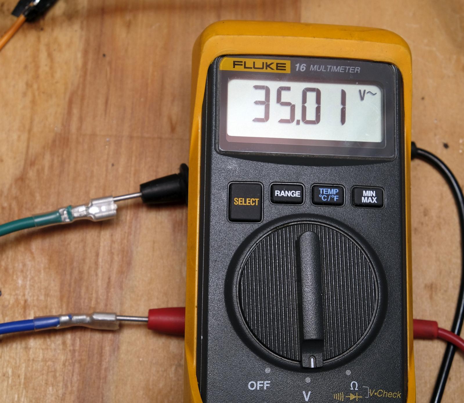

The voltage seems a bit high from a 32vac secondary.

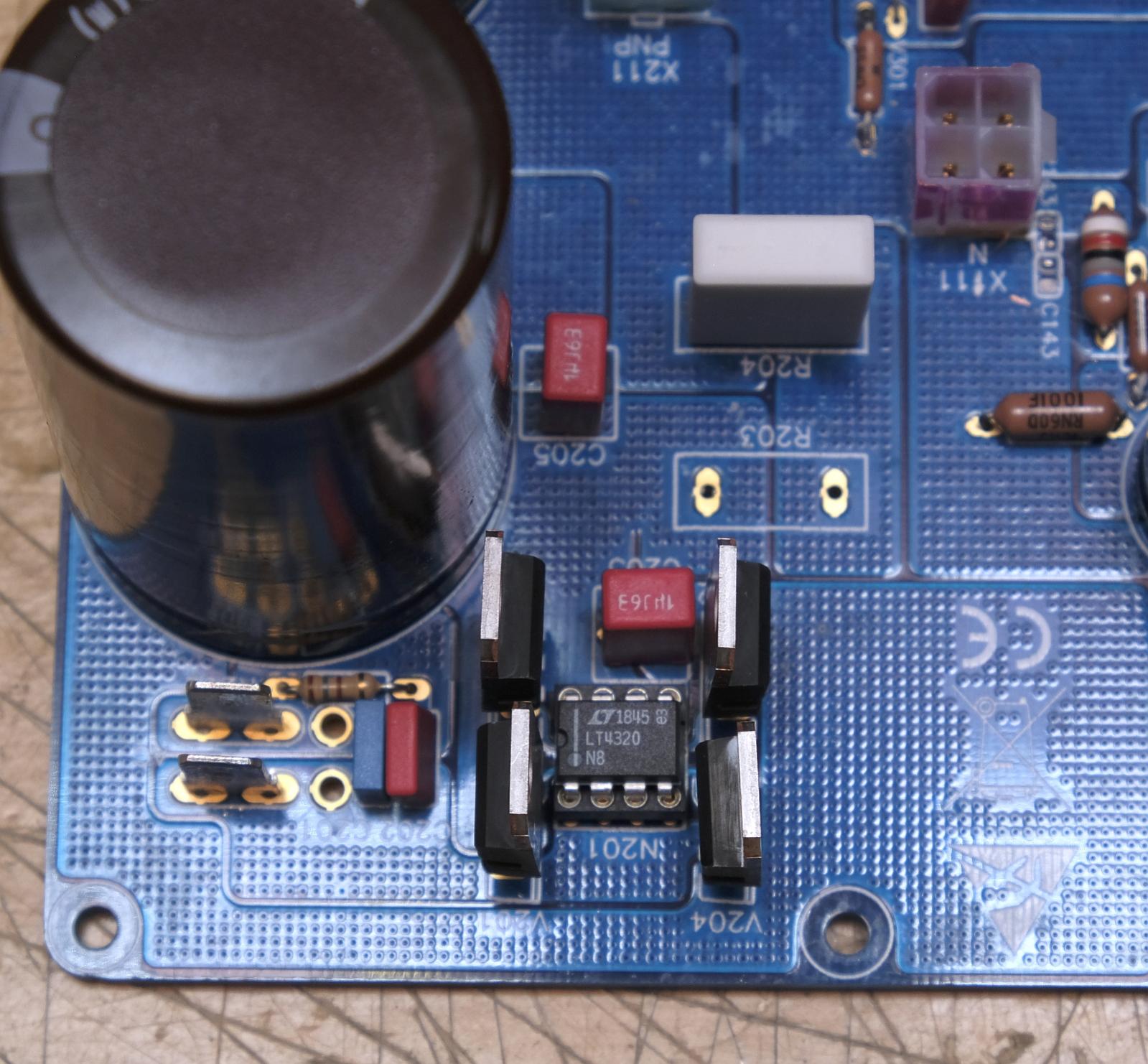

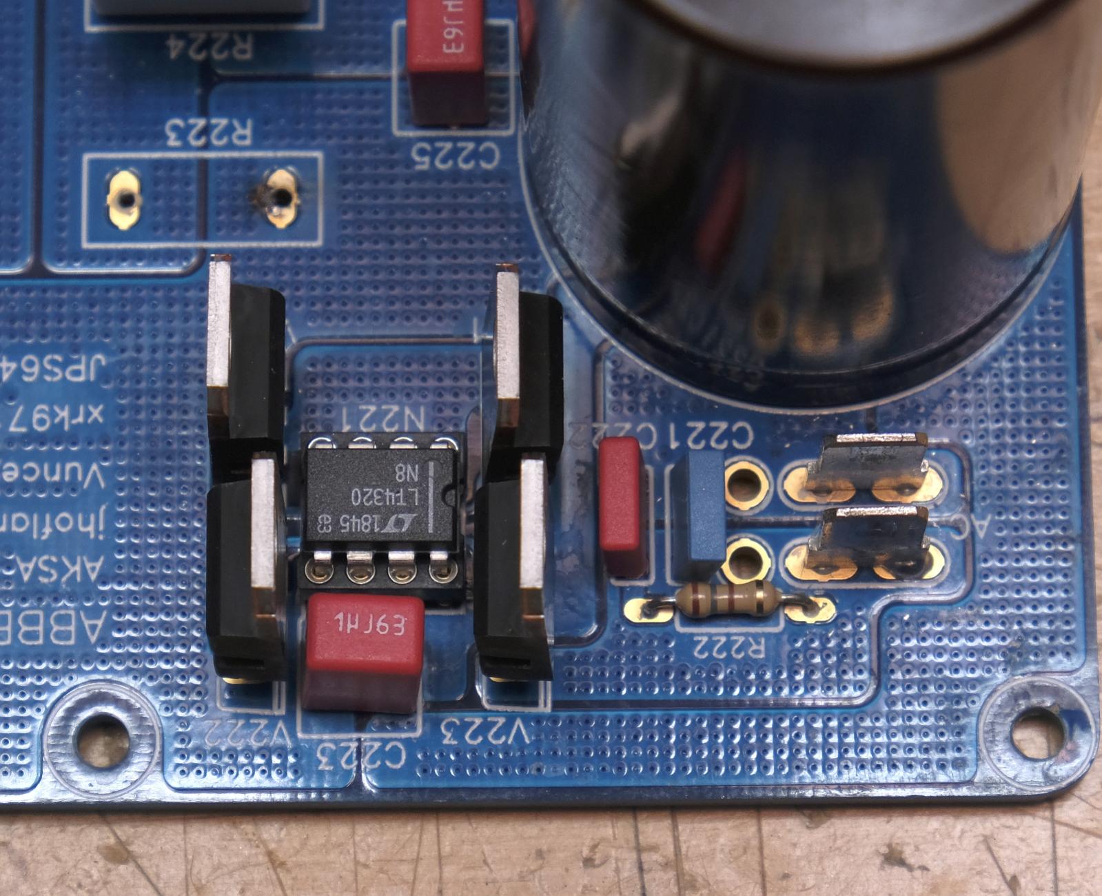

Here are several shots. I am reading 35vac on each secondary (TVA volts!). R203 and R223 are still out in these photos.
I haven't tried X's suggestion. I believe I may have mild dyslexia, so miss wiring a connector is definitely a possibility.

Yeah, double check all BJT and Mosfet flying lead pinouts for correctness. You can power up with capMx BJT’s connected, but not the Mosfets to check voltages. (When the Mosfets are connected, the BJT’s must also be)

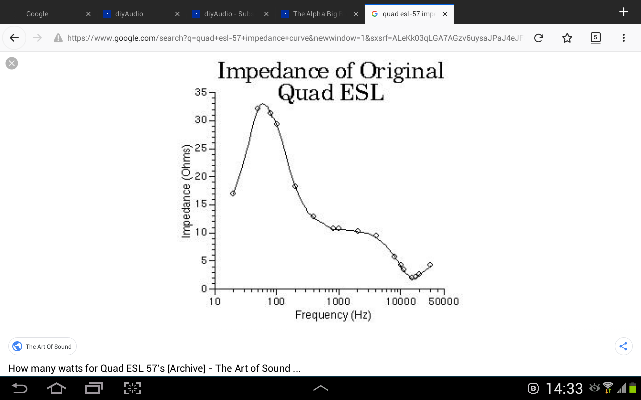

I'm currently using a Bedini 25.25 (25 W x2) to drive a pair of stacked Quads (57s) and they sound awesome. Admittedly the Bedini runs at about 65°C but it has small sinks. This amp should not have a problem. My only concern is the protection circuit, some have had problems with ESLs I believe (hearsay)I'm thinking of using this amp to drive a pair of ESL57s, but would the 57s low impedance at high frequencies (~2R) cause problems at all?
Kevin
@Chiily:
2ohms at what frequencies? That is pretty low and depending on how much current is needed, may cause problems. Do you have a link to the impedance sweep as function of frequency for the ESL's?
Hi X,
Quad ESL (57) impedance curve attached. The Quads (TMK) can take a maximum voltage swing of 32 V peak-to-peak and then you will get panel arcing. Stokessd here on diyAudio has clamp boards that can be easily installed to protect the tweeter/mid panels. Quad ESL57 clamp board?
