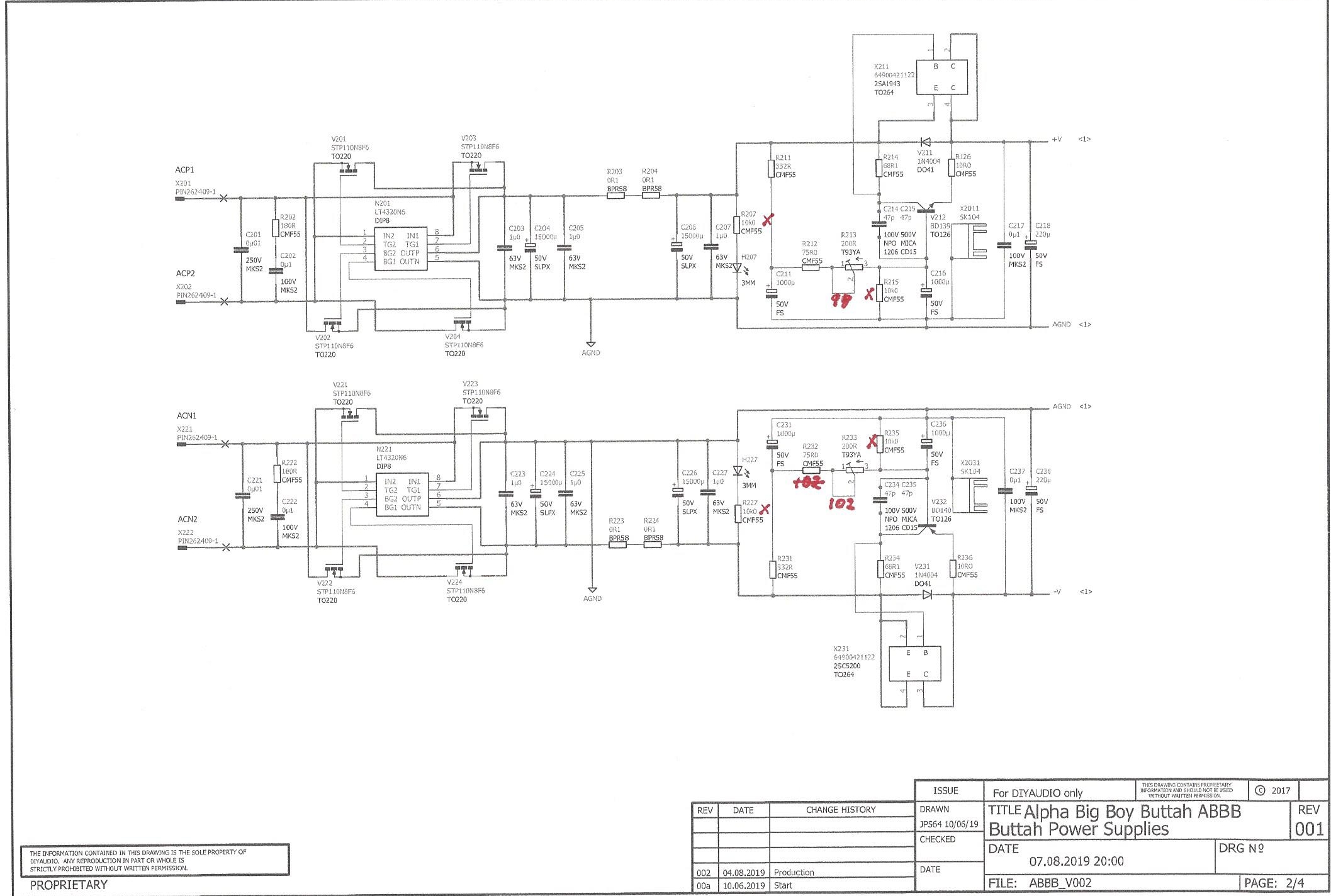

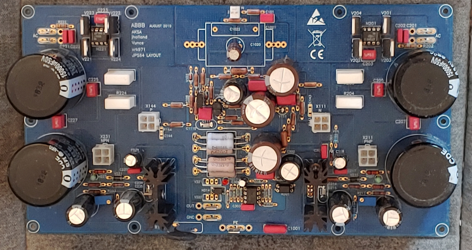

Attached are the schematics of the power supply and amp. Red "x"s denote blown resistors. The delay is not included since they are all blown.
Also attached are images of the top and bottom. I inspected the areas around the transistors with a magnifying glass before removal of the parts.
The power transistors and MOSFETs are wire-wound and soldered to the flying leads, so will require some surgery to check. When I built them, I gave every wire a good "pull test" to ensure the crimps are solid at the board end. I also verified I had closed circuits between each wire and it's nearest passive device.
Lastly, I double checked again that there is no short between the flying leads and the heat sinks.
The Chassis is made from wood, so nothing can short to the chassis.
My current plan is to replace all the resistors since most are blown anyway and are not terribly expensive. None of the polarized caps are mis-formed, so I expect they are good. I will also replace the three actives in the circuit protection area.
Any thoughts on the film caps or the on board transistors?
Again, thank you all very much,
-Josh

Hi Joshua,
That’s an awful lot of resistors to be blown. Even in places that don’t carry much current (like input stage). How are you measuring them? If you use a digital multimeter, are you sure your test leads are not bad or maybe the meter itself might be bad? There is no reason for R101 R102 to get blown - ever. In all my years of making amps, these are never damaged. Or you have a thin solder flux film over the terminals and the meter probe is not contacting the legs proper. You have quality Dale CMF55 there and they look fine. When they blow they will be brown or black and visibly burnt.
Hi Joshua,
I have an old Fluke 88 from my previous life, it's beat around a bit, but still works fine.
I double checked and found that you are indeed right, R101, and R102 are not blown. I should have caught this, a moments common sense says that if the amp is not hooked up to an output, then those should never blow.
I had the meter set to "alert", and did not realize that it stops auto-ranging....
Just goes to show that you can use a tool for decades, and still not know everything about it 🙁
I will upload a fresh schematic. I need to eat, and I am probably done for the evening, so probably tomorrow.
Thanks for the challenge on my info,
-Josh

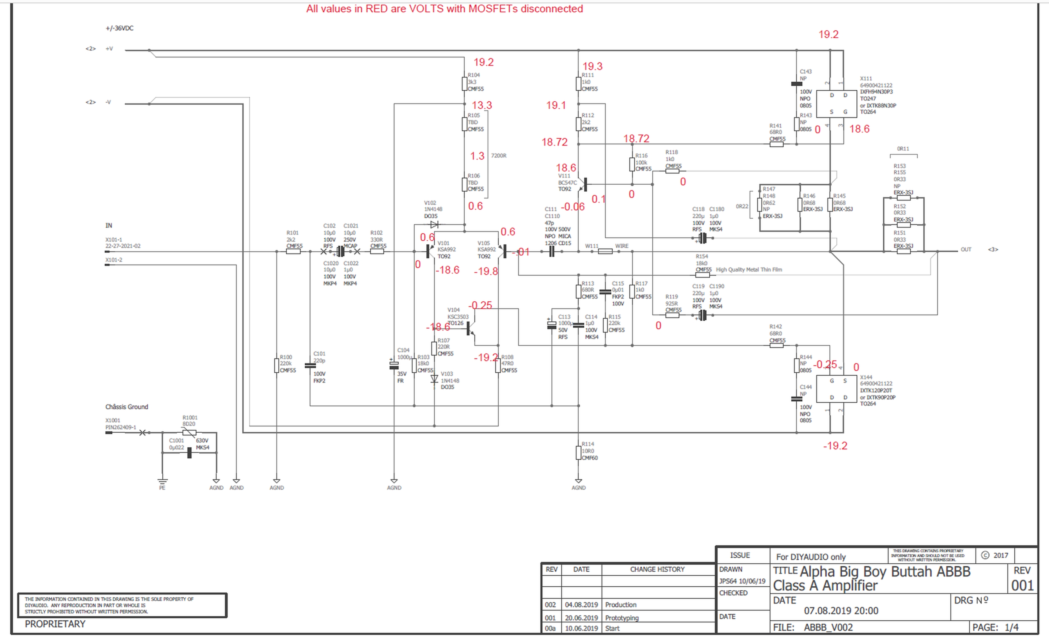

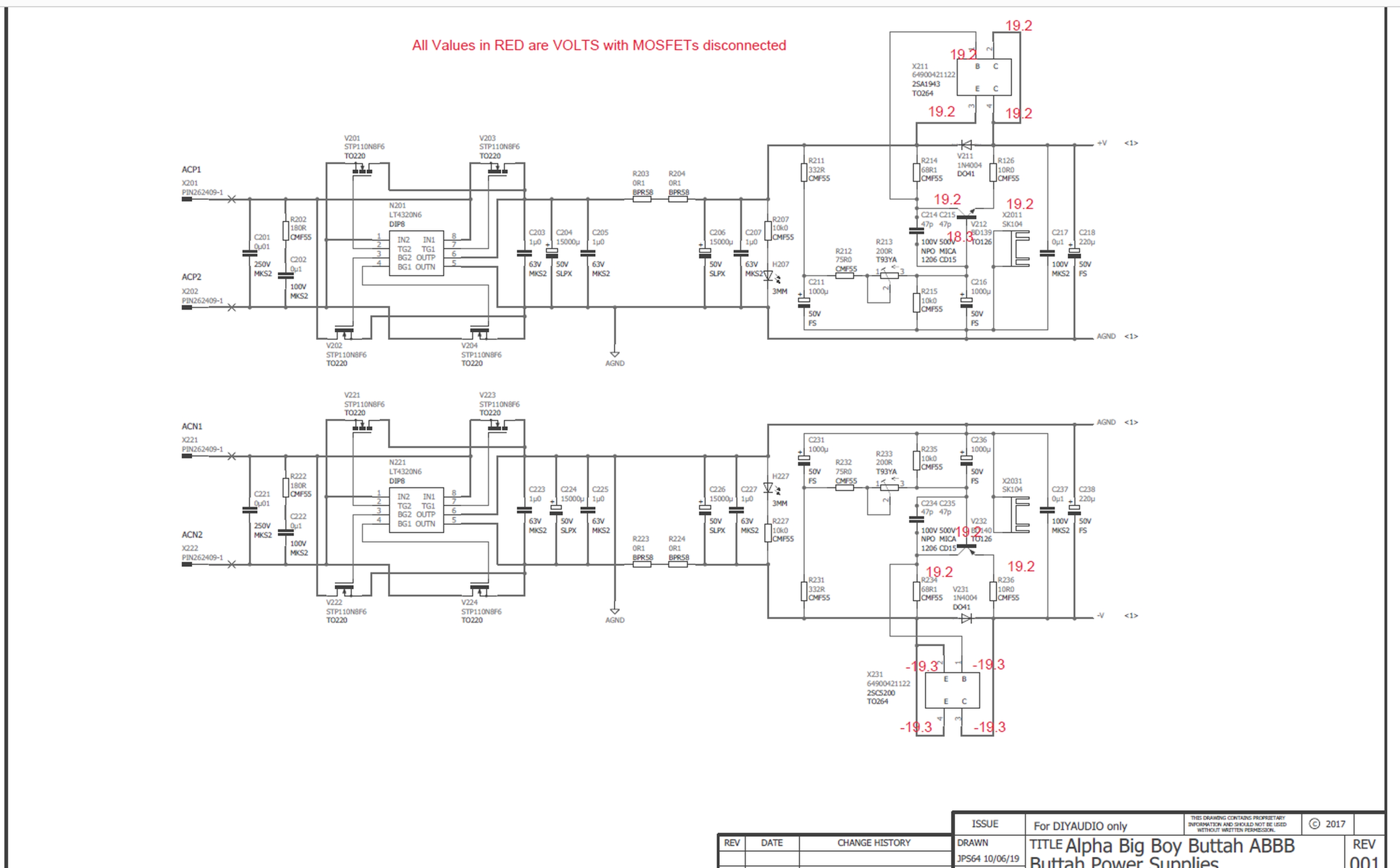

Hi folks,
Here are some voltages.
I am running it at about 55VAC.
Attached are screen shots, and the original pdf with the values in red.
Should the base of V111 be 0V?
When I tried to measure R116 on the board, it acted like it was pumping up a cap, so I removed it and checks correctly.
Thank you all for your help,
-Josh

Hi Joshua,
Thanks for posting the detailed diagnostics. There is something strange going on at the gate of the P-channel MOSFET and what is driving it - the KSC3503 VAS stage V104. The gate voltage should be about 4 to 5v higher than the -ve rail or -14v to -15v. For it to be at -0.25v or near 0v means that the MOSFET is either conducting wide open (smoking hot). This would explain fuses blowing, etc. I would remove the P-ch MOSFET and check the resistance between the gate and drain or gate and source and source and drain. If anything lower than 10's to 100's of kohms then it is probably a fried MOSFET (shorted between S and D) and G and D or S. It may have fried because the thermal conduction was not good, or ESD, or you may have a bad KSC3503. However, I find that the BJT has never gone bad in my experience.
Hi Joshua,
Thank you very much for taking the time to try and untangle this.
Sorry if it I was not clear in my previous post, all those voltages where taken with the MOSFETs disconnected. I put it on the schematic, but I think I forget to say that in my post.
The P-MOS checked fine by your suggestion, the N-MOS though was shorted by all pin combinations.

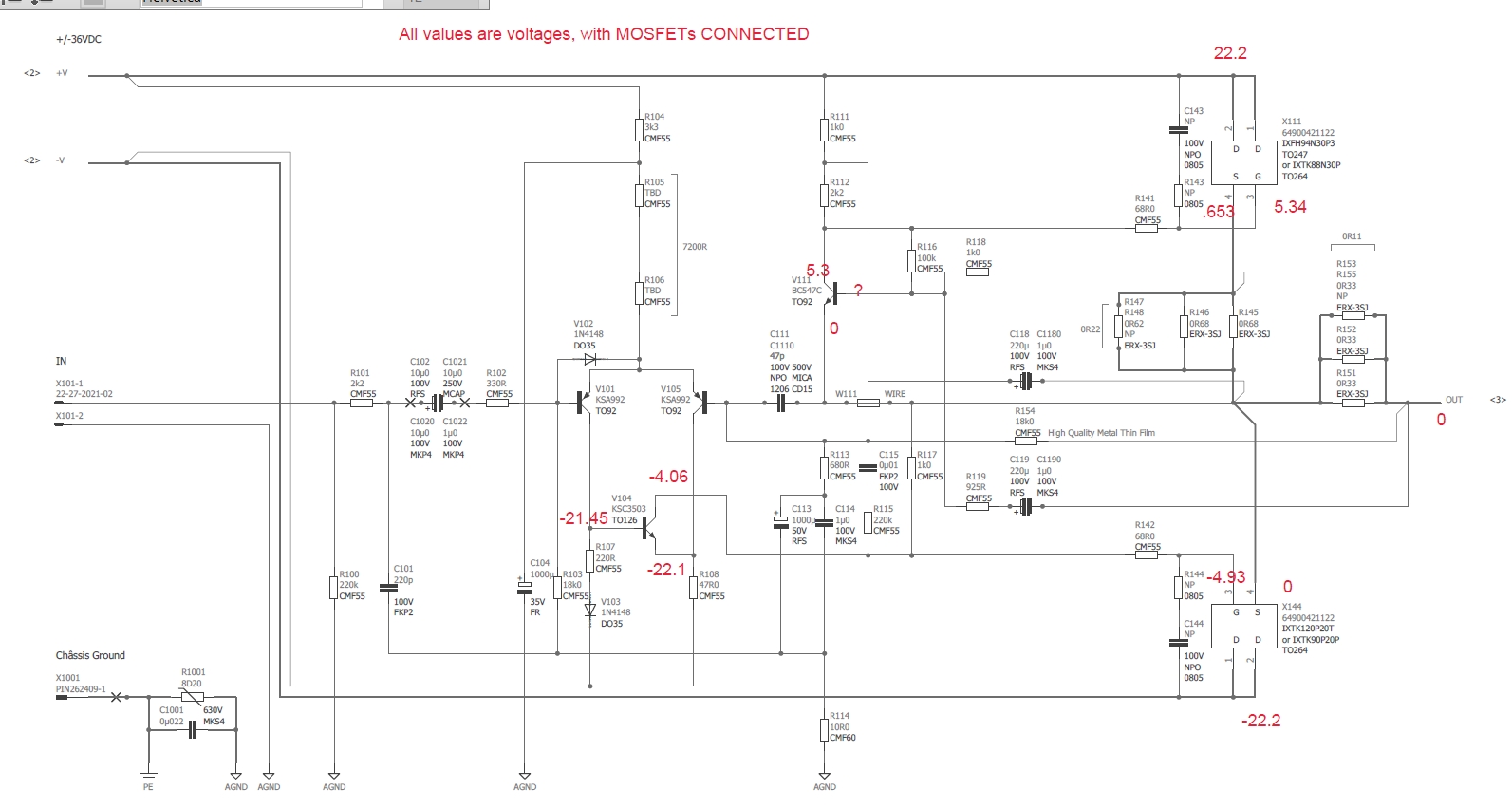

I have replaced the N-MOS, and started the amp.
There is a hum coming from something. I do not know what, it might be the fans, might be the variac, the toroid, something else...
Voltage drop over the source resistors climbs up to about 0.7V and then settles at 0.64V.
I slowly raised the variac, source resistor drop remained constant, and the hum seemed to get quieter.
At about 100V, the C-60 started to smoke and I shut it off in a hurry.
Attached are voltages using about 70VAC. This is enough AC to get the fans running and the temp display working. Temp stays under 60C measured on the heatsink die with thermistors.
All voltage are with MOSFETs connected
Note the "?" at the base for V111. Probing this changes the pitch of the hum, and the display changes intensity.
Thanks again.
-Josh

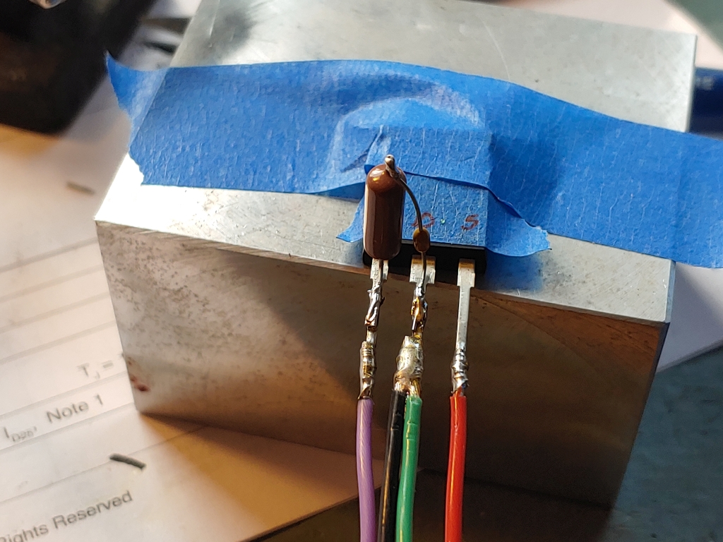

I also attached a pic of the wires at the N-MOS for those interested in that sort of thing 🙂

Well, I got the amp running.
Turns out the root cause was torque from the wires causing the transistors put too much pressure on the Silpads allowing them to partly short when at near full power. I happened to be looking in the right place at the right time, and saw a bit of blue glow.

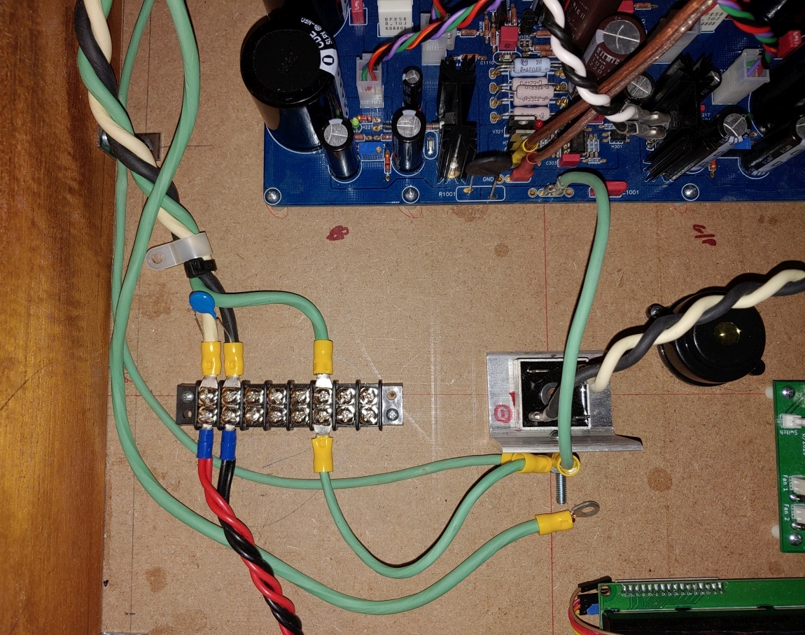

Now I am having a loud humming from my speakers (both amps).
I only get the hum when connected to my DAC or AVR.
I do not get the hum when I use the headphone jack from my phone or when the audio in is disconnected.
Here is what I have done so far:
Detached the audio in from the back panel.
Run "jumper" binding posts directly from the circuit board to bypass the installed binding posts.
Detached the safety ground from the heat sinks.
Unplugged the transformer from the bridge rectifier that runs the fan controller.
The chassis is made form wood.
The ground scheme as of this moment is mains earth goes to the star ground, the back panel safety earth and the clean ground from the amp go to the star ground.
Power comes in, goes to a distribution block, to the transformer, to the amp. The 12v tap is detached from the rectifier.
There is a class X/Y cap across the line and neutral.

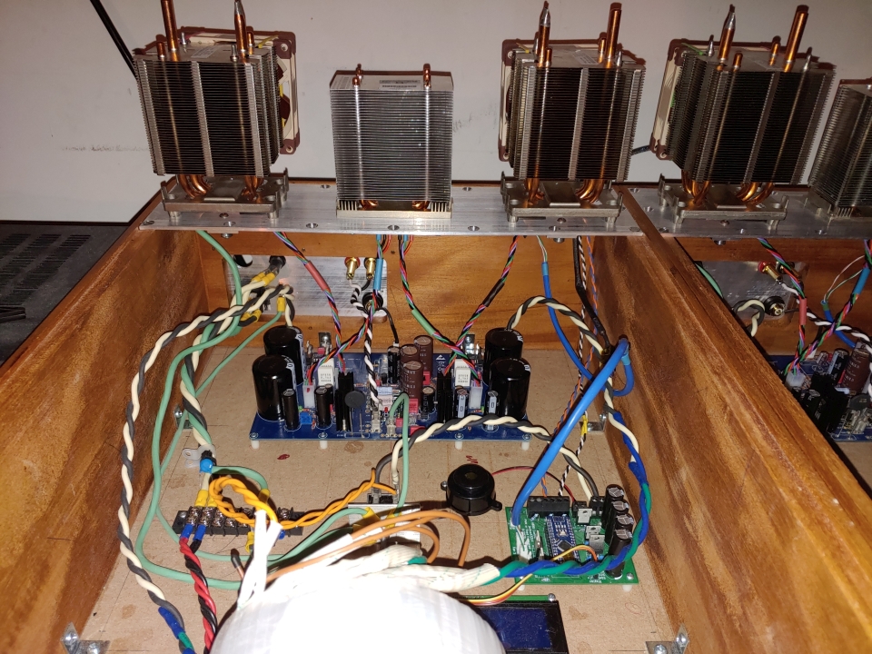

Attached is a pic of the inside. I can take a decent pic of any area anyone wants to see.
I do have one question in particular, is it safe to float the ground on this amp?
Any ideas or suggestions greatly appreciated.
Thanks,
-Josh

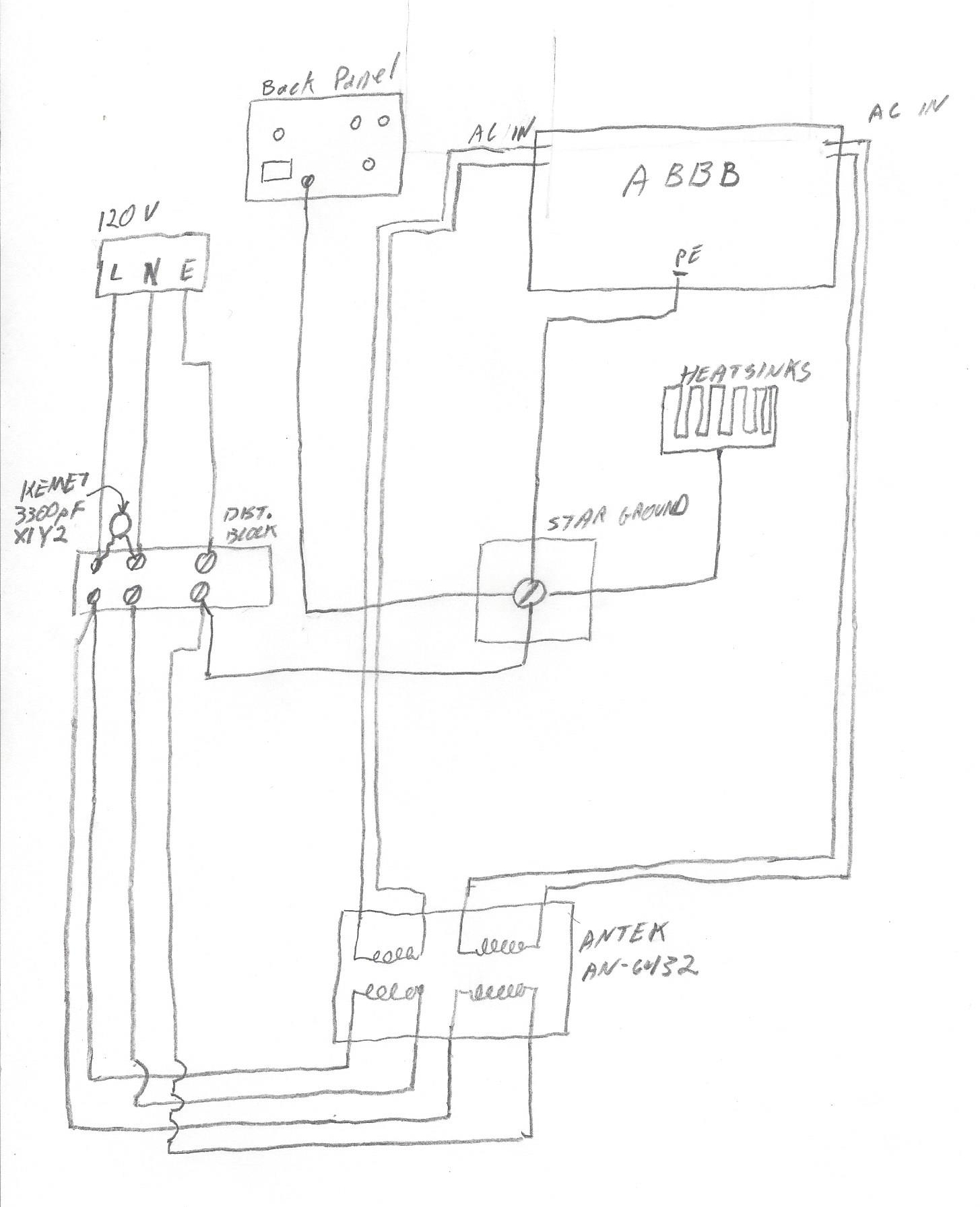

Grounding scheme is hard to see from photo. Can you make a hand sketch of the grounding plan?
What is important is that the clean analog ground of your amp doesn’t touch the dirty chassis ground directly or inadvertently. It must be controlled and deliberate.
For example, here is what I did for the Alpha Nirvana amp:
837360d1587747684-alpha-nirvana-39w-8ohm-class-amp-a190389f-cdd0-45c7-8d35-354511cdef86-jpeg
Thanks for the reply.
Here is a sketch of the grounding and powering scheme, and a pic of the actual implementation.
Everything in the power/ground path is in the sketch - if it is not in the sketch, it is not in the amp.
A note: the ABBB has a C-60 at the ground on the circuit board, so I am not further isolating the ABBB ground with another C-60.
Should I still have another C-60?
The disconnected green wire is the safety ground to the heat sinks.
The tightly wound black and white wires crossing the circuit board that appear to touching the transistor are not touching the transistor. it is an optical illusion, the wires and the transistor are several inches apart.
My line power is reasonably clean. I take pains to not use fluorescent or LCD lights, and I do my best to keep SMPS's off this circuit.
The humming sound is similar to the humming sound you get when you plug a guitar into a live amp. About that same frequency, but not as loud and without the "buzzing."
