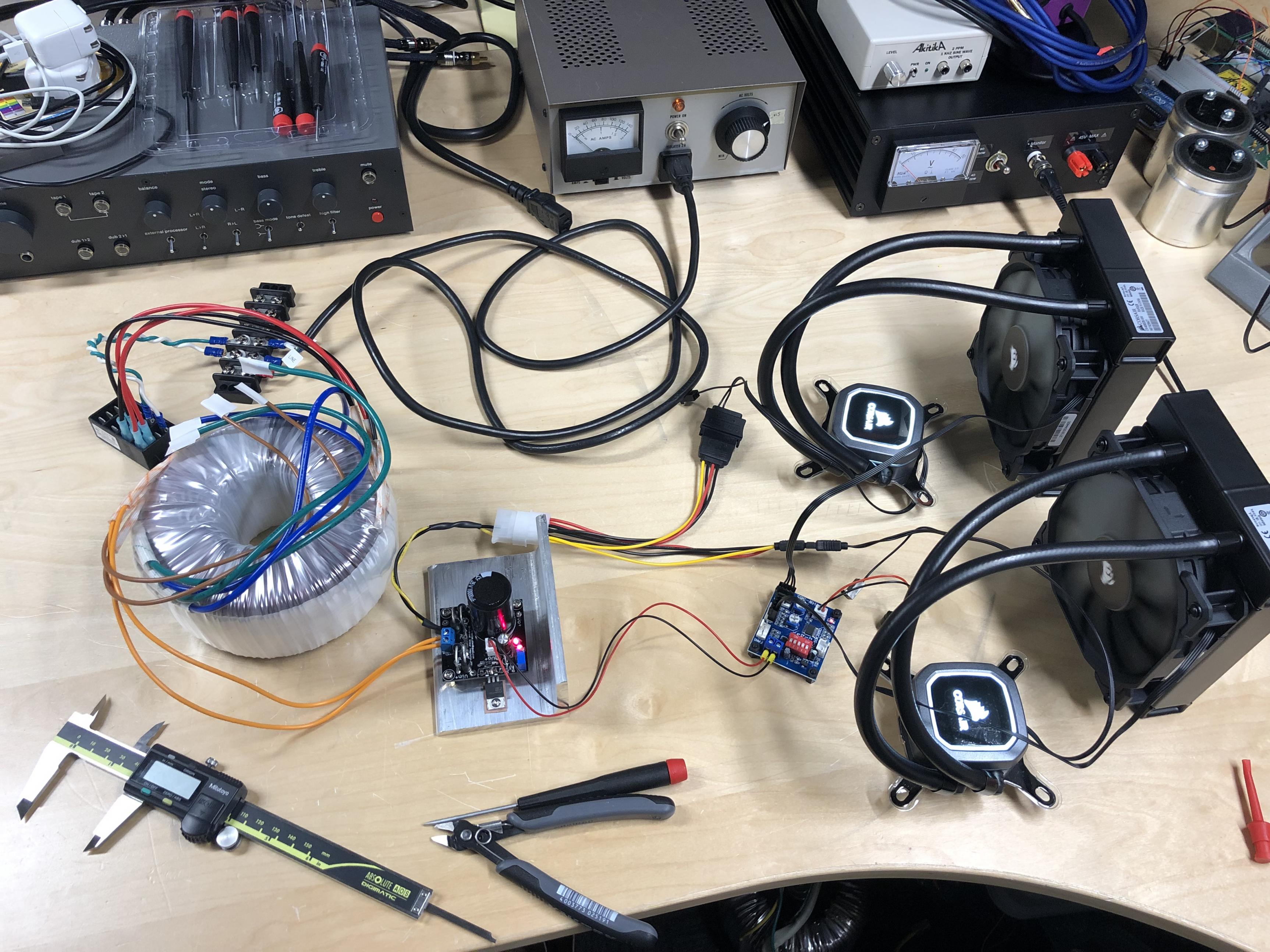

A little update on my progress. I have a working testing with 2 Corsair H60 All In One water coolers running off the 12v secondary and a small adjustable regulator PCB I have some stock of (Linear regulator PCB (LM317, LT1085, LM338, LT1083)). Each H60 pulls about 400ma for the pump and fan. Fans are adjusted using a simple 12v pwm controller, the same as I believe Vunce has used, though I have another interstesting one on order (DC 12 24V 48V 2-Way 4-Wire Computer PWM Temperature Control Fan Speed Controller 699934192570 | eBay).
Overall, I'm pretty satisfied with the sound level, the largest source of noise is the vibration from the pump (hosted in the actual cooling block). I will look to minimize this in construction by isolating the mounting of the cooling block from the rest of the chassis.
My next step is going to be actually starting to build one channel and testing the thermal performance of the H60s. I have all the parts ready to go, but was wondering what (if any) adjustments are needed to be made during or after construction. It looks like the two pots are part of the cap multiplier. I am assuming these are used to dial in the same voltage for both rails, any instructions on this? What voltage should we target? Where is the best spot and under what circumstances should we test this voltage (MOSFETs (dis)connected? under load? etc?)? Are there any other considerations / steps to take during construction and initial bring up?

Nice setup there, Gtose! Looking forward to seeing how the liquid cooling works. If you upgrade those fans for he brown/beige colored Noctua's, there is a word of difference in fan noise reduction.
Regarding the pots on cap Mx, set it at midpoint to start off - it really does not change the output voltage a lot, maybe 1v to 2v, and I have found a good operating point is to adjust for about 3v of drop to get the lowest ripple.
It should be adjusted with the load in place, or the amp drawing 3A. You can measure the voltage at input to BJT and output of BJT of cap Mx and look on O-scope to see where the minimum tolerable ripple and minimum acceptable output voltage is. Less ripple (higher voltage drop) is less output voltage.

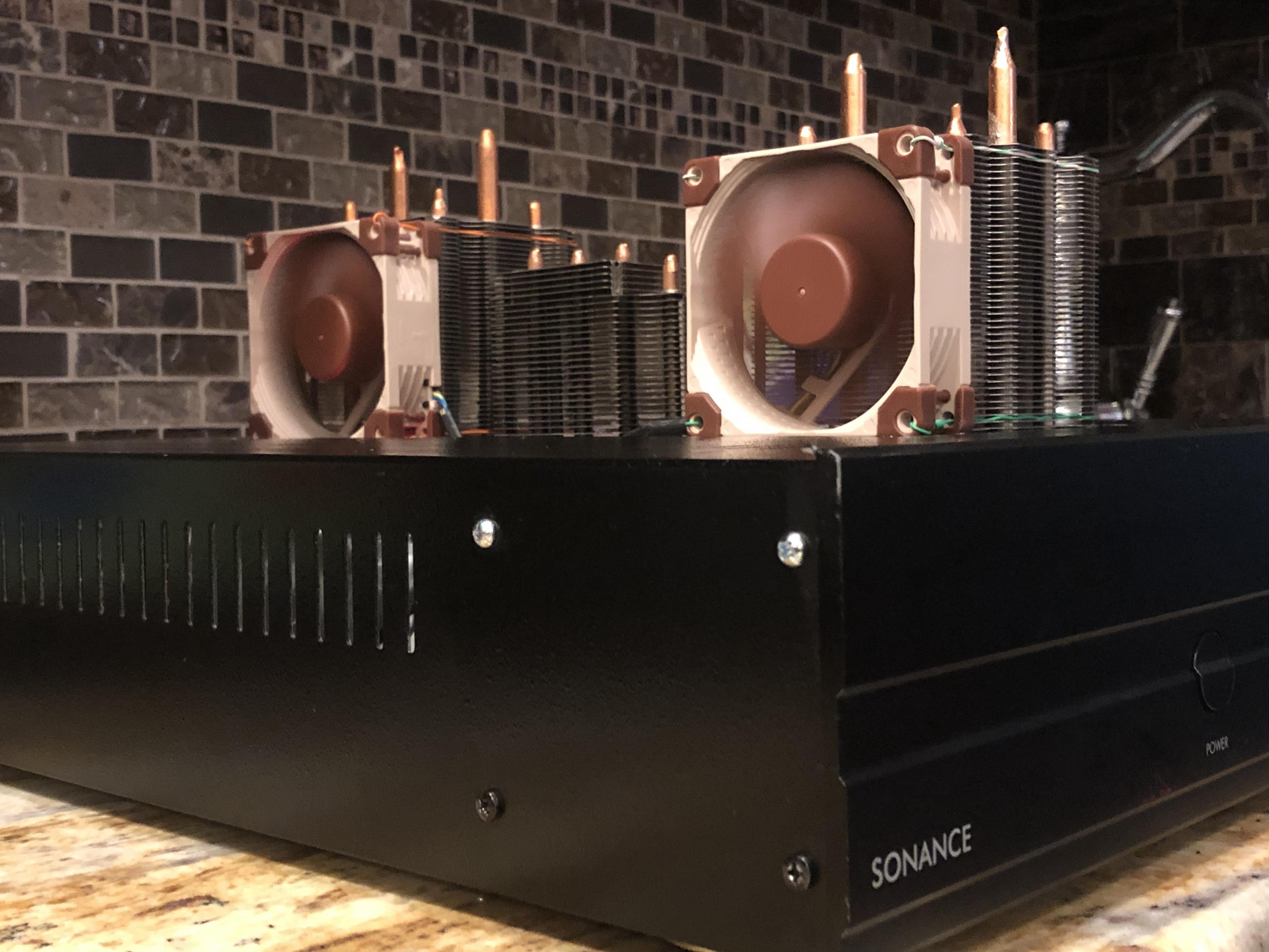

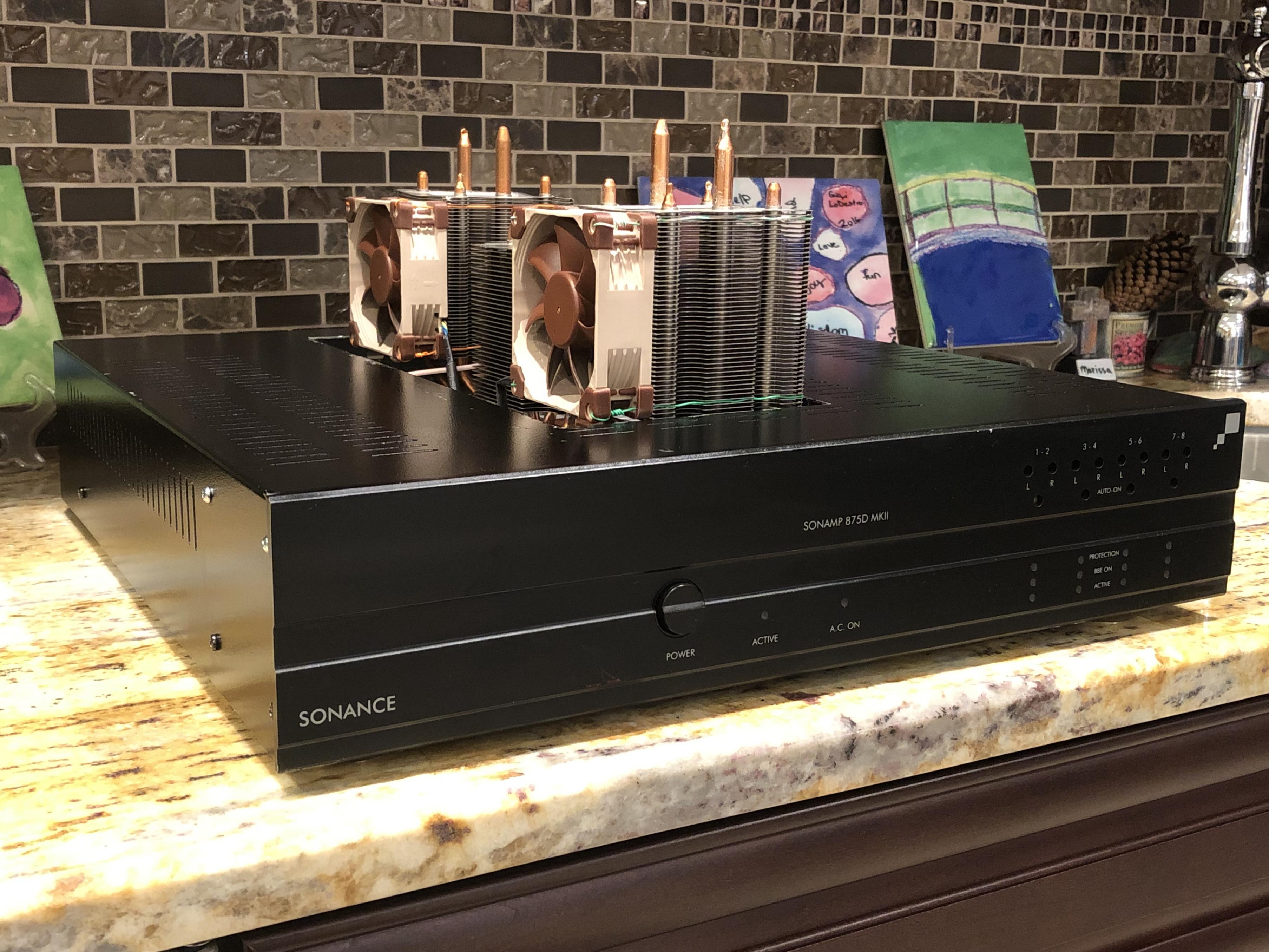

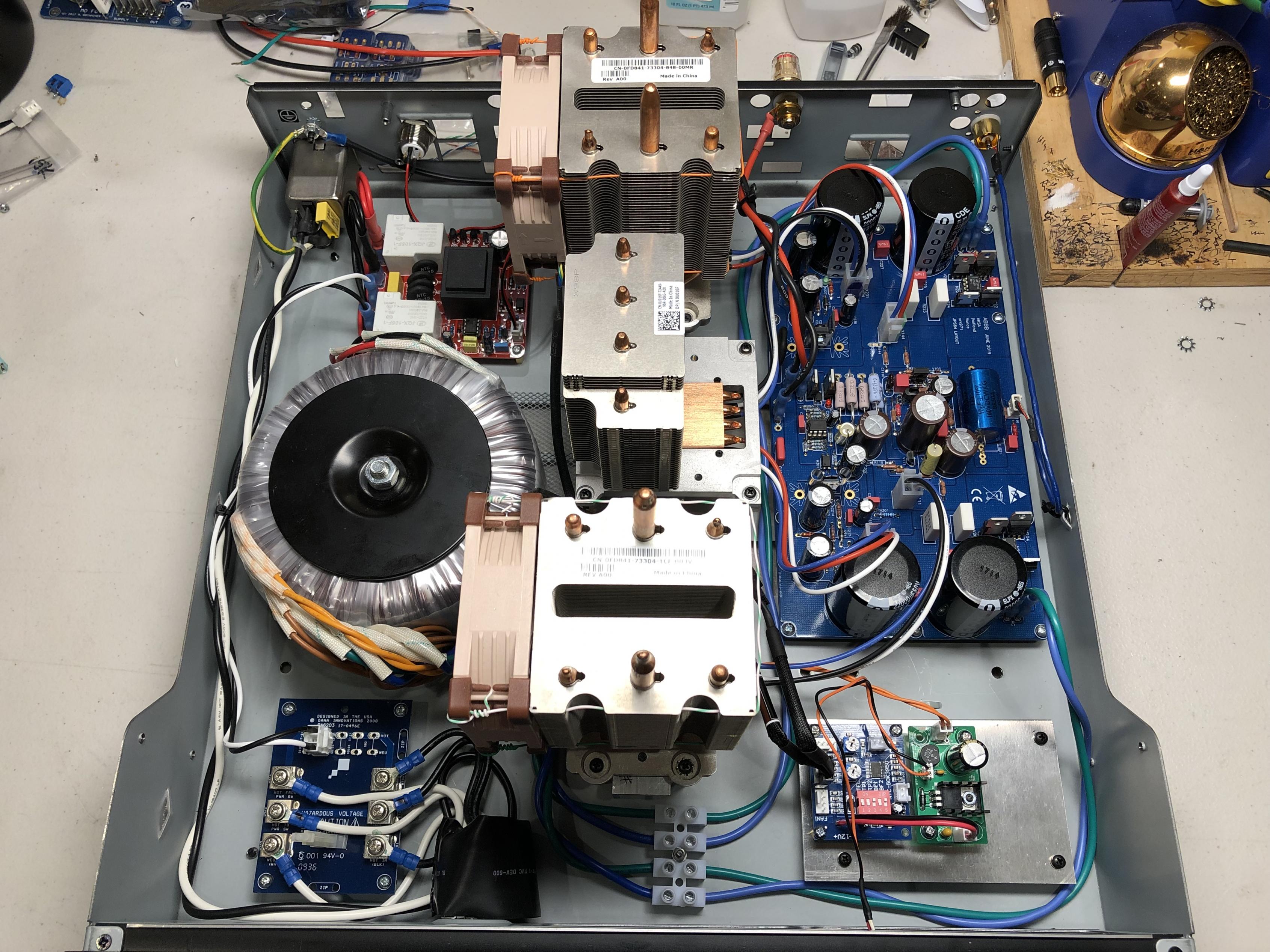

ABBB stuffed in a chassis
Hello fellow builders,
I thought I’d share a few pics of a fully functioning monoblock ABBB stuffed into a recycled chassis. The enclosure size is 17”x 17”x 3.5”, transformer is an Antek AN-6432, both BJT’s are mounted to the center cpu cooler(no fan required) flanked by the Mosfets mounted to independent coolers.
Since this was a recycled chassis, I will have to work on the front panel to clean up the existing holes or maybe just a wooden overlay.....?
She is singing away! Perfectly quiet, silent background at idle without any power on/off noises :)
Now, I’ve got to get the second monoblock completed to get the full ABBB impact!

Vunce, thanks for sharing your work! Do you have another one of those donor chassises laying around for the second channel or will it be an “asymmetric” build?
I’m assuming that is a soft start circuit by the IEC. I haven’t thought about it for this build, but since there is a cap-mx, with I’m guessing a slow ramp up, is it recommended? Regardless, would inrush from the traffo be a concern with 600va?
Joined 2014
Hi gtose,
Yes symmetrical monoblocks, I have a few of these enclosures. Each one of these amplifiers originally had four 125asx2 ICEpower modules in it. Very cost effective way to source them :)
Yes, some sort of soft start would be recommended for this power level. Whether it’s simple NTC’s or a board similar to what I have installed. The capMx is after the CRC so it’s ramp-up has no effect on the transformer inrush hitting the active bridge.
