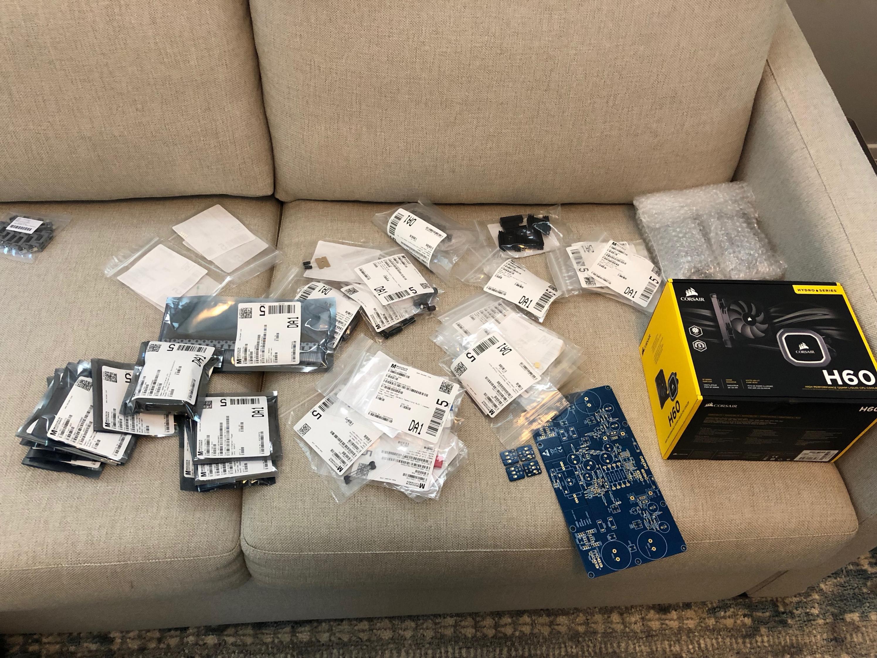

It's my favorite day of the week: BOM delivery day! I went largely with Vunce's Mouser BOM, plus my corrections. For the DC coupling caps I am going to do MKP1840s (QTY (3) MKP1840 10uf 160V 10% METALLIZED POLYPROPYLENE BOX FILM MKP1840610165 | eBay), they should fit nicely. I have a pair of 32v/600va Antek's enroute as well, figured I would oversize them since I should have the space.

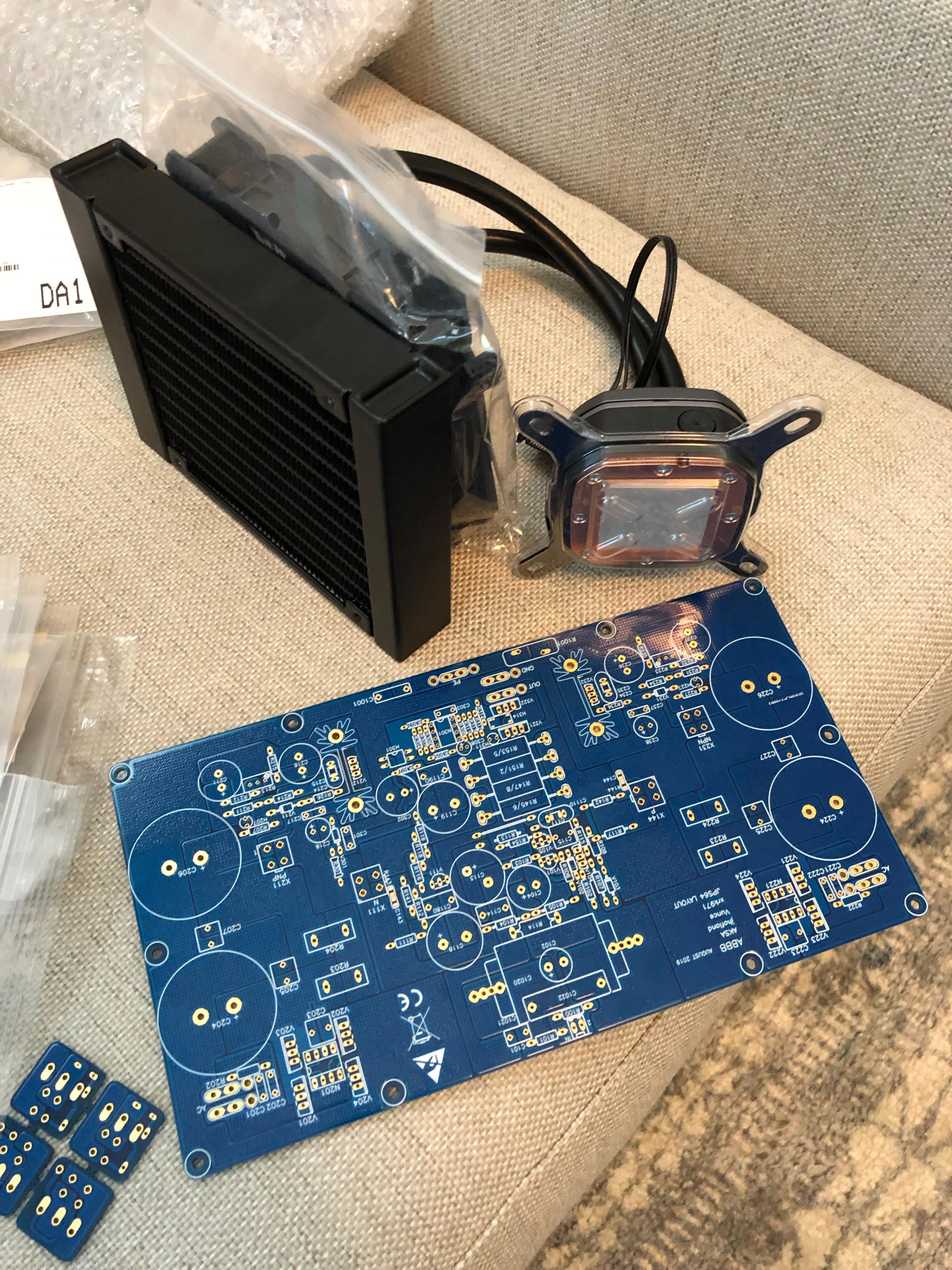

For thermals I am going to attempt the water cooling route with 2x Corsair H60s per channel (https://www.corsair.com/us/en/Categ...2018)-120mm-Liquid-CPU-Cooler/p/CW-9060036-WW). I ordered one from Amazon for $70 to test fit (both mechanically and electrically) and noodle on before ordering the rest.
Not sure when I'll get to actual construction, Loafimus is going to kill me if I don't finish up an IcePower 500ASP monoblock build we've been working on, but I'm super excited for how this one is going to come together 😀

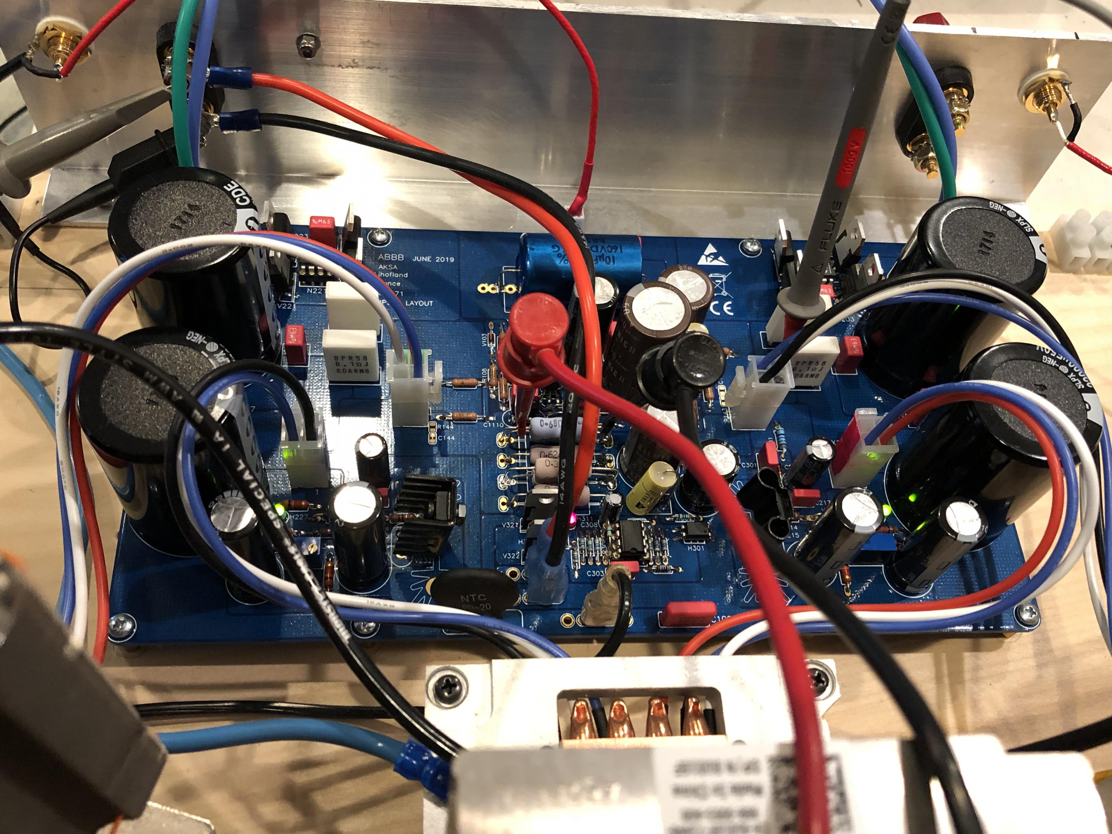

I scanned the boards, and added the pin numbers to all the headers, and the Rxxx and Cxxx numbers to the flying boards. Please ignore all the boxes drawn around the parts, it is the same image I used when mapping out the boards.
