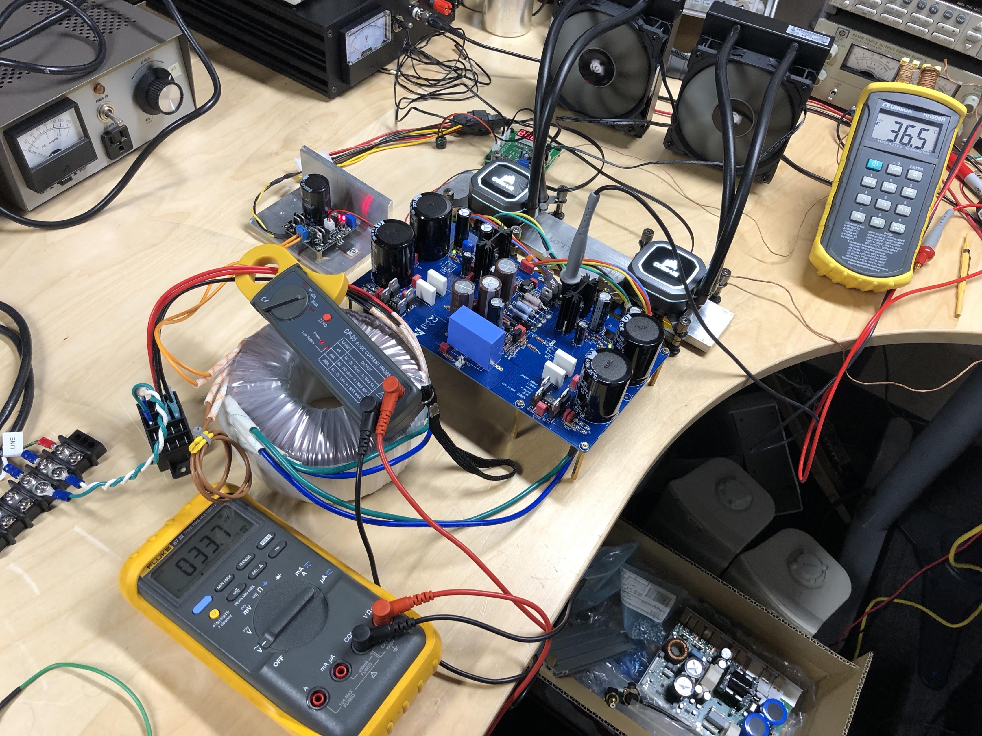

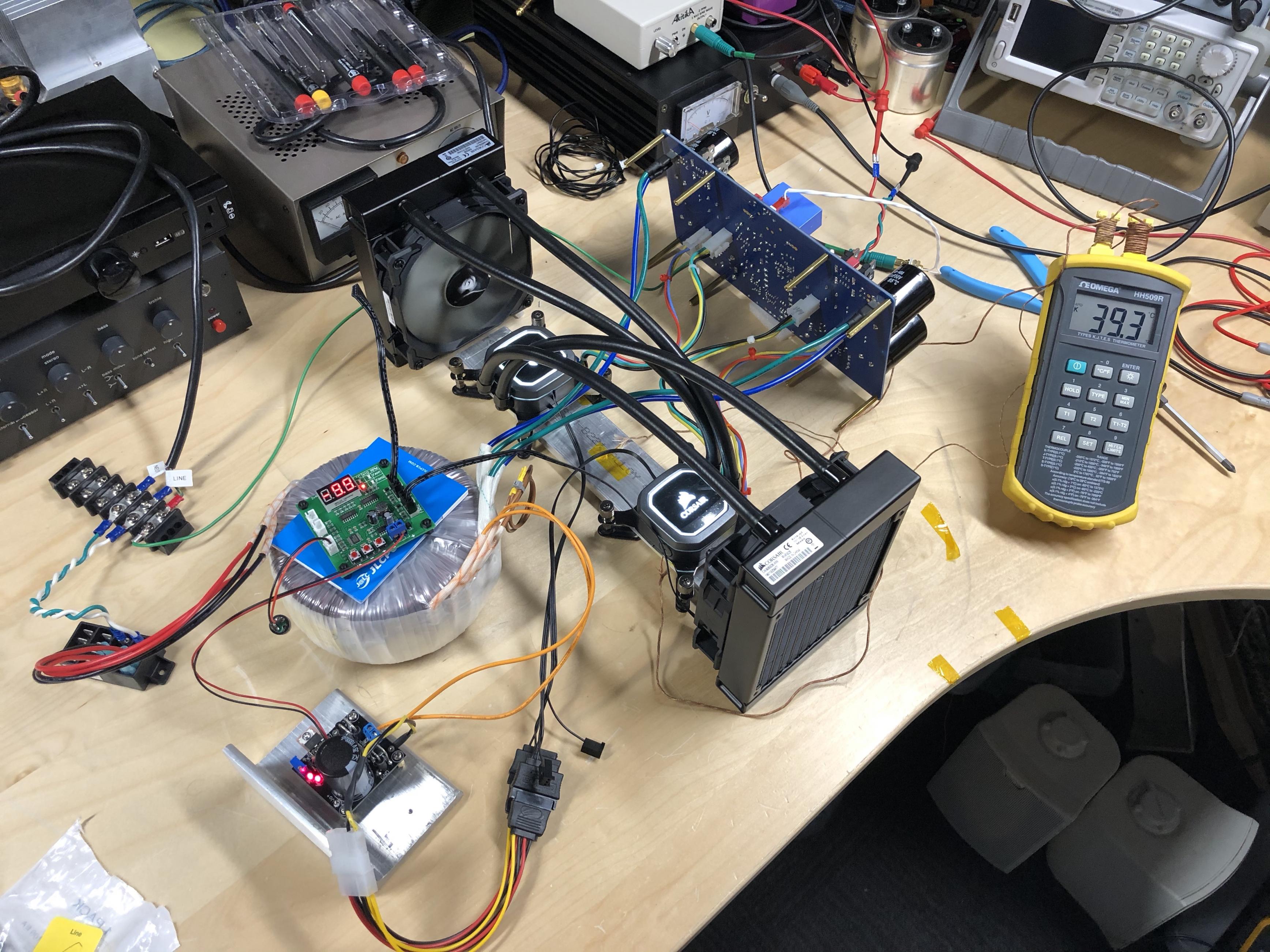

ABBB H2O Build Update

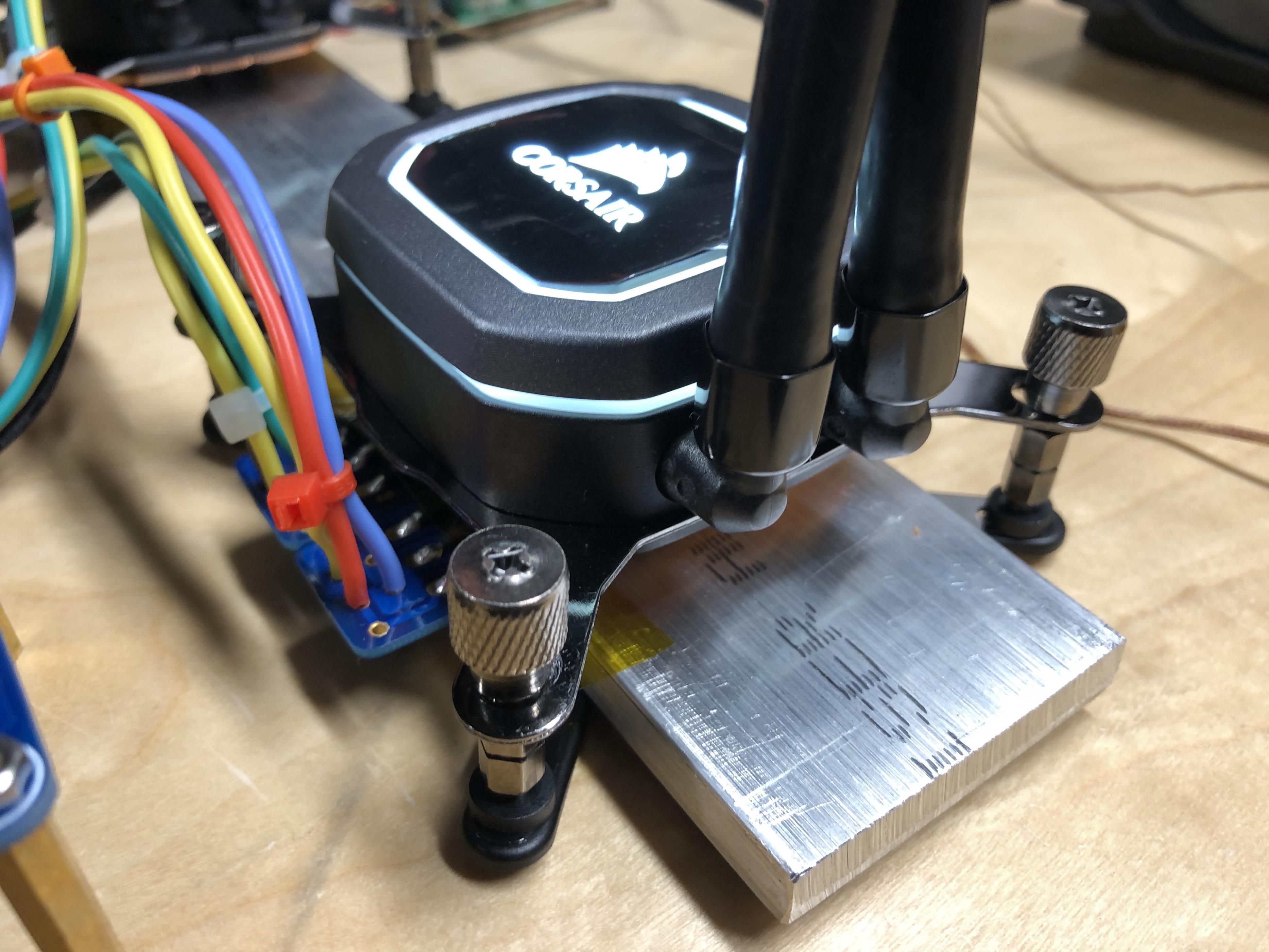

I've finally gotten one ABBB channel soldered, connected, temporarily mounted for my water cooled ABBB build. The MOSFETs and BJTs are mounted on a 2x1/4" aluminum bar using the mounting hardware included with the Corsair H60 all in one liquid coolers. Currently, I am using some SilPad to electrically insulate and thermally couple them to the copper water block. I have some Keratherm I'll use in the final build.

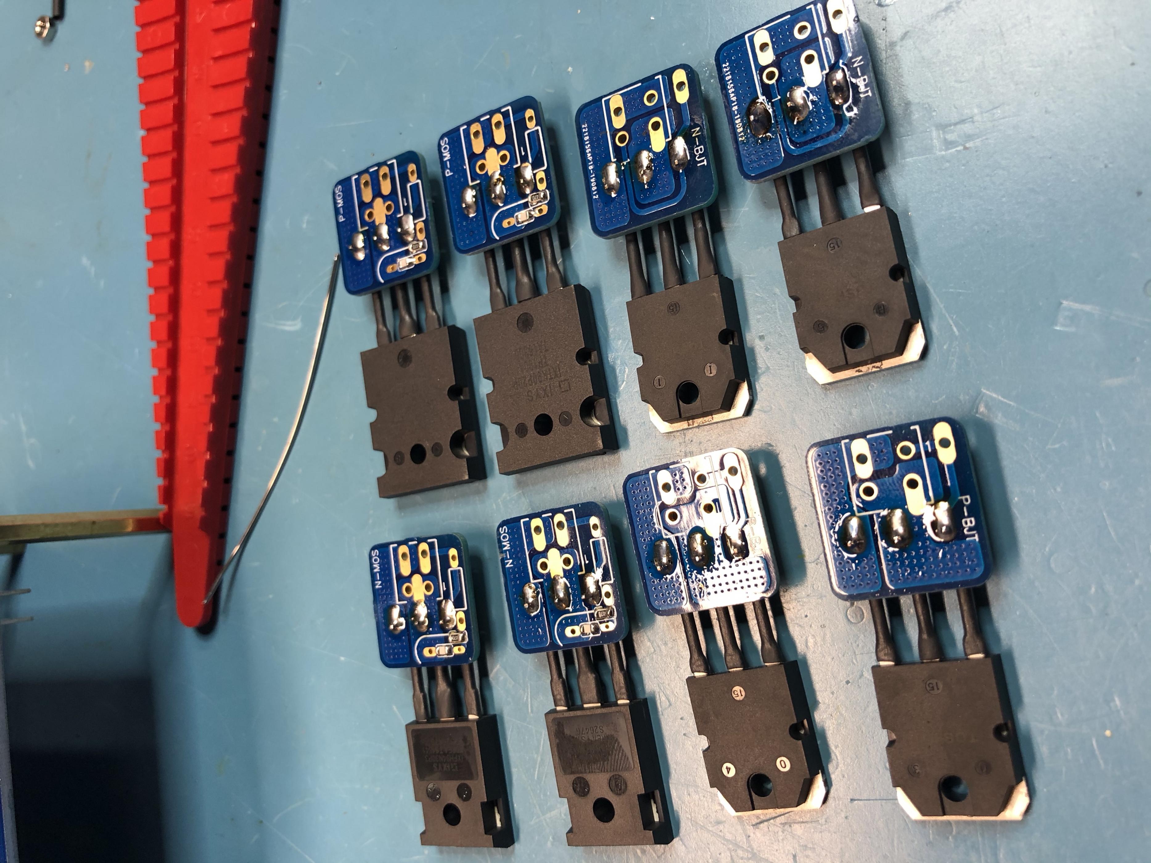

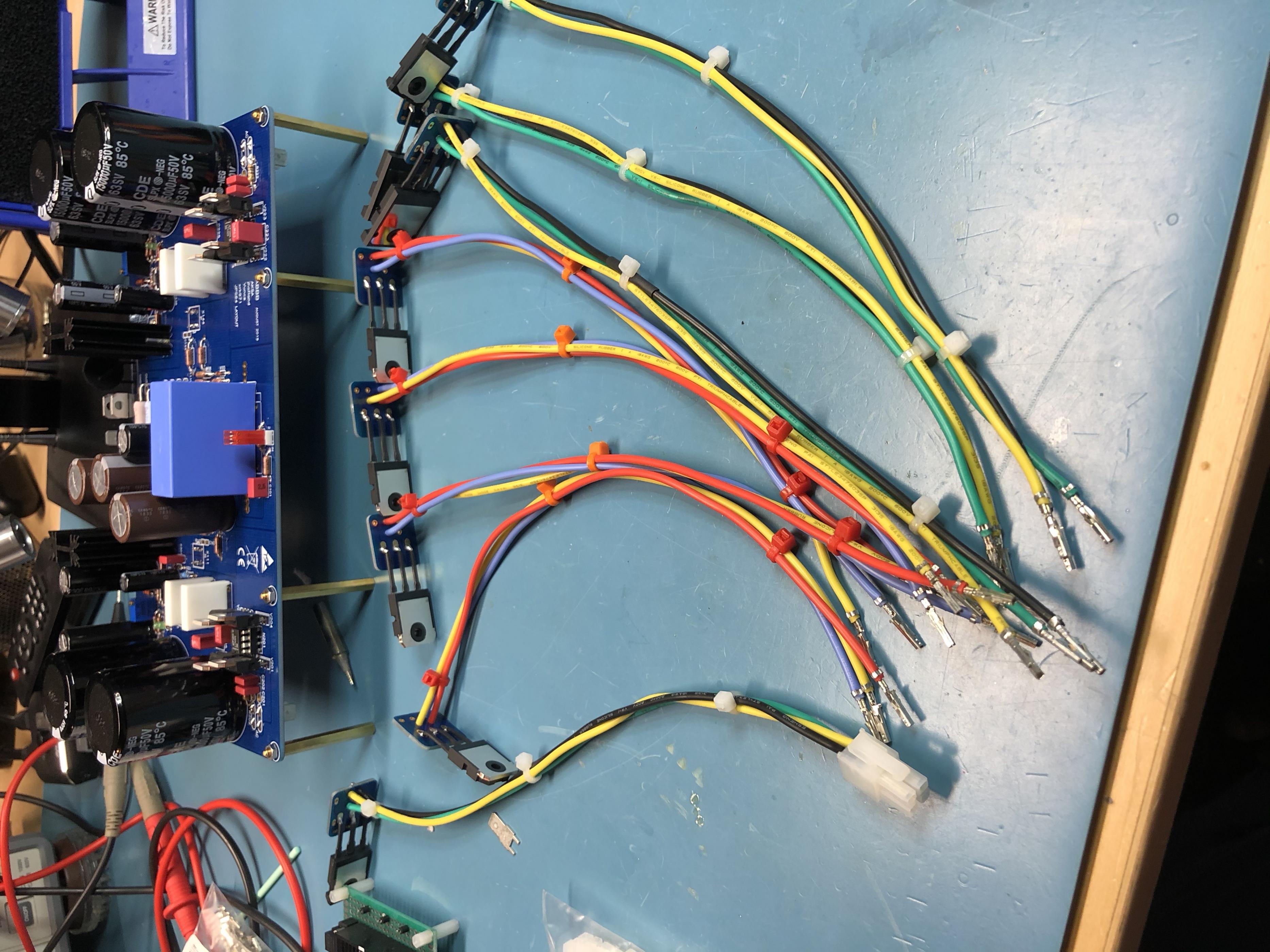

Some build notes:
- If you are mounting both the MOSFETs and BJTs on the same sink using a bar across the top, you'll need to add a 0.02" shim for the BJT to get them level for mounting

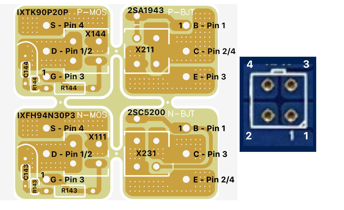

- I proceeded (overly?) cautiously in wiring the connections / orientations between the MiniFit and breakout boards, avoiding any assumptions during wiring. To help wrap my mind around this, I annotated a picture of the breakout boards from the schematic and PCB layout. The pin numbering of the MiniFit connectors was not immediately obvious at first glance and the diagram helped clarify this during the build.
- Be cautious as you place components, there are a few resistors that are a tight fit and they need to be carefully placed to ensure they overlap in a meaningful and safe manner 🙂
- Don't forget to order extra KSA992FBUs (V101, V105) for matching, I'll be desoldering my current pairs and ordering some for matching shortly.

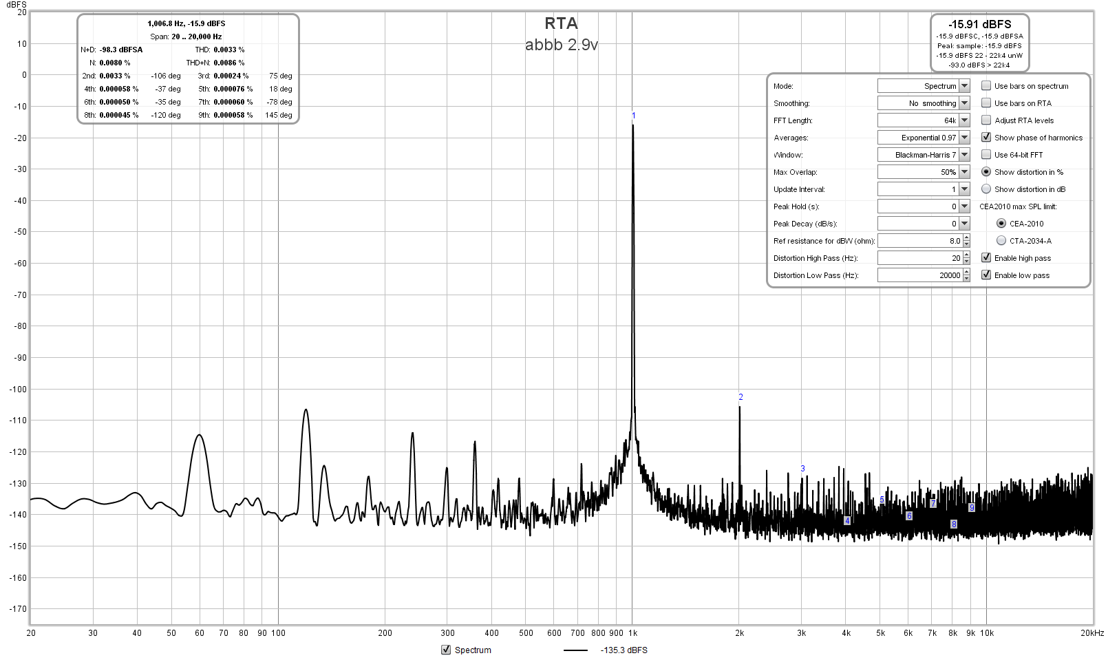

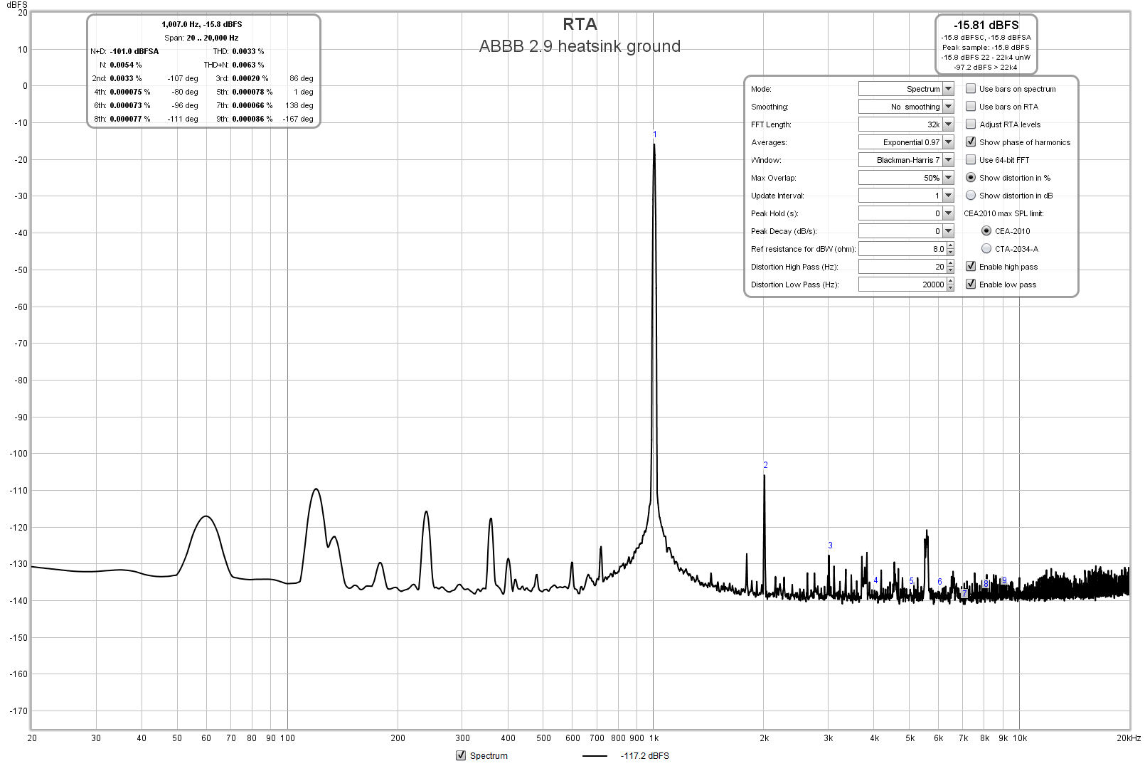

That said, on to the measurements. I've completed the soldering of both channels, but have only hooked one up for testing. My measurements in REW are attached, but here is the breakdown for my tested channel:
- 2.9V@8, ~1W: 0.0033% THD
- 9V@8, ~10W: 0.011% THD

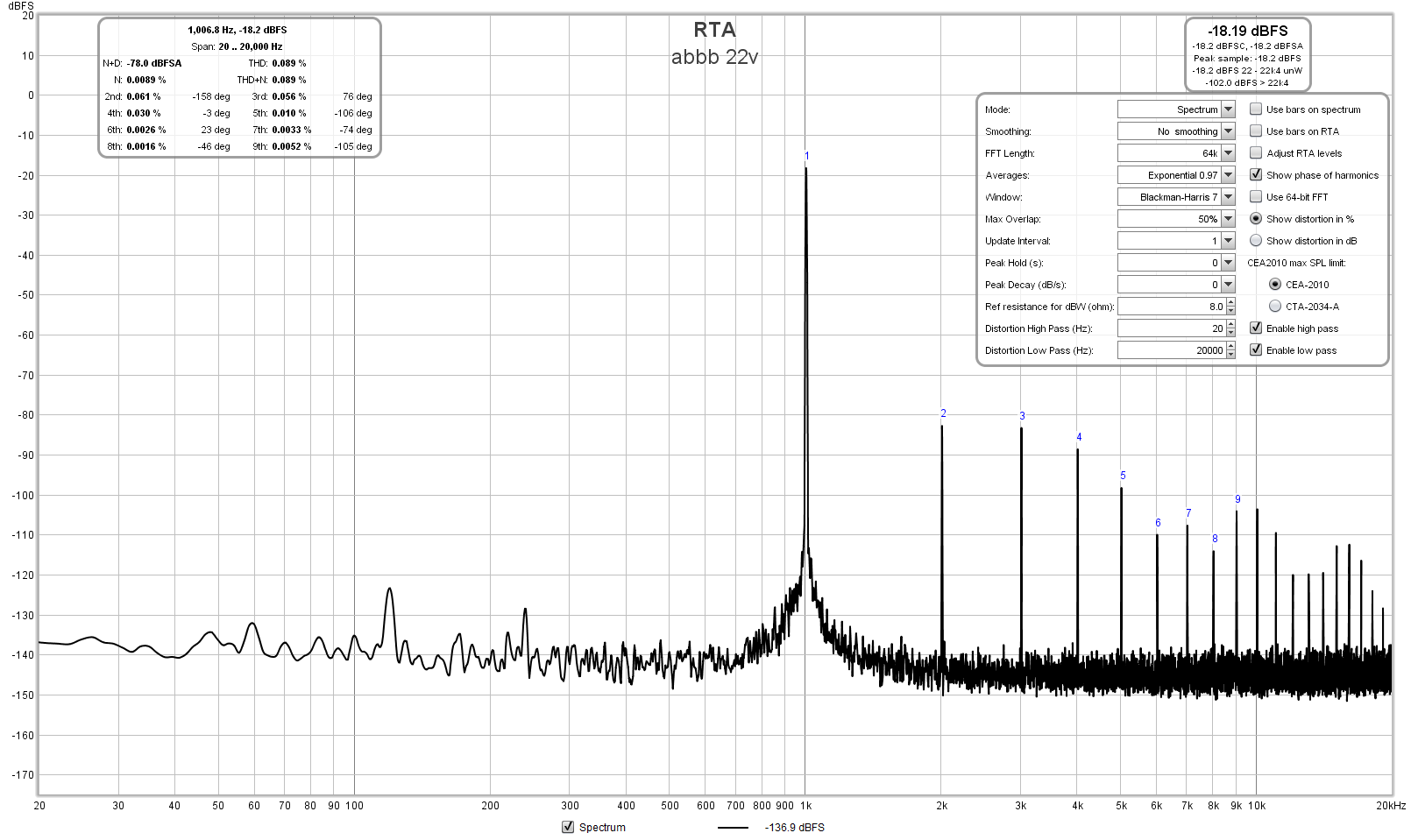

- 22V@8, ~60W: 0.089% THD (60W!!! beyond this we skyrocket into clipping)
Bias: 2.9A (voltage measured across R147 / 0.22)
Antek AN-6432 32V transformer and cap-mx adjusted to be the minimum matching voltages possible given the adjustment range:
- Negative rail: -42.9V before BJT (X231 pin 2/4), -39.4V after (X231 pin 3)
- Positive rail: 42.8V before BJT (X211 pin 3), 39.4V after (X211 pin 2/4)
- AC ripple: about 120mV before BJT, down to 2.5-3mV after
Temperature was measured and monitored during testing on the copper water block. It remained fairly constant at idle after warm up and then with load. Overall, depending on the radiator fan speed, temperature remained between 30 and 40C. I think I'll be able to run the fans under 1000rpm and will likely be upgrading to Noctua fans. Interestingly, or maybe not, the aluminum bar that the back side of the transistors are mounted on is running consistently 10C hotter than the actual cooper block with the dies. This won't be a problem, but when I case it up, I'll likely add a large fan on the top of the chassis to help extract this hot air and the air pulled in to cool the radiators.
Phew... all in all, I think things are running as I had hoped!

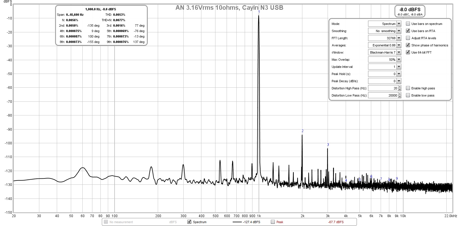

One question about my measurement results. Given that this is a test setup, should I be concerned about the 60hz and 120hz humps I'm seeing? Is this indicative of a ground loop in my test setup? (I am using an ESI Juli@ PCI sound card). For testing I have the PE chassis ground connected to the mains ground. I quickly tested without the water cooling power connected (no fans or pumps) and saw no change and also tested with PE disconnected with no change. I figure this is something that will probably iron itself out in a real build, but want to catch anything early so I can plan ahead. Any other concerns in these results that I should look into?

Gtose,
This is superb work and you are true pioneer! Congrats on the very first water cooled ABBB! (or maybe Alpha for that matter?)
The measurements are excellent and the 60Hz/120Hz peaks you are seeing are consistent with what I have been seeing with SLB. I am getting about -115dB for my mains hum peaks on the Alpha Nirvana. This is running 3.4A so in similar ballpark as yours. You might be able to clean it up a bit more by running a ground wire from the aluminum clamp bar to chassis ground star hub. Also, once you put this in a metal box, it helps. I have also found that an NTC like 8D-20 on the trafo primary to serve as a soft-start, and it also seems to reduce the 60Hz peak. Be carfeful though, it runs hot enough to burn if you touch it.
Thank you so much for taking this project all the way through to the REW measurements! I did not expect the harmonic profile to look this good, nor the THD to be this low (0.003%) at 1w. And to be able to hit 60w! Yaoozaa! 😀
I really like how compact the water cooling setup is! Do you have a link to the particular unit you bought?

I just noticed that Gtose mounted the Minfit Molex underneath the PCB on the bottom side. Interesting! You really need to manually check the pinouts on that one!

Thanks all of the kind words and motivation to test the other channel 🙂 X, also thank you for the clarification and comparison on the mains bumps. I'll test grounding the mounting bar and see if it has an impact.
I just tested the second channel and it has a little lower rails voltages, so reduced the cap-mx drop a hair to get the voltages close for each channel. Test results were nearly identical. I still need to test the other set of transistors.
I am using a Corsair H60 (2018 version): https://www.corsair.com/us/en/Categ...2018)-120mm-Liquid-CPU-Cooler/p/CW-9060036-WW
I'm waiting to see if the price drops before buying the remaining 2 for the second channel.
Yeah, hence the annotations on the breakout board and MiniFit connectors 🙂. I will be mounting the ABBB vertically and will have the power wiring and transistor wiring going on the bottom side through cutouts on the mounting plate. This will allow all power wiring to head one direction and all I/O to head the other (very close at the back of the amp). The transformer will be mounted vertically at the very front of the amp on the opposite side of the transistors / watercooling to get it as far away from the ABBB as possible. In my initial testing (shown in the attached pic) I had a lot more high frequency hash when the transformer was mounted near the ABBB.

Thanks to X's recommendation, I successfully reduced the 60hz by grounding the heatsink bar to PE/chassis ground. 60hz in the RTA went down 5db and overall noise went from 0.0066% to 0.0056%. Attached is the new spectrum at 2.9V/~1w. I can't imagine how clean it'll look with proper wiring and placement!
