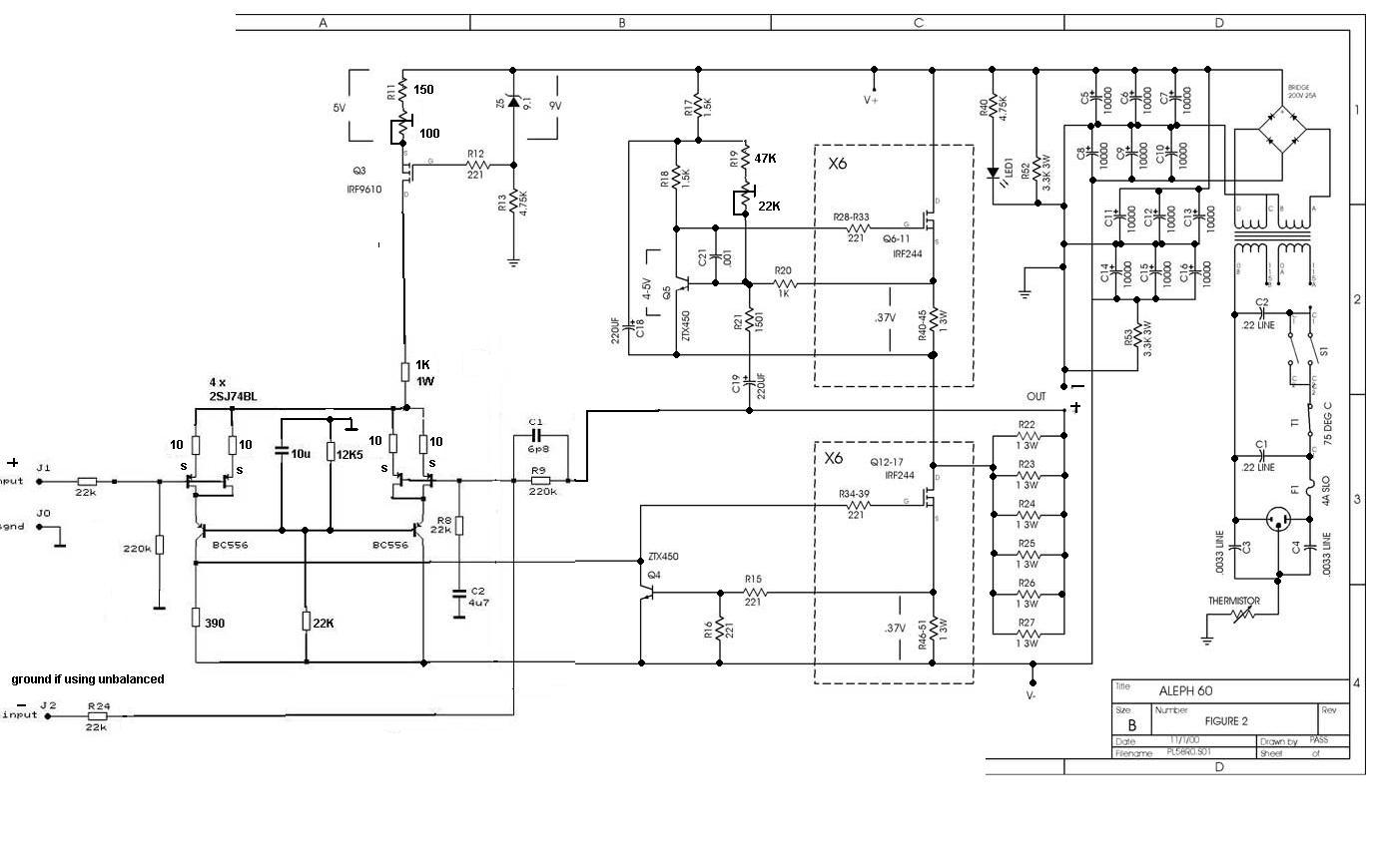

Since then, playing with this sort of circuit and with different devices and such,
I decided that there is a stability advantage to having some resistance off the
Drains of the input devices when cascoding. This means 100 to 200 ohms
or so between the Drain and the Emitter of the cascode transistor. I have
seen several examples tend toward oscillation, often fixed by a lag resistor
(Drain to Gate) on the outputs, but traced to the low impedance seen by
the input device Drains (the Cascode).
So if you run into this issue, you can try this. Or try it anyway...

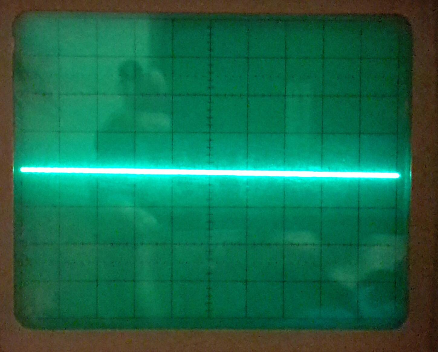

Currently I'm building an Aleph 30 with BrianGT boards. This Thread came just in time before soldering the mosfets. Now I am sourcing 2sj313.
But here is another 'problem':
I was wondering about the modification of the resistor in series with the zener diode.
On some other sites I read that zeners below 5v6 (real zener effect) have lower noise than higher 'zeners' (avalanche effect).
I took a 4v3 and a 5v1 zener in series and here are some 'screenshots' of my old hameg scope.
First picture: 9v1 zener. I see some noise.
Second picture: 4v3 and 5v1 in series. At least on my sccpe very low noise.
Could someone please tell me why?
Ulf
The 9.1V are somewhat noiser. They run quieter with more current, which
is why I lowered the value of the bias resistor - it was close enough to the
edge that occasionally there was excess noise.

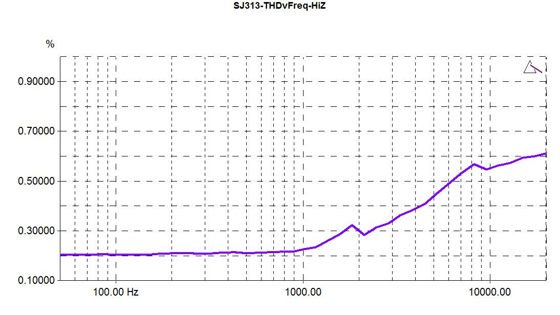

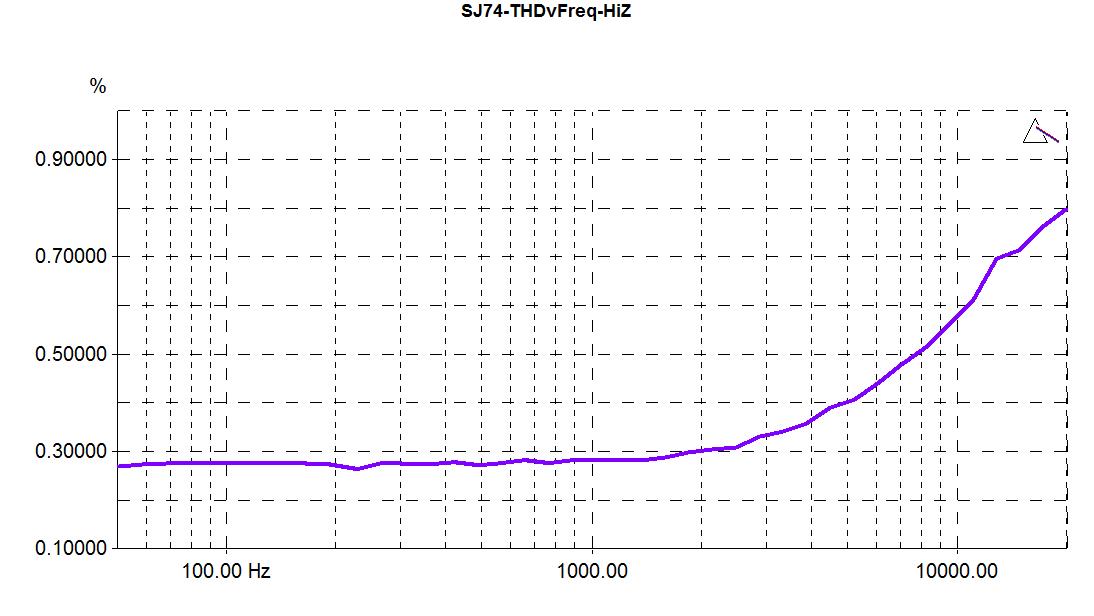

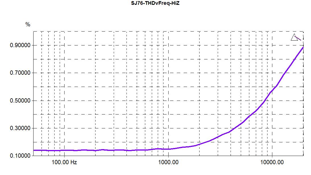

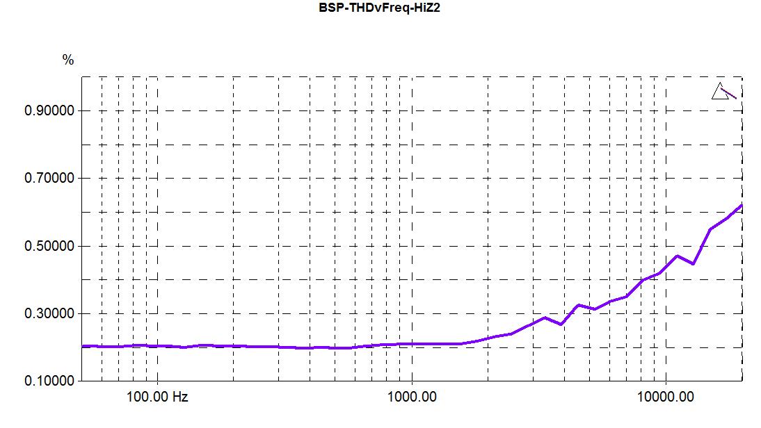

the great 2015 front end fet shoot-out
i made up a small front end test bed to compare a few of the candidates for the Aleph. The lineup includes the 2SJ74 JFET ($4), SJ313($2.50), Euvl's suggestion of the SJ76 ($10) and a fet from the Infineon BSP range (0.50)
For all the devices except the 2J74, the load was 390R in the drains of both fets. The devices were run with 10mA bias each. I wanted to test intrinsic linearity so I measured just the input stage (naked, without any feedback) across the load resistors with H2 nulled out.
For the 2SJ74, the load resistors were 1K and bias was 5mA each. I used 10mA Idss fets.
All measurements were made at 0.5V RMS and the fets were driven at high impedance (10K) to get realistic results.
results below ....
