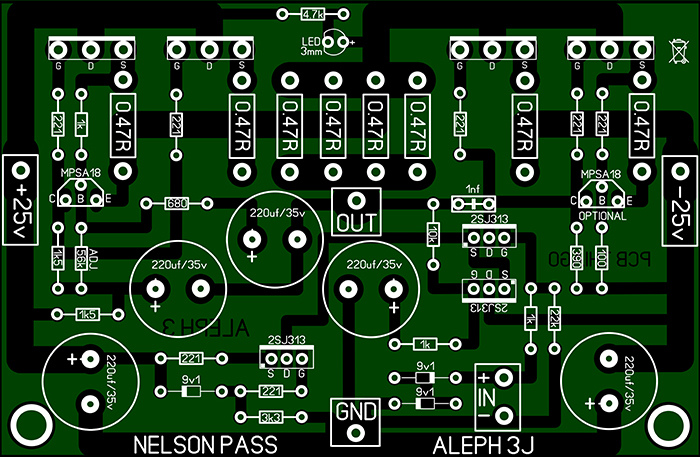

Anyone have pcb layout to share? thanks Papa for mods
This will work -- Aleph through-hole PCB Set | Chipamp Electronics

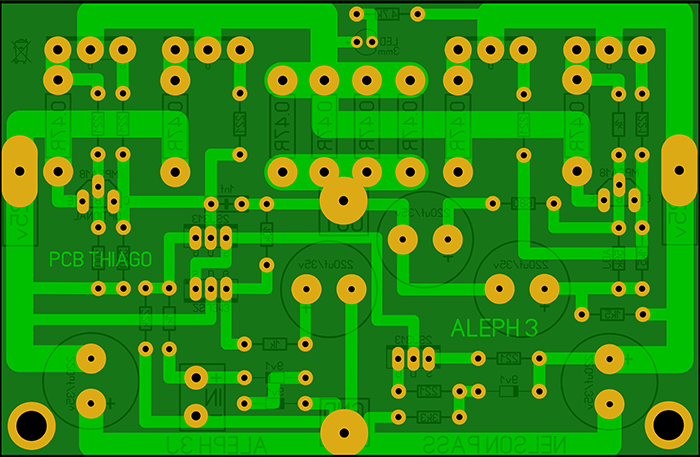

bumble bee
without looking further (having nerves only for my own pcbs ) - outputs need to be closer to the edge
Thank ZEN .
8mm is too much?
I will try to decrease without affecting the rail of the mosfet .
Best Regards
8mm is too much?
Best Regards
maybe turn the 2 matched SJ313's around so the they are back to back and thermally couple them together. or side by side so they can share a smal sink or a smal alu sheet.
Break the trace between GND and -IN, add pads for jumper.
Balanced input (XLR) needs that separated, but if the builder will use RCA exclusively, the jumper can be installed.
Can you also add pads/holes on the capacitors for 7.5mm and 5mm lead spacing?
