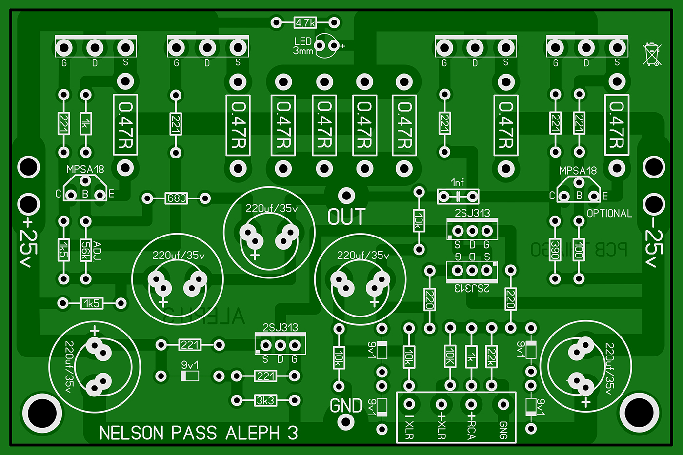

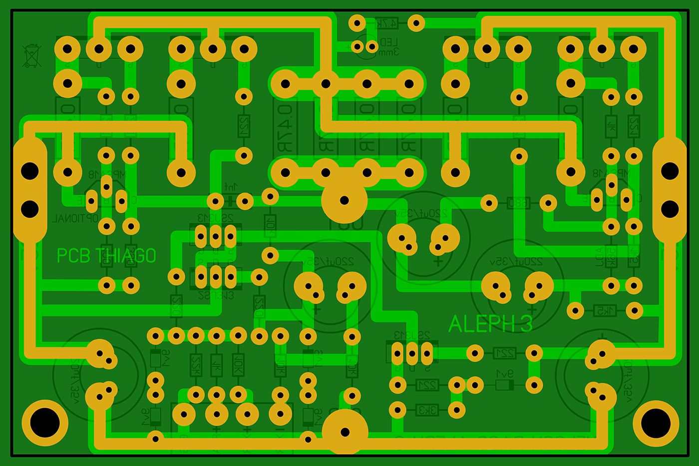

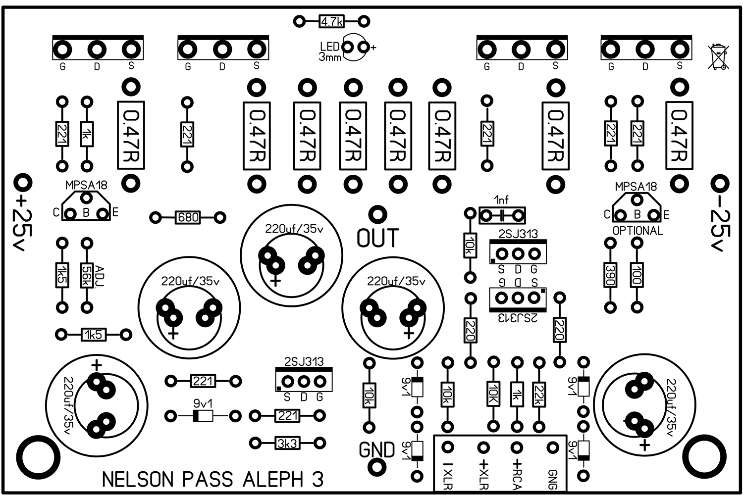

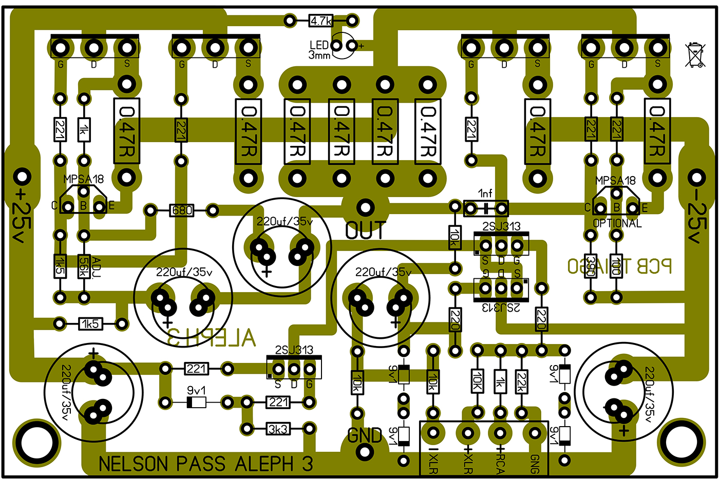

Break the trace between GND and -IN, add pads for jumper.
Balanced input (XLR) needs that separated, but if the builder will use RCA exclusively, the jumper can be installed.
Can you also add pads/holes on the capacitors for 7.5mm and 5mm lead spacing?
aleph3 is not a balanced amp 🙂
Oh, I guess you're right... I'm so used to the diff. pair being able to be fed from one or both sides... It wouldn't be very hard to add, just 2 resistors. 🙂

Capaciitor 5mm and 7.5mm
Mosfet 6mm edge
XLR and RCA input
better?
Add additional holes to +/- 25V & GND to accept larger 14/16ga wires. I'm not sure how thick your heatsink plate is, but you might want to try and separate your output mosfet pairs a bit more for thermal spreading purposes. If you have a 3/8" or thicker plate it probably will not matter.
Also slide the 1nf cap near the input LTP to the right or move the 10k resistor to the left.
