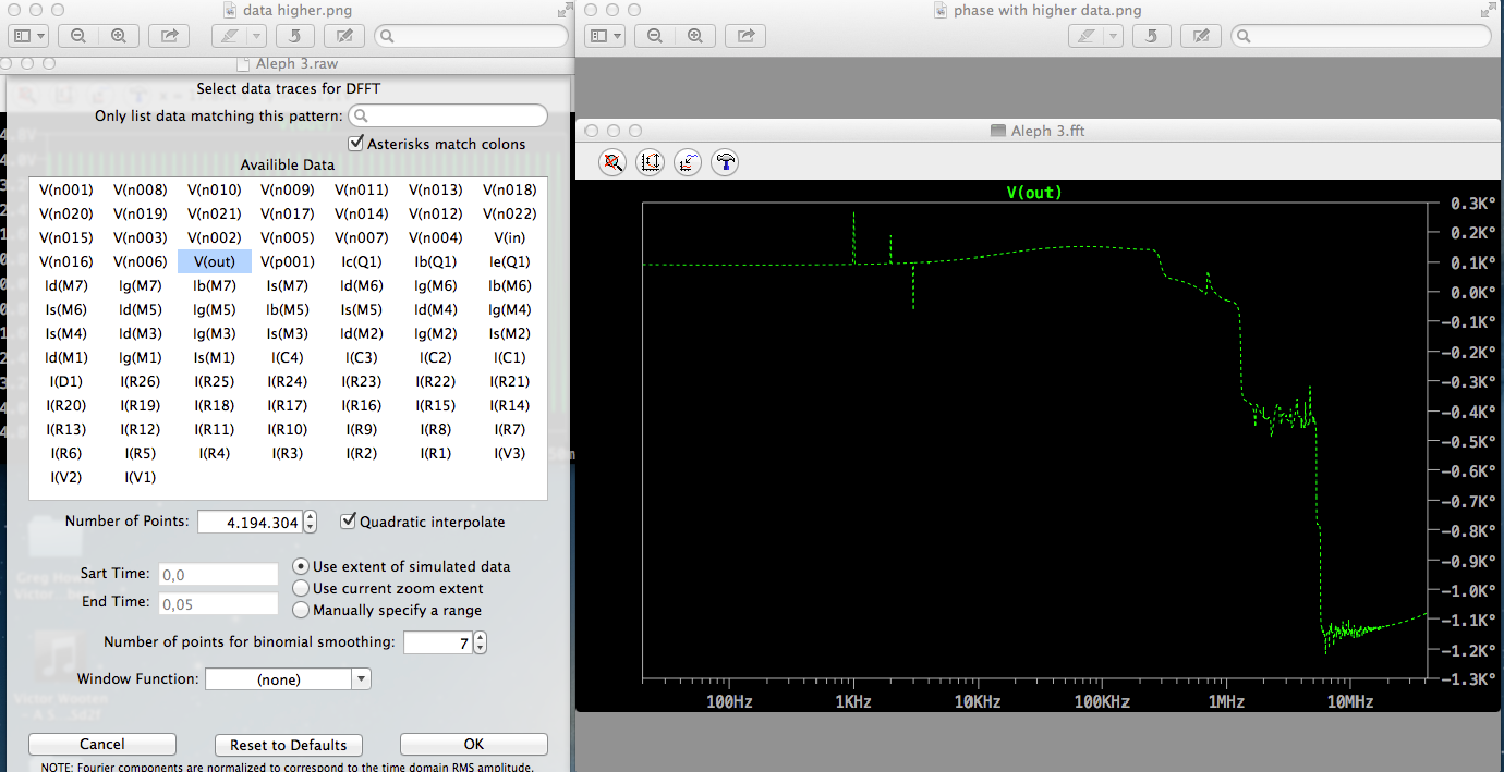

The 1022 FIR filter for the range 1500.-3500 seems change time alignment.
David advices to extract only from point 512 - end of file.
This seemS to make the correct time alignment with the fundamental wave.
I would never have found this.
I plan to show the different results you get with Spice and the Aleph 3 circuit as well ....hope you have an eye on it and I am sure you can help to find the reasons why Spice used by an unexperienced user delivers contradictory results concerning the k 2 phase.

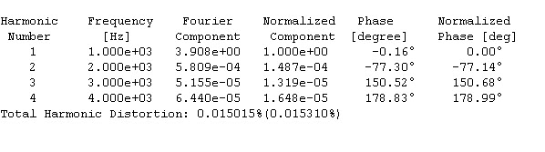

I just realized that my post in #245 http://www.diyaudio.com/forums/pass-labs/267857-aleph-design-reloaded-25.html#post4802935 did not show the harmonic phases. Note the plots show negative K2 phase whereas the numerical value of K2 phase in the log file is near +90 degrees. My comment in post #240 about the numerical value being near -90 degrees WAS INCORRECT. Here is what I intended to show:

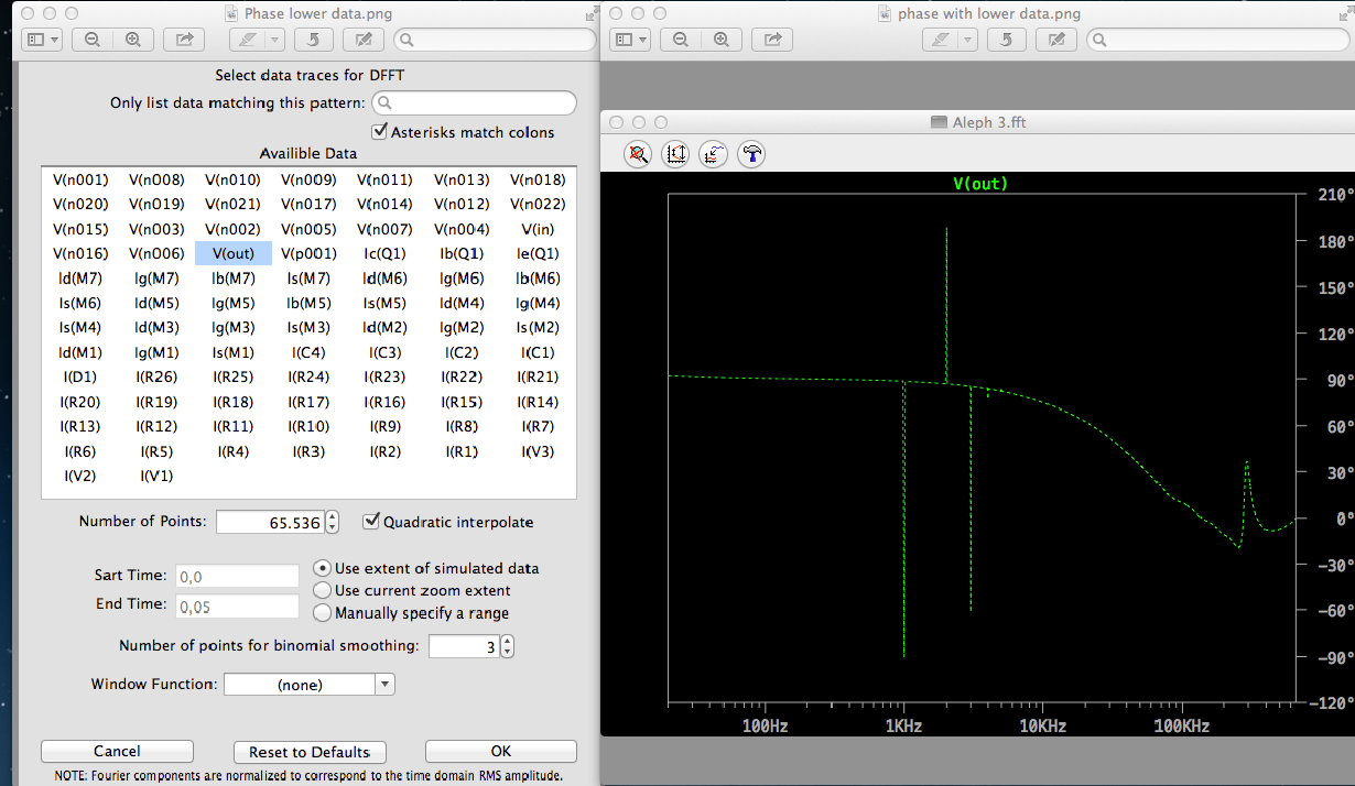

are these data in the error log made without any window?
no "Blackman" or something like this?
and are these numerical data the same data I see in the graphical FFT picture when I choose no window function?
same routine I'm always using
run , after that right click on graph , see error log
prior to anything - disabled all compressions in control panel
regarding FFT - 4M data point samples , number of points 7 , Hamming windowing function

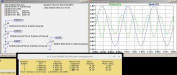

The Fourier data in the log file is not identical to the FFT plots, but there are quite similar and do not suffer from phase shifts due to the windowing functions. The windowing functions are totally symmetric and thus do not phase shift. In the plots of post #283, theta= 360*time/1ms K1(theta) = H1*sin(theta) relative phase of K1 to itself is zero K2(theta) = H2*sin(2*theta+90) relative phase of K2 to K1 is +90 degrees
Does this mean that you can have neg phase k2 but degree value in the log is positive as shown in our last picture.....?
Yes.
- theta= 360*time/1ms
- K1(theta) = H1*sin(theta)
- relative phase of K1 to itself is zero
- K2(theta) = H2*sin(2*theta+90)
- relative phase of K2 to K1 is +90 degrees

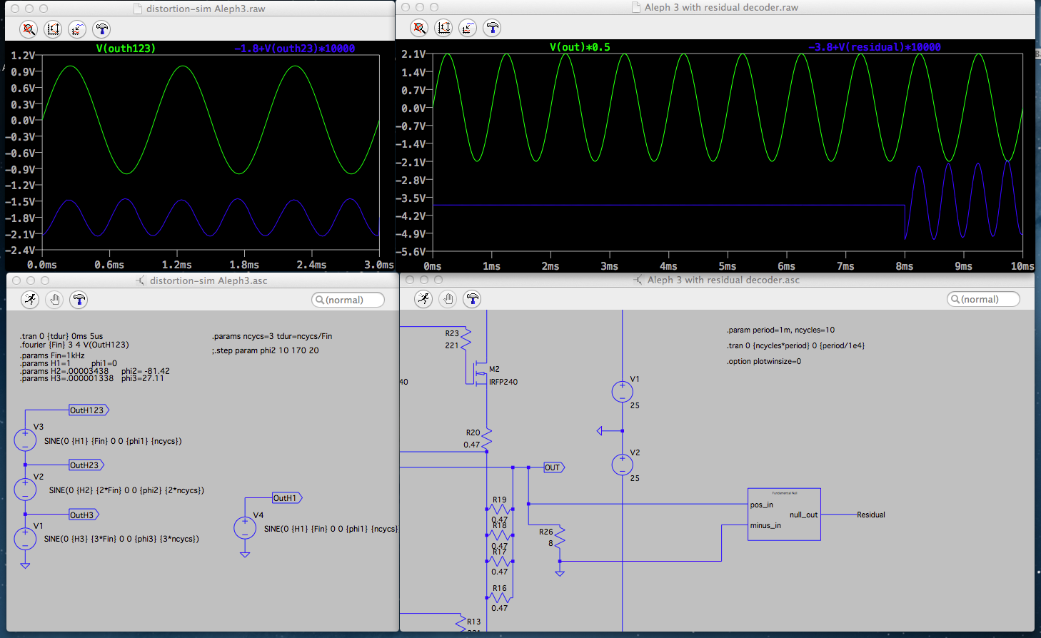

@lhquam
Do you know why the two residual programs distortion sim and the distortion decoder deliver the wrong phase residual for Aleph3 in Spice simulation,
or do I make a fault?
I used the circuit with the small correction of Nelson here
http://www.diyaudio.com/forums/pass-labs/267857-aleph-design-reloaded.html#post4184920
THX
left distortion SIM and right the residual decoder results
The plot on the right showing positive K2 phase doesn't make sense since it also shows negative K3 phase, which seems unlikely. Was the right plot with higher output Wattage?
no only with a higher number of points chosen….same circuit same in and output.
I wanted to show that simply changing the number of points gives another information.
So there seems to be be no explanation why the Aleph 3 spice simulation tools, that show the residual, are wrong showing pos phase k2. In real, the Aleph 3 shows neg phase k2.
