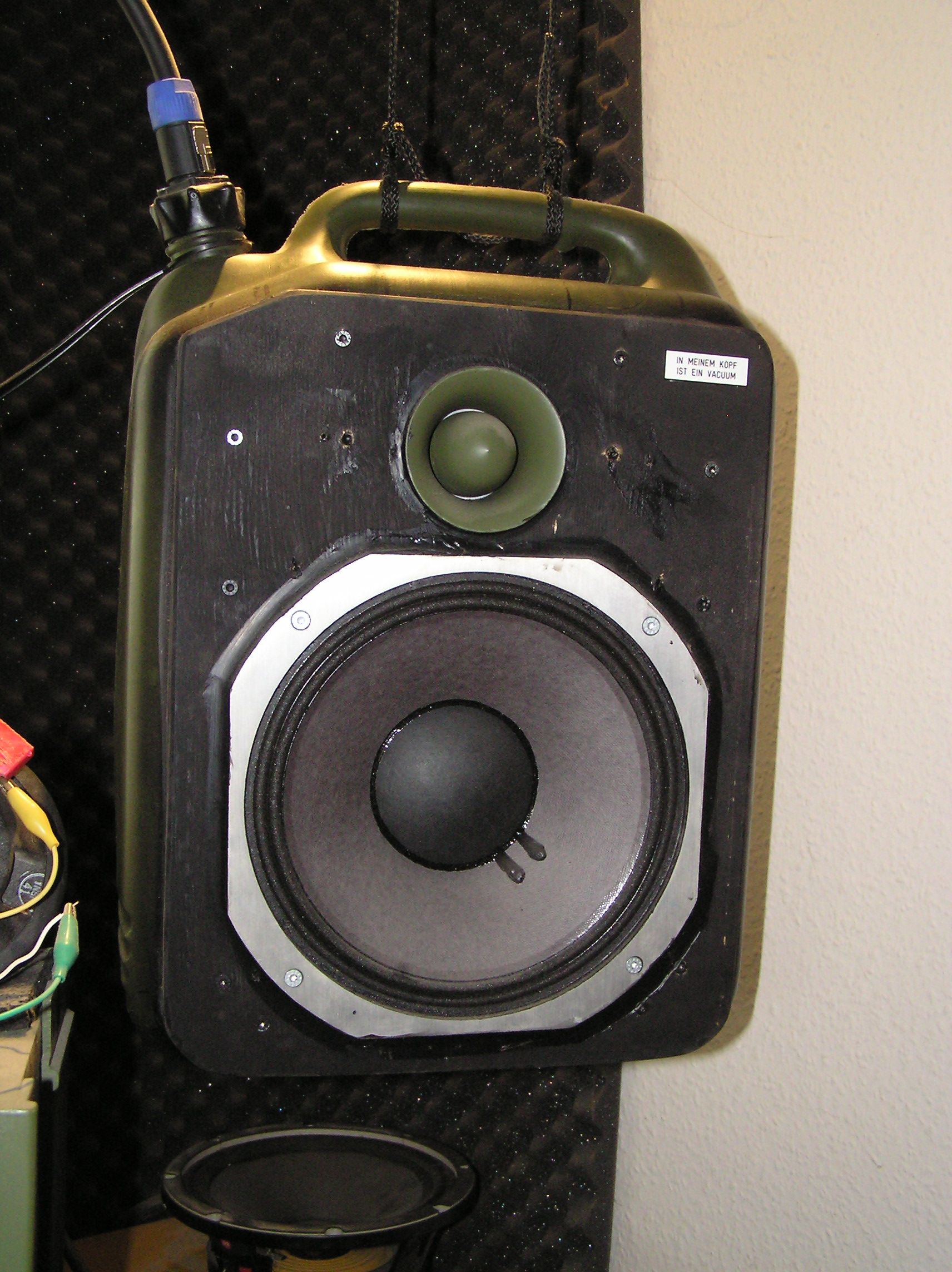

:) so just to make you great guys laugh a little,and to show im not afraid of pro equipment
this is the top of my little party system
jbl 2123,2402,driven by bss omnidrive,3khz dividet,serious old amping,they are for the compromise to squeeze it in plastik jerry can very fun to listen and people are wondering how loud they are,box has compete inner outline with wood than foamed took me two weeks to build
have a great sunday all:D:trapper::)

The "2402" was probably stolen from an ultrasonic traffic control station, and contains a 2405 diaphragm, which in the 2402 housing makes for a rising response peaking around 21,000 Hz.
