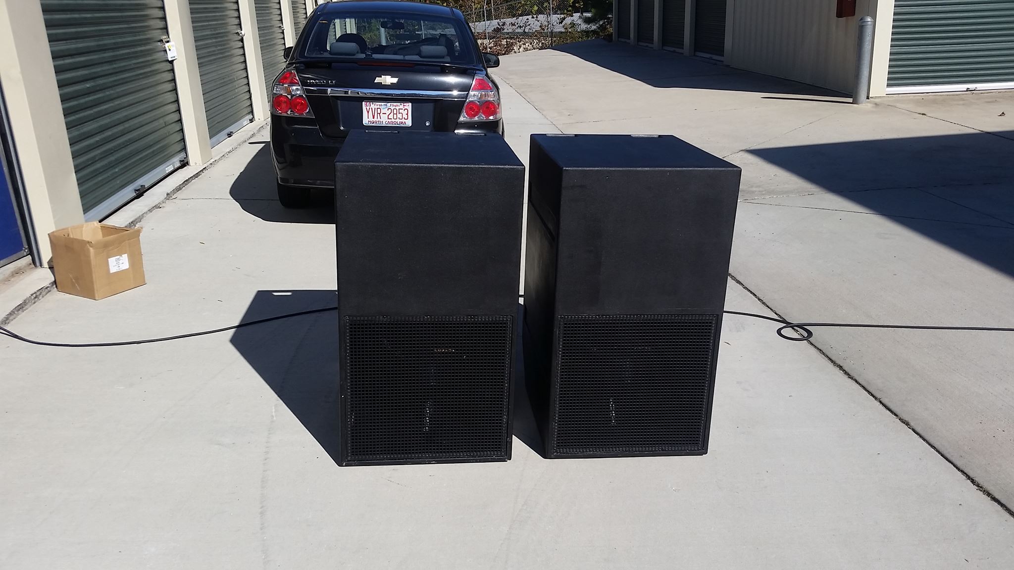

well guys heres a pic.
I had to put the project on hold from this point, as I've had a busy last 4 days since I took this pic. got to soundcheck em. a bit dissapointed I can hit excursion limits (distortion) witha bridged macrotech 3600 (into an 8 ohm cab), but they are damn loud before that point.

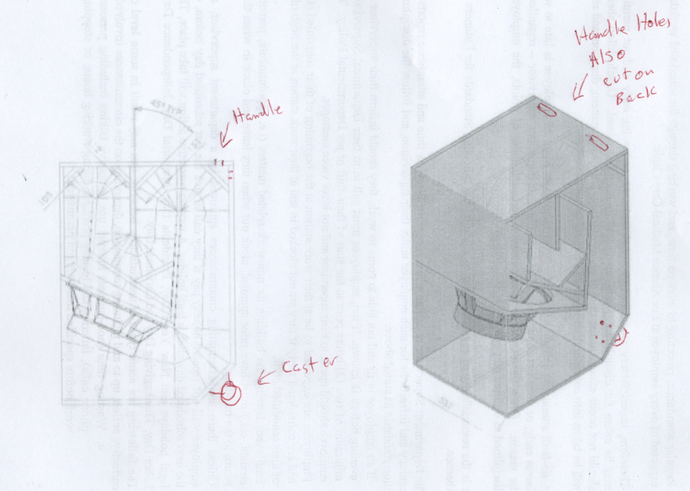

forgot to ask....adding handles etc...obviously handles will take up space inside the cab, however small...does this effect the sound in any way?
is this a stupid and pointless question lol?
Handles don't need to take up any interior space.
You can cut the angles using a circular saw and a long ruler clamped to the wood as a guide.
I agree with sine 143 that the Keystone is a far easier build, but it is a bit larger (and louder).
Art
