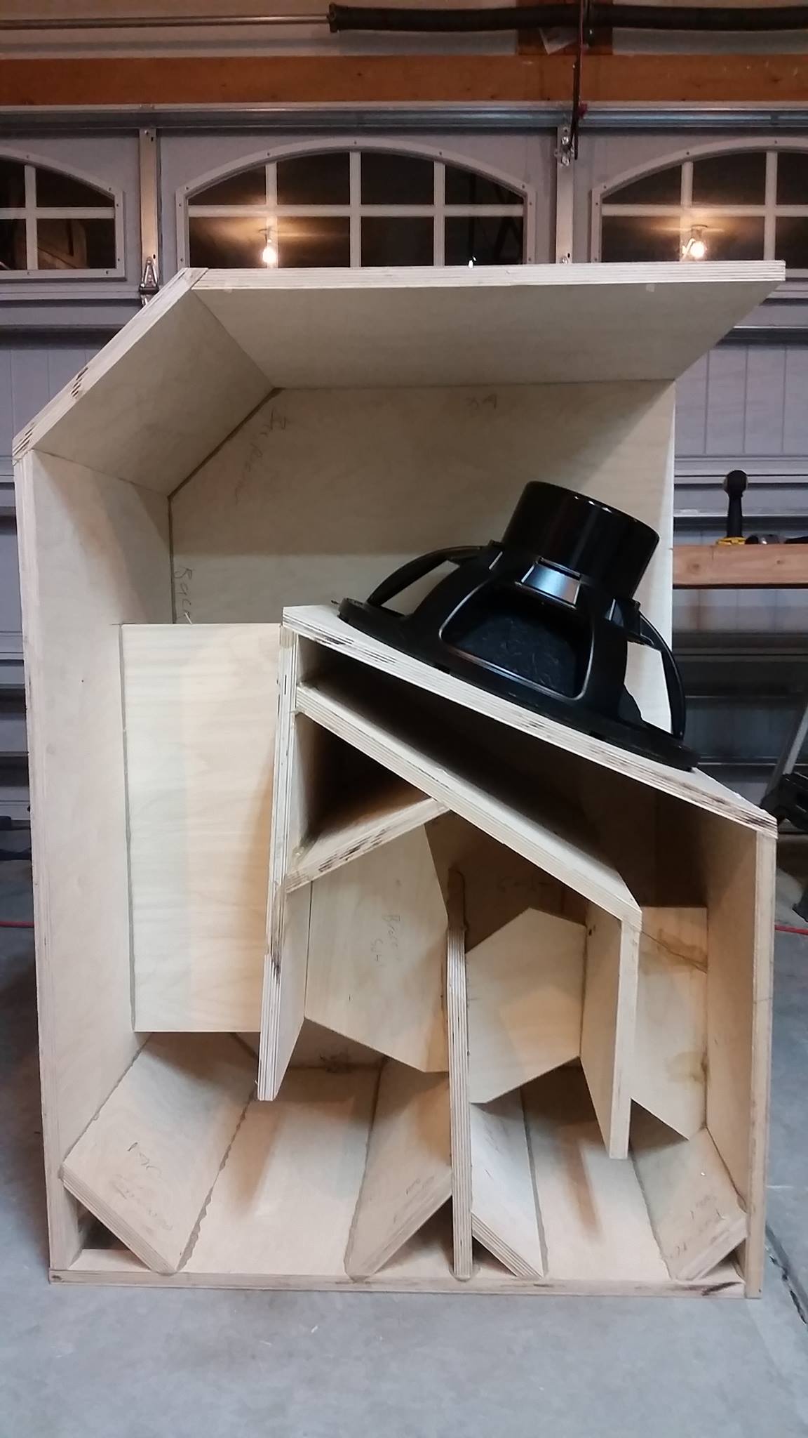

are those 18sound 18nlw9600 ?Well well well. What do we have here

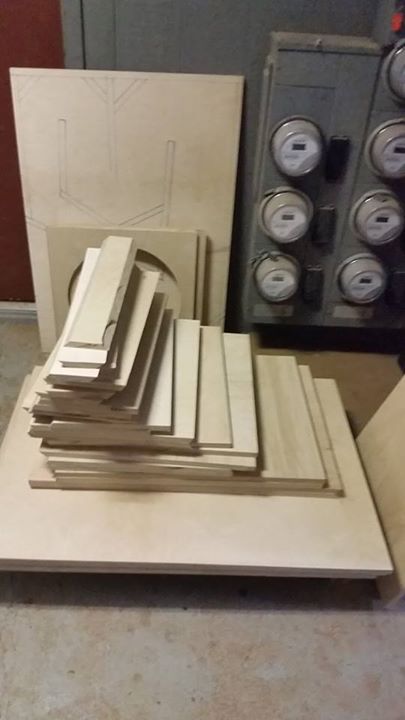

lol... its far from perfect, I had to pull the front panel about 3/8 of an inch in when attaching side 2 (got off square). THankfully clamps helped me do that.
The braces are me, a handful of explitives and a compount mitre saw lol. as you can see I broke that back brace into 2 pieces (2nd piece not pictured) to make the cuts easier.
