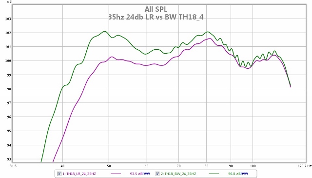

Optimal High Pass
Gents,
While playing around with measurments and settings on my DSP I found that I get more output in the low end of the pass band if I select Butterworth instead of Linkwitz-Riley.
I wasn't paying attention to the fact that Q is higher on Butterworth? and the level at crossover is different between the two of them.
There is a lot of output close to the 35 hz area, but it gets critical quite fast as you go below the loading from the horn, so Isn't it all about having the steepest slope possible when talking sub high pass?
Can anyone share - or recommend High Pass settings?
I am using B&C18SW100 and cone correction from Djim.
Greatings, Andy
