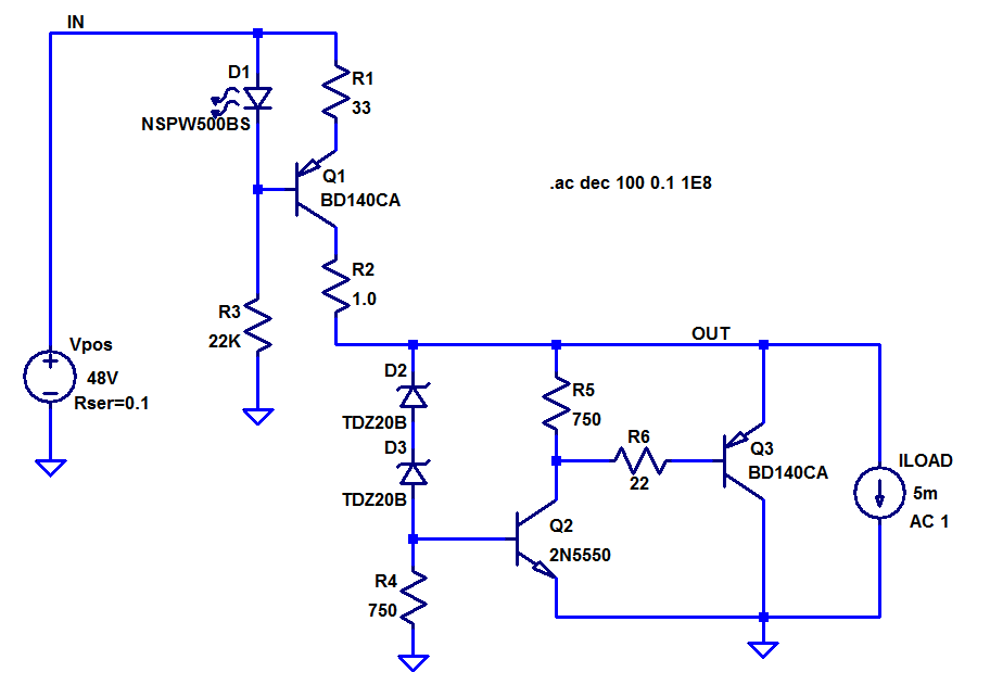

The easiest way to decrease PSU output impedance by a factor of 100X, is to increase the open loop gain of its error amplifier by a factor of 100X, since
In the circuit of post #134 image_1, that would mean replacing R16 by a current source, and also replacing Q7 by a Darlington or a CFP/Sziklai (drastically reducing its loading upon the collector of Q6).
- Zout_closedloop = Zout_openloop / (1 + openloopgain)

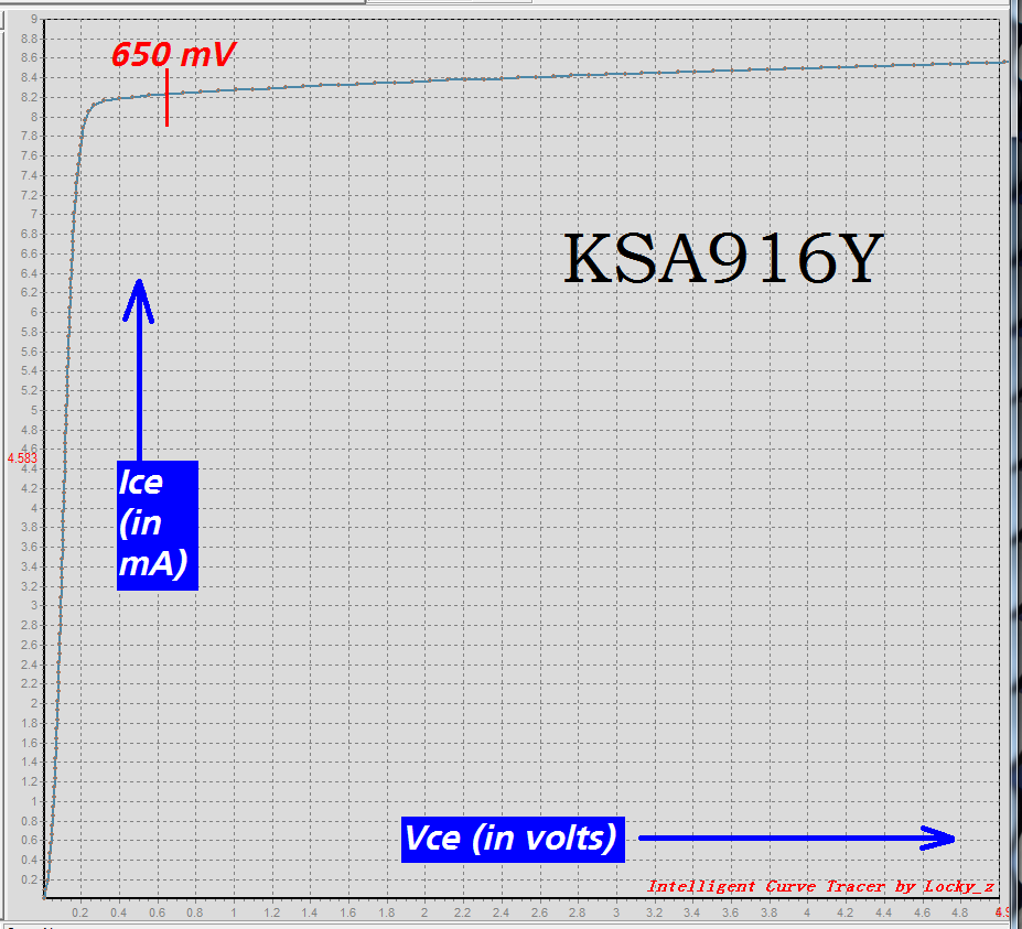

This was my thought too, but then I wondered if this is feasible ? - there's very little voltage headroom here, R16 drops only 650mV since it sits between base-emitter of the shunt transistor. This is why I simulated an extra gain stage, another BJT cascaded to the design I posted. It increases the OLG as you say, by around 20dB if I remember. I can't post any attachments from my simulation right now as I'm not at my usual computer.
Joined 2009

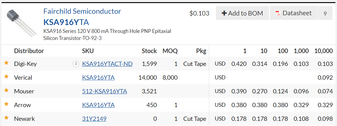

that's a nice low Vce(sat) - I'll try a simulation on this one, looks promising indeed. I may opt for an SMD transistor, I'll check the Digikey catalogue for options.
Edit: e.g. BSS63LT1G from On-Semi
https://www.digikey.ca/product-detail/en/on-semiconductor/BSS63LT1G/BSS63LT1GOSCT-ND/2120567

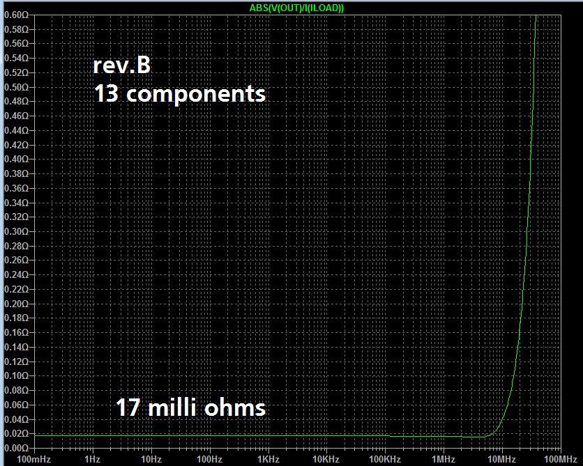

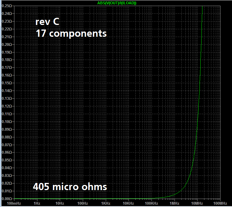

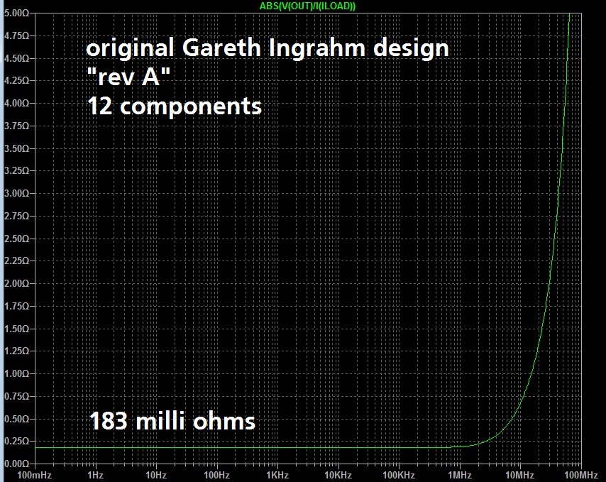

The positive half of Gareth Ingram's dual regulator in post #134, uses 12 components. Its output impedance at low and medium frequencies is 183 milli ohms. See "rev A" below.
If we make a slight alteration to the design, following one of the suggestions in post #162, the component count rises to 13 parts, while output impedance is cut by a factor of eleven, to 17 milli ohms. See "rev B" below.
If we make a second alteration, following the other suggestion in #162, component count zooms up to 17 parts, and output impedance falls another factor of 40X, to 0.405 milli ohms. See "rev C" below.
Regrettably, these alterations do include "original research" as Wikipedia puts it; they are not pure copies of a published, working, known good design from a celebrated Name Designer. So they may not align with the philosophical goals of this project
However the simulated performances are quite pleasant.

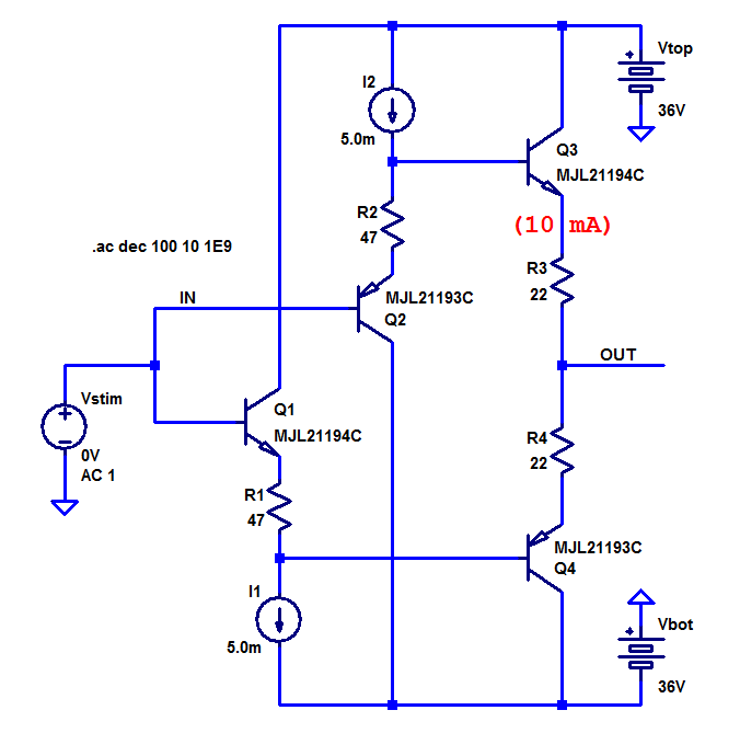

I was thinking. Diamond buffer with high voltage ( +/- 30 ) voltage amp and CCS. It could rival many op amps. We should be thinking of a very high input impedance into the buffer so who knows how good it could be. PDF gives some idea.
http://www.ti.com/lit/an/snoa725a/snoa725a.pdf
Joined 2009

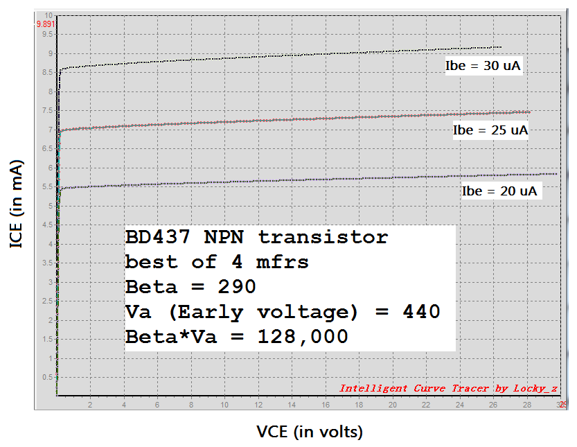

Implement the diamond using the complementary pair BD437/BD438 . Automatic, guaranteed bandwidth limiting via device selection.
BTW the NPN device has one of the highest Bob Cordell transistor figure of merit numbers (FOM = EarlyVoltage * Beta) that I've ever measured.
