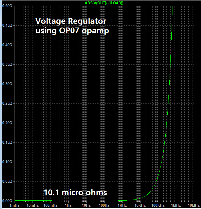

My little preamp instrumentation power supply uses a single low cost opamp and gives quite pleasant Line Rejection (a/k/a PSRR) across the spectrum from DC to supersonic. But some people refuse to even think about using opamps.
And what is the Zout of this one?
10.1 micro ohms. It starts to roll off sooner than you might wish, thanks to the anemic bandwidth of the OP07. But its gain! Wow! Zout falls as gain rises and OP07's gain is ~ 114 dB. There are other "precision opamps" with even higher gain but none are as inexpensive as the OP07.

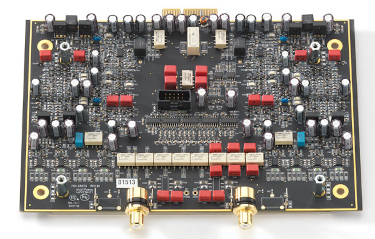

Wow, count the number of electrolytic capacitors on that Levinson board! Their designers seem not to be afraid of electrolytics at all.
I suppose that they were forced to use a thru-hole mounted connector (at center) to the daughterboard, for high reliability and mechanical strength when the connector is plugged and unplugged. Having thus decided the board would include both SMD and thru-hole, they appear to have used very high value electrolytic capacitors, so high that SMD electrolytics in those values are not available, and that's why there are bunches and bunches of thru-hole radial electrolytics, all over everywhere.
There also appear to be four pairs of TO-126 thru-hole mounted transistors, without heatsinks. Why they didn't use D-Pak instead, is a bit of a mystery, since D-Pak is generally more widely available and cheaper too.

It is fascinating to see what they've used; I imagine cost is not an object. Lots of ICs too. I reckon the line of ICs near the centre are part of the R2R volume control. Lots of relays. I think the main connector is at the far side and is part of the pcb. That middle connector could be anything...often front panel connections.
Read the text of the article too; this picture shows a phono board and it has a daughterboard. That's why there are four silver colored hexagonal standoffs arranged in a rectangle: the daughterboard plugs into the black central connector, and the corners of the daughterboard are bolted to the standoffs.
The relays at front select cartridge loading resistance and capacitance; the relays at rear select gain (for moving coil vs moving magnet).
Since they brag and brag and brag about dual mono mirror image layout, it's unusual to see a single orange component at center top near the edge connector. What would they only want a single copy of?

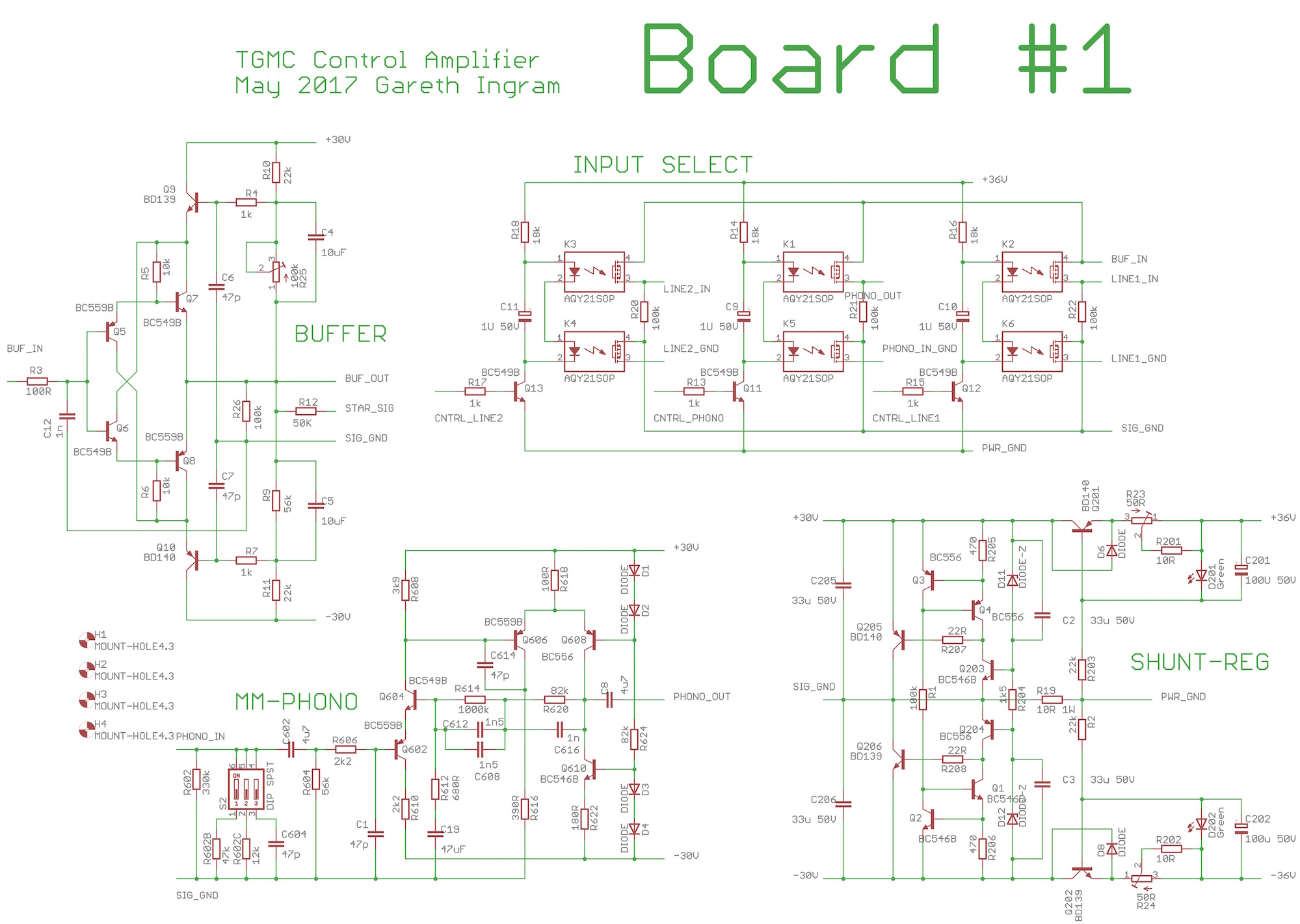

Board1#1
wow, they got a lotta stuff on that board. It would take me more than a little effort to duplicate that and the chances of getting it right first time around are nil. I take my hat off to these guys. JC's Blowtorch pre-amp has <1/10th of the number of parts and probably sounds at least as good though. There's things to learn here but I'm not sure what they all are - do you think relay switching for the cartridge loading is sonically better than a DIP switch (which I've proposed) ?
I'm starting to feel the law of diminishing returns apply to my own project. I don't want to unnecessarily Rush it (play on words there!) but I figure I'd better start on a layout for Board#1. I've decided to forego including an output buffer on this board as space is already tight. So this first board will be the input board, with RIAA and a single buffer that sits in the signal chain just before the off-board volume control.
I need other sets of eyes on this first board or we'll be wasting time fixing it rather than moving on to fun stuff for board-2.
Attached is the Eagle (layout software) schematic entry layer. It looks a bit disjointed so I'll upload a joined-up block sketch of it.

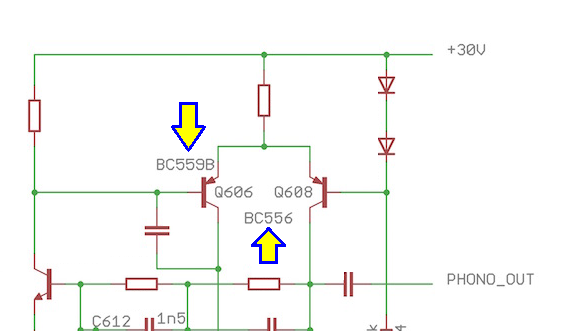

Joined 2009
This portion surprises me:
_

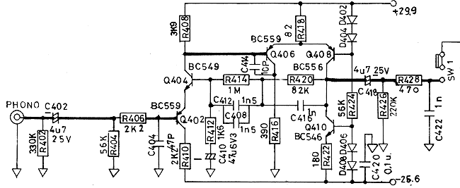

these parts choices haven't been reviewed, for the phono they are a direct take-off from the original NAD circuit (attached). I'm not sure why the designer specified these choices. This emitter coupled amplifier is NOT an LTP by the way so matching is not relevant.
my guess:
The BC559 was chosen for it's low noise, at least the datasheet says low noise. The BC556 was chosen for having a higher Vce(max) and is matched to it's complement, the BC546 below it on the schematic as these two devices are paired as a complementary output stage.

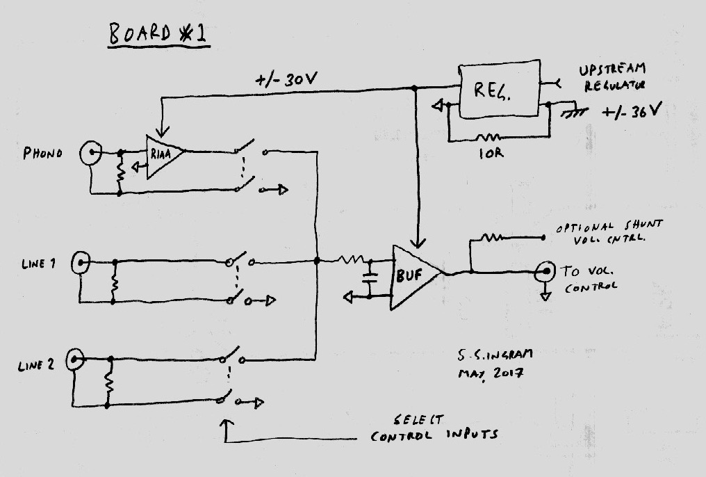

Joined 2009
You gotta love their design aesthetic, I mean I've never owned a reel-to-reel but these guys make me want one. If you follow that link, look carefully at the photo of their new amp, in the lab - the design engineer over at the other bench keeps a nice bottle of red wine on the floor. Now that has to be the kind of environment that encourages down-time to reflect on design choices 🙂
I've attached a sketch of the overall scheme for Board#1, including the grounding.
