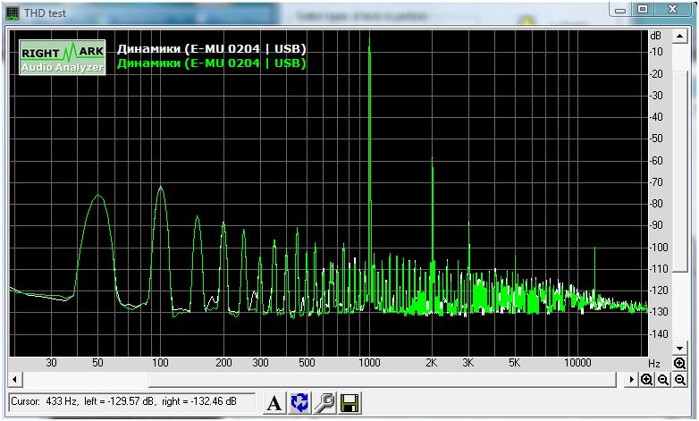

Greetings! A small lyrical digression, well, or somewhere near ... Here is roughly what the spectrum looks like for a modern SE amplifier: 6N8S (6SN7) - 6P6S (6V6) - EML520. Measured with an output power of about 5W.The Tube Cad Mighty Diamond showed the Diamond Buffer can have ideal harmonics. As a Tube guy he wouldn't think to say as it is the goal of tube designs to have the second harmonic in the right proportions. Transistor people tell themselves tube guys love amps with only second harmonic. That's as far from the truth as you can get and isn't really possible in most cases. What was really meant was the higher order distortions were below lets say a - 60 dB level so were hard to measure in 1956.
Probably, it is not always possible to curb the means of measurement. As an example, I can provide an option where such a breakdown is almost not observed. But, the main thing is the nature of the "classical" (or almost such) spectrum.
Is this without nfb?

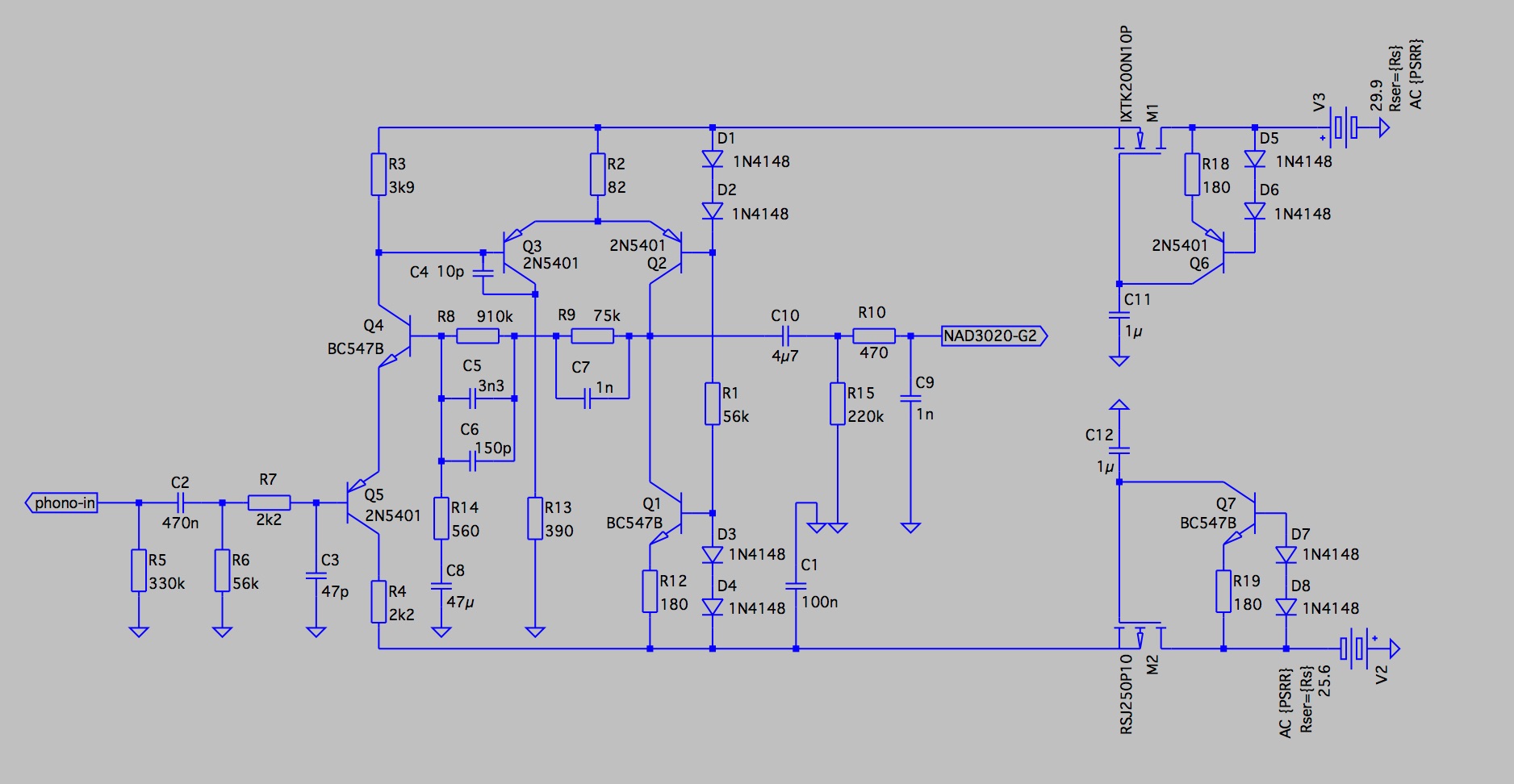

additional regulator for phono section ?

But attention moving back to Board-1 and the MM phono section.
In LTSpice this phono section has atrocious PSRR, at least it's clearly bad at low frequencies and improves somewhat at high frequencies. Although there is a shunt regulator on the board, it feeds several circuits. I thought it worth considering additional power rail isolation for the phono section. It doesn't swing a lot of current because it's in Class A and will be driving a high impedance buffer which means not a lot of current variation on the power rails. A simple cap-multiplier provides a very meaningful improvement in low frequency power-rail isolation at relatively little cost. See attached - ignore the FET part numbers, I just 'grabbed' some parts from the Spice library; in practice I'd use some nice SMD FETs. The advantage of FET over BJT is very high gate impedance (vs base impedance) allowing for a higher PSRR.
Thoughts ?

"NFB" is in the Russian abbreviation "OOS = negative feedback". Yes, without it.Is this without nfb?
Apology, for some distraction from the topic of the respected Bigun.

The LTP tail is very low impedance - high impedance is better for PSRR.

But I wonder which will sound best, a cap-multiplier on the phono amp, or a higher feedback factor for lower output impedance on the shunt regulator. Or I just won't notice.
Considering that many expensive hi-end phono stages work on batteries, I think that both - low impedance and a lot of capacitance - would work the best 🙂
Am I missing something here - I don't see the FET's shunting any d.c.current to 0 volts only a,c. through small capacitors.
There is an example by Ed.Simon of a shunt regulator in combination with an LM4562 op.amp and 7820/7920 supply conditioning 3 lead regulators. The source for this is an article in audioXpress issue of June 2009. I can scan this and send by email.
In regard to the LTP one half has the form of a CCS the source voltage of this cross connects the rails via a 56k resistor.
You could try increasing the impedance by substituting a constant current diode to improve the rejection if simulation shows this is an improvement since there are two CCS involved and the possibility of signals on both supply rails to allow for.

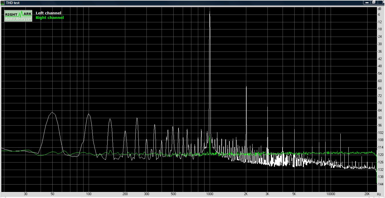

Wow.

You probably won't notice. LM317s would save a lot of effort and board space and Naim uses them.But I wonder which will sound best, a cap-multiplier on the phono amp, or a higher feedback factor for lower output impedance on the shunt regulator. Or I just won't notice.
