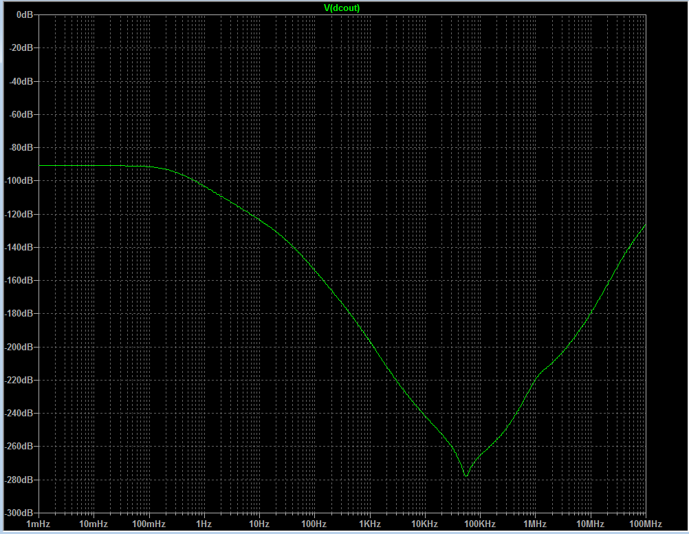

My little preamp instrumentation power supply uses a single low cost opamp
and gives quite pleasant Line Rejection (a/k/a PSRR) across the spectrum from DC to supersonic. But some people refuse to even think about using opamps.

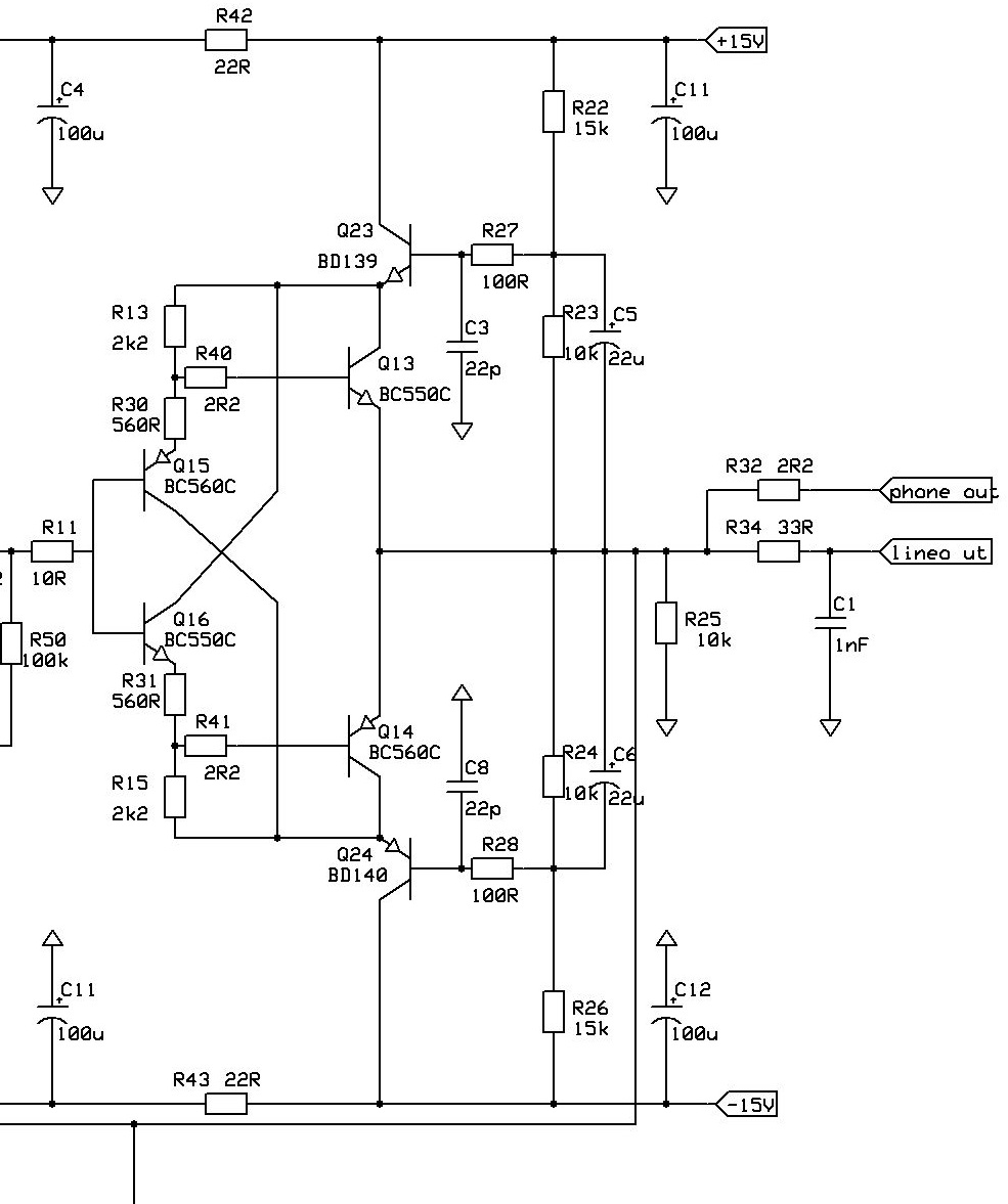

I have looked at a couple of discrete buffer options, just for fun whilst the decision process is still ongoing. I set up an LTspice simulation to get a feel for three options, a) the NAIM 324 board, a single ended CFP loaded on a CCS - this didn't produce the lowest distortion but I expect it could be modified for better results, b) a simple Diamond Buffer with bootstrapped current source - this was lower in distortion, nothing to complain about, c) a more complex Diamond Buffer with bootstrapped power supply ('dadod' used this in his GainWire, 'PigletsDad' has used it - found it originally in an old EW article) - this produces significantly lower distortion.
This bootstrapped-supply DB looks on paper (Spice) to be astonishing. I've posted the schematic below along with my Spice file. I believe Damir's GainWire amp has been built by others and found to be excellent. In which case, it's not a high risk, what's not to like ?

2N5401 and 2N5551 have high VAF - have you tried these in the Elvee Crazy Diamond Buffer. I suggest using the Cordell models for this purpose.
My thinking is with high VAF any differences in high frequency behaviour will be pushed to much higher frequencies where these will be less significant and may well obviate the need for the more complex circuit.

This is a good read on the Diamond and how to get more from it. Thank goodness he gives graphs of distortion. These ones look ideal. The Mighty diamond looks good. As he says, what good is a buffer that is shy about giving current. To be honest if you don't go for a real buffer then best not have one.
I think the ability to drive headphones is what you want, it's also a free lunch. It means never having doubts about any new idea that you want to try. One of my nicest amps had a 75R inverting input. My headphone cum preamp example designs would laugh at 75R.
Seeing as this Diamond Buffer looks a winner why not tweak the gain for the NAP140 clone amp to suit? If you make it 500 mV it should be OK. You might be able to usefully reduce Cdom as a result. That should give you identical HF distortion if the Cdom tweaked. A tiny tad more hiss doubtless if more sensetive ( ear to speaker type ). Quad were often told they shouldn't have 500 mV sensetivity on the 405. I think they got it right. That means at worse a 200 gain for the phono which is very OK. Personally I would use 12 + 17 for that with an option to have 62+17. The 62 being MC and 75 uS, the 17 is 3180/318 ( gain 160 ish at 20 Hz ). My brother who had years of experiance fixing amps thought 17 for the 1kHz 3180/318 was the ones that sounded best. He was a very scientific thinker, this was one of his rare rules of thumb.

Well the simplest is reported as the best. This is expected because complexity without appropriate refinement will produce undesirable side effects. My idea to use an IC diamond buffer (with no internal nfb loops) intends to address this. If you choose discrete, I recommend very simple and BJTs in current gain mode where possible, like the NAC. Or do some JFET trickery a la Curl if you are in an artisan mood.
I think I'll look at the feasibility of fitting all that I've earmarked for Board-1 onto a pcb within the constraints of my free layout software. I'll start out all-discrete as this is the worse-case for layout space and see how this influences choices. If I use the buffer on Board-1 for a headphone output I'll not have any gain so I was thinking any headphone outputs would go on Board-2. However, my experience with headphones is that gain is NOT required, line-level signals are plenty loud enough and the headphone output just needs some current drive capability.

A Zener diode shunt has rather anemic regulation due to its high dynamic impedance
good comment Mark - although I will not use a simple zener regulator I will use a shunt regulator that uses a zener reference your post prompted me to look at the simulated dynamic impedance of the simple shunt regulator I was planning to re-use from my last attempt at a pre-amp attempt. In it's simple form it has an 'output' impedance of 1/4 ohm which I feel is too high when several circuits will be hanging off the same rails. Adding another BJT stage to the design pulls this impedance down to around 15m ohm which I think will be sufficient.
