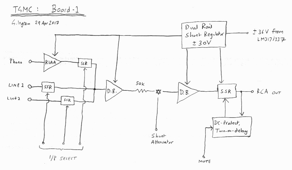

Board1 Overview
Piecing it altogether, the first board should be described by the attached scheme.
This will give me a functional pre-amp all on one board. The other boards will be able to tap into the Start-Signal point, Start-Gnd point and pull their own power from the upstream regulator.

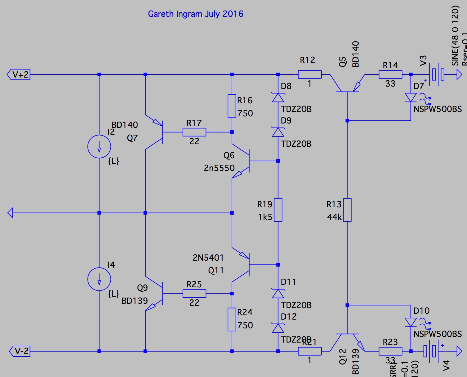

- I'll be re-using the dual rail discrete shunt regulator design from the TGM1i thread (proven) and configure it to provide +/-30V rails, about a 6V drop from the raw dc supply coming out of the LM317/337 upstream regulator.
- There will be an off-board shunt volume control sandwiched between two discrete unit-gain no-feedback Diamond Buffers, one of which feeds the output via a dc-protection circuit from the TGM10 thread.
- Feeding the input buffer are three relay-switched options, two line inputs and a phono amplifier circuit.

I think you're right there Nigel, in fact the regulator I have used is really just an amplified zener diode. A diode alone has the challenge of heat dissipation, adding a transistor makes for a more convenient, should I say 'traditional', means of thermal management. The extra gain does of course make the regulator more accurate on paper at least.
I may modify my scheme to put a buffer and solid state relay (SSR) on each input rather than a combined one.
At the same time, I'm giving some thought as to the differences between a discrete diamond buffer and an op-amp buffer. I can't help thinking that the op-amp would be more transparent unless the discrete buffer is very well designed.
Avoid opamps. An IC buffer with a little gain may be handy. Avoid home brew diamond.I can't help thinking that the op-amp would be more transparent unless the discrete buffer is very well designed.

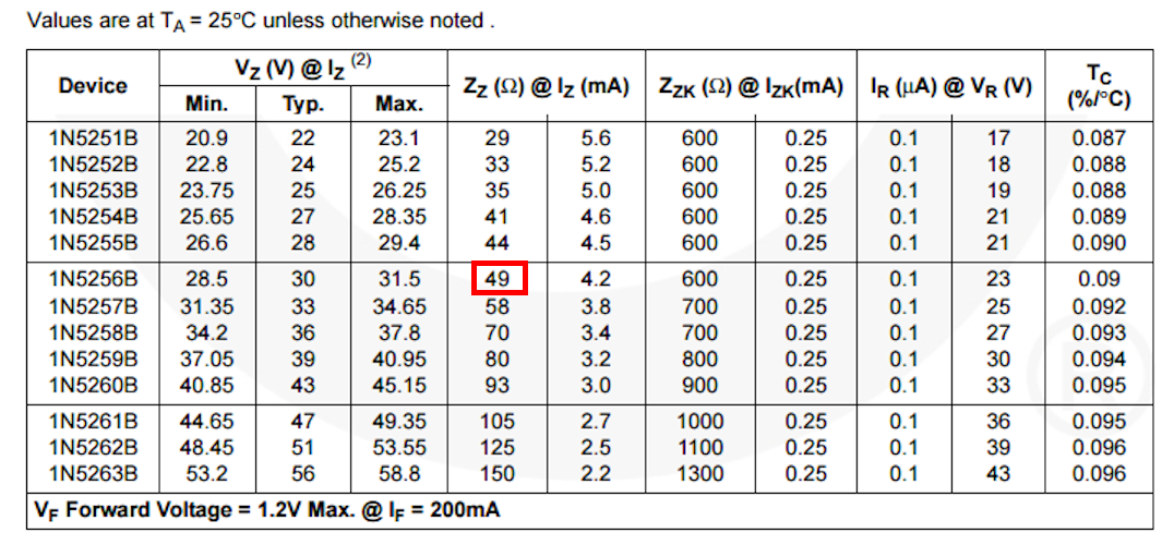

A Zener diode shunt has rather anemic regulation due to its high dynamic impedance, especially if you bias it with a resistor instead of a current source. For example, 36V input and 30V output using an 1N5256 zener and a 1.5K resistor (4mA bias), gives only -30 dB of attenuation. Amplified zeners are better (thanks to their lower dynamic impedance), TL431s are better still, and cascode current source bias is even better. For those unafraid of opamps, you can build a double-shunt regulated reference voltage using two cascaded zeners, then an opamp controlled pass transistor with voltage divider feedback from the output. More than 90dB of attenuation is easily achievable. But now you're designing instead of copying, which may not fit the philosophy of this project.

In real life over and above a RC filter I found an amplified zener quite good. TL431 needs care, the graphs given are really very easy to use. There are very low and very high capacitance options with the in between not usable fo some voltage options. If you try them you will find they really tell the truth. There are some makes that claim dramatically better noise levels ( ON?? ). Here are some tests I did. LM317 with some care is almost as good. The TL431 is with a junk box slow Darlington ( TO3 ). The amplified zener here is not with CCS ( note not really worse than LM7812 although more peaks ). Again just my notes so forgive format. The TL431+ MJ3001 is 4 dB above background. The 7812 would be quiter if the 1.25V LM317. The hiss can be lost in the lower feedback arm due to a noise being bypassed to ground by using a capacitor in paralell with the lower feedback resistor that sets the gain/output voltage.

For the Shunt regulator -see attached schematic. It shows two zeners in series because of a limitation in the parts library for LTSpice but in reality it is only one diode. The CCS feeding the shunt is bog standard of course. I think the overall design is simple and effective.

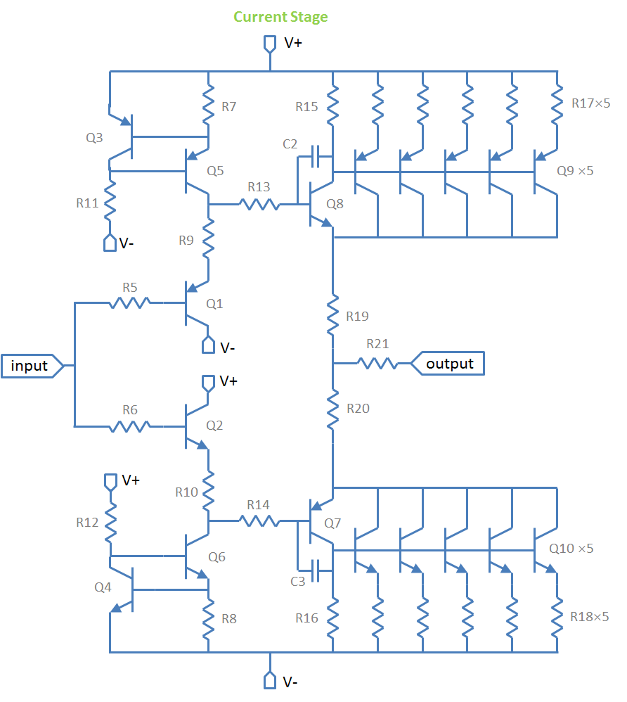

Buffers-
in the left corner we have the i.c. buffer from Intersil, the HA-5002. This one isn't the only option, there are others with built-in over-current protection.
in the right corner we have a discrete buffer from RJM (http://phonoclone.com/diy-sapp.html). It is a Diamond Buffer only this incarnation uses a CFP in the output. I'm not sure a CFP is needed nor are all the parallel output devices because we're not driving headphones out of Board1. But the performance of a discrete buffer vs i.c. is what is at stake here.
who's gonna win ?

The LME49600 caught my eye as the sort of thing...although it is unity gain. http://www.ti.com/lit/ds/symlink/lme49600.pdf

That was a bit of a bare-bones Spice simulation I used to get a sense of it's sensitivities. I would expect to see some decent caps placed across the zener diodes to shunt as much of their noise away as possible and some decoupling on the power rails would be nice but that should be done close to the relevant circuitry. Additional caps could be used on the CCS for slow start (to ground) if this was deemed useful.
That LME49600 device looks tasty. Once again, it's a Diamond Buffer. Are we sure we can't do better with discrete ? One side-advantage is that the discrete can be designed to run off the full +/-30V rail voltage whereas the i.c. buffers will need their supply pins cascoded with a pair of transistors to drop the voltage down.
I have not used any of these buffer ICs so I am going on data sheet info. and hope. I would hope that Intersil and TI have gone to a lot of trouble to match transistors up to get low distortion figures and have gone to a lot of trouble to make low-drift, temperature compensated current sources and so on. I am very wary of op-amps but these buffers "appear" somewhat simpler and ought to be less prone to audio nasties than op-amps and don't "appear" to use loop feedback.
