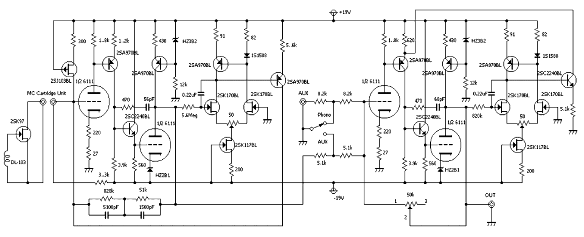

Maybe something like line stage from kaneda DC217 triode and +- 19V dc coupled too
