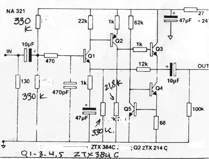

I think it would be a lost opportunity not to include the Naim gain stage as one of the options in this modular design.
Are we talking about the "321" board (attached) ?
It's probably 'safe' to trim the gain, say to 5, without impacting the signature sound that is being sought. But the improved power supply I have in mind may make a difference compared with the original NAC 32 etc.
Greetings! Yes, it is this part of the scheme. You can try to reduce its gain, for this it is necessary to change the depth of feedback. But, as it affects the sound - you need an auditory test. I think that you could evaluate the expediency and influence - by making at least a preliminary layout of the scheme. And make sure: there is an improvement for you or not.
