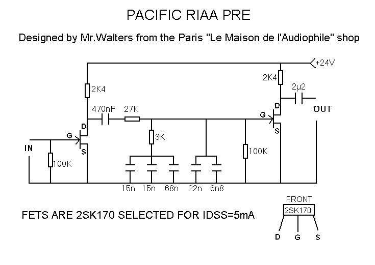

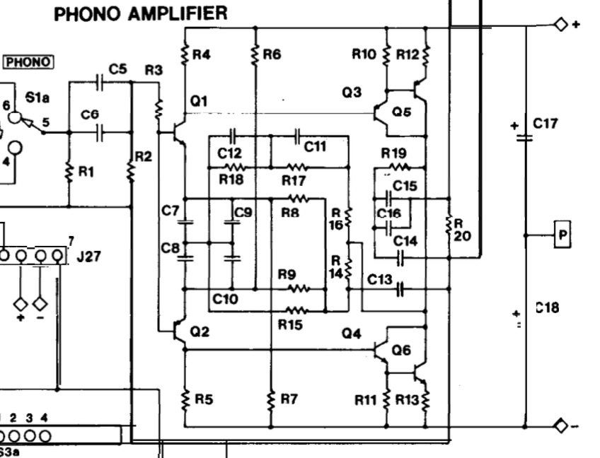

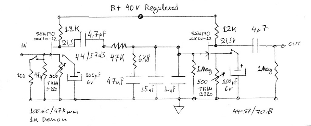

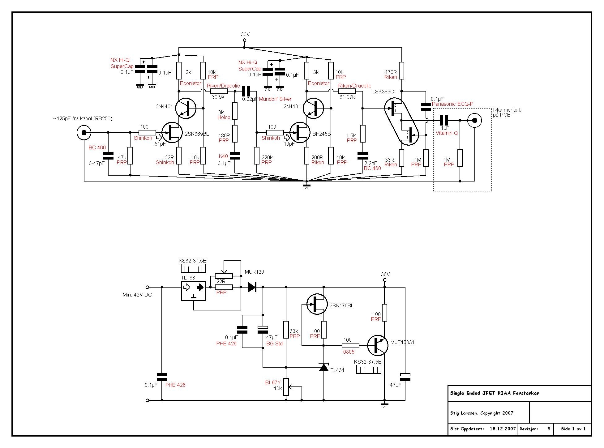

Just gazing around, there are hundreds of proven phono amplifiers out there. I'm just talking about MM and just discrete and the list is huge.
I wonder, if given good quality components, with attention to detail on the wiring, and a hi-end regulated power supply - is there much to choose between any of them ? I suspect that the reputation many of the 'famous' and historical designs have earned for themselves is partly from their choice of power supply and components that were available at the time they were in production. So such 'reputational' information is hard to rely on.
For me, I have no experience with an of them. However, I did get to the point of having the NAD3020 phono built (TGM1i) and briefly had a listen but nothing I can rely on. Since I have the parts on hand and have some design familiarity with this circuit it is on my short-list.
The Naim looks messy in comparison. The MM stage has a pure gain stage feeding an RIAA corrector. It's still not enough gain and relies on the line-amp gain stage to provide decent signal level. That's a lot of transistors and other parts for the signal to traverse.
The DH-101 design looks nice. I read it might have been a Borbely design. It has simplicity and elegance.
If we accept the use of JFETs (SMD parts are the most available) it opens up a whole extra list of possibilities. I'd favour the Salas Simplistic because it's been so well documented and tested through builders on this forum.
And I'm aware that an op-amp based circuit with modern op-amps should be flawless in performance. So my somewhat subjective short list becomes (in no particular order):
> NAD3020 (BJT, discrete)
> DH-101 (BJT, discrete and symmetrical)
> Salas Simplistic (JFET, discrete with a tube-like topology)
> Op-amp based (i.c.)
Thoughts ?

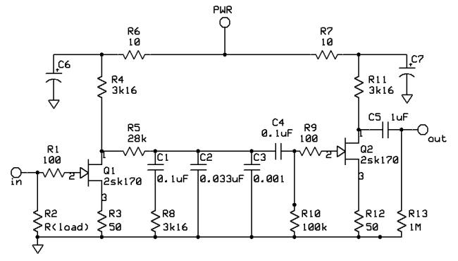

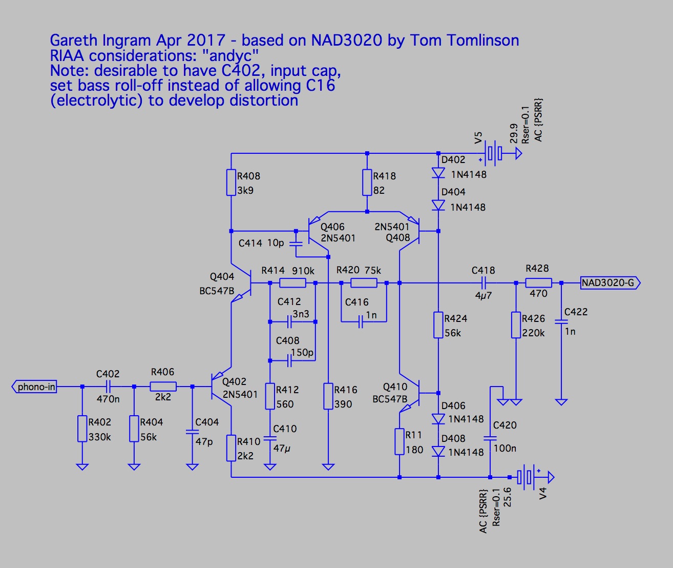

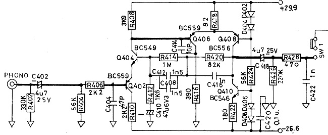

Interesting that you mention Tom Holman. The NAD 3020 phono stage design is attributed to him from what I have read.

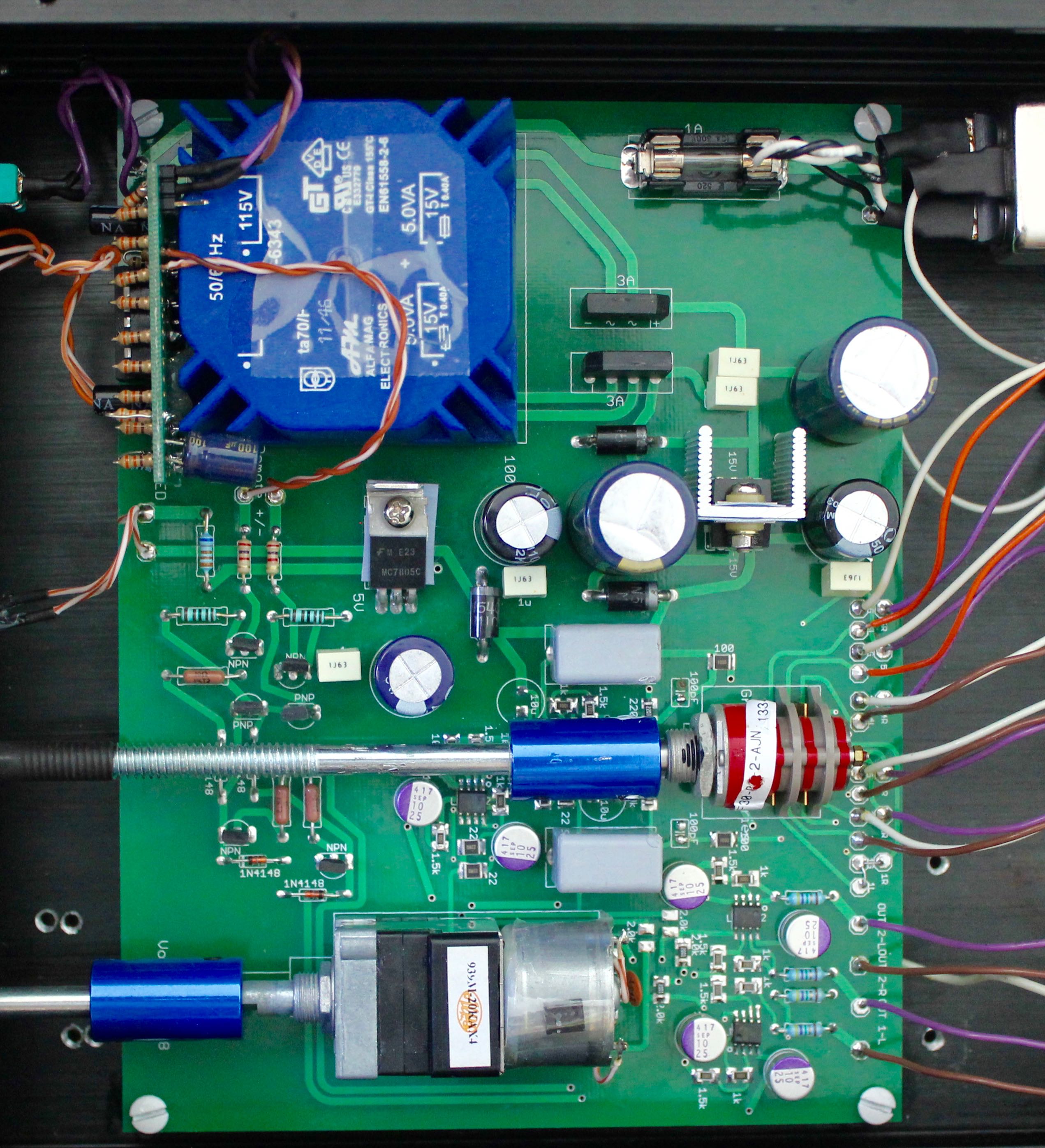

Yes, sure. Find attached. As I said, it's absolutely standard circuit and in my opinion the very good sound and operation comes from the SMT, the fact that the pot is buffered and that I generally used lower resistor values to reduce Johnson noise. According to Self 4 Opamps in parallel are about the optimal for quality/price/noise. I used just 2.
I might have an error in this schematic in wiring the potentiometer that I corrected later, due to misunderstanding of top/bottom view.

Thanks Ruwe - I'm not sure I know what all the parts are as shown though 😱Yes, sure. Find attached.

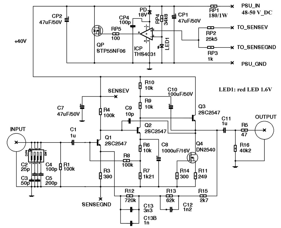

Attached is my current favourite on the MM phono amplifier. I think it has very good on-paper performance and a very good reputation (comments made earlier not withstanding). I have also increased the gain over the NAD original so that further gain is not required. Simulation results are very encouraging, with low distortion, decent PSRR and no obvious concerns about overload tolerance.
Please see also some information from 'andyc' who used to be an able member of this forum: Andy's Audio and Electronic Design Topics
Sorry, not intentional. That's what I have, because I'm lazy and I know I'll build SN0001, and maybe SN0002 if a friend of mine also wants one 🙂
The main mysterious parts are the Grayhill selector switch and the motorized Alps 22k quad-potentiometer between the stages.
I'm familiar with Grayhill from my years in avionics repairs. They are widely used as encoders by many companies and I find them amazingly reliable. They can stand dozens of years of abuse by pilots pushing, wiggling and hitting them countless times. The downside that I found later (which is valid for any rotary switch IMO) is that they have some crosstalk. So, relays are still probably a better option, although this switch most likely has better contacts than most.
The switch has three poles and the return (ground) lines of the sources are switchable too. I think, this is very important in avoiding the preamp to become a crossroad of ground loops. Still, many people switch just the signal lines. I guess this is the way of thinking that currents magically disappear when they reach the common.
There is also an H-bridge shown that controls the rotation of the 5V motor of the Alps by remote. The remote control receivers I buy online from a guy in the Netherlands. Very small and simple board that works with Philips and Sharp codes.

[note error in my attached diagram 2 posts back. It should say '... instead of allowing C410 the feedback shunt cap...'. The idea is to avoid allowing any electrolytics in the signal path do any low-pass or high-pass filtering and leave that job instead to higher quality caps]
