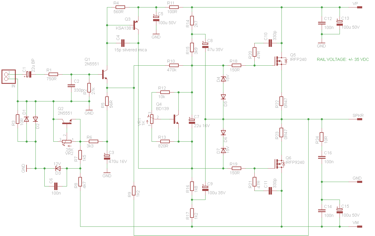

DIY 40W MOSFET AMP
There doesn't seem to be many designs with this arrangement. Mind you there aren't so many designs that still use a bootstrap CCS, fewer still with a bootstrap and MOSFET output stage.
Hugh, thanks for your description of the bias generator and suggested parts values. To be honest I still don't fully understand how to design this functional block and I probably need to invest further time to study it.
The bias generator R values in the schematic above were taken directly from the International Rectifier app. note I referenced. Mind you the HEXFETs used in that design are different, so its no surprise to learn that these values when used in this circuit are grossly inadequate, assuming of course that the app. note design was optimal in the first place, which I wouldn't assume.
Ah you're quite right AndrewT. I followed Bigun's original circuit (CFP output) a little too closely and put the zobel on the wrong pins...
Does this look better?

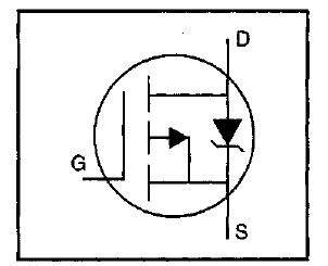

The earlier sch (497) and the latest sch (503) both have 240 & 9240 as the outputs.
But in both sch the 9240 is drawn upside down with the Source connected to the supply rail.
But the integral Zener is the correct orientation ??????
Or should that be a diode.
It's the Gate to Source that sometimes have a Zener.
