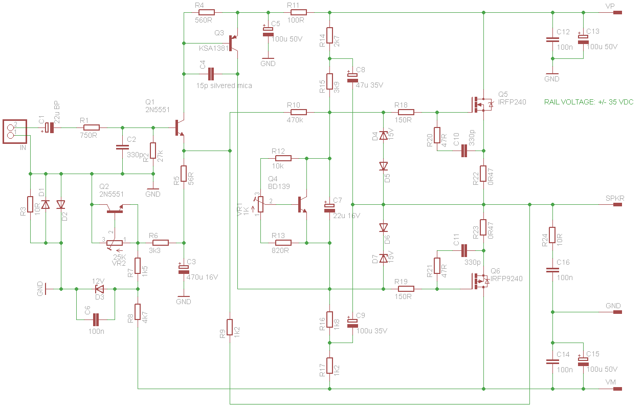

I like the design that Christian has proposed - he's doing well with his new designs. The only concern I have is the OLG at high frequencies being limited by VAS driving the gate capacitance of the output devices - but I don't think it's going to detract from good sound.
He could provide room on the pcb to allow for a CFP VAS, which would have a lower output impedance and is therefore, better able to drive the FET gates.
Hi guys, I can open the Spice file but it complains about the missing pot component and these devices are missing from the model.
The R values that make up the input transistor biasing circuit don't match the schematic. For example, R12 should be 4k7, R6 is labelled R4 in my schematic, R6 in the Spice model doesn't exist in the schematic.
C10 is open circuit in the model - it should be across the gate to source.
There is no good reason why there would be any DC offset at the output once VR2 is adjusted correctly. My changes are confined to the output stage, the front end is Gareth's tried and proven design.
That's a great suggestion. Another (perhaps technically better?) solution would be to buffer the VAS itself with an EF or CFP driver stage.
The CFP drivers would be more in keeping with Rod Elliott's philosophy, but I would want to investigate whether one of these two methods would allow us to retain the simple trimpot for biasing the output.
I have another idea for a quasi-complimentary output stage utilising the TGM8 front end. A switching MOSFET would handle the positive swing and a CFP BJT quasi-compliment the negative. I've turned the front-end upside down for this one, with an NPN VAS transistor, so that the action of the VAS bootstrap helps better saturate the MOSFET, theoretically making the clipping more symmetrical.
The BJT compound pair on the -ve side means that the VAS only has to contend with the gate capacitance of one MOSFET - not two.
I have no idea whether this will even work, let alone sound any good, but its a concept I'm keen to explore further. Gareth, I have a feeling that quasi designs aren't your cup of tea but I'm hoping Hugh will take an interest since he recently expressed to me an interest in quasi designs.

Hi guys
Since I posted the LATFET schematic at #463, I've been thinking about this a little more. One of the issues bugging me is the fact that the VAS, with its bootstrap, can only source extra drive voltage into one of the outputs. I've ensured the other rail holds up under load by placing a series diode and generous cap to the front-end; however, the VAS will not be able to crest the rail on the positive swing.
We could use separate boosted rails, but this would require an extra pair of transformer windings and power supply components; I'd rather not resort to this added cost and complexity. I can readily buy toroidals locally with 25V and 40V secondaries - but nothing in between.
What's needed is some way to bootstrap the other side. A friend sent me this link to a design illustrating precisely that: the function of its "dual bootstrap" technique is described in detail:
DIY 40W MOSFET AMP
The second concern is that LATFETs are relatively expensive and difficult to source. Vertical MOSFETs are inexpensive, abundant, and have some useful qualities, but are more difficult to thermally stabilise: bias servo design has so far eluded me.
This article from Rod Elliott and app. note has some useful information and solutions that apply to HEXFETs:
Using HEXFETs in High Fidelity Audio
http://www.irf.com/technical-info/appnotes/an-948.pdf
So here it is... any comments or suggestions? It shares much in common with Bigun's original design, including the output transistors (but only the HEXFET pair...).
By happy co-incidence I bought several of these HEXFETs last Xmas with the intention to build Bigun's high power version. Well I never got around to it and the BJT-only version sounds so good at high volumes without them that I probably never will.
R12, R13 and VR1 will probably need some tweaking to ensure thermal stability. R18 & R19 may need to be increased to stabilise oscillations at the outputs; however, it may also be possible to decrease it slightly after experimentation.
Joined 2009
This is an excellent approach fully worthy of the TGM8 badge 🙂
Maybe try a Spice simulation to confirm parts values.
Christian, you have around 8.2V bias across the generator which you cover with a single Vbe multiplier.
This will create a very high tempco, around 8.2/0.65 times the usual Vbe junction. This is way over more than the hexfets require, and with warming up the output stage would actually shut down.
You can ameliorate the multiple by putting a couple of leds series in the emitter of the transistor. Then, if you use greens, for example, you will drop 4V across the two leds, then another 0.65 across the be junction, so the resistor you use between base and emitter is 10K (5K trimmer and 8k2) and collector to base around 8k2 (which will drop around 3.5V, with 4.65V dropped across base to emitter.
This approach, if the leds are NOT thermally bonded to the outputs, only 3.5V of the Vbe thermally connected to an output device will adjust the reduced tempco over the output devices. Choose leds that can accommodate the hefty current through VAS.
