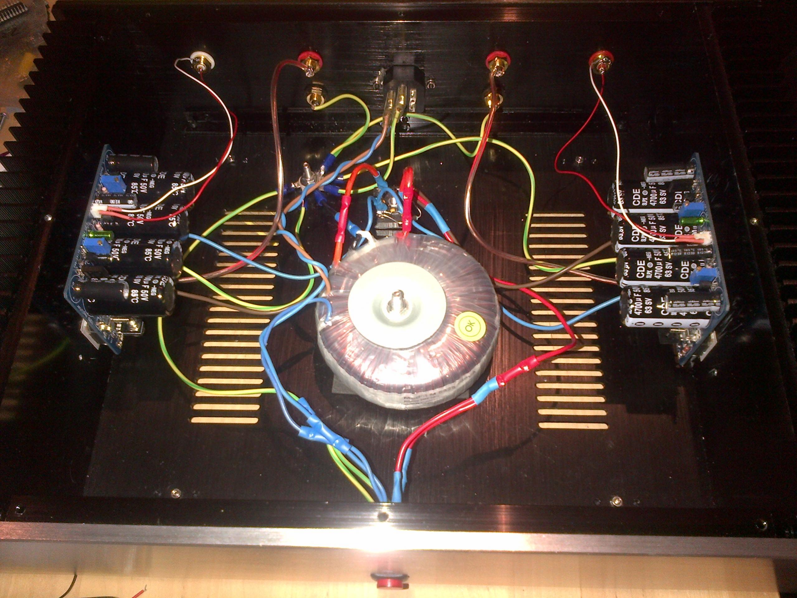

Thanks to all your help, we finally have lift off with Australia's 2nd (AFAIK) TGM8.
After finishing the wiring (see pic), I powered it up and monitored the current draw on idle, 0.1A, which was fine. Tested on some old speakers, channel by channel, no concerns at all - we have music.
HOWEVER, on checking the DC offset, I noted one channel had negligible offset, whereas the other had 6.5v!
So (somewhat foolishly in hindsight) I used the trimmer to reduce the offset, but as I turned it to about the 3v mark, I heard a loud pop which sounded remarkably like an LED exploding. Sure enough, the LED on the board appears to have failed.
I also noticed (independently of the above set of events) that the LED on the functional board turns on only momentarily when I power up the amp. It's the only LED on the board, but I can't tell from the schematic what this LED does in the circuit. Should it be on permanently when the amp is powered on?
Any troubleshooting would be greatly appreciated, cheers.

The LED is not a power indicator but instead it lights red if there is a dc error at the output. Otherwise, unless the edit described earlier in the thread was made to the pcb by Christian before he sent them to you, the LED's stay off. With the edit they light green when there is no dc error. It is also normal for them to light briefly on power up, this is the turn on delay stopping any turn on thumps in the speakers.
How does the good channel sound ?
As for the bad channel, I don't have a quick answer and will have to think about it. I'm on travel for a couple of days so it won't be easy... note that as described earlier in the thread, there is an error on the silk screen, the offset and bias pots are mislabelled. The bias pot is labelled offset. The offset pot is labelled bias. The pcb files I posted later on have this error fixed.
By the way, where is your safety earth, from the IEC power inlet connected ? to the chasis I hope!

Ok we can wait to hear from Christian if he implemented the green led function, but for now it sounds like the initial red flash followed by turning off is the way it should be operating. Which is fine as that confirms that the LED is blown in the bad channel - it doesn't flash when I turn the amp on.
As to the sound - phenomenal, incredibly relaxed, yet still highly detailed! Tempted to use the good channel on my better speakers just to enjoy it for a while! A very inviting sound for sure.
Yes, the safety earth is connected to all the other grounds (in the pic above with the big bolt and plenty of spades).
Oh and 3k9 2W was perfect for the power indicator LED, not too bright all ; )

Congratulations on getting one channel working, and don't worry, we work through any problems to ensure the second channel is fixed too.
But first of all, can you please drill a second hole in the chassis, so that the safety ground has its own dedicated attachment point right next to the IEC connector? AndrewT will go beserk if he sees it bolted to the star ground!
Make sure all paint around the hole has been scraped away then lay down a star washer, the earth lug, a flat washer and then TWO bolts on top so that there is no possibility it can come loose. Put your multimeter across the earth pin on the power plug and a bit of exposed metal on the case to make sure there is no resistance. This could save your life if there is no RCD in your meter box or it is faulty.
As Bigun said, the LED is a DC offset indicator not power indicator. The brief red flash before turning green is also normal; it means its catching the brief surge of DC on power up.
To be honest I don't know why one channel had huge DC offset. I tested and trimmed both boards before I sent them off for 0V offset and suitable bias. It might be easier to send the faulty board back to me to have a look at?

Thanks Christian. So on your board do the LEDs flash red then turn green?
On mine they flash red, then completely off.
Ok I'll put another hole next to the IEC, easy.
If we can't do some simple tests on the bad board over the next few days I'll send it your way for some expert treatment ; )

Went looking back in the thread to refresh my memory about the mod Bigun mentioned above. No, I didn't make this modification; however, it should not affect the operation of the DC offset controller. So the led will flash Red and then turn off completely.
Ok, yes, re-tested on both boards, the good one has only 0.13mV offset and the led flashes on momentarily, music plays fine. The bad board has no LED flash, and about 12V (!) offset and doesn't play music at all.

12V offset is extreme; I would not connect a speaker to it as damage to the speaker is likely as a result. Something is very wrong with that channel :-(
Question: What is the voltage wrt ground on the:
1. Base Q1, and
2. Emitter Q2.
3. Voltage acoss the LED.
This should reveal that the bias generator at the first stage is incorrect. I hope!

Ok, with respect to ground:
Good channel -
Q1; -0.731v, -108.1mV, 36.64v.
Q2; -6.07v, -5.4v, 25.2mV.
LED; 1.356v (red->centre as green is n/a)
Bad channel -
Q1; 17.51v (slowly keeps increasing), 17.31 (also increasing), 38.42v.
Q2; 18.8v (increasing), 18.9v (increasing), 19.2v (increasing).
LED; 1.178v (red->centre)
