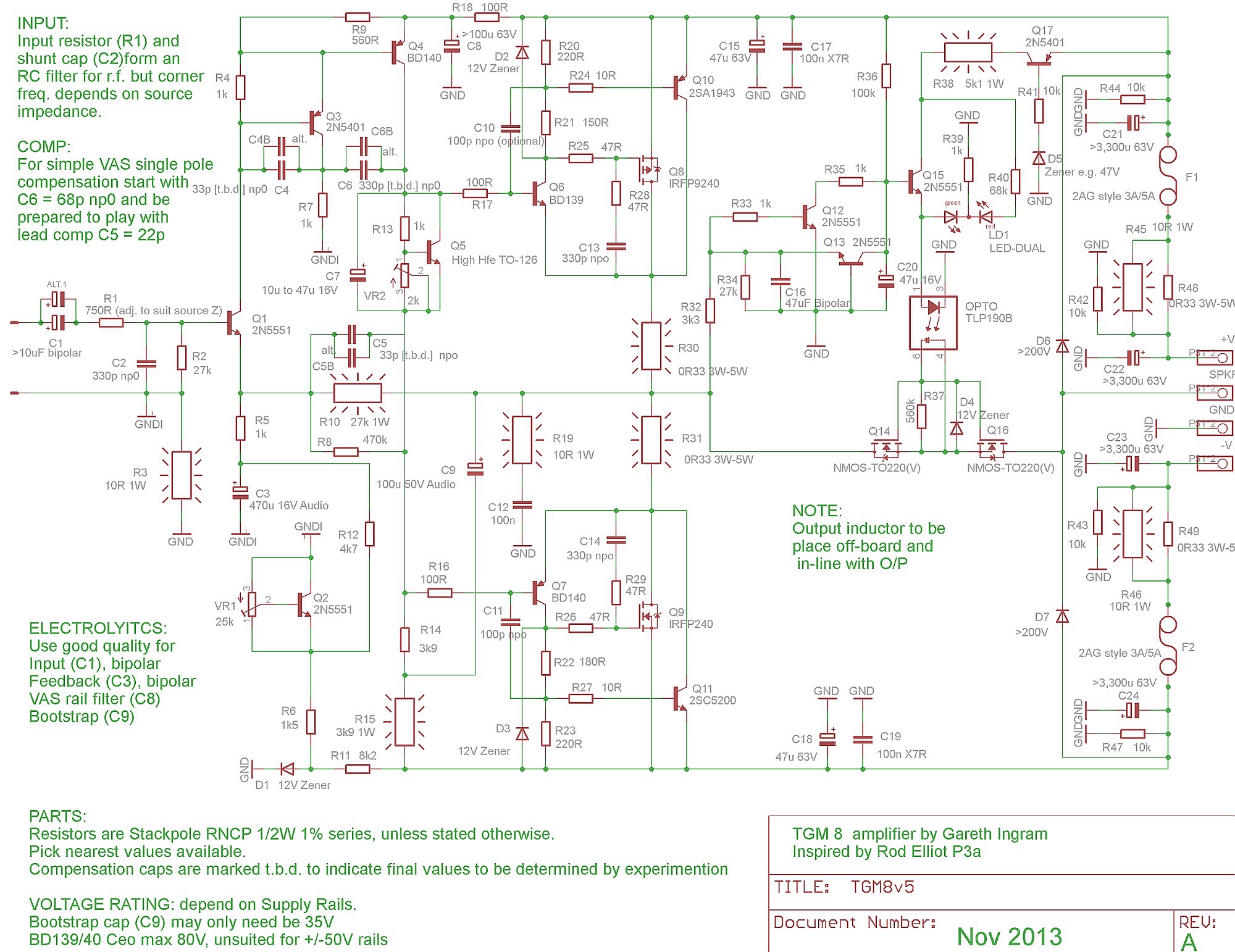

I'm a bit confused about your figures. Could you please write them on your correct schematic, then I will examine. I've been on the wrong schematic, I believe.

Thanks Hugh, I've attached the schematic which the boards were fabricated from (Christian - could you confirm?). Q1 and Q2 are both 2N5551. I couldn't tell which pins/legs were the base/emitter so I measured each of the pins/legs with reference to ground.
For ease of reference, results were as follows:
Good channel -
Q1; -0.731v, -108.1mV, 36.64v.
Q2; -6.07v, -5.4v, 25.2mV.
LED; 1.356v (red->centre as green is n/a)
Bad channel -
Q1; 17.51v (slowly keeps increasing), 17.31 (also increasing), 38.42v.
Q2; 18.8v (increasing), 18.9v (increasing), 19.2v (increasing).
LED; 1.178v (red->centre)[/QUOTE]
Hope this helps?
Tom

Check R2 is grounded, with other side on base of Q1, then set VR1 so there is around -6V wrt ground on emitter Q2, and -12V wrt ground on the zener.
Much of this problem is generated by Q2 VR1 setting, I believe. You should have around 6V across R6 (1K5) and this is around 4mA.
Verify that there is 0.63V across R4.
Hugh

Thanks Hugh, just sat down to do some more testing and noticed that F2 is blown, is it better to replace and then continue testing, or given that these fuses are at the output stage of the amp, ok to continue testing?
Tom,
If you have a variac to halve the supply, then replace the fuse and have another go.....
If no, wire up a 12V 21W car brake light in place of the fuse and supply the reduced current.
It's a good method, if passing only 100mA the filament will cool and drop very little voltage across it. You will need a lamp in place of on EACH fuse for each rail.
Hugh
Hugh
I would remove the led and replace it, but be quite sure the long leg is positive, the anode! Normally LEDs never fail....... using bad polarisation of too low a dropper resistor kills them.
Hugh
Hugh
Ok well some more testing done but not much headway unfortunately.
The amp is drawing some serious current - I put a 20w globe in place of the fuse on each rail and they blew straight away. Because of this I can't take any meaningful measurements (without the fuses in place the readings are very different from the good channel compared to the bad channel, but on the good channel alone the readings differ when the fuses are in line versus when they are not).
I also replaced the LED then inserted fuses again but they blew straight away too. In particular F2 (the fuse on the negative rail) seems very aggressive, sparking furiously when I put it in and take it out!

Good idea, Tom.
Replace 5551, Q1.
Then set bias gen VR2 to MAX resistance to minimise output device current.
BTW, troublefinding is another skill than design, it's both a tough call.
Hugh
Replace 5551, Q1.

Thanks all - will try replacing Q1 first.
