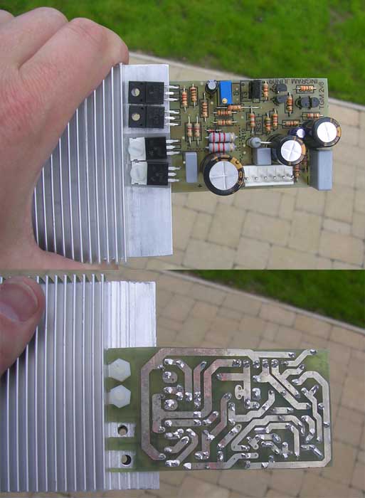

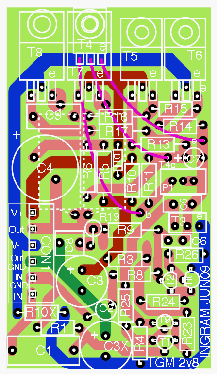

So, keeping it simple means adding only the CFP to the design which makes the existing pcb a little more cramped but nonetheless quite doable so I've moved things around and kept the same footprint.
Here's the draft layout (attached) which needs tidying up and then hopefully this weekend will see some etching work.

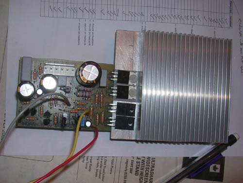

The pcb was made and stuffed. Attached is photo of first TGM2 amplifier.
It's drawing too much current on the +ve rail (via 100R psu resistors), something is wrong - will have to investigate further before allowing those psu rail fuses to be installed.

Very compact , gareth.
How much is "too much" ??

Nice pcb, Gareth.
Sometimes, though, you can make 'em too small, then servicing is an issue - which you soon find out about if you have a problem getting one going!
Too much current generally means bias generator. Check all connections are good, make sure the correct transistors are in all the right places, nearly there....
Hugh
Hugh

OS[/i] [B]Very compact said:Nice pcb, Gareth. Sometimes, though, you can make 'em too small, then servicing is an issue - which you soon find out about if you have a problem getting one going!
There's something about compact pcb's that I like, aesthetically that is. And I have to admit to being a bit weird - I find the shapes and patterns of the pcb tracks attractive. Some pcb's have a clinical look, some a messy look and some just look 'right'. I could not find a traditionally symmetric layout that looked 'right' so I ended up with what you see.
AKSA said:Too much current generally means bias generator. Check all connections are good, make sure the correct transistors are in all the right places, nearly there....
UPDATE:
You were right on the money. The bias adjust was just too far off base. I had it set up roughly, but it turned out to be too rough. It's now adjusted and playing in my system for me 😀
It sounds great. First impression is that it's a little cleaner than TGM1. Of course it doesn't have the same kind of H2 injection as TGM1, it uses something a little more subtle. But further listening will have to wait for me to tidy things up. I didn't have the right caps for Cdom (I need to reduce it) or the HF feedback (I need to reduce it a lot). Also, I didn't have the exact resistor values for the LTP collector load so it means that the current balance is out. I see this in the output where my dc offset is of order 100mV and the current flow through the emitter resistors on the output devices is not the same. Nonetheless, I'm not complaining, it looks like it was trying it's best to work straight off the bench.

Hi Bigun.
In TGM2 v1 (post6) you use Lender Vas and in TGM2 v8 you no use Lender Vas. Why?

Hi GEirin,
That's a good question - I have to think back, it's not that obvious why now. At the time I was exploring some improvements over TGM1. Most of my explorations were done using simulations rather than trying it out on a bench. This was / is probably a mistake as simulations don't tell you how things sound. I don't think I found a lot of improvement from the use of the Lender VAS and so I dropped it. If you are the experimenting kind of person I'd suggest a better approach is to try it out on the bench.

Colin and I tried the Lender. It offered potentially more gain, since not just the base but also the emitter was driven (in antiphase). However, the degeneration at the emitter throws any additional gain away, and sims revealed that gain was identical to a single ended VAS with no degeneration.
Since the increased Zout of a Lender compared to a base drive VAS was higher, we felt that the Lender configuration, though neat to look at, was no advantage.
Instead we moved to a buffered VAS, now driving the output stage from an emitter, not a collector.
This seemed to help, as the output of the VAS became a voltage, rather than a current source. Sims revealed higher OLG, giving more loop gain. Subjectively, we had the feeling dynamics improved.
