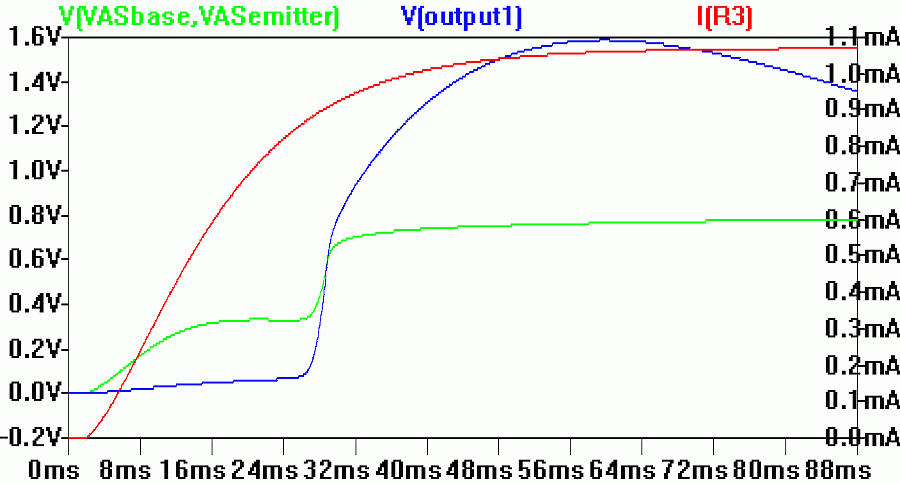

I didn't have time to get back to the CFP sims today, maybe this weekend. I did revisit the turn-on thump question as it seemed like that would be a quick lunchtime activity on my existing spice model.
But......
Keantoken,
In spice I see a turn-on hump at the output of around 1.6V to 2V, but equalizing the RC's on the LTP inputs was problematic. So I need to seek more guidance on my understanding of these things (bear in mind that the actual TGM1 amplifier doesn't have a loud turn-on thump problem so my sims are exagerating things).
Here goes: I just looked at a simple LTP by taking off the 'slave' CFP devices and adjusting the LTP feed resistor accordingly.
Power comes up at the output stages according to the RC of the psu (7ms) and at the front-end stages according to the on-board rail-caps that isolate the front-end of the amplifier (10ms). The LTP devices become fwd biassed and turn on pretty early (in my sim. it's 3ms but that's not universal) and as they do current starts to flow through the LTP. This current depends on the LTP feed resistor and the rail voltages which are still coming to life. Hence, we the voltage difference between the LTP collectors climbs with increasing rail voltage. As the base-emitter voltages stabilize the LTP output settles down to a steady level.
In the meantime, over at the VAS house, things are sleepy, the VAS is not yet forward biassed because the LTP output has settled already at a differential voltage that is too low. Current is flowing through R5 to charge the Bootstrap cap (RC = 220ms) with nothing much flowing down through the VAS. The VAS collector follows this voltage on the Bootstrap cap. [digression - thank goodness for this cap, without which the VAS collector would rise quickly and produce a nasty output spike]. As soon as the VAS collector voltage rises enough to fwd bias the driver (in my sim. it's around 30ms) the party starts and the amplifier output swings up towards the +ve rail and your speaker cone moves next door.
Before this gets out of hand, the neighbours have complained i.e. the feedback node at the LTP sees the output driving upwards. The LTP output sends out an error signal which climbs and eventually there's enough current flowing through the LTP to fwd bias the VAS. This turns on the VAS, lets the air out of the party and the good ol' sensible feedback loop steps in to restore order to the output. Now the LTP output settles out at a high enough level to keep the VAS turned on and everyone is happy.
The attached shows some of what I'm trying hard to understand. The red line is the ramp up of the supply rail.The green line shows the voltage difference between the two LTP collectors (it first starts moving after the LTP devices turn-on, then settles out at 300mV, then gets sharply pulled up by the influence of the fdbk), blue is the amplifier output.
So how do we fix this ? - Speeding up the fdbk loop by reducing C2 but this cuts into the bass response, we need to kick-start the turn-on of the VAS to get the fdbk servo running earlier. A current mirror would fix it, not a CCS.

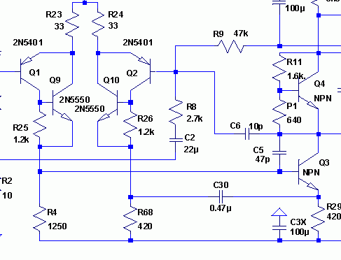

First, to clarify.
Most amplifiers will have some kind of turn-on thump, because of active devices turning on, etc. If you use bootstraps or a CCS you can change the cap values so that one part will turn on after or before another (what if you bootstrap the LTP and have it turn on after the output stage is on?). That said, most designers don't go crazy about trying to make it dead-silent when it turns on (If I'm not mistaken). Sometimes it is a price you have to pay for a given topology that has benefits in other places. If it's too bad, then you can always connect the speaker through a relay and have the relay turn on only after the amp is fully on.
I might have made a mistake mentioning the RC constants so urgently. I should have just said that I thought it would help. But now that you're interested, maybe you'll be happy to hear the full story.
In the schematic you posted:
The input cap is 470nF. The feedback cap is 22uF. That is about 50 times as large. Your gain is only somewhere around 20.
If the net input network resistance and feedback network resistances are the same, then your feedback cap should be about the value of your input cap multiplied by your gain. So,
Given that R1 = R9+R8 (notice however, this is not true in your schematic), then
Cfb should = Cin*gain
Your cap is about 2.5 times this value, which means your feedback loop has higher low-end bandwidth than is allowed through the input. I would say 8.6uF would be close to the value you want here.
Generally, lower value caps will be cheaper if you get the high-quality ones. Rather than getting an expensive 22uF cap where it is not really needed, you can get a 8.6uF cap to put in the same place for cheaper. (then again, every component adds distortion. By using a cap well within its ratings, you can be sure it doesn't contribute significant distortion - but this is the purist approach, maybe not important for you.)
Although this might not have any serious benefits, I feel happy knowing that both ends of my LTP are that much closer to being equal.
Next thing:
There is a high impedance between your output and your feedback device (R9). This means that lower signals can cause significant error. If you decrease the net resistance of your feedback network by 10, I think your circuit will be more stable and will also have insignificantly lower distortion (because the base currents of the LTP themselves cause error especially when you have high impedance near them)(this would make R9 4.7k and R8 270ohm). This probably won't matter as much with your CFP LTP because of the high gain, but I think you should try it and see.
If you lower the feedback network's net resistance by 10, you will have to multiply the feedback cap by 10, to keep the even RC constants, FYI.
Why don't you replace your input and feedback resistors and caps with the values of those in my LTP schematic. In my schematic there is a gain of exactly 10 (perfect for 20V rails, given 2V pk-pk maximum input) and no strange component values, so matching time constants is trivial. If you want higher gain you can use 33k and 2.2k resistors, which would give a gain of exactly 15 (perfect for 30V rails). Then when you feel you know the system well, you can use your own values and modify to your liking.
And C6: I have tried using such a cap in the simulator and it was unsuccessful in my designs and caused instant oscillation. Theoretically it should be very helpful for stability because it isolates the output stage from any HF input, while ensuring LTP stability. However, it might increase 20KHz distortion (which generally isn't considered important). With the modifications I've mentioned, it might not be necessary. Better coupling between the output and feedback can help with stability issues in my LTSpice experience.
I hope this helps,
- keantoken

If my sims are right, the issue is not how fast the output stage turns on, it's on already. The issue is getting the VAS turned on so that the fdbk servo is up and running. This means ensuring that the LTP output is up quickly, not slowly ?
If the net input network resistance and feedback network resistances are the same, then your feedback cap should be about the value of your input cap multiplied by your gain. So, I would say 8.6uF would be close to the value you want here.
I agree, I could drop the 22uF down, but I have already bought them so it would actually be less trouble to leave it as-is. I know that's not in the spirit of experimentation but it does play nicely into your next suggestion....
If you decrease the net resistance of your feedback network, I think your circuit will be more stable and will also have insignificantly lower distortion. If you lower the feedback network's net resistance you will have to multiply the feedback cap, to keep the even RC constants, FYI.
With the 22uF cap I can lower the fdbk loop resistance, perhaps only marginal in this case but an easy change (I'll check the sim).
Why don't you replace your input and feedback resistors and caps with the values of those in my LTP schematic. Then when you feel you know the system well, you can use your own values and modify to your liking.
I'll certainly try it out in the sim as a minimum and depending on how lazy I get the pcb can also be used to make a real life comparison.
I have found this also, in the sim, C6 feeds back too much high-freq. In TGM1 the LTP gain is lower so it was a good value. For TGM2 I will lower C6.[/B][/QUOTE]
Thanks for the input - very helpful !

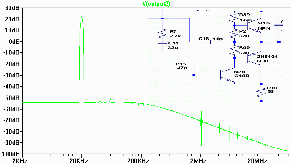

Improving the VAS part 2
But since the 'theme' of TGM2 is the use of CFP , so the natural thing is to put a CFP into the VAS. It's more in keeping with the approach so far than the Cascode (Nelsonvandal - maybe CFP VAS is still good for the 'memory effect' ?). Now we can make pretty much all of the front end prone to oscillation, the VAS included !
Will the output stages also need to be CFP ?
The good news is that this cleans up the distortion spectra quite nicely, particularly H3. I assume that it also provides the opportunity to buffer some of the non-linear loading from the drivers.
[no current mirrors were harmed or used in this design]
BUT: will it sound better, or have I taken away something here, perhaps the Bootstrap has lost its influence over the VAS with the CFP version ???

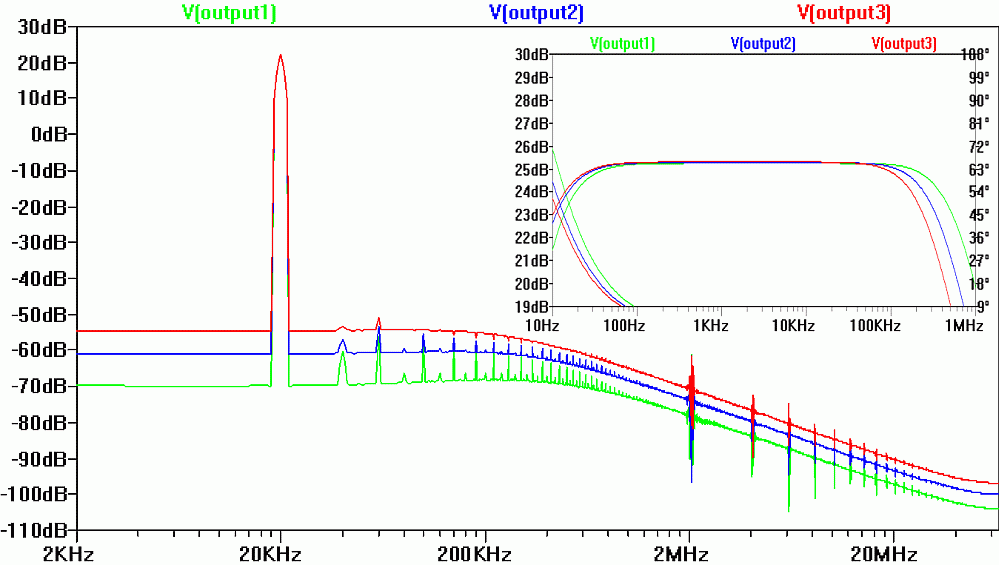

OK, I gave this a spin too:
by reducing the fdbk loop resistance whilst keeping the gain roughly the same. As you predicted there is a clear improvement in the overall distortion - in that the 'floor' moves down by several dB compared to my starting point. However, as the floor moves down, it uncovers harmonics. So, will we have any sonic benefit from making this change ????
The frequency response also changed, as could be expected. The lower resistance cuts into the base response and extends the hf response. The phase margin might also be improved, especially if I make some other adjustments.
Attached shows 3 different combinatinos of fdbk series/shunt resistance (red: 47k/2.7k, blue: 32k/1.8k, green 17.4k/1k)
p.s. this was done with the CFP VAS.
p.p.s. Bootstrap was bad for distortion, crossing that one off the list.

The FFT looks interesting. Those HF harmonics trailing to the horizon? Supposedly they sound bad. Were these harmonics simply covered up or did we produce them by the changes we made?
MikeB on this forum has mentioned the harmonics "upfolding" affect. Basically, this states that when your VAS and/or LTP are not linear, and you use a large Cdom size, the lower harmonics get circulated through the feedback system. Now you have distortion harmonics of the first set of harmonics added in. The distortion is distorted and gets reverberated up in frequency like folding a piece of paper.
So you want your VAS to be very linear. Your CFP LTP is already extremely linear, it seems.
Here is my observation: The VAS transistor has to handle the full output voltage across its collector. As we know, a transistor's gain changes with collector current and collector voltage. Run your amplifier at 1KHz full output, and plot the gain of your VAS transistor (use a single transistor VAS, not CFP). You will see something awful. Do it. Run it again at 20KHz and see what happens then.
Using a CFP VAS helps this, but only by adding gain. It doesn't solve the problem. This has obvious implications for stability. And since you need such a large Cdom to control this high gain, your distortion will start to rise at a lower frequency, and your THD at 20KHz will increase.
My solution to this has been to cascode the VAS, as illustrated in my schematics in the below link (Q4 is the cascode transistor). Try this and then look at the VAS gain at 1 and 20KHz. Some say you don't need this, since no one hears above 16KHz nowadays (but what about your children?). Others say frequencies higher than 20KHz can affect the tonal qualities of the music. I have found that if I do this, I don't need super-high gain in order to get low distortion. I will let you decide what you want.
http://www.diyaudio.com/forums/showthread.php?postid=1826545#post1826545
One possible bad side-effect, is that since you will have to set the cascode voltage low in order to get full output swing, the Cob of the VAS will be higher on average (Cob or collector-base junction capacitance decreases with higher voltage, just like a Varactor. This goes with all semiconductors). This hasn't been a problem for me, and it only seems to amount to lower HF bandwidth.

Those are "artifacts" caused by too low a number of FFT points.The FFT looks interesting. Those HF harmonics trailing to the horizon? Supposedly they sound bad. Were these harmonics simply covered up or did we produce them by the changes we made?
At the default (LT decides) or this... .param num_fft_pts 1024 , a "herringbone" plot emerges. with increased sampling ...
.param num_fft_pts 32768 , a pure plot will appear.
OS
For 1KHz THD, I use a 1uS timestep. For 20KHz, 100nS timestep has done me well.
If I want more, though, I have a set of options that I paste into my circuit that I could share with you. It computes the timestep according to FFT size, your test signal frequency, and the length of your simulation.

I have followed up on your suggestion about current sharing in the LTP and found that the distortion profile does improve if I allow the LTP master devices a bit more juice. I didn't get time to explore a range of values using .step today but the results were positive. I reduced the input device collector resistors from 1k2 to 820R, and used 33R for emitter degeneration.
With a 10nF load in parallel witht he speakers, phase margin evaporates quickly. A choke in the output is now on the agenda.
I also followed up on the suggestion of less capacitance between the VAS and feedback node on stability concerns; I reduced C6 from 15pF to 4.7pF.
The addition of the CFP to the LTP remains a clear winner from a distortion perspective. But I have not convinced myself that the additional improvements from the CFP in the VAS are needed unless I had to drive a more challenging output stage (a non-switching driver stage will be a topic of my next project).
