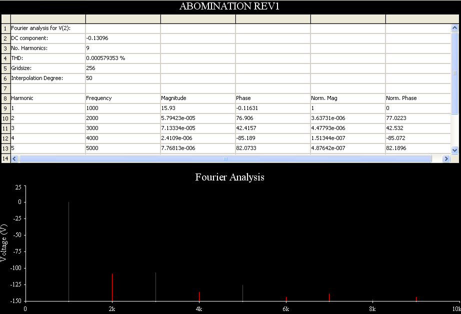

MJL21193 said:Change the input R to 47K and this is the result.
That's 130mV DC offset as opposed to 3mV and THD has climbed considerably.
Increasing the input resistor is not the same as decreasing the feedback resistor. The intention of my suggestion is not to purposely disbalance the LTP, but to simply decrease impedance between the output and LTP, to reduce phase and base current error. The only reason I don't decrease the input resistor just like I do the feedback resistor is for input impedance considerations.
FYI, the fact that increasing the input resistor increases distortion should actually help my point that decreasing the feedback resistor will decrease distortion.
Also, your last attachment does not show an increase in distortion.

Originally posted by keantoken Increasing the input resistor is not the same as decreasing the feedback resistor. The intention of my suggestion is not to purposely disbalance the LTP, but to simply decrease impedance between the output and LTP, to reduce phase and base current error. The only reason I don't decrease the input resistor just like I do the feedback resistor is for input impedance considerations.
I did find an improvement when I decreased the feedback loop resistance in terms of distortion. I also recognize the tradeoff in choosing R1. As with opamps, there is a dc bias current at the non-inverting and inverting inputs so the value of the resistors at each input will result in a dc offset and choosing them to be the same minimizes this. Yet the value of R1 affects greatly the input impedance. Fortunately, I didn't go forward with the Lightspeed attenuator plan because I have so many channels as that would have required a much higher input impedance.

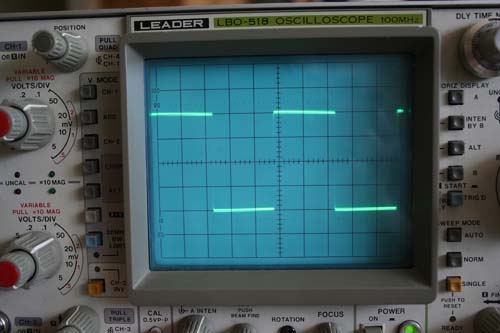

FINALLY... I have my scope up and running. We're looking at TGM1 here of course as TGM2 hasn't been built yet. A couple of borrowed scope probes. I'm afraid the scope and the probes aren't great but they do work. I tried to calibrate the probes as best I could but it was pretty hard to do so. One probe simply would not reproduce the calibrated square wave nicely.
So, hooking the 1kHz scope cal. output to the amplifier (via volume control) and looking at the output with a speaker connected (too loud) I was able to see my first square wave output. We're on 50mV/div with a 10x probe so output amplitude is around 2V pp. My apologies for the poor image, but the waveform looks as clean as the probe will allow - no ringing, rounding or other niggles were obvious.

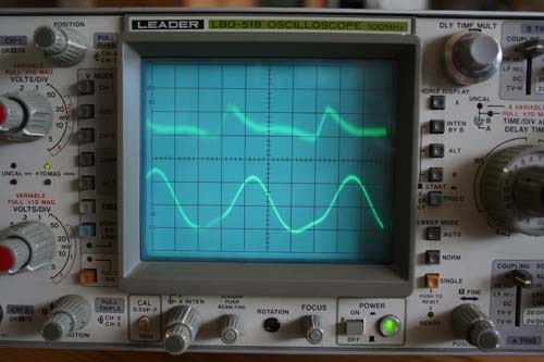

And I am making progress in tracking down the hum problem.
I can see the hum across the speaker terminals. The attached scope plot shows two traces (speaker connected).
The lower trace is the ripple on one of the supply rails, makes a nice reference waveform for the scope trigger. At most we have 2.5div x 5mV/div x10(probe) = 150mV pp (two channels powered up). Timebase is 2ms/div so we're looking at 120Hz, as expected.
The upper trace is the hum across the speaker terminals. It's a bit fuzzy, but I don't think we're seeing oscillations here (none visible on the plot shown on the previous post for example) but rather some general contamination by noise (input is floating). We are looking at around 1.5div x 0.5mV/div x10 (probe) = 7mV peak. It's enough to be annoying.
Joined 2009
Next stop was to look between speaker return and chasis. In this design the speaker return goes to a start point on the power supply which is lifted from ground via 100R.
It looks like all the hum is developed here. If I temporarily connect the speaker between the output and chasis the hum goes away.
Here's a scope plot of the signal between chasis and speaker gnd return - looks same as previous scope plot doesn't it.

I have gone back and done a few more sims, lowering the feedback R (and the shunt R proportionately) and found the THD DID drop, by a reasonable margin.

I fixed the hum - changed the layout from it's split star earth design to a single star earth. Now I'm feeling all warm inside too...
