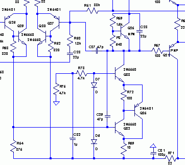

Well, first off I don't know much about Cascode's. I'm not sure how to implement this. I have made my best estimate as to how to add this into the VAS and to provide it with a stable bias from the -ve rail.
However, I don't see an improvement in the distortion performance. Before I debug this, can you comment on the implementation - schematic attached
That looks like it will work, though I would put the cascode between the VAS and the rail.
I can't see an advantage to this configuration though. A blameless style EF will most likely do as well or better with less complexity.

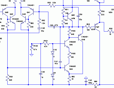

Bigun said:
and as an interesting variation I tried this (attached), also no improvement.
Just curious, but the diodes you are using is it diodes or LED’s?
Could you post the voltages on the schematics?

Personally, I haven't seen much improvement in using a filtered reference for the cascode - as long as the collector voltage of the VAS is steady in comparison with the +-20V that would be there otherwise, you should have an improvement. In my simulations, using a cascoded CFP for the VAS actually increased distortion. Your second schematic, theoretically, would have worse performance, because of the collector voltage of the CFP slave. Then again, maybe we've met the limit of simplistic theory.
I usually feed the VAS cascode with two diodes fed off of the unused side of the LTP, as in my schematic I linked to earlier.
Scratch that, in one of my recent simulations, feeding the cascode off of an LED with a 10u bypass cap results in a decrease in HF distortion. (if you want, I can post my simulation files so you can play with them yourself)
Oh, well. When I simulate amps, I cycle through a bunch of possibilities to see what causes the most benefit and what doesn't help. Eventually, there is nothing I can do to make it better. The cascoding tends to be one of the last things I add, so maybe it just has a very small affect (maybe even insignificant).
Why don't you post the specs, such as gain and THD?
Personally, I think you should build it already. Microscopic improvements can only go so far, since the real world is inherently not precise. I think it is a better idea to make a board that accomodates for your selected options and see if there is a significant audible difference.

Originally posted by stinius Just curious, but the diodes you are using is it diodes or LED’s?Could you post the voltages on the schematics?

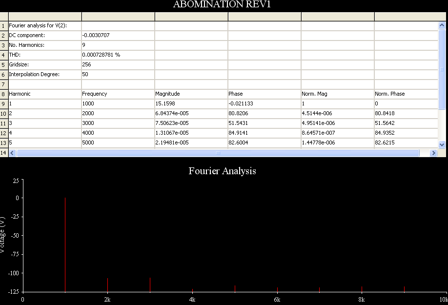

Stinius, what an insightful question. Yes, the regular LEDs that I used don't offer sufficient voltage drop. I've made this mistake before. :no:
I've re-run the sim with LED's. And I see an improvement in the FFT. It's a not a huge improvement, but a further drop in H2 but not for higher orders.
