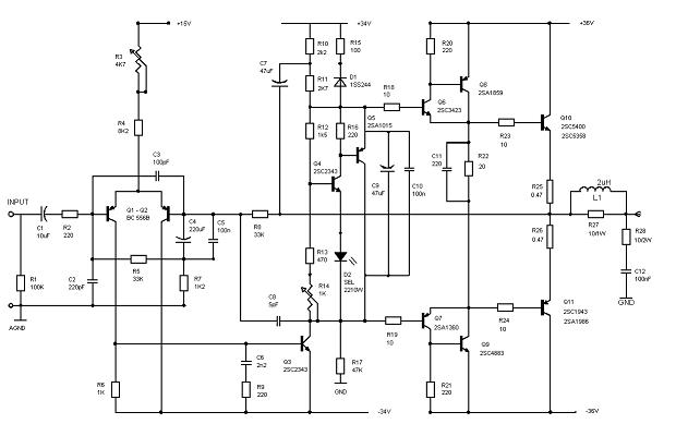

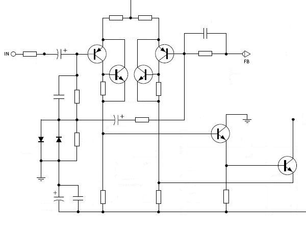

Try it the other way around. Buffer first, VAS 2nd. Then you will find that you've unloaded the LTP from driving Cdom. It might be counter-intuitive to put the buffer first but I think it provides some interesting benefits.
Joined 2009
nope - haven't tried it. It's just theory (simulation) but it looked interesting 🙂
What you will find is that the compensation cap goes on the VAS (2nd device), whereas you need only a very small compensation cap on the first device to ensure stability of the LTP-VAS.
So, if you put the comp. cap on the 2nd device it's now actively driven from both ends. The emitter of the 1st device and the collector of the 2nd device. Slew rate is now more symmetrical and no longer limited by the current output from the LTP.
Will I build it -- well it's in the queue along with a few other things 😀

I like to use the free LTspice tool to simulate circuits and understand at least in principle how they might behave. Have you tried this ?
The RC input filter - not sure if you need it, what are you trying to filter ? - do you expect to operate in a noisy RF environment ?
The Miller cap is almost always needed to make an amplifier of this topology stable. I would doubt you can eliminate it without some other equivalent compensation method. The miller cap is controversial, some hate it, some don't. My own listening tests tell me that it has an optimum value.

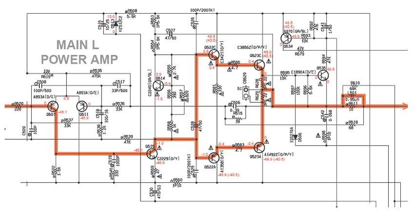

Actually this amp is highly mature and uses several stabilising techniques, most simply preventing excessive slew and thus inhibiting oscillation. It also has a very small output inductor, with split feedback before and after presumably to promote stability into capacitive loads.
1. C508 across the bases of the long tailed pair.
2. C517 across the feedback resistor, R536, reducing gain with frequency.
3. C519 in series with R540 across collector load of Q507.
4. C529 and C526 shunting VAS output to AC ground.
Certainly there is no formal lag compensation across the VAS collector/base, but the foregoing demonstrate that stability has been very carefully configured regardless.

I think the CFP Vbe multiplier is interesting... Many would say it is unnecessary, I wonder what the sonic impacts are? (EDIT: it is probably there to increase the gain that's lost through the LED).
Some possible improvements:
1: NPN VAS, with better transistors (but, we would have to use a PNP VAS...). Generally NPNs have higher gain.
- keantoken
- keantoken

UPDATE:
Well it was time to bring back all the parts I had built for a reunion. This weekend I was able to find all the pieces. I need to get back to the bench and do some DIY again.
I was not happy with the mess that I found. I stripped away a lot of things, removed a lot of wiring and cut it all back like an overgrown garden. What on earth was I thinking when I built this monster.
I took out the inductors from the psu as they were creating a problem with solid mounting of the pcb and replaced them with 0R33 resistors. The inductors weren't that big at 330uH and so I'm not expecting any degradation in sound. The psu is now simply a set of soft-recovery diodes for the rectifier followed by CRC. The first C remains 14mF per rail (plus film bypass), the second C remains 18.8mF per rail (plus film bypass).
Volume control removed - too messy. Will have to re-develop. ipod as source.
I set it back up with one channel of TGM1 and one of TGM2. Biass was wrong on both of them. I'd been operating them a bit warm, over 100mV across the output emitter resistors. Trimmed both back to 58mV.
And I did the classic. My probe tip slipped on TGM2 and shorted the Collector-Emitter of the output device. Nice blue coloured flash ! It still worked, but at higher volumes it produced a lot of crackling interference. I guess putting the +ve rail to the emitter reversed biassed the b-e junction - not good. I'll replace the device tomorow.
How do the amplifiers sound ?
Not as good as I remember - the passage of time has made me more honest. But I could sense the same magic potential and I will be making a couple of adjustments to fix this up pronto.
TGM1 - needs more current through the LTP, it's running too lean. And compensation is too heavy, OLG falling off too early. A resistor and capacitor will fix this.
TGM2 - not sure yet, probably just needs a new output device but phase lead is too heavy and needs to be cut back. And I will be trying out some ideas to sweeten the sound as I remember that TGM1 always was a little more musical than TGM2 but couldn't match it for bass and clarity.

Upgrades completed !
TGM1 - increased the current through the LTP by reducing the feed resistor from 15k to 10k, reduced phase lead from 22p to around 5p and reduced LTP collector load resistor to minimize the dc offset at the amplifier output. The 'special' resistor used to bleed some of the output to the top of the LTP was replaced with a lower value (to compensate for the fact that LTP current was increased). Sounds good !
TGM2 - Tried reducing LTP emitter degeneration from 33R to 15R. Theoretically this improves the OLG so that it's higher than TGM1. But the sound was not as nice so I put it back to 33R. Sounds clearer with better bass than TGM1. But not as musical. This was also solved with some adjustments and now it sounds better all round compared with TGM1.
Next step is to rebuild the chasis and decide what to do with the volume control.
Output Capacitor: just for interest, and although not needed, I thought I'd listen to the amplifier through an output capacitor. I found that the bass was noticeably worse off through a 220uF Nichicon MUSE. But through a 2,200uF Nichicon MUSE the bass was fine. I also tried a 10,000uF Nichicon HE cap. Overall I was hard pressed to hear a difference between the use of the two larger capacitors but I could hear a very subtle difference between cap and no cap. The output without a capacitor seemed to have just a tad more 'space' around the upper mids. That's about all I know how to explain what I heard. I concluded that I could be happy with an amplifier that used an output cap.
I tested quite a few capacitors with my signal generator, and found that for higher values, say over 1000uF, there was always resonance right in the middle of the audio spectrum, at say 3KHz, sometimes 4KHz (the larger the capacitor, the lower frequency the resonance). So you seem to be right about something going on in the mids.
