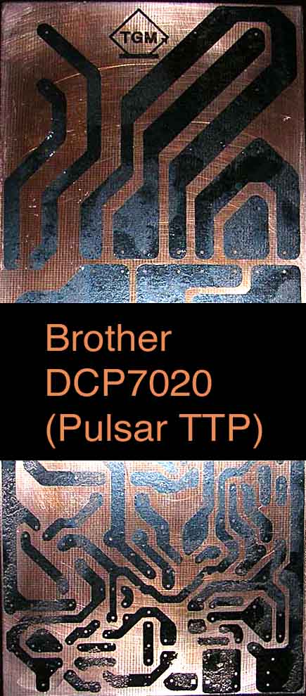

I don't know if this image is clear, but it is my 2nd attempt at toner transfer for making this pcb. If you can see what I can see (!) it's unsuitable for etching. The toner has poor coverage. It is stuck to the surface nicely and there's virtually no bits missing. Lots of pin holes.
I suspect that the issue is the toner. I'm using a Brother laser printer and I've heard that other people have had issues when putting them to use for this purpose :bawling: :whazzat: :redhot:
However, I did buy a Dremel today, always wanted one and drilling the pcb gave me the excuse.
Also on the upside, you get to see the logo I've designed for this thing (a tenuous connection to my Forbidden Planet theme, TGM = 'The Great Machine' and the doorway to the Krell lab was this shape....)
PCB was cleaned off. Wire wool until it gleamed. Acetone again.
Used Xerox laser printer instead, image looks good on the transfer paper.
But results still poor, looks like same kind of issues from first time around. Tried twice: Ironing long and hard verses less hard and for a shorter time didn't reveal any improvements except that ironing for a shorter time results in poor adhesion.
Could the toner be unsuitable from both printers ?
There must be something I'm missing here 😕
I get excellent, no fuss results printing onto laser printer transparencies and using a fluorescent lamp to expose boards pre-coated with photo resist.
You tradeoff the higher cost of pre-coated boards vs. buying expensive toner transfer paper and the hassle of polishing the copper, ironing, and then doing it over when the toner transfer didn't quite work.
