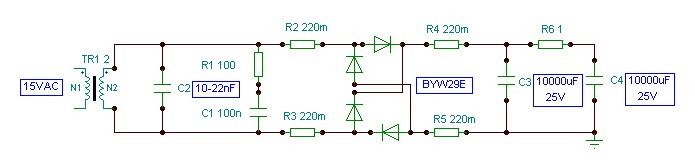

These are BYW29E's from NXP which Digikey sell for 70c a piece when you buy more than a few. It adds up to a fair cost for the system but I figure getting better power supply performance is worth it and wouldn't be any cheaper to achieve through better transformer or capacitor design. The next step would be full regulation but I don't want the additional voltage drop or a 'stiff' supply.
These diodes can be heatsunk but I haven't designed them to fit against the 'main heatsink'. Do you think it's worth designing heatsinking for these parts ?
The main heatsink material is Aavid Thermalloy part 68855. If I cut off 3 inch slices for each channel the thermal resistance is around 1.51 degC/W. This isn't a low as what is spec'd for AKSA 55 for example, but for a single channel designed for 25W I am hoping it will be sufficient not to cause a reduction in the lifetime of the output devices ??

You may also want to incorporate some of these parts.
it´s exactly what I have been using. Maybe you could arrange a lighter heatsink for the diodes. I`m not able to assess the main heatsink.These are BYW29E's

Lumba - I've seen the use of a resistor/cap filter on the output of a PSU but I'm not sure how much incremental gain it allows me. At this point my pcb is 'full' so some clever rework will be needed to add more.

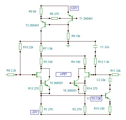

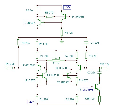

The reason I'm not convinced of the need for the additional circuitry is that the simpler circuit is a close relative of AKSA 55 which has a good reputation. i.e. it may be 'good enough'. But then where's the fun without some experimentation !
I do like the concept of the JFET/BJT input pair because as far as I can see the dynamic range of the JFET is larger - it's linear over a wider range of input voltages compared to the BJT only design. Am I understanding this correctly ?
But the JFET on it's own doesn't have the drive capability for the VAS so we add the BJT to give it some 'back bone'.
Unfortunately I'm still not 100% comfortable with the detailed design calculations for component values. Many of them aren't too critical and a 'feel' for the topology and constraints gives a good guide in most cases. However, too often I am simply 'borrowing' from existing designs without fully appreciating the subtle tradeoffs. For example, some designs use a potentiometer to control the current through the LTP (AKSA/Lifeforce) to influence the dc offset at the output, other designs go straight for the throat and put the pot across the legs of the LTP to adjust balance at the emitters directly. Which is best and why ?
JFETs aren't so easy to source I find, especially matched pairs in a single package, which used to be more common.

JFET input is preferable for every imaginable reason. (Sorry, I`m not explaining why). You could use BC560 until you find some 2SJ74s, which have the same pinout.
This compound (CFP) is more linear than a plain device.
R5 defines the LTP current, 0.7V/68Ohm=10mA and R13/14 the current through T3/T4 in the same manner.
The output DC offset is chiefly caused by imbalances in the LTP.

nelsonvandal said:You know that Hugh uses CFP in his top of the line amp Soraya, do you?
I've not looked at Soraya, all I know is that he named it after his daughter so no doubt he is under pressure to ensure it is his best design or he'll be in hot water !!
Hugh's Lifeforce (successor to AKSA) uses CFP at the input. So does the FrugalAmp from OS. I think Hugh may also have included an emitter resistor in the VAS. Along with other measures the performance is well ahead of the original AKSA from all accounts that I have read. It's more accurate, noticeable improvement in bass. But it's not for sale as a kit and I want to build. Hugh says that the distortion of Lifeforce is way lower, 15dB down from AKSA. People who have upgraded from AKSA to Lifeforce have been very pleased. But it was the unique character of the AKSA that attracted me to it in the first place. The 'limitations' of it's design are what give it this character.
Of course we don't ask Hugh to give up his secrets (well we do, but he says 'no') but I believe from all the reading I've done so far I have an approach:
step 1) build a design with low distortion - TGM2 and TGM3 should achieve this
step 2) allow flexibility at the LTP to affect distortion - primarily though the current balance
step 3) experiment with the compensation - helped along by separating the HF feedback loop (from the VAS) from the LF feedback (from the output).
