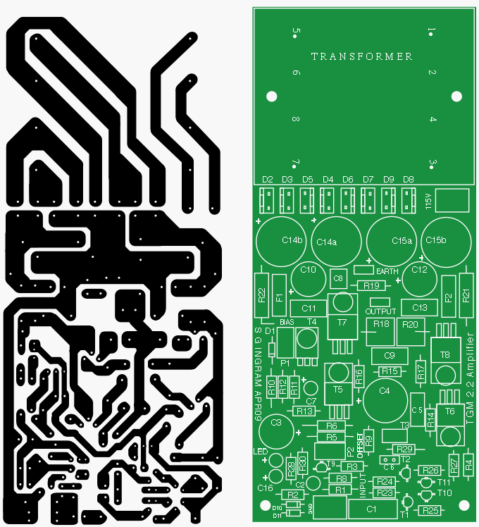

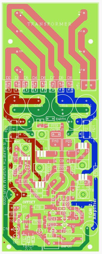

The pcb design was too large to fit on a single letter size print out, so I've squashed it down to a size that's easy to deal with. It ain't finalized and checked over yet, but we're getting there...
I'm going to be stuck waiting for a few back ordered parts from DigiKey (e.g PSU caps). This gives me time to set things up, make a first-go pcb, sort out the chasis and heatsink.
I'm thinking the first step is to build the psu, check it. Then build the simple TGMversion1, debug it slowly. Then build up version 2 and debug it.

Looks good and I like the concept of individual mono amps.

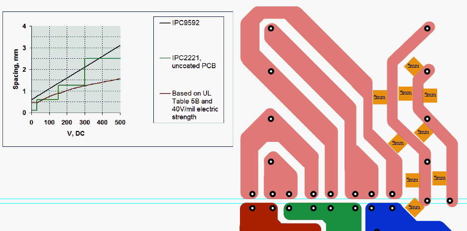

One thing is you might want to increase the clearances on the mains AC traces. There are regulations covering this - I'm not sure about the exact numbers but I think it's ~5mm apart. For your own peace of mind.

definitely want it safe - duly updated to achieve 5mm spacing. Couldn't find much on-line about this except the little graph.

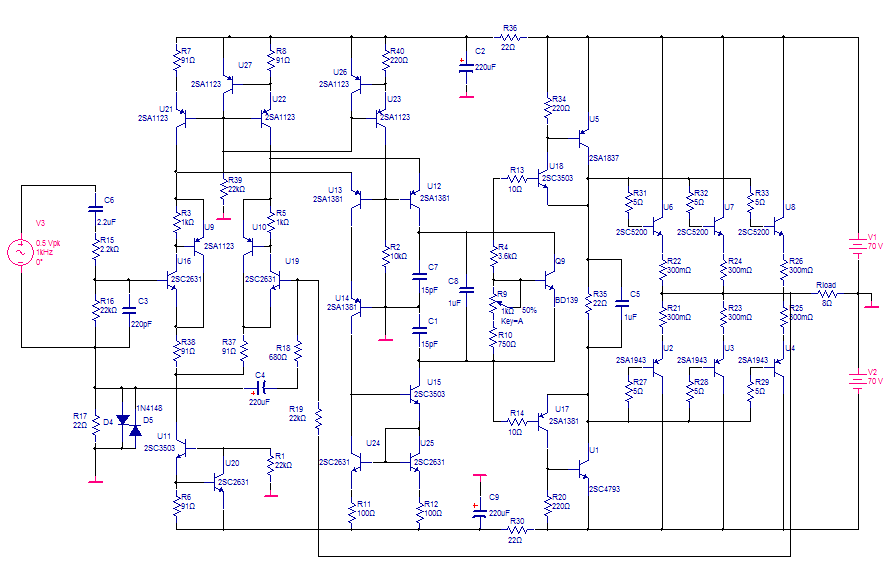

I see your schematic does't have component values. Can you post one that does?

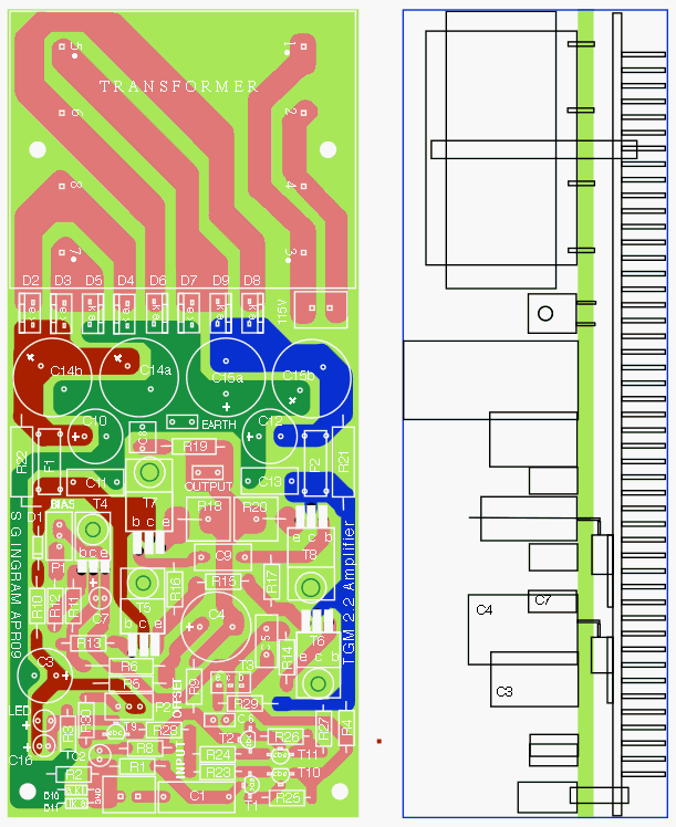

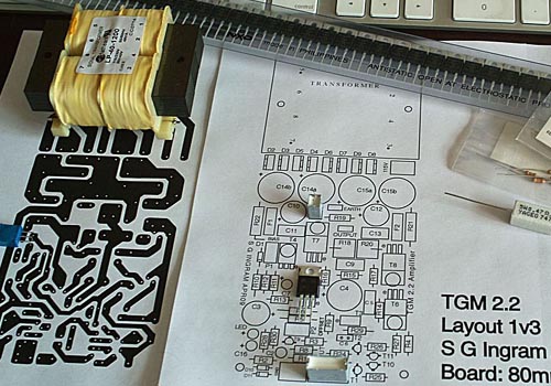

Your board looks really good - have you printed it out full size to check that everything fits? Too many times I go ahead and make the board, only to find that the parts don't fit😱
What program did you use for the layout? Mind posting or sending me a pdf of the copper and the silkscreen? I could give your design a listen myself.

Excellent question! Well, I have dry fitted most of the parts to a print out although I will repeat that process again shortly because the recent print out was from a printer that I don't trust the scaling. Trouble is, some of the parts are on back order so I have to trust the manufacturers datasheet.
I didn't leave much space for a heatsink on the VAS device did I? Neither did I consider a variable footprint for playing with compensation capacitors. On the other hand, I can make another one.
Now I have to come clean on the pcb design. I downloaded Eagle, the free pcb layout software. It's one that has all the features and I was looking forward to learning the ropes on this. It is limited to small boards, smaller than mine so eventually I'd have to pay for a license or cut the design into two pieces. The real issue is that you have to define parts not in their library and this became laborious quickly. I was too impatient. I used a graphics drawing program (Macromedia Freehand) that I am familiar with and just drew everything, so the files are no use to man nor beast I'm afraid. If anybody has a library for Eagle with the parts set up I would be willing to redraw it - but since it hasn't been proven to work yet this should perhaps wait.

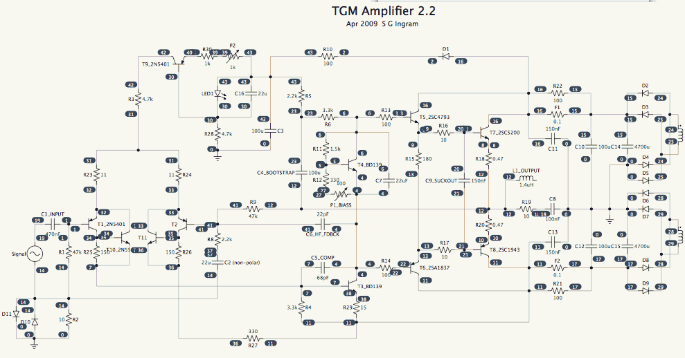

Here's the schematic reposted with values. But it's a work in progress...
The values for the TGM version 1 are pretty set. They are based on what I imagine AKSA would be happy with (differences certainly include C11, C13 and bits of the NFB for example). In this version the LTP will be set at a low current with no emitter degeneration. Linearity/accuracy is not the primary aim for me here but to sample the sound with some 2nd order harmonics from the imperfectly matched LTP. With 20V secondaries I figure the supply rails at +/- 26.5V. I also need to check R8/R9 to ensure the gain isn't set too high that I get clipping.
The pcb is designed to allow me to make TGM versions 2 and 3 so the schematic includes parts that I haven't worked out values for yet since they aren't needed for version 1. These are R23 and up and C16.

Your outputs layout is a little small for the TO-264 package. Are you planning on the FJP5200/1943? These are TO-220's.
Joined 2009
Yes - are they bad ? - my power requirements are not high (sensitive speakers) I didn't need to get output devices in the large package (e.g. 25W might well destroy my HT speakers and my big speakers would be better bi-amped so I'd still be able to test them out without frying things). I have the Fairchild 5200 devices in TO-220 packages rated at 17A 80W (and their complimentary equivalents). I've no idea if they will be as good as the Toshiba originals.
I (foolishly ?) try to single-source all I need from DigiKey to keep it easy. I specifically wanted soft-recovery rectifiers and I couldn't find them in compact form.
What is the compact bridge rect. you have there ?
The compact bridge would have helped me shrink my layout, because my pcb size is ideally fixed by the width of my heatsink (I have 6 meters of 184mm wide extruded Al) and the height of the box (80mm). But the shrinking is done for now.

I have a couple of comments on your schematic. First, your front end is running way too cold (talked about before). Second, your input cap is a tad low, might cut off some LF response. Third, your VAS is running a bit hot (definitely need a sink on that).
Look at deleting R3 and adjusting R30 to a lower value (and either use a lower value for P2 or eliminate it altogether).
R25 and R26 in your CFP inputs may be too low. I worked up a similar input and used 1K in that position.
