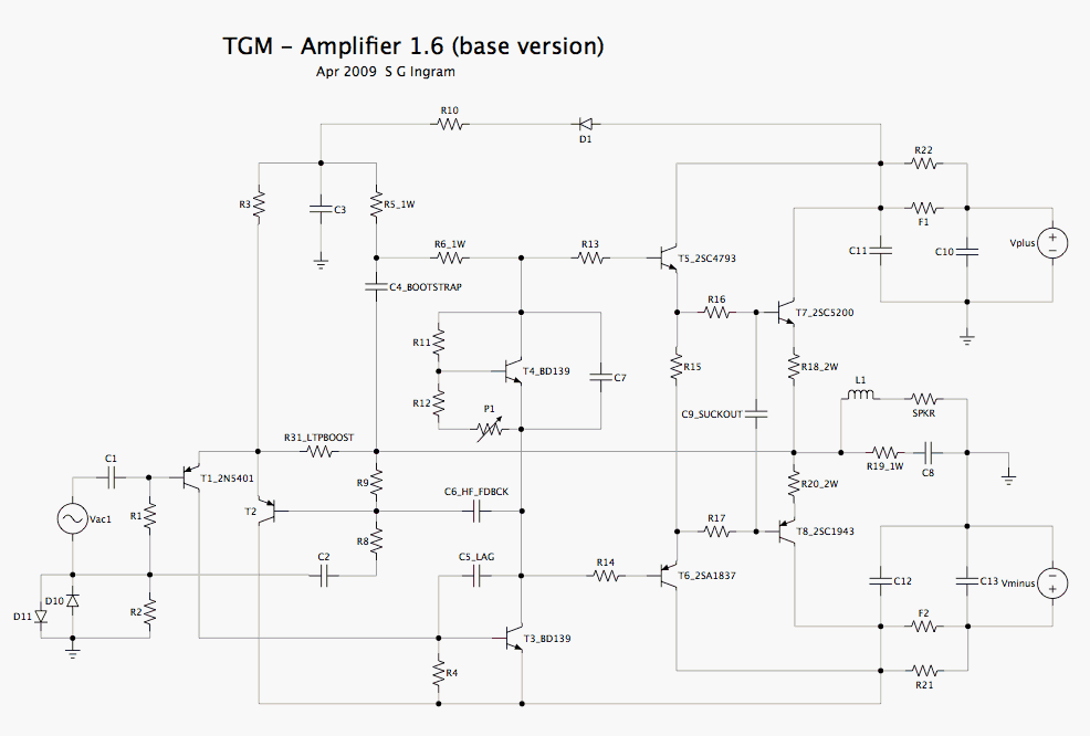

And here's what I was referring to as an update to the base version:
Gareth,
you know, I like your basic view on things and I`m pretty sure that some sunny day you will design and construct good sounding amplifiers.
An active current source for the LTP (without a current mirror) does not mean constant current through the devices but a heavier emitter/source load causes decreased functional accuracy and increased distortion. However, a current mirror and a VAS CCS, without further measures taken, would raise the open-loop gain, lowering THD but also sound quality.
It is supposed to have a front-end that is not designed for measured excellence.
Amplifiers should not be designed for measured excellence.

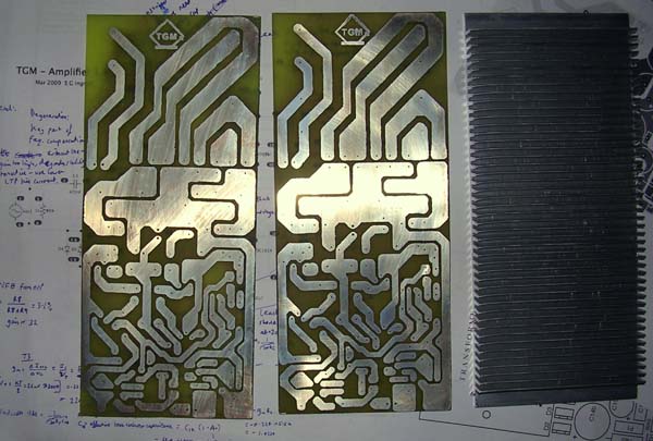

Well, I am able to report that having given up on Pulsar paper I have had more luck with some magazine paper (a big thanks to MJL for that one). The BBQ adverts seem to work well, so too the car adverts.
I'm not completely satisfied with the results, but I no longer have the patience to rub down some copper clad board so into the etch bath it went, just half an hour ago...

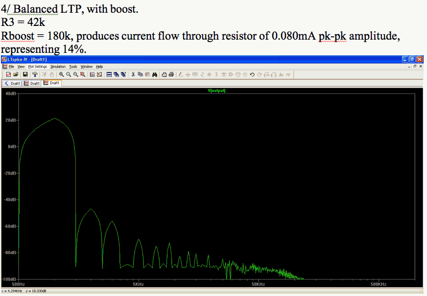

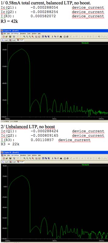

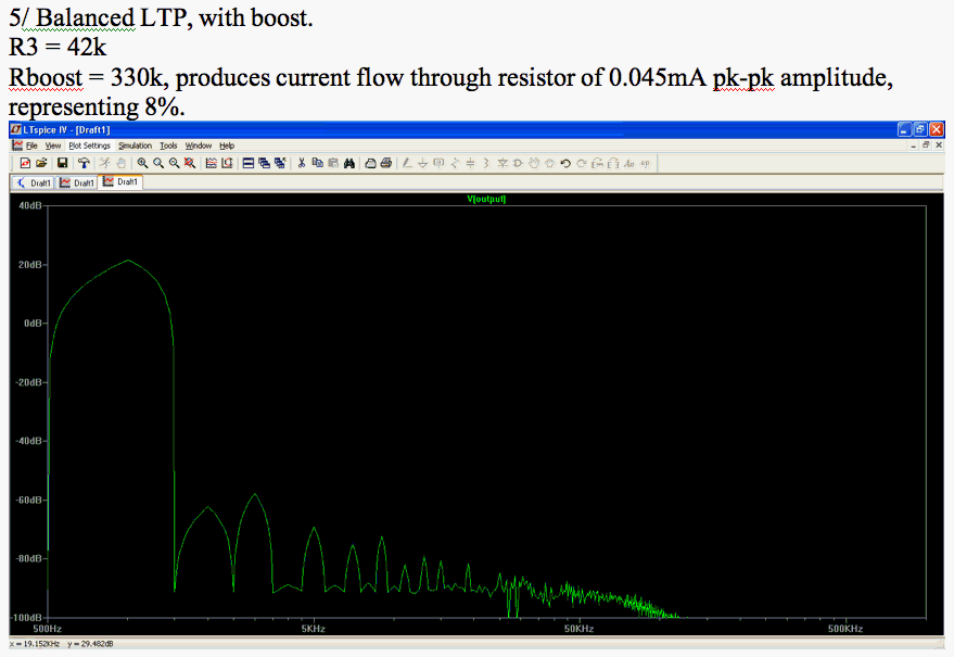

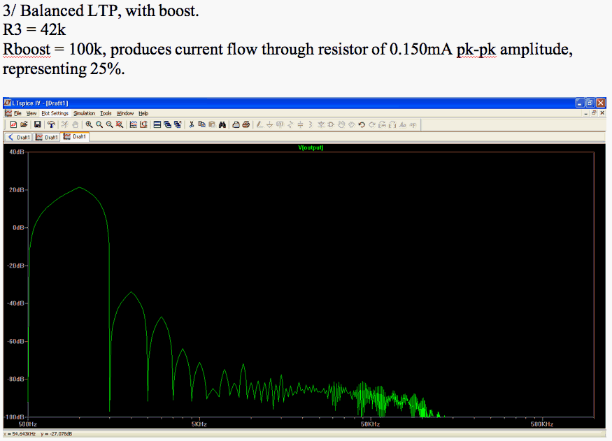

So I tested out my amplifier and it works fine. So back to the idea of manipulating the H2 content by unbalancing the LTP (after all, that was my excuse for not using current mirrors).
I am simulating TGM version1, with the simply resistor biassed LTP pair. I'm running it 'cool' with only 0.58mA through the combined LTP. I tweaked the biass resistor to give me this value since it's close to the current that flows through the AKSA LTP (my role model). Picking an E12 value gave me a lucky coincidence that the current balance was pretty good. The input bjt sees 288.054 uA, the feedback bjt sees 288.254 uA. So the currents at dc operating point are balanced to around 0.07%. I obtained an FFT of the output as shown in the attachment top trace.
Then I unbalanced the LTP by reducing the biass resistor and pushing the total LTP current up to 1.1mA (still pretty low). The two current flows are now 288uA and 809uA respectively, which is a huge imbalance. I checked the FFT of the output and saw the lower trace in the attachment.
What gives ? - the harmonic content is not really changed that much, did I miss something here. H2 is at -70dB, H3 at -60dB. If anything H2 is a bit lower when the LTP is unbalanced. I had expected an increase in H2 with the imbalance based on some reading on the web.
Sorry about the image quality, files size limits are the cause...

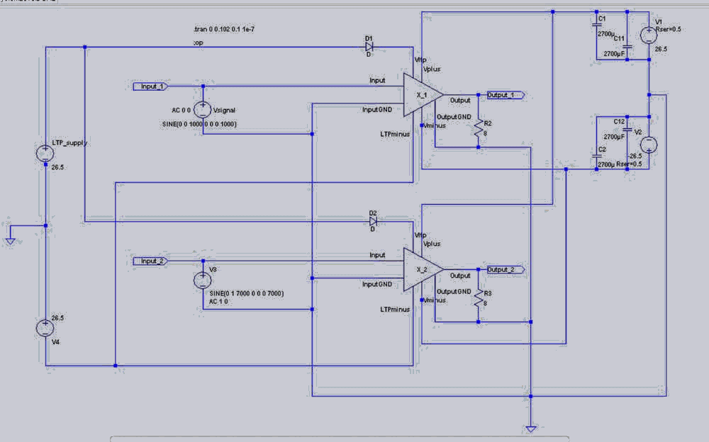

I've started looking at the question of cross-talk. I have to build several channels. For stereo it makes good sense to invest in a dual supply so I suspect not very much effort has been devoted to multiple channels. For 5 channels it gets more cumbersome. People have complimented me on my approach of using mono-blocks, but it is a brute-force solution and I thought it worthwhile to dig further.
I set up a simple simulation. It may be too simple and simulations are not the same thing as real life where there are many more parasitics to include than I have bothered with. But it gave me a tool to explore the relative effects of topology on the cross talk from one channel to another. I looked at a two channel arrangement where I set up one channel with zero amplitude input and the other with a 7kHz test signal (I removed the ground-lift resistor as this messes up the reference point for the output) and looked for 7kHz appearing on the power supply rails and subsequently contaminating the other channel.
I've looked at three basic approaches.
1/ Single Supply to all channels
2/ Dual supply, one for all of the input stages, one for all the output stages
3/ Mono block, each one a separate supply
Attached is an example of the Dual - Supply. The main supply is that for the output stages, the intenal resistance is set to 0.5 Ohm and filter capacitors with a series resistance of 0.05 Ohms. The TGM1 amplifier is represented by the triangle.
