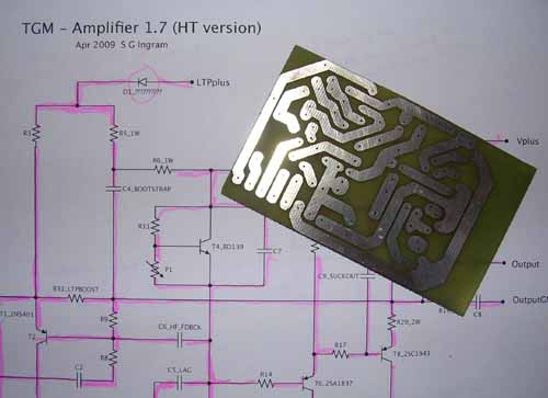

Here's the 2nd pcb for playing with the amp. I don't know why, but making pcb's drives me crazy. Seems that as soon as I work out a method than it stops working. My wife is starting to suspect that I know how to use the iron afterall 😱

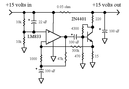

finesse regulators were scrutinised here:
http://www.pstca.com/spice/ripple/ripple.htm
option 2 and 3 look worthwhile.

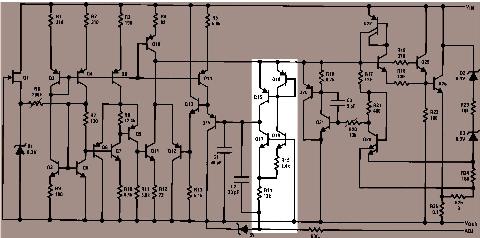

LM 317 circuit diagram with the BGR highlighted. It is not a very attractive design for audio use, small operating frequency range (yet still wider than that of fixed-voltage regulators) and the noise level just cannot be low, however it`s a much better choice than an unregulated supply.
